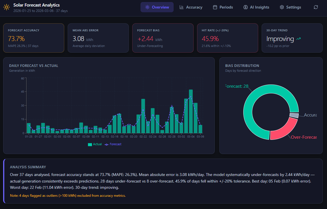

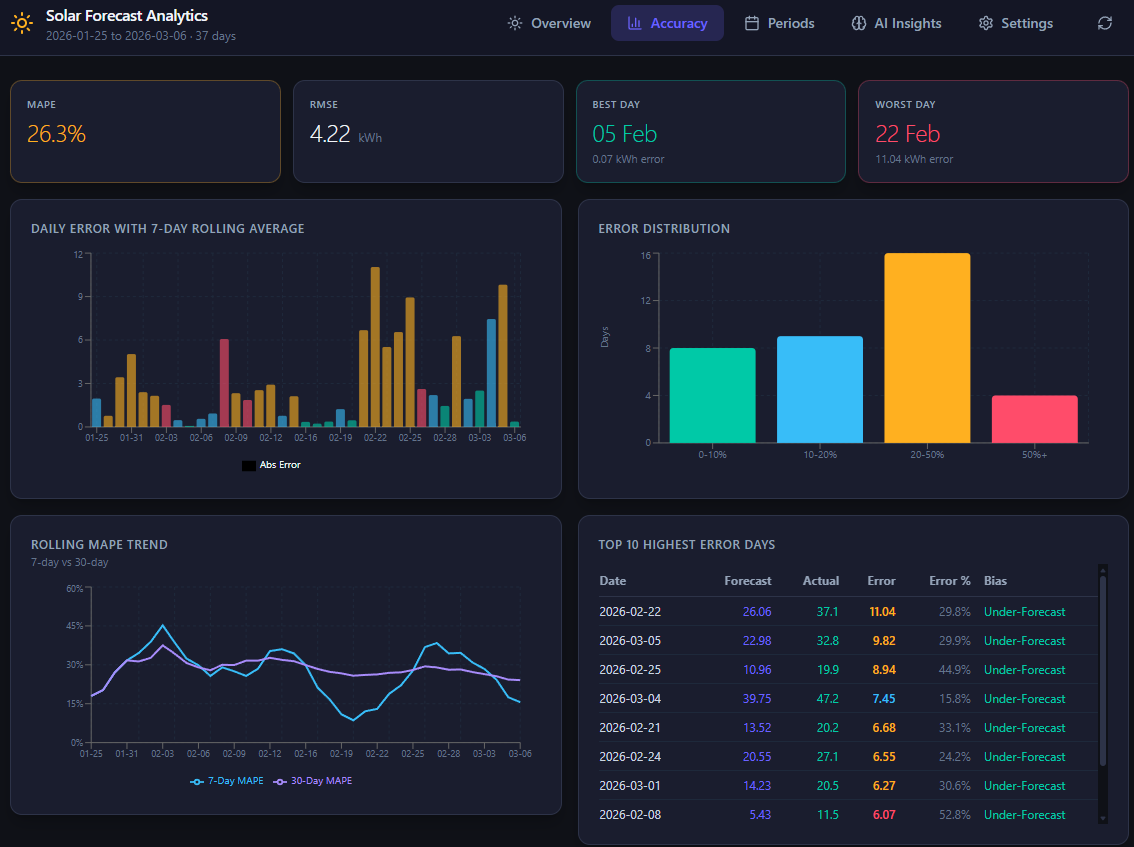

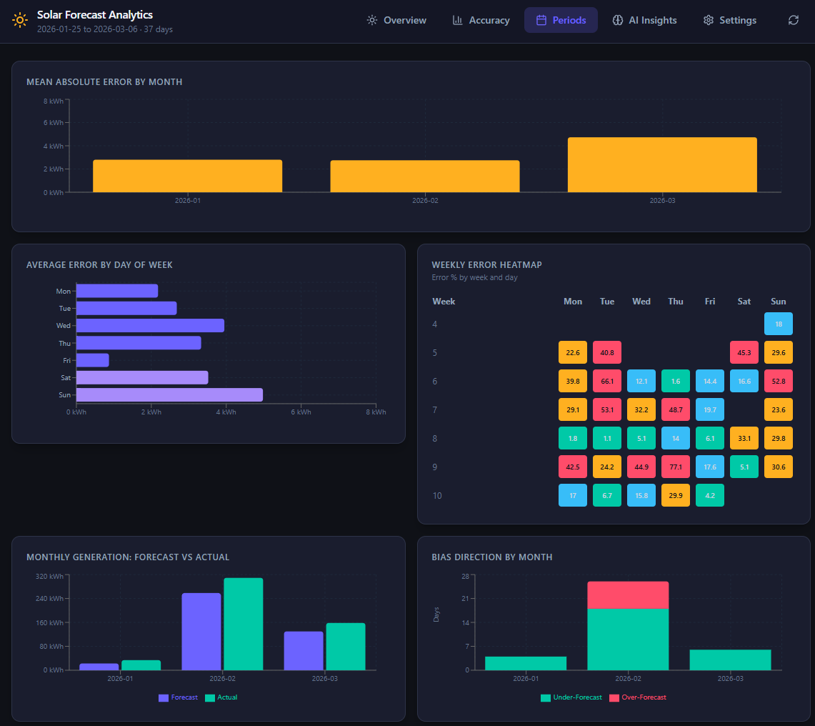

I built an app that does some analysis on forecast accuracy for me... only got a months worth more or less, but its interesting data. my system is consistently over producing vs forecast from Solcast!MaterialBarracuda48 wrote: ↑Tue Feb 24, 2026 7:29 pm The built in HA solar forecast said 9.3kWh

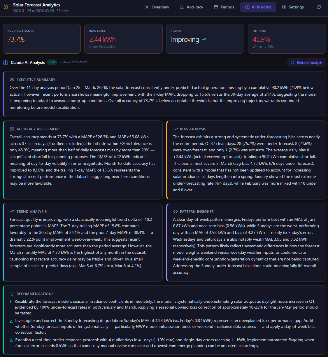

whacked in my claude API key to see if it could give some recommendations too!

That does look mighty good, and even more impressive is getting better than expect performance.
Took a few tweaks before I got solcast forecasts that actually made sense, it didn't help that solcast and forecast.solar use different ways of expressing azimuth.AdamNewberry wrote: ↑Sat Mar 07, 2026 11:35 am my system is consistently over producing vs forecast from Solcast!
In terms of usability the mind boggles why can't we just enter a degree from true north using a compass app on our phones.
The trick I found to both is fresh data, things really can change within half an hour.
Also solcast blindly assumes 20% degradation, unless you enter an install date or similar, and forecast.solar assumes no degradation.
