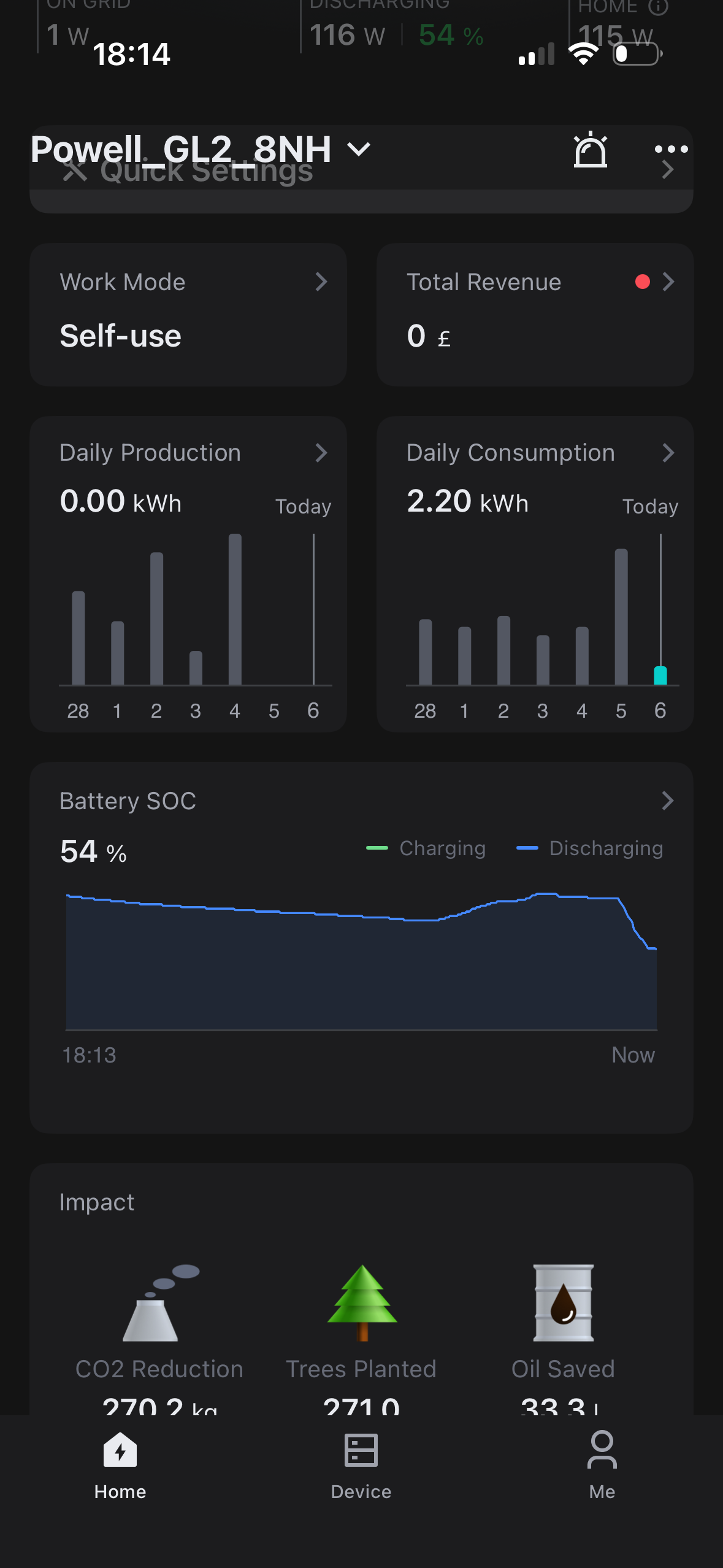

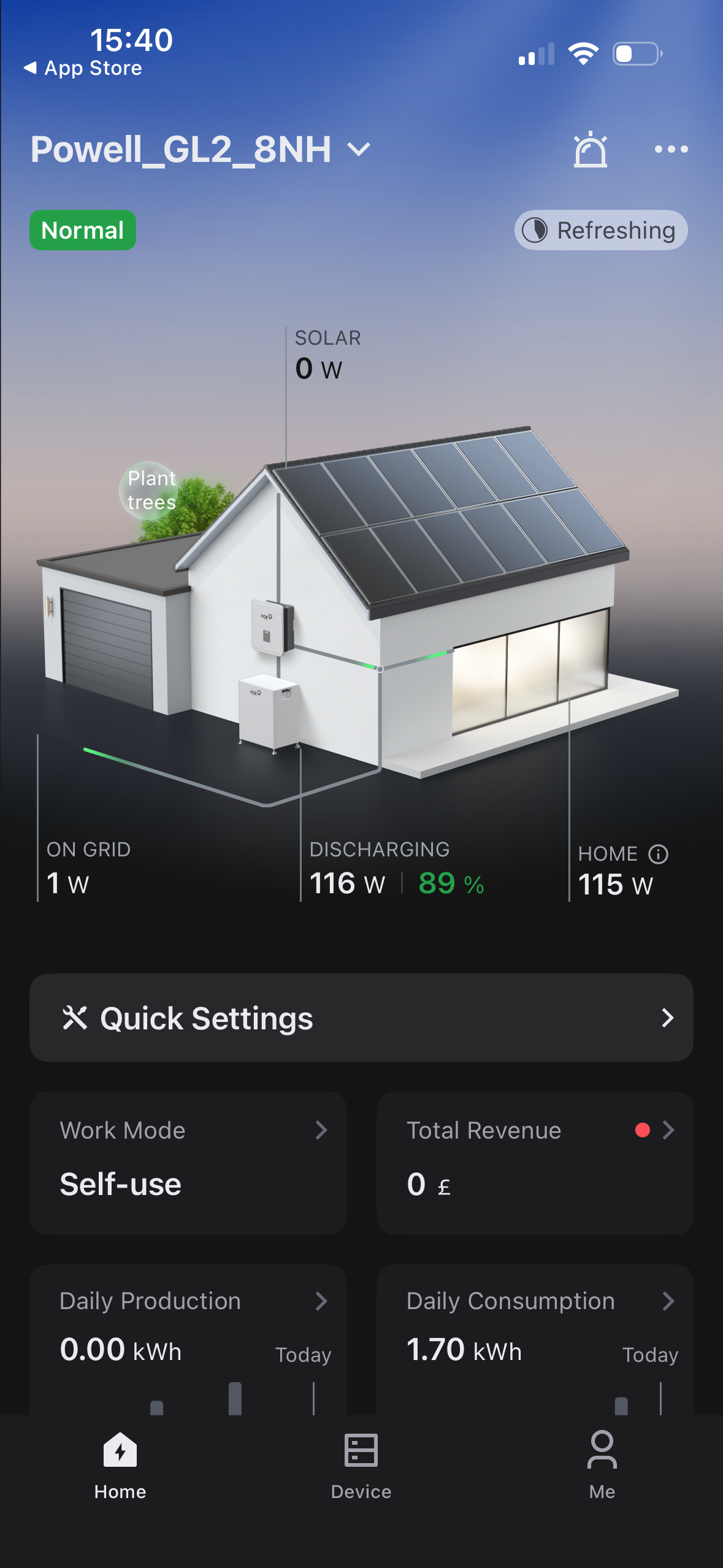

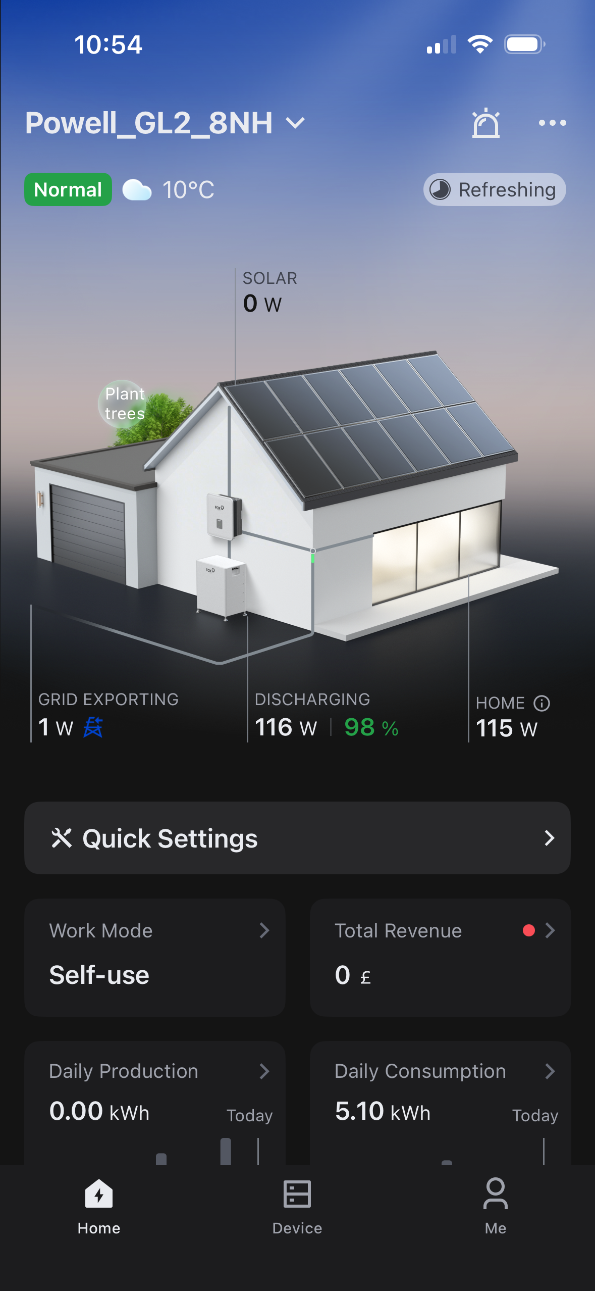

I’ve added two images from my app screen. Yesterday at 10.54am full sun.
Today at 15.40pm, cloudy. Daily production screen, showing zero pv production!
In your first picture, you can see the PV was generated up to the 4th, then stopped. Not sure what has happened on this date, and no fault codes shown etc.

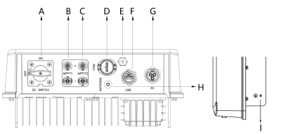

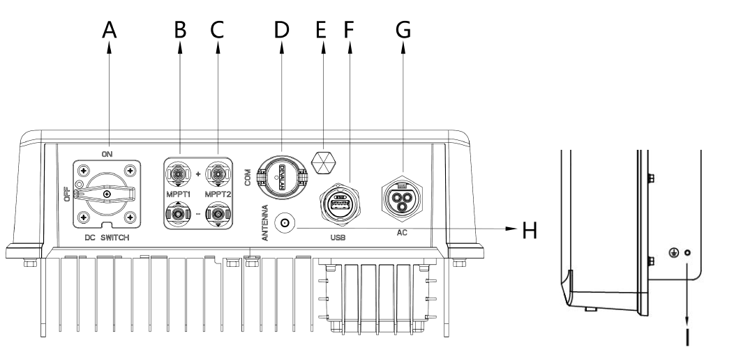

Under your Inverter, you should see a physical DC isolator, I presume this is set to On right now? It might be worth turning it off at this isolator, and on again.
Can you let us know if you are using both string inputs under the bottom MPPT1 & MPPT2 also, or just MPPT1.

That 5 second refresh is a nothingburger. It is a new firmware that gives you 5s refresh on energy stats vs the old way of 5mins of data being sent to the cloud.
The system still sends data to Fox every 5m, but locally it gives you a snapshot every 5s, so it is working fine.
The SoC % of a battery is just a 'construct' of the BMS inside the battery measuring cell Voltages, given your system is new, it takes a few charge and discharges to the 10% and 100% indicated SoC to calibrate.
The lack of PV power being shown is your issue, and something is stopping PV from being generated.
