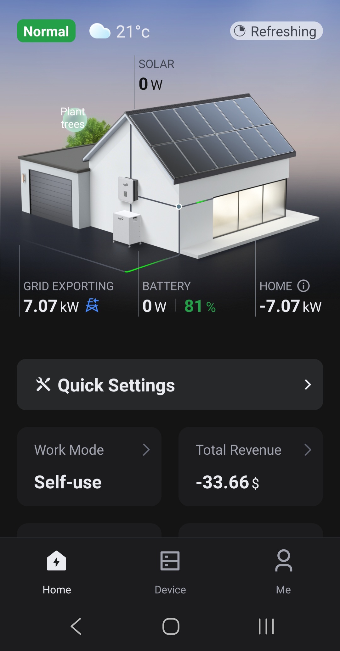

Homepage, to show current Work Mode

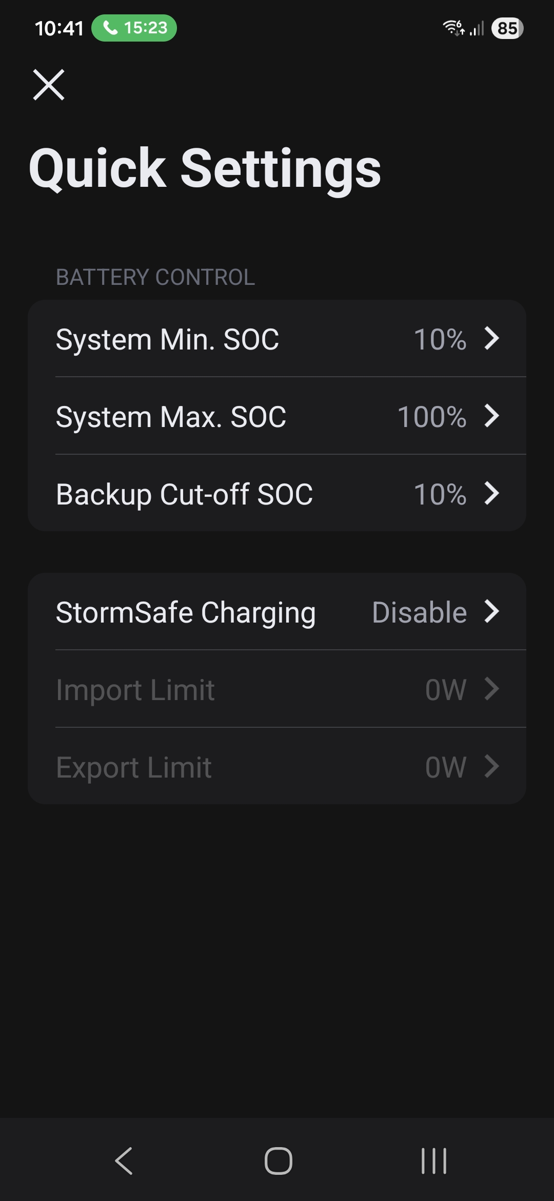

Quick Settings to show Min/Max SoC and the rest

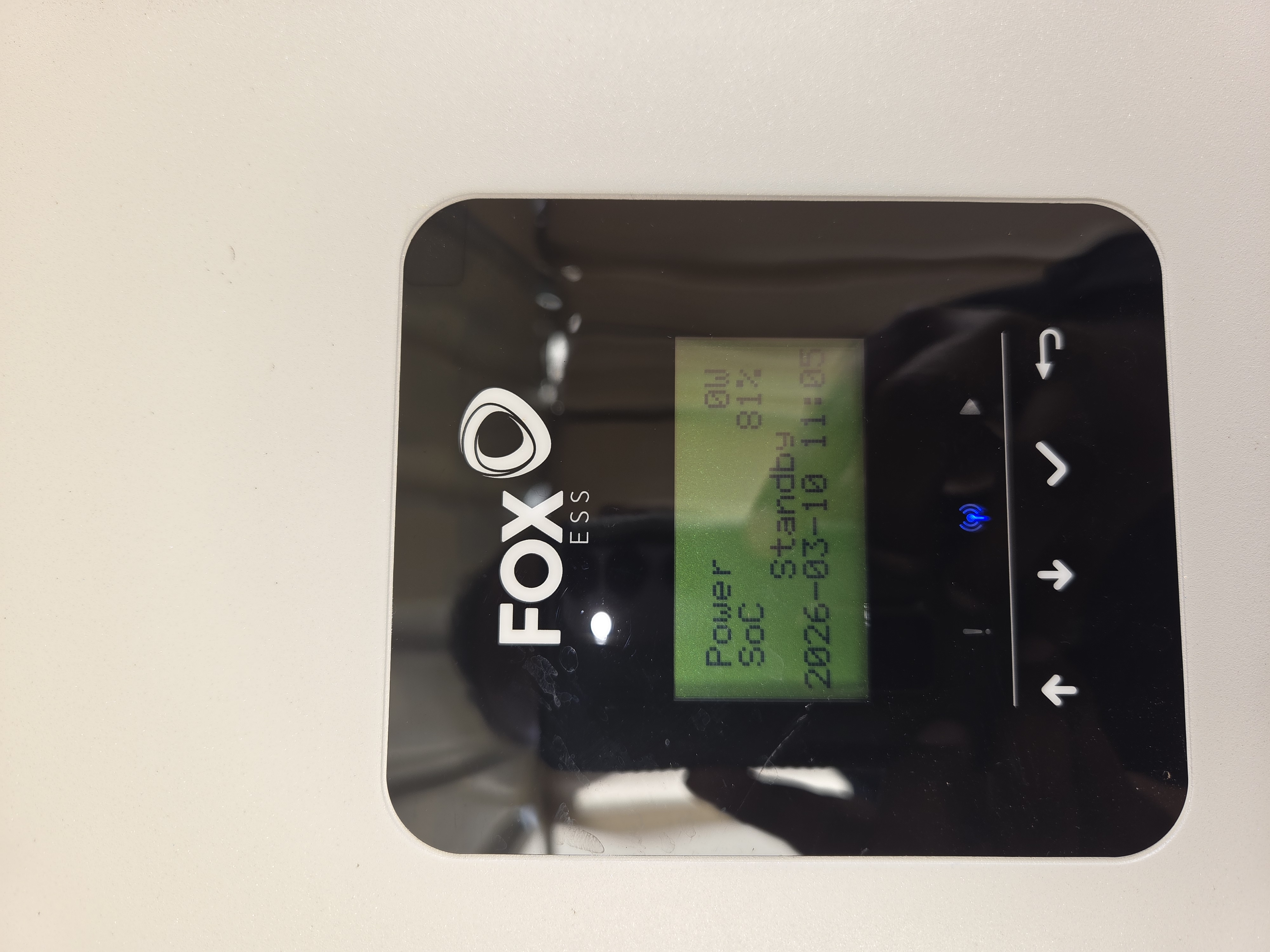

Attaching screen shot from app and inverter. If u have suggestions for app settings, I will appreciate it very much.

Ok, I think I figured out the problem and resolved the issue. Willtest through for the day.... If u have this issue then flick through the settings on the inverter and disable standby mode... ahah

All good. I had been away for a week and inverter went into standby mode after 5 days. Not sure if this is some default code for idle battery protection. Not sure why it did not auto switch to normal mode upon active use. But all good, fingers crossed. BTW, there is no support from installers who are basically fly by night operators. Hope this is not another pink batt gate...
