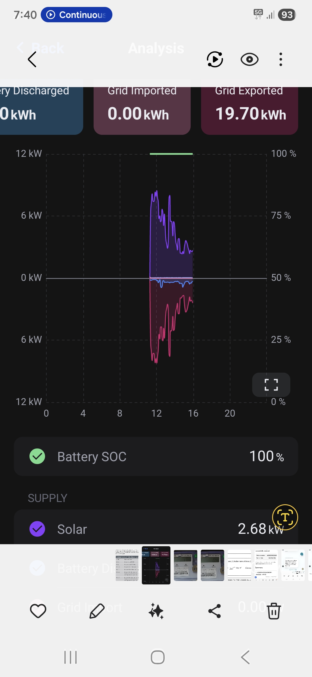

The other possibility I can think of is your solar CT clamp is backwards.
You said you export 17kWh, was this reading from FoxCloud2.0 App?
Do you have some pictures from the App to share?

Yes this is from the app.MaterialBarracuda48 wrote: ↑Mon Mar 16, 2026 7:43 pm The other possibility I can think of is your solar CT clamp is backwards.
I am worried about the ct clamp as I had some issues with it during the first install.
I've attached an image shortly after I read the smart meter (so was more that 17kWh)
