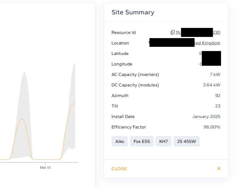

This is what it gives you for hobbyist accounts (this is my west array):
Note you cannot specify the cell technology, only an efficiency factor. Also, it does not seem to take the installation date into account for hobbyist accounts, since if I recall correctly, it was at 90% from the start, and I had to manually set it to 96%.

WyndStryke wrote: Sat Mar 07, 2026 2:05 pm Note you cannot specify the cell technology, only an efficiency factor. Also, it does not seem to take the installation date into account for hobbyist accounts, since if I recall correctly, it was at 90% from the start, and I had to manually set it to 96%.
I had to set our 3kW system to 90% and the 1kW system to 80% to get matching forecasts.
