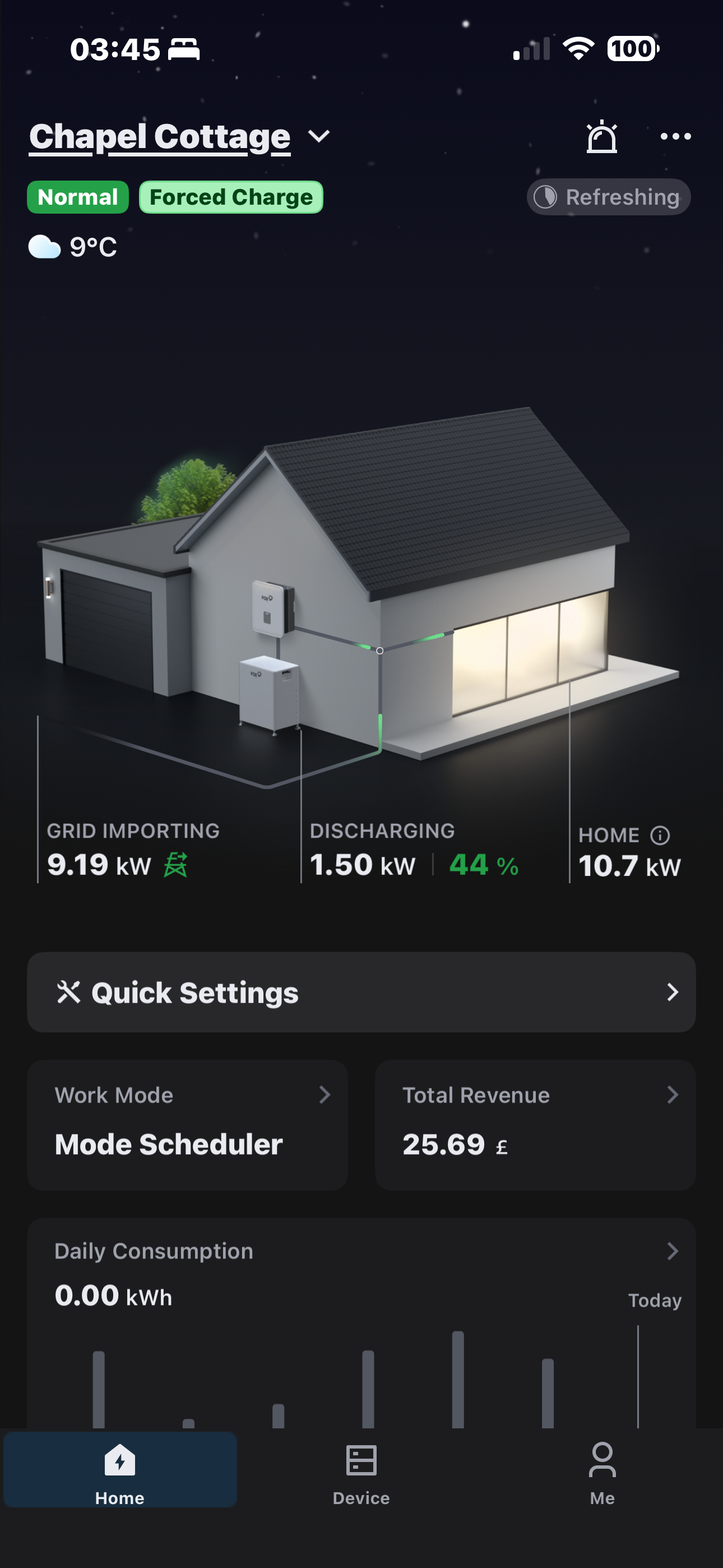

However last night the noticed my battery was discharging at the forced charge period. It seemed that all of a sudden the max that could be imported to the whole house was 9kw. So my ev was charging at 7kw and other devices were on. When these dropped below 9 the battery started charging again.
But this morning I’ve only got a 40% charge.
This has never happened before and usually during my cheap period I’ve had peaks of 16kw with the battery charging at 5KW and the eat 7 and immersion at 3 etc.

Input 9200
Export 5000

Input too low, I bet you suspected that would be the case.
Here is how to adjust.

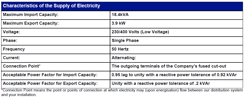

Depending on your house fuse rating, this is your example value
Volts x Amps = Watts
230 x 80 = 18400 Watts
If you have a G99 for your install, you can get the values from that.

Correct only they can change it, but since they often leave the values on defaults or duff values go ahead.
It is very rare that they change the default passcode.
My export was set to 3600W, by my installer, as you can see I am allowed 3900W, so I went and changed it.
During firmware upgrades, yes values can be changed if Fox baked new defaults into the code, catches a few out.
I suggest you look for and check your G99 (guessing this is what you have) for your Import/Export rates before you adjust.
