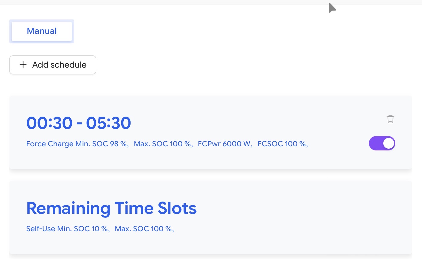

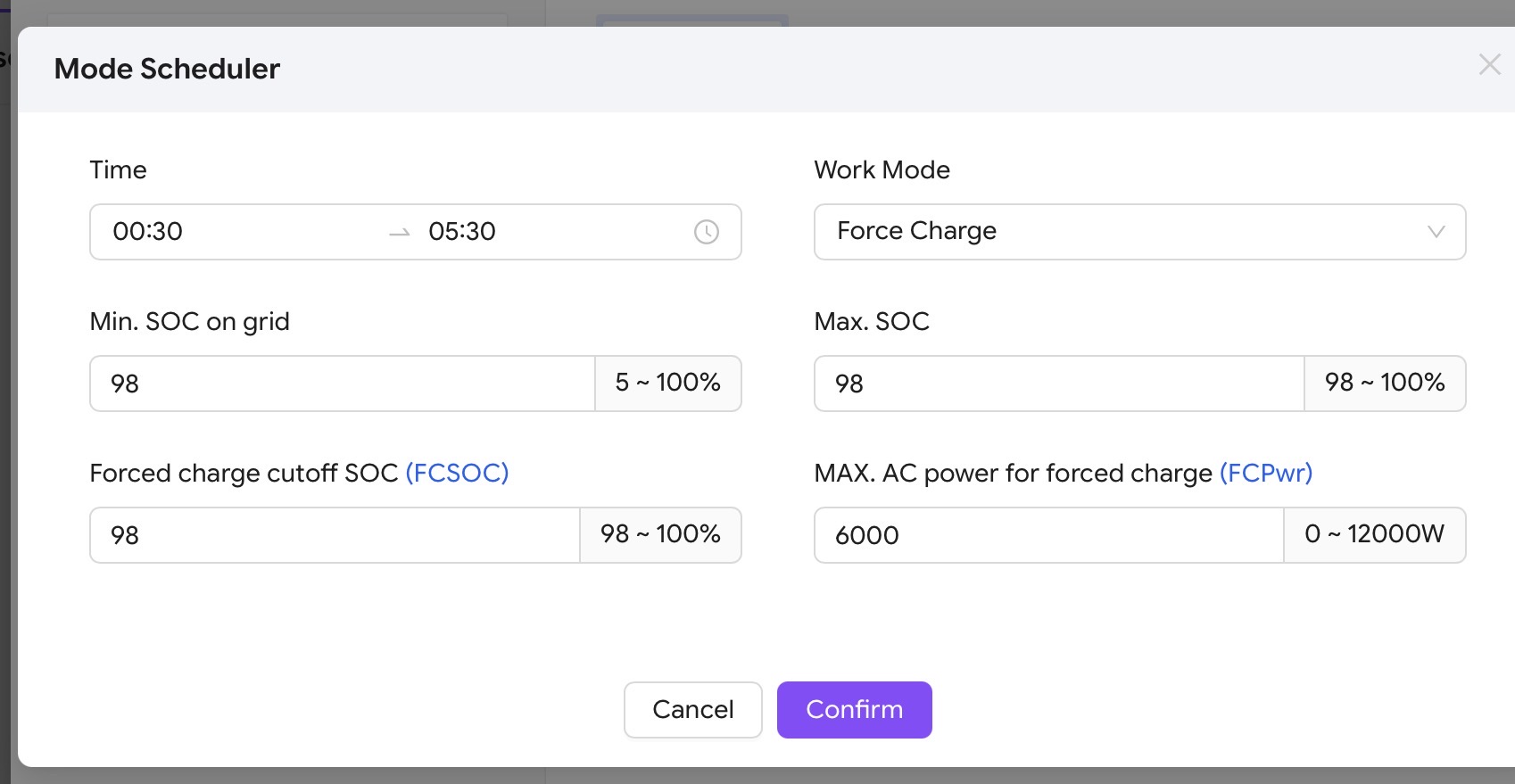

These are the current settings I have, I would be very great-full if you could give any feedback or spot any errors. I had no idea what an ideal wattage is so went for 6kW like my EV charger
Really hoping to see some charge in it tomorrow morning and not just 10%.

They look good, yes... Mine would have charged at 1.06kW with those. The 98% Min. SOC on grid seemed to be the magic setting that made it charge when it was on 1.09. If the unit was working properly that setting would tell the unit to stop discharging to meet the house load once the SoC goes below 98%, but with 1.09 it's definitely not working properly!
