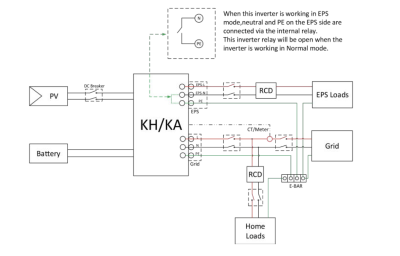

...except that it doesnt....when the power cut happened the whole house went off, then a few seconds later (!!!!) the supply to the house resumed from the battery......when the power came back again the same thing happened
I later ran the test again this time using the supply isolator switch to give a clean break and exactly the same happened.....router died, NAS offline, CCTV offline, PC shutdown potentially with open files then went offline etc. etc

You are obviously upset, but what Inverter do you have, and what errors are showing on the screen?
If you have a small 3.68kW Inverter and 5kW load, it won't handle it.
If your battery SoC is not enough, it won't work either.
Then theres the chance they wired things up wrong.
If you can provide more details, then some help can be given hopefully.

Hi, indeed I am not happy.....
system comprises:
14 x Aiko Neostar 2p plus 475W panels (6.6 kWP)
Fox EP12 10.4kW usable battery (>40% SOC)
FOX KH7 7kw hybrid inverter
EN-EPS-BOX-SP gateway
Pretty much all perfectly matched as far as I can tell...

Same inverter as mine, should be able to handle 7kW EPS load... unless you was using more than that at the time.
Do you have fault codes on Inverter screen?
I would expect grid loss and Voltage warnings to be stored (and usually in the FoxCloud2.0 App you can view once running) on the Inverter screen/history.
