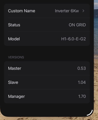

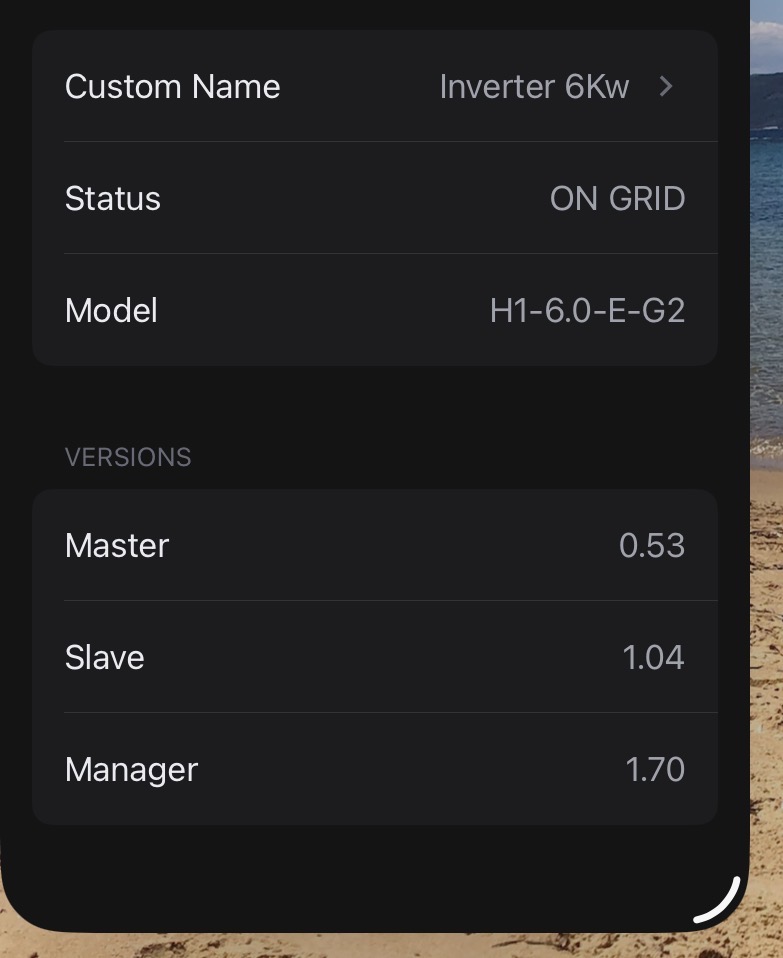

Now I see the inverter fw showing a Master of 0.53 Slave 1.04 and Manager 1.70, all changed without any action from me
The app stopped refreshing for 15 mins yesterday lunchtime, can only assume the inverter has thrown a wobbly and ended up in a mixed state

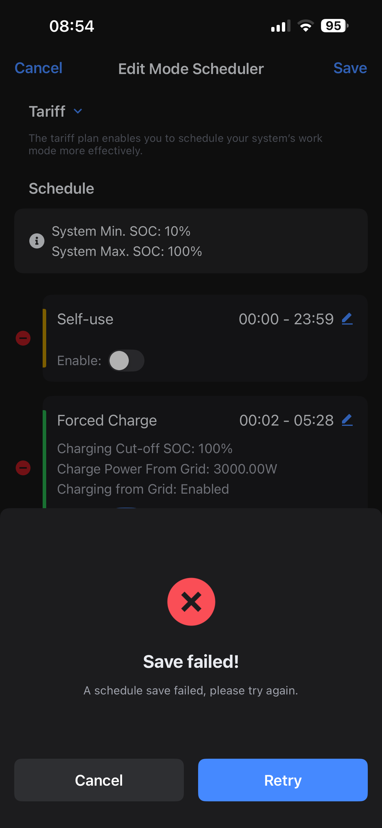

Still cannot save any changes in Mode Sceduler
A complete inverter and battery shutdown/reboot has not solved the issue, over to Fox tech support
Can only assume the Master fw at 0.53 is the issue.
It looks like they pushed a beta firmware out to your inverter then
Over to Fox support as you say, hope they resolve this quickly.

Still seeing an issue on the app, where changes made in Mode Scheduler cannot be saved, deleting and reloading app makes no difference. Changes on the web based version work fine and then are copied to the app, but still cannot be modified on the app
Anyone else got this issue ?
Was an issue on 2.2.7 and now 2.2.8
Finally managed to get my installer to push through the correct fw.

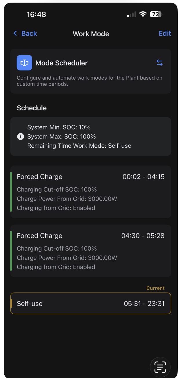

Solved it !
After rebooting the Datalogger and still no resolution, I noticed in Mode Scheduler, I had 2 FD schedules, and a disabled self use. And a box to tell me remaining time is self use.
Set the self use to 0531 to 2331 and enabled it, then save and it now works and the 2 other schedules can be turned off /on, saved etc.
This is something unique to the app, as the web based tool had the same setup with self use disabled as a schedule and it had no issues modifying the other schedules.
The stupid thing is that the app states remaining time is self use, and it was working correctly in self use.
This is the aftermath of the dodgy fw they pushed onto the inverter last week, as it was fine before their unwanted intervention .
These Fox guys have really got to get their act together and actually test what they develop fully.
