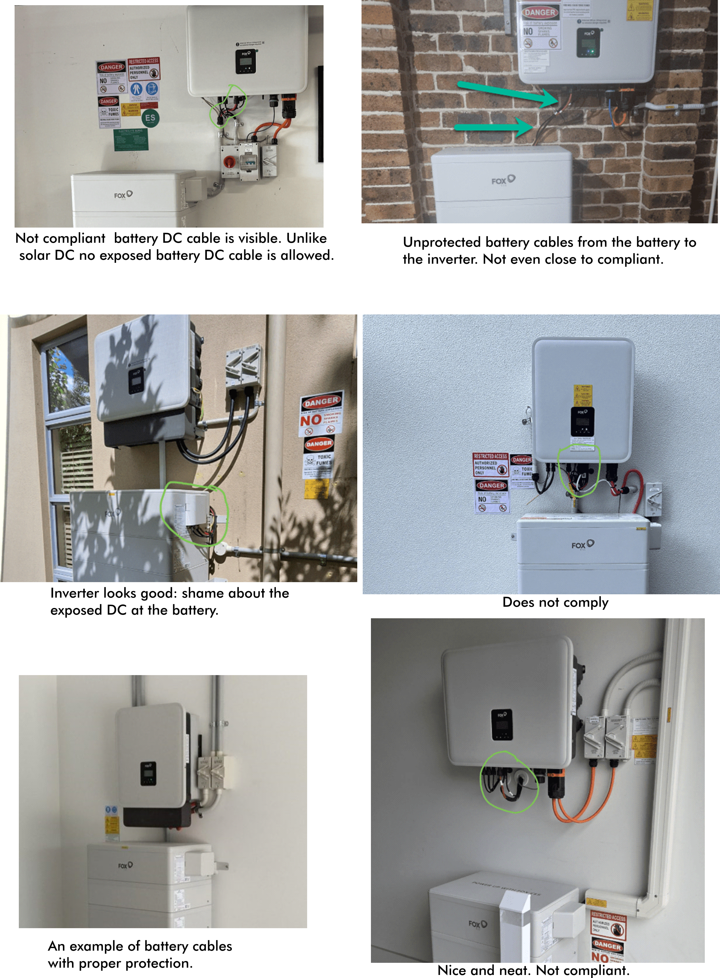

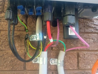

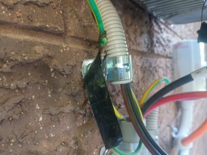

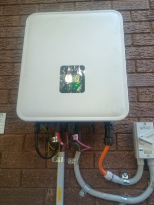

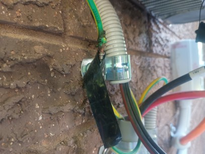

Here's the link to the article which seems to indicate a lot of FoxESS installations might be non-compliant... how's yours looking?.... i'm worried.
Mine is no better so I'm raising the subject initially with 'Access Canberra Installations'
https://www.solarquotes.com.au/blog/aus ... g-problem/

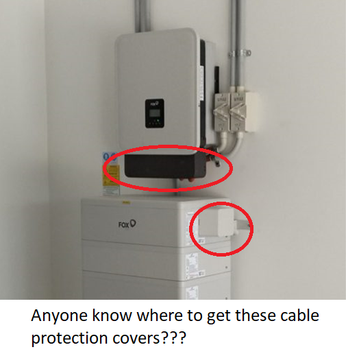

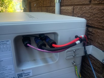

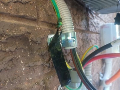

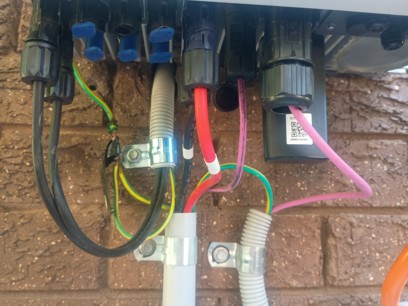

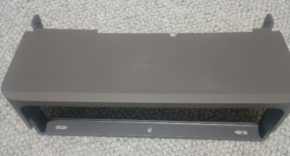

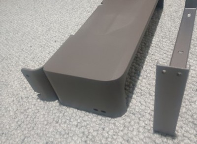

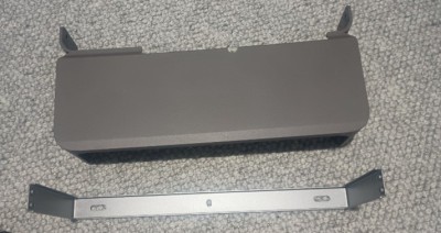

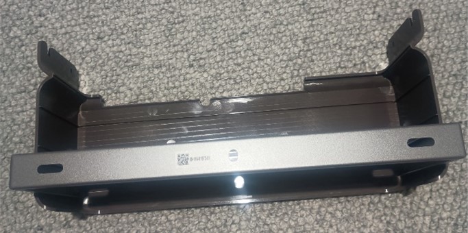

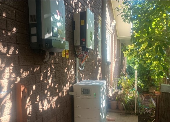

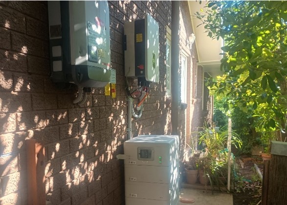

Here's pics from the article, looks a lot like mine.
Does anyone in OZ know where to get the 'cable protection covers' shown in the last pic?
Instal pics.pdf
(899.26 KiB) Downloaded 775 times

...not sure that the instal pics were included...

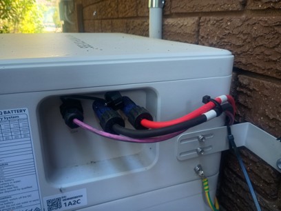

My install didn't come compliant with the two covers so I've sourced and installed them myself rather than going through the installer. For the battery master cover FoxESS nicely supplied me the cover. For the inverter terminal/wiring cover I sourced that from Solar Juice at something like $40 delivered.

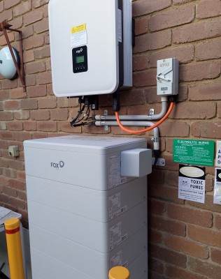

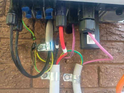

My installation has those wires exposed as well. System has been inspected by Access Canberra and I did ask the inspector about the exposed DC wires. He said that isn't an issue. My system is compliant.
Re: Non-Compliant FoxESS installations? (Australia)
How about sharing a pic of your install.
TheRoseManCanberra wrote: ↑Sat May 23, 2026 6:36 am How about sharing a pic of your install.

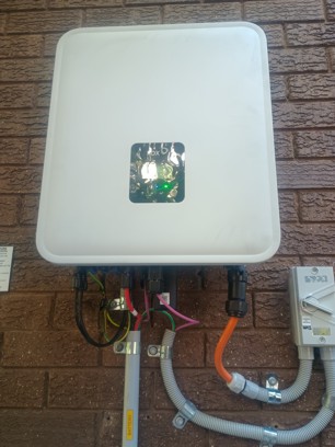

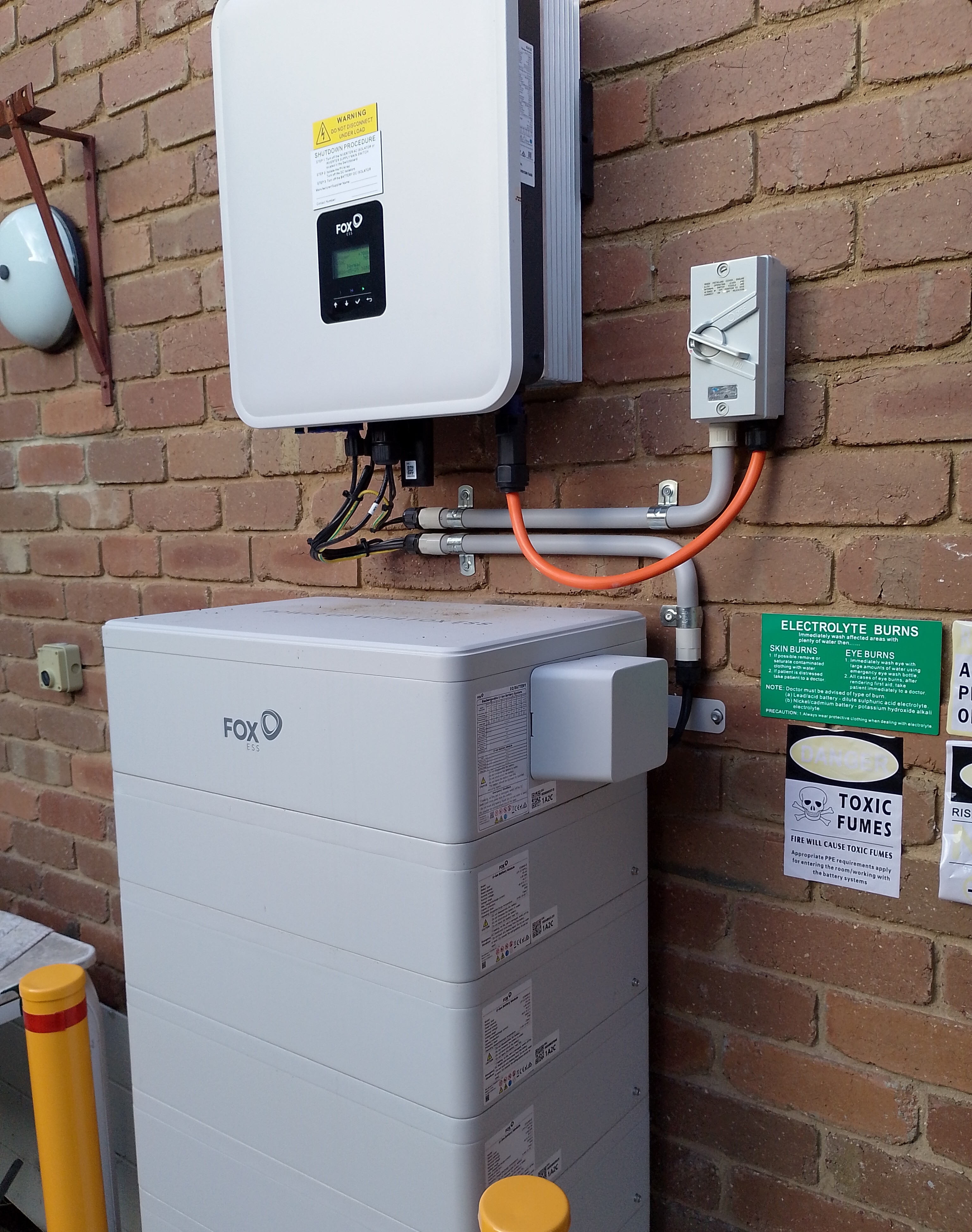

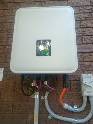

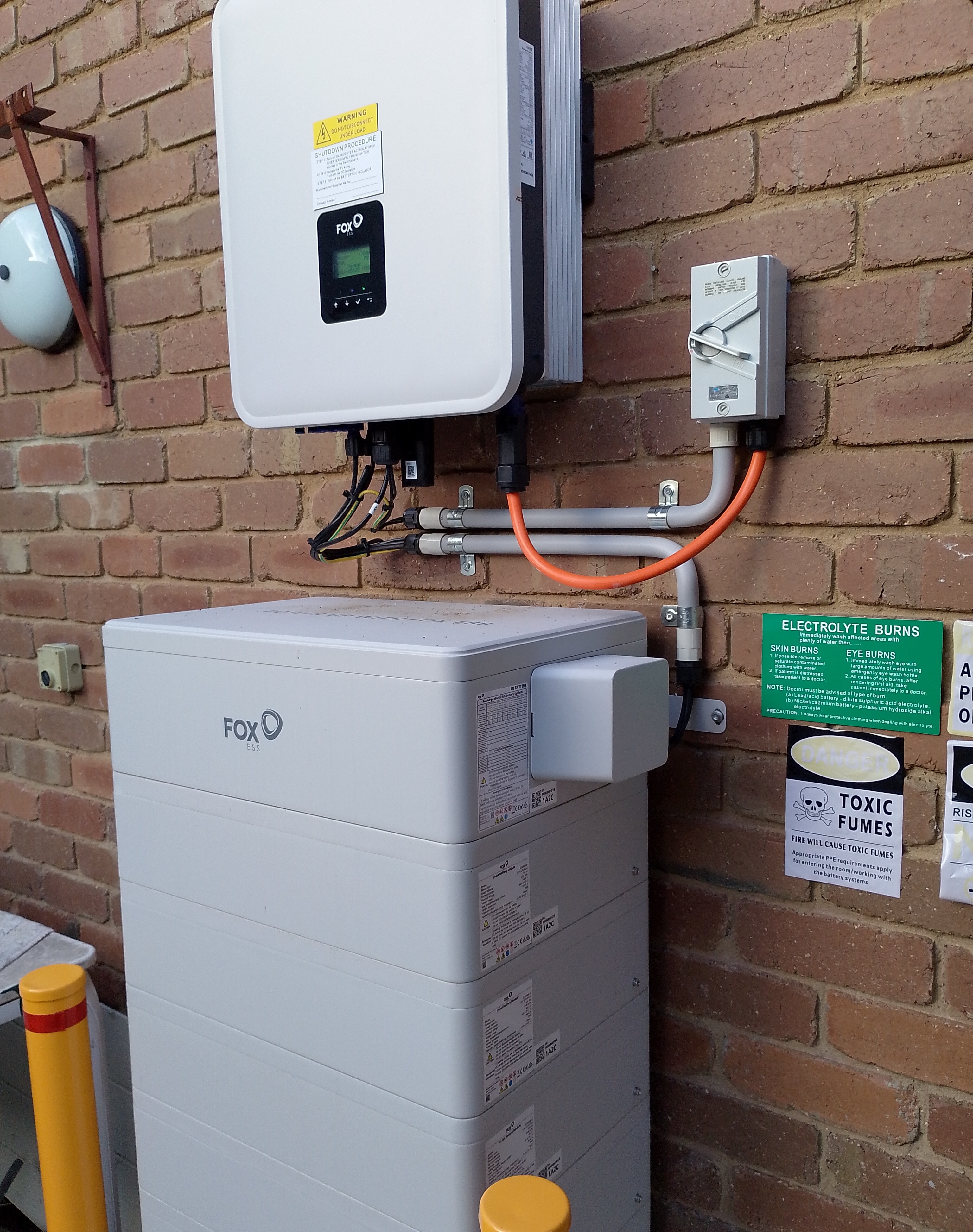

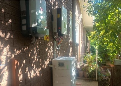

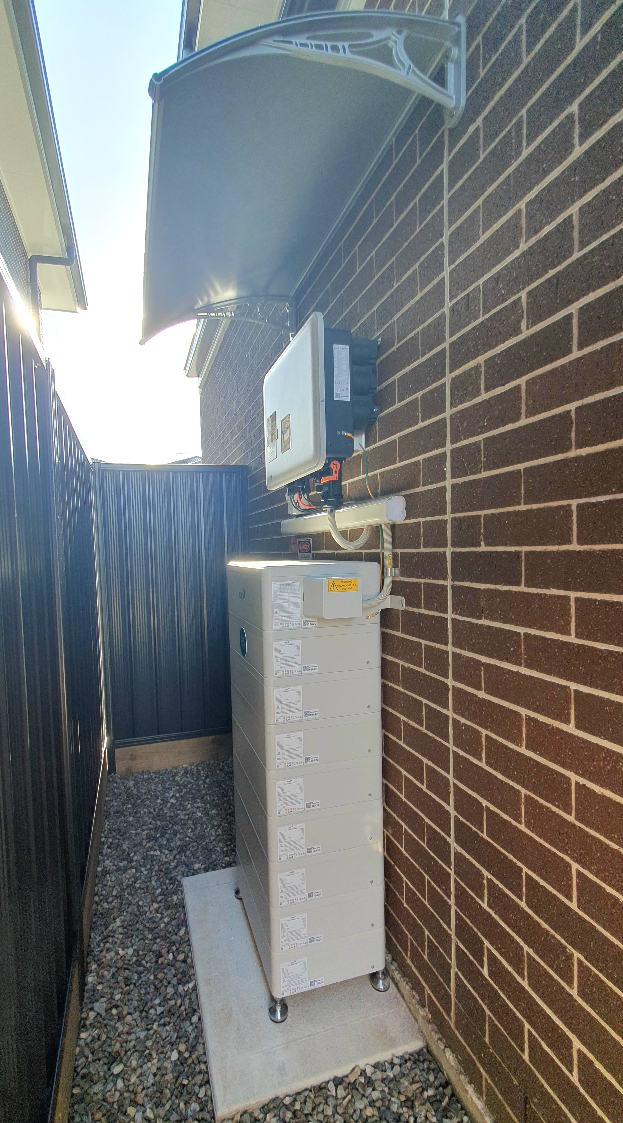

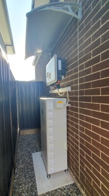

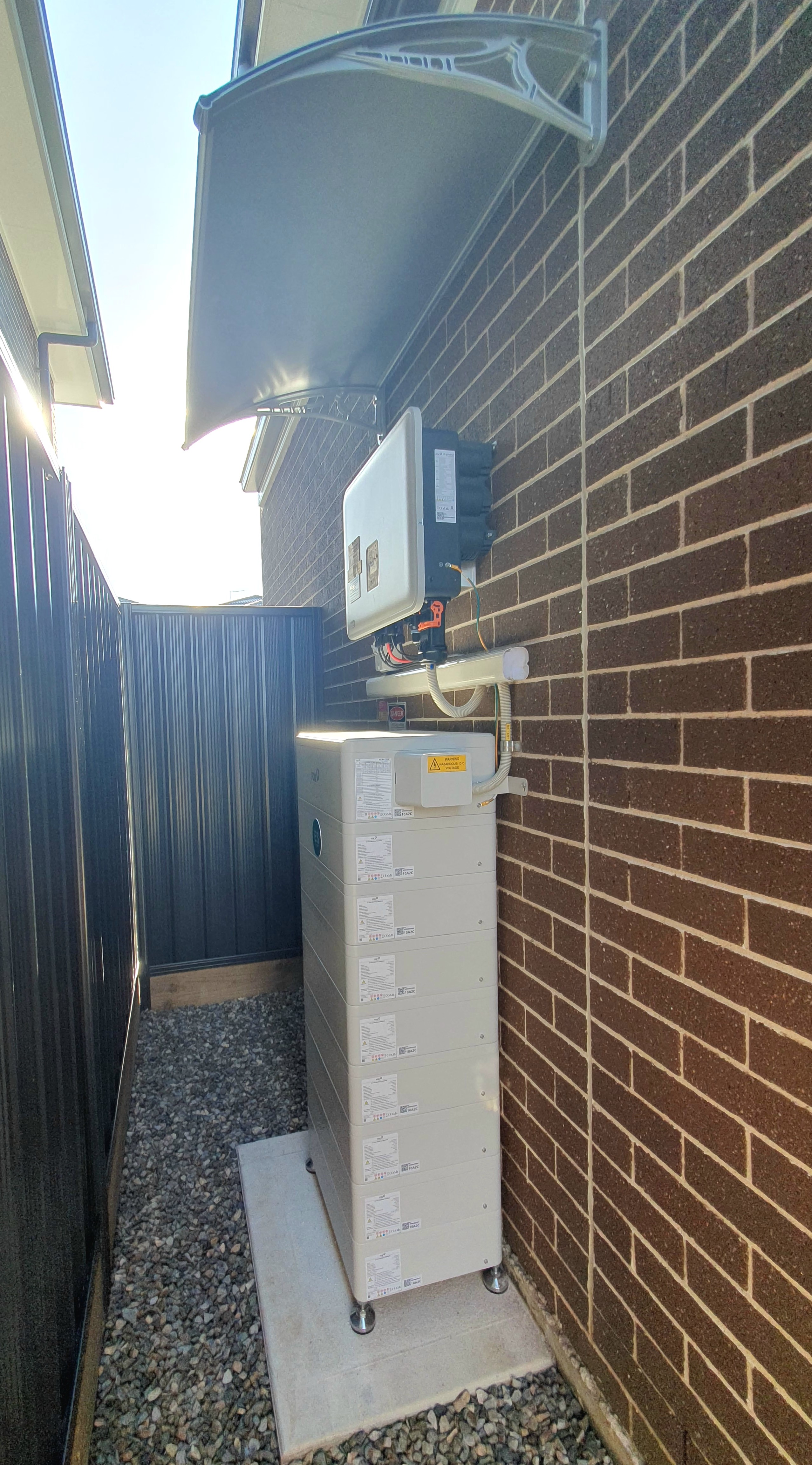

Here is my install
That's very neat, i wish mine looked as good.

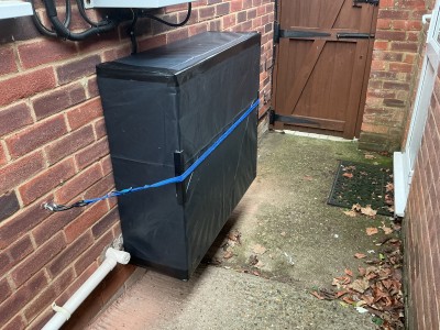

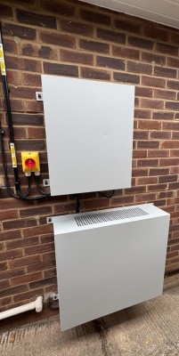

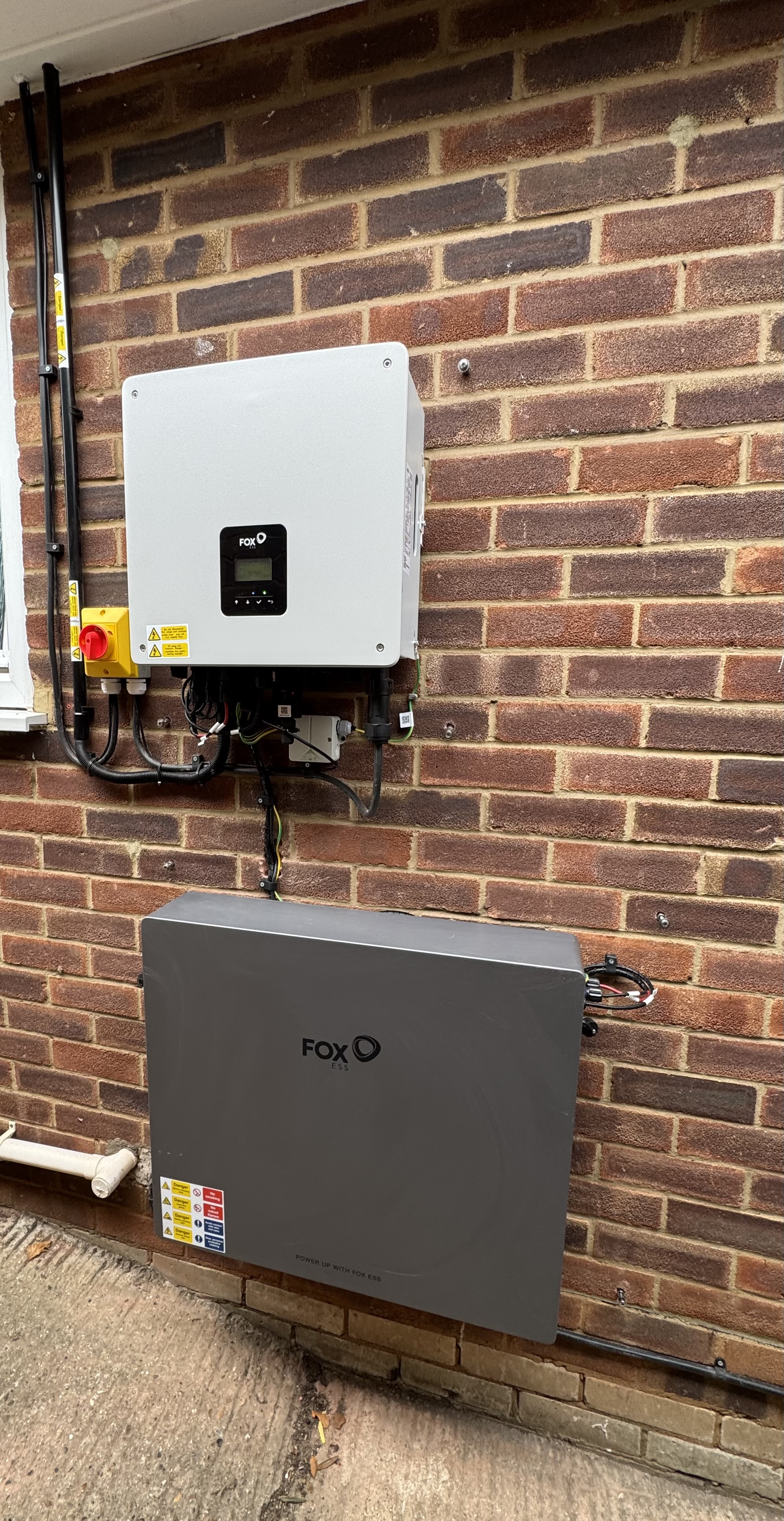

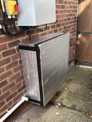

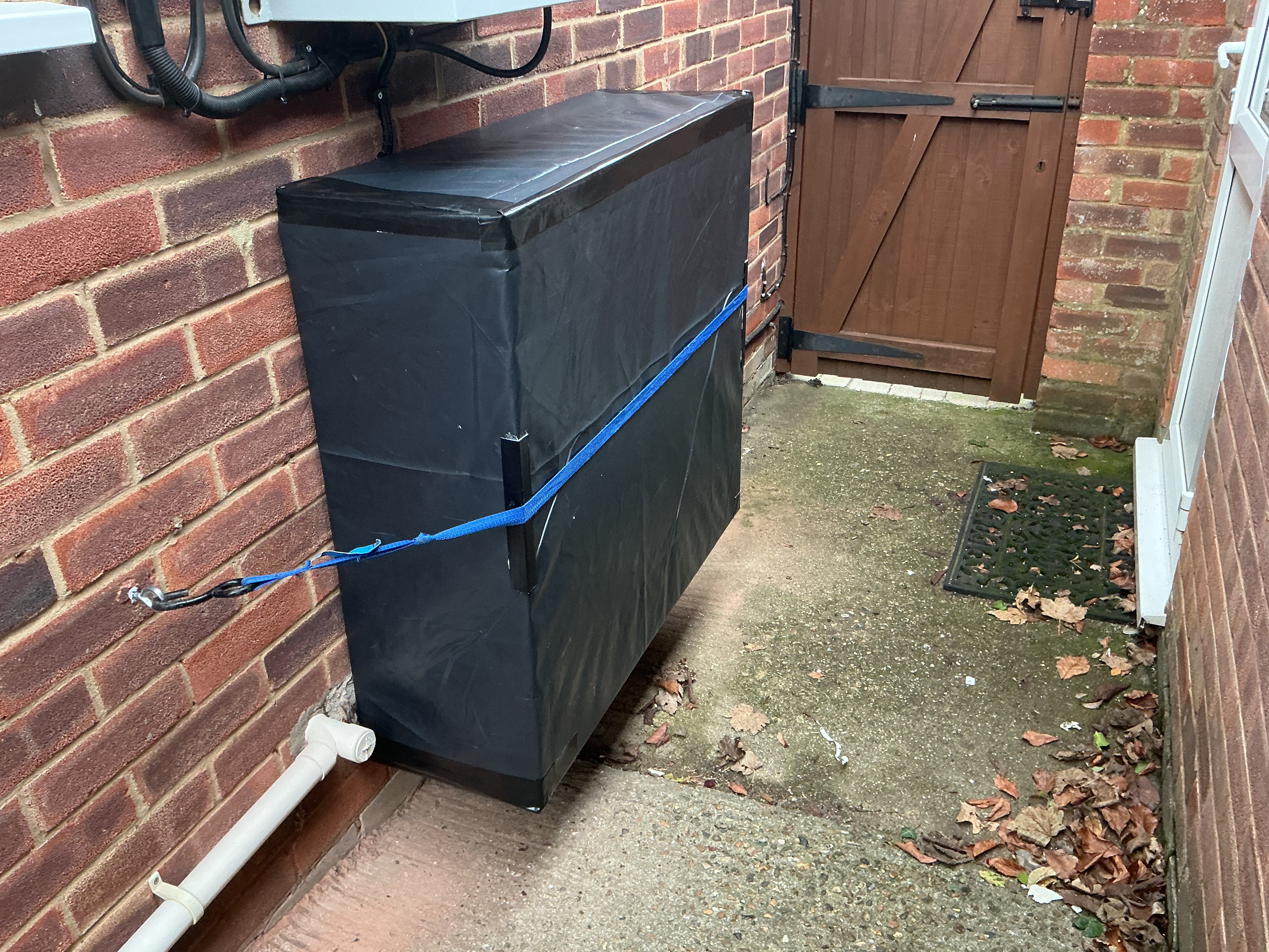

Comment from the UK, so no understanding of Aussie regs.
They are installed the same here, I’ve had made a cover for both Inverter and battery, protects from UV/heat etc and covers all cables around underside of inverter and connection side to battery, for the abysmal weather we receive for 9 months of the year in the UK, the battery is insulted in both the cover and the external cover with a total of 100mm insulation board, positive effect is it keeps it warm in winter and cool in summer.

Here's a pic of mine so you can see why i'm annoyed with the tardiness of the installation, i've just today sent another email to the installer, supplier, electrician, and certifiers asking for some advice on tidying it up, it's just a shambles as far as i'm concerned, un-protected wiring, poorly secured brackets, 'dodgy' earth connection..... once they get your money they just disappear, so annoying.

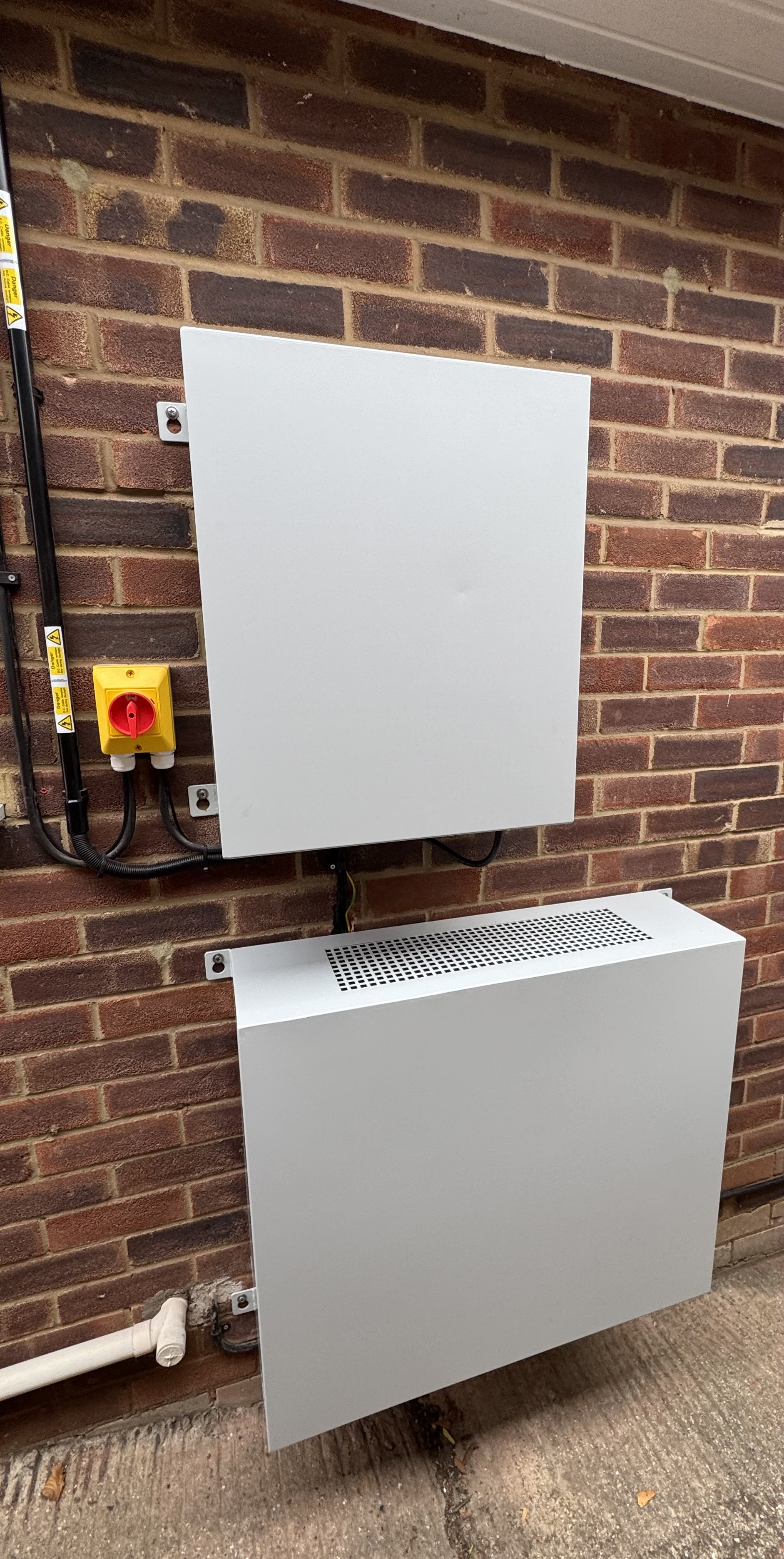

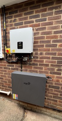

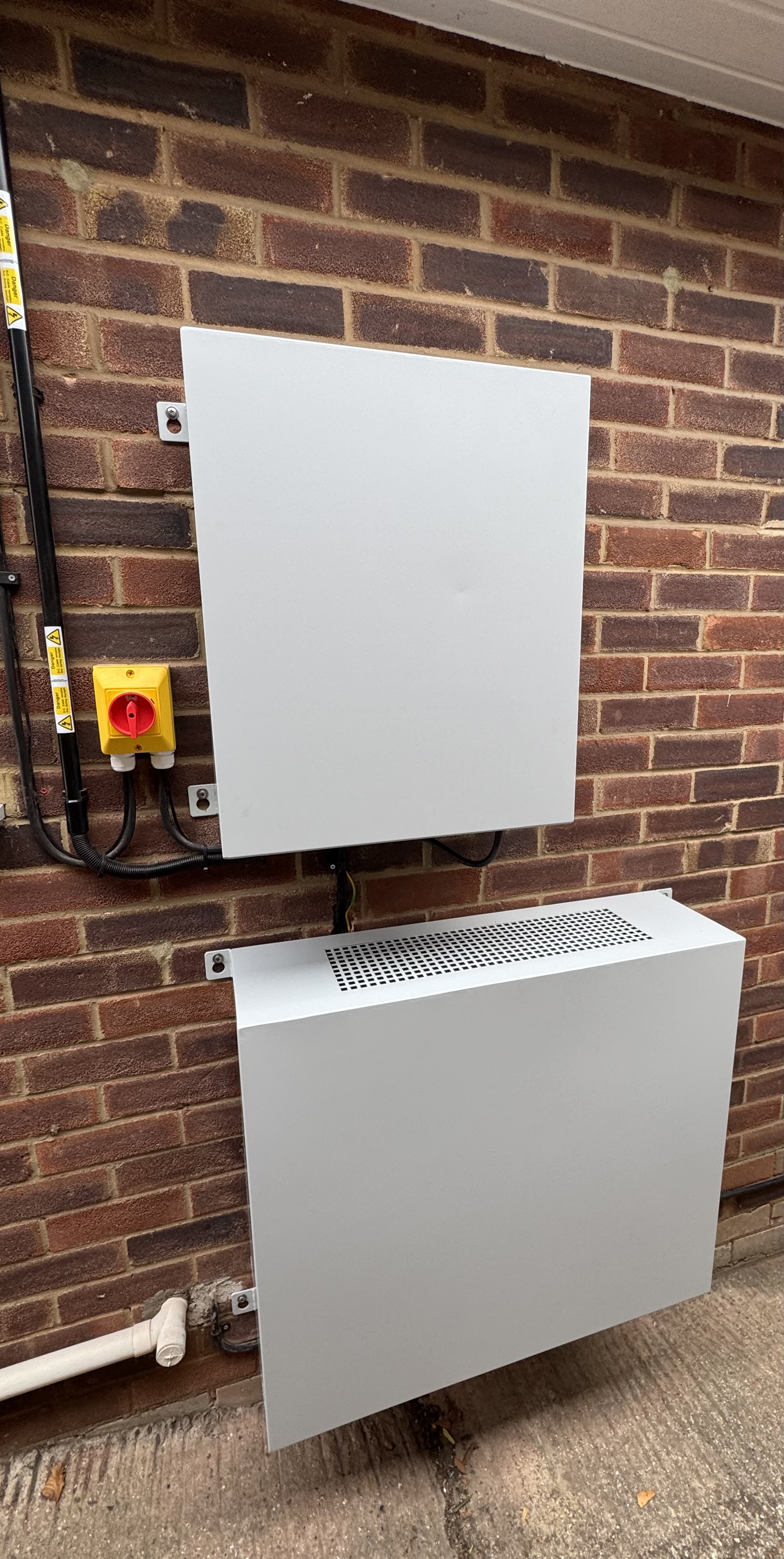

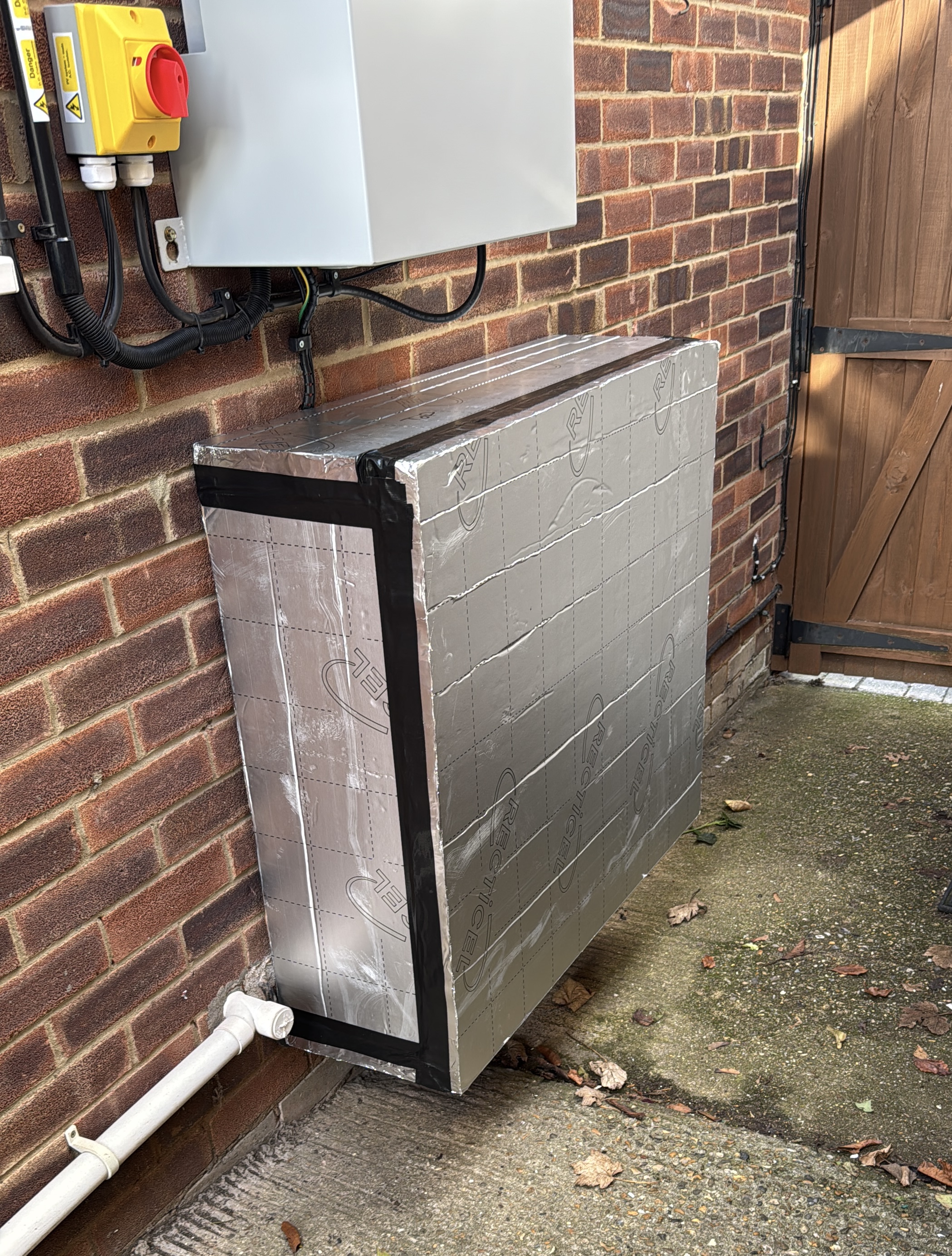

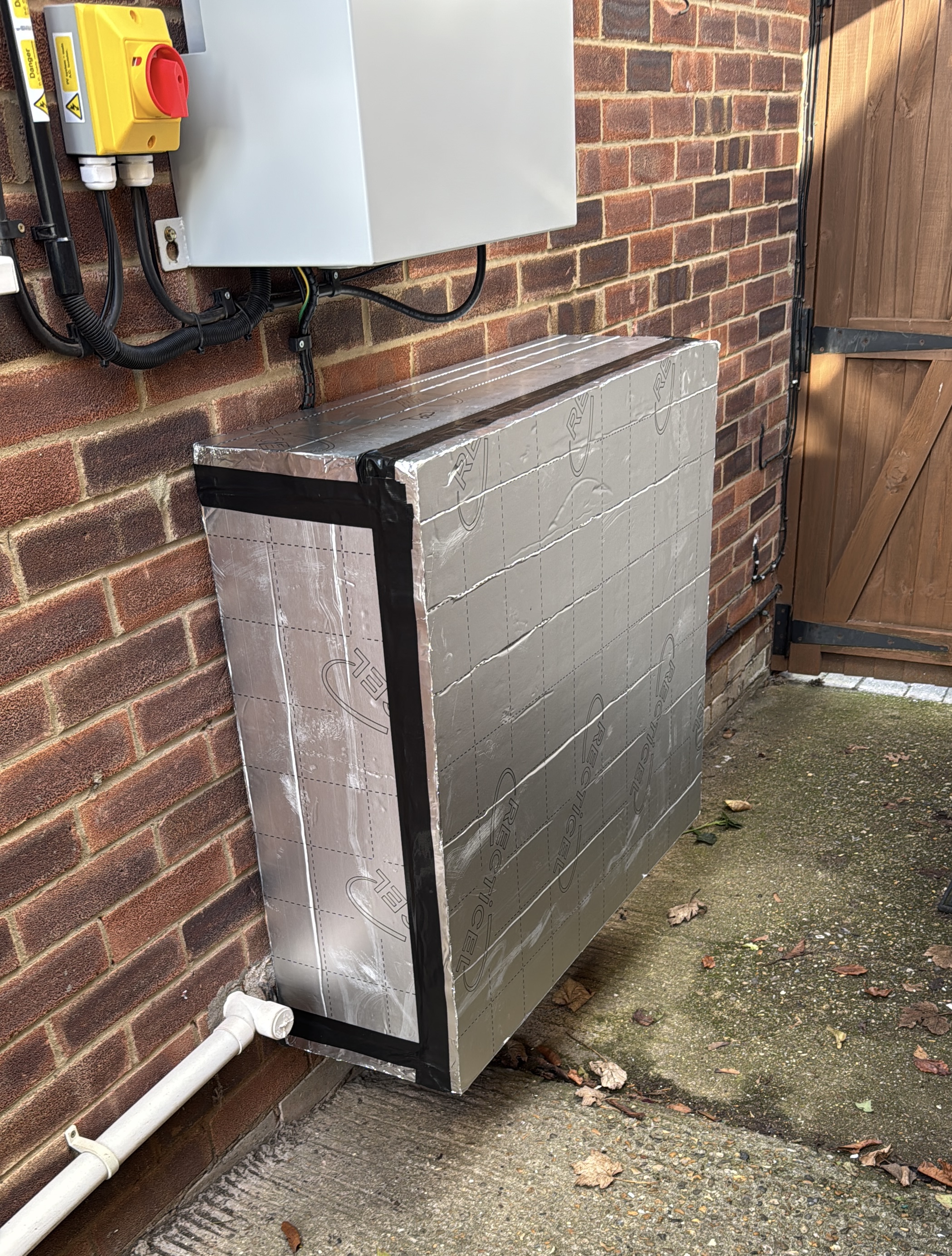

Morning Rose Man
Funny how going to the other side of the world standards can be similar, perhaps my installer emigrated 😄
I had some less than acceptable parts to the install that I could not be bothered to complain about, and resolved myself.
The worst being the earth cabling around the inverter, where the wiring was connected into a Wago that was pushed up behind the base of the inverter. The install is only as good as the installer no matter how good the kit is.
My wife was concerned by the exposed wiring and potential for small grandkids to go poking around.
Initially I looked at the small number of commercial offerings that were supplying covers and were not taken by them, so I designed my own and had a local fabricator make them up and powder coat them. That was last Sep/Oct, then the temps were dropping and the battery heater was kicking in, so insulated the metal cover internally, but as winter kicked in the battery temps were still dropping to sub 10C, so then made an insulted box out of 50mm Celotex to go over the metal cover and problem solved even on nights were external temps hit -10C a few times.
Image shows after I had sorted the earth wiring into a waterproof box, then with the covers on, and finally the external insulated box.

That's a very nice result, those covers are fantastic, you should be selling them.

CDubbs wrote: ↑Tue May 26, 2026 7:03 am Morning Rose Man
Initially I looked at the small number of commercial offerings that were supplying covers and were not taken by them, so I designed my own and had a local fabricator make them up and powder coat them. That was last Sep/Oct, then the temps were dropping and the battery heater was kicking in, so insulated the metal cover internally, but as winter kicked in the battery temps were still drooping sub 10C, so then made an insulted box out of 50mm Celotex to go over the metal cover and problem solved even on nights were external temps hit -10C a few times.
Image shows after I had sorted the earring wiring into a waterproof box, then with the covers on, and finally the external insulated box.
Nice job on the covers & insulation.....

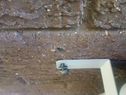

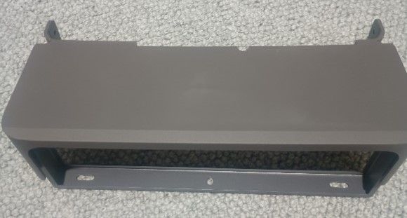

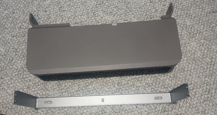

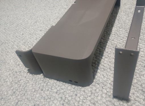

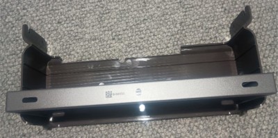

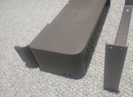

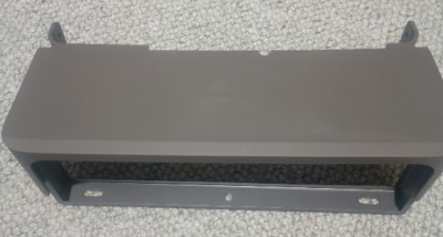

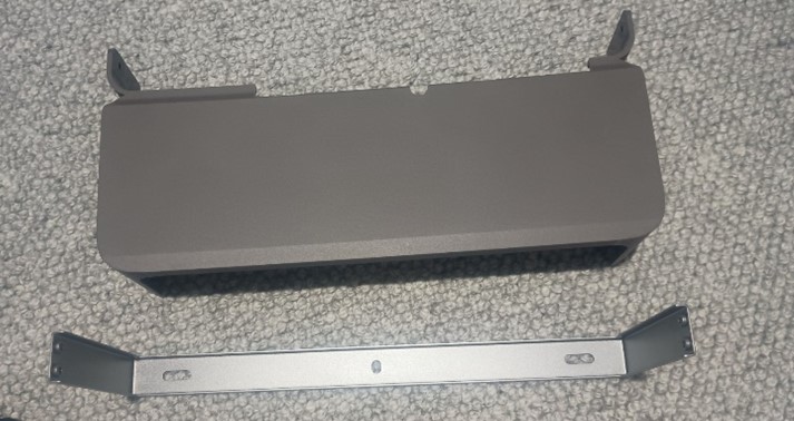

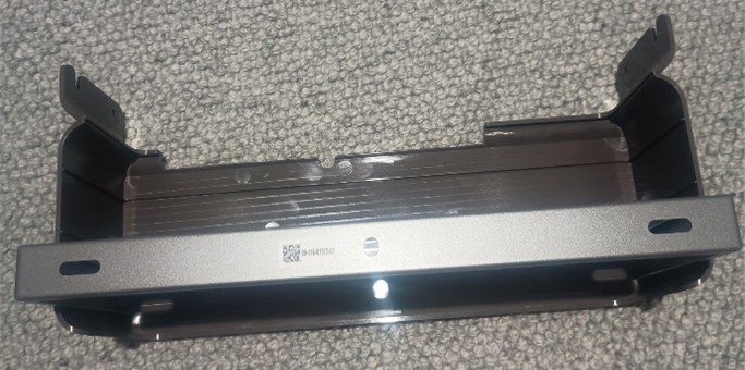

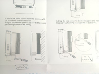

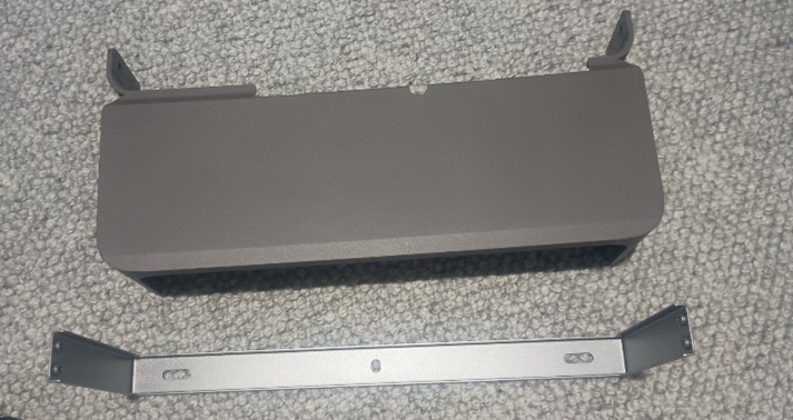

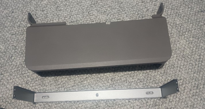

G'day Cdubbs, (i'm on about mechanical protection again!)...
so i sourced a very nice inverter cable cover but it raises another issue for me, apparently there are 2 ways to fit these covers depending on which inverter you have, the difference being some have manufactured fixing holes near the front edge of the inverter which allows for the cover to be simply put in place and secured with supplied bolts, and some don't have these holes and therefore you have to mount a full width bracket to the wall behind all your wiring and then the cover is attached using this bracket (see pics).
My inverter doesn't have those holes so i have to mount the bracket first which raises a concern for me poking around all the DC cables etc with the bracket and drilling holes to fix it to the wall. I'm ok with general house wiring but not so much when it comes to the inverter-battery wiring, and i guess my question would be do i just shut everything down, solar, inverter, battery, and the do what needs to be done?... would it be safe to do this?
(.maybe some would say contact your supplier/installer/electrician to do this and i would but they have just vanished!). Maybe i forget mounting the bracket and get some heavy-duty double-sided tape and mount it with that.
Any advice / suggestions would be appreciated.

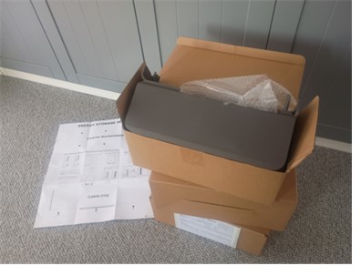

..i meant to say the cable covers were about $12.50 each and shipping was $40 so i thought about it and found out i could get 3 shipped for the same price, so i bought 3... so if anyone in Canberra is looking for one of these covers then I'll be putting them on Gumtree Canberra for around $30 each next week (this way we all save on the shipping costs), they can be collected from my place.
If anyone wants to buy direct then here's the link :
Accessory FOX ESS Inverter DC terminal protective cover for KH8/9.9/10
https://solarjuice.com.au/product/acces ... h8-9-9-10/
Interesting
When it was announced on the forum that Fox were going to sell working covers for the battery and inverter, I looked at my inverter H1G2, and wondered if they were going to modify the design to have tapped holes to mount the covers as per the pics at the time.
It was after that I decided to get complete covers fabricated.
Clearly if your inverter does not have tapped holes for mounting you need to mount externally.
So the option given just means drilling some holes in the wall and mounting as per instructions and if your not too confident with your drill stability either power down or get a mate to do it who has a steady hand 👍🏻

CDubbs wrote: ↑Mon May 25, 2026 10:36 am Comment from the UK, so no understanding of Aussie regs.
Have you got photos, I just had mine installed (in UK) and also came without covers!
Aiko Neostar 3S 490W panels x 16
Fox KH8 8kw hybrid inverter
They are near the top of this thread

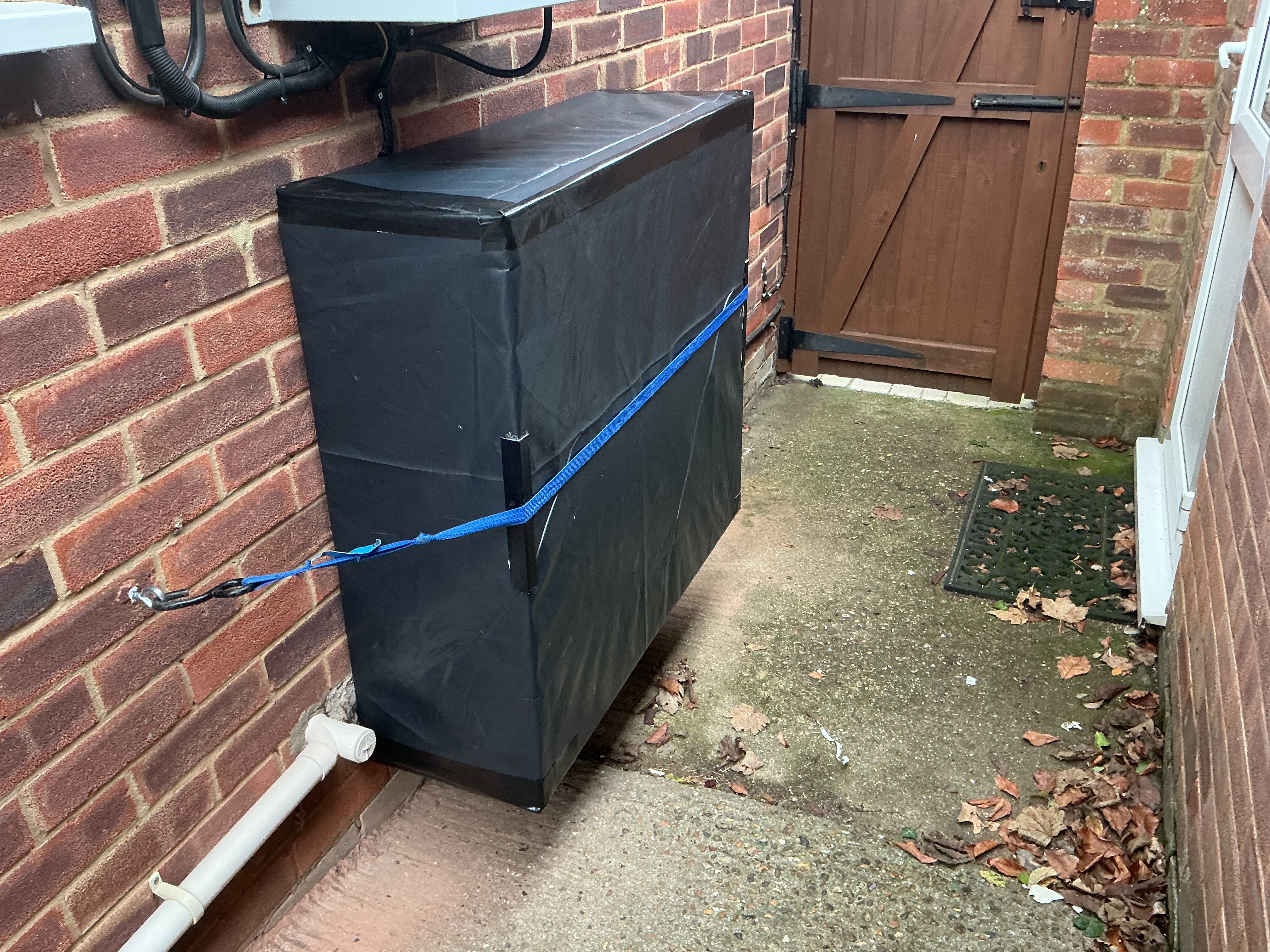

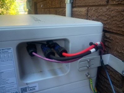

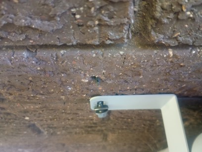

I got my installed on early March this year and I have the cover on the battery cable but not on the inverter. I just ordered one from Fox Ess Cloud app but I doubt it will fit given my current install. Any idea?
You should be fine, from what I can see your inverter has the pre-drilled mounting holes so you’ll be able to just push the cover up into place then put the 2 screws in each side. The instructions that come in the box shows 2 mounting options and yours will be the 2nd option.
That's a really clean installation :D.
Did you consider the Fox recommended air gap around the battery when designing this? Or inlet/outlet vents to prevent potential overheating? Appreciate the air gap recommendation always has an element of a safety factor included. What have the internal cell temperatures done when being charged heavily overnight or charging in the day when the sun is producing a lot of solar?
Fox do talk about this air gap as being mandatory for them to honour the battery's warranty.
