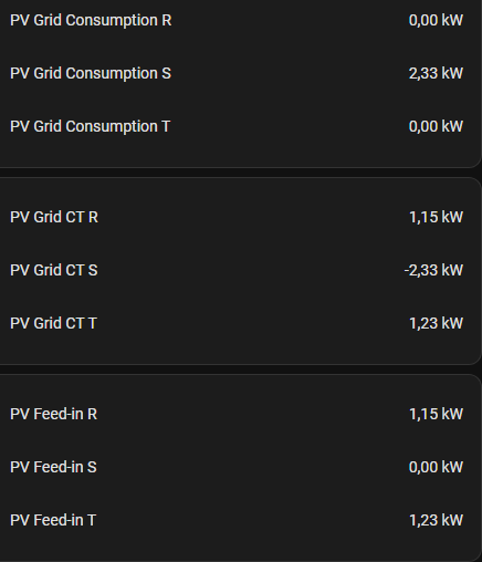

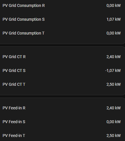

My values with car connected and Export Control = 60000kWh
My car it connectet to phase "S" only and takes 3,5kW. 2.5kW comes from the Batterie and the remainig 1kW from the grid. Because the batterie is discharged on "S" the Inverter switch also "R" and "T" to discharge.
The result is that I take 1kW from the grid while on the other hand feeding in 5kW.

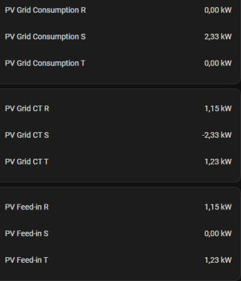

So I assumed setting Export Control" = 0 will solve this - which doesnt:
So as you can see it got worse.
Also I'm wondering about "CT S" which - for my understanding should be positiv instead of negativ.
Any insights on this?
