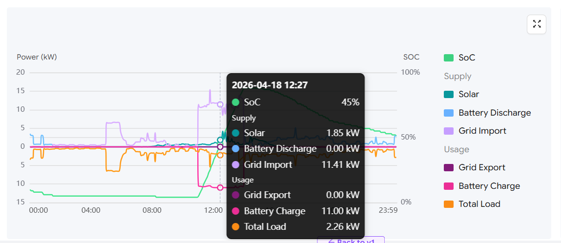

During forced charge I have previously been able to charge at 11kW. Maximun of 10kW from grid and the rest from PV. Today it is only charging at 8.5kW.
Anyone have any clues wny?

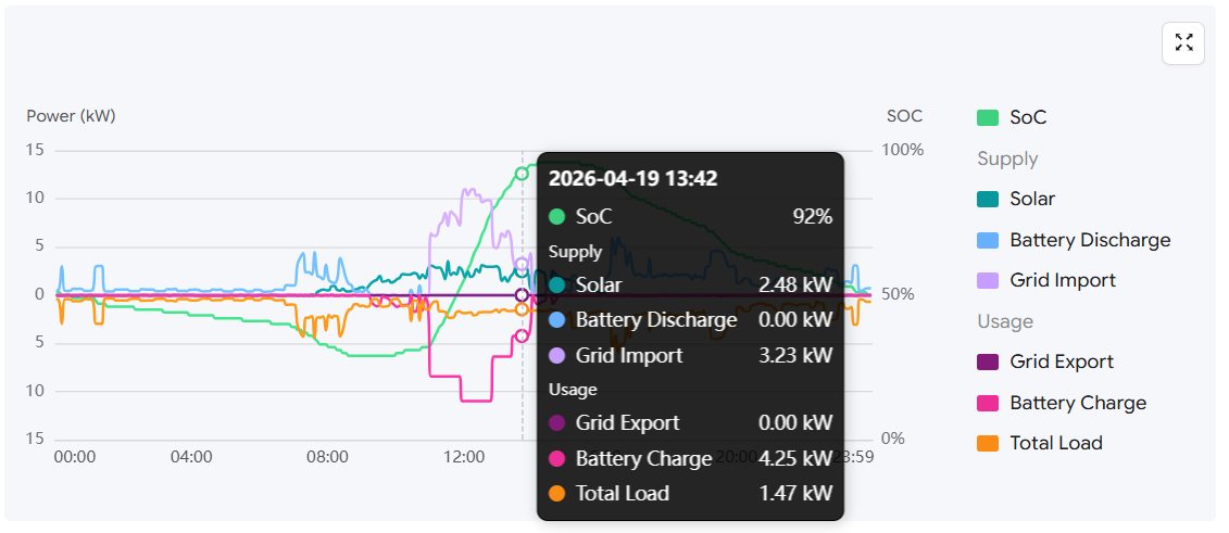

Yesterday it was working as expected.

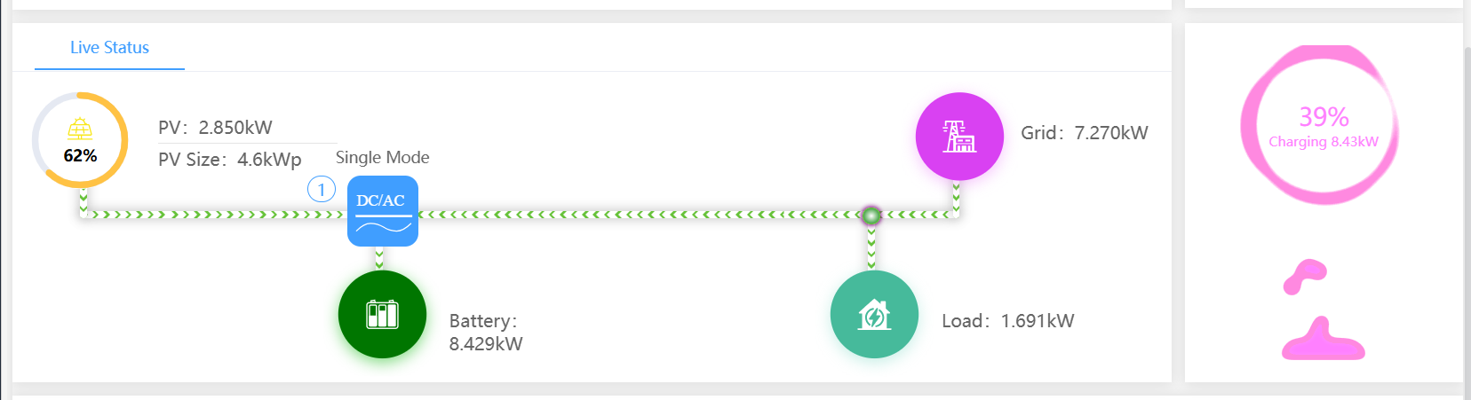

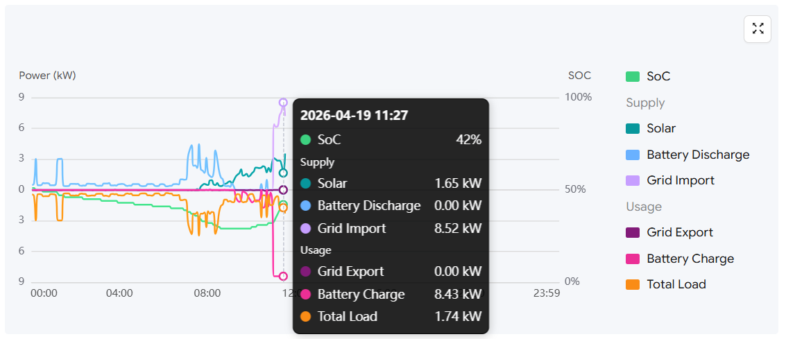

However today the charging is being capped at just below 8.5kW.

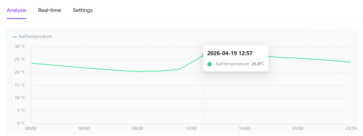

I have checked all of my settings and nothing has changed from the previous day. Does the battery provide a reading of it's temperature? The outside temperature seemed similar to the previous day so not sure that would explain it either. There now seems to be a set power limit based on the SOC.
At 11am when the forced charged period started the SOC was at 32% and the charging power was being throttled at around 8.43kW. At 11:52 the SOC reached 52% and the charging power stepped up to 11kW. At 12:52 the SOC reached 80% and the charging power was throttled at 6.38kW. At 13:32 the SOC reached 90% and the charging power was throttled at 4.25kW.

I've colded days previously and have not seen this throttling before. I'll check again today to see if this is now the way the battery charges.

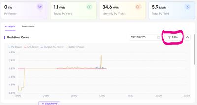

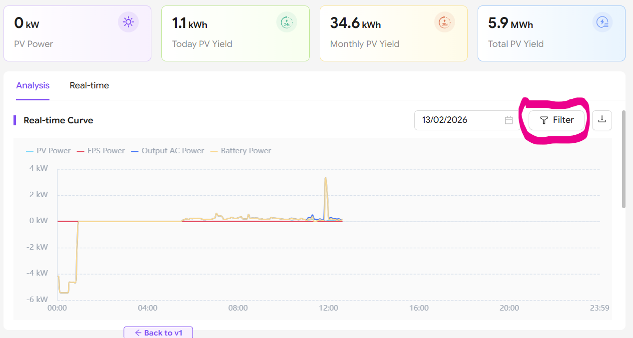

Look for your filter, and then find your battery cell temp min
Re: Not Charging at expected rate
MaterialBarracuda48 wrote: Sun Apr 19, 2026 11:00 pm Look for your filter, and then find your battery cell temp min
Thanks for the hint.
At 11am the battery temperature was 21.3C and steadily increased during the charging period so according the post from @Dave Foster would not expect any throttling of the charing rate during that time.
There does not seem to be any correlation to temperature and looks suspiciously like the chargng rate is now adjusting with the SOC (50%, 80%, 90%, 95%). I'll monitor over the next few days.
