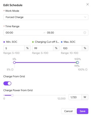

Re: New EVO 10-5-H only charging at 1.06kW
The only setting that looks odd is "Min. SOC" - it's the minimum level the battery is allowed to reach for it to stay "on grid", which I understood as the lowest level it will discharge at. Seems irrelevant when you're trying to charge, but it might be worth changing... These settings work for me running on Version_Master 0.23:
I’ve deleted the old schedule and copied those settings to see if that helps. Ticket in with Fox either way.
Fingers crossed! :)
