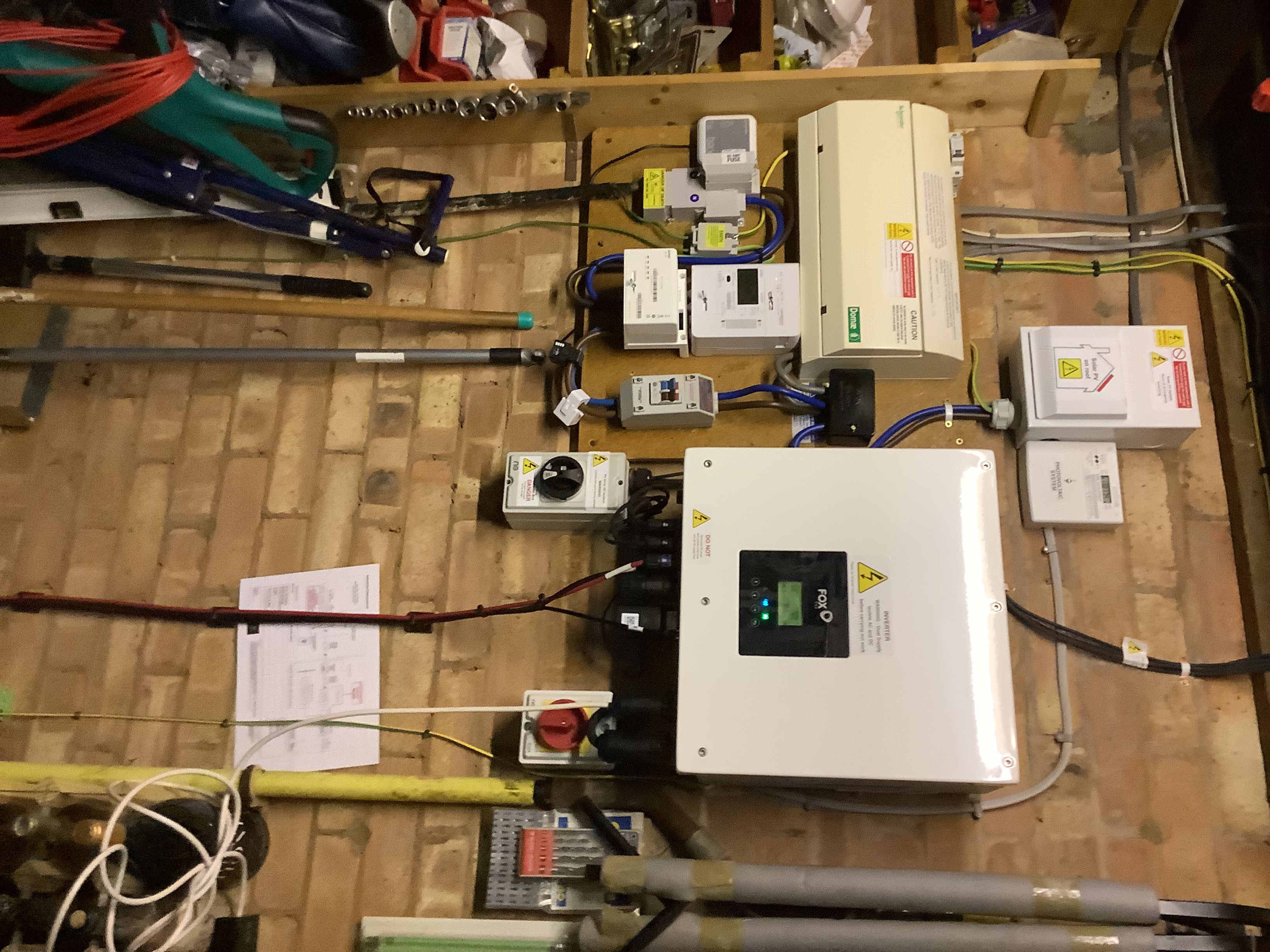

It might be a good idea to post a picture of your electric meter box area zoomed out, so that we could look at wiring.
If you have the correct Henley blocks already fitted (to split the EV load before house load) then it could be a 2 min task to simply move a CT clamp and problem is fixed.
Another cheap way, is to fit a 2nd CT clamp on the wire going to the EV charger, in REVERSE orientation, and wired to the inverter main CT wires, so that it deducts the load and it become 'invisible' to the inverter load.

You asked for a picture of all of the components of my installation and this is attached.
The inverter is an H1-6.0-E
Battery is ECS2900, just a master and slave.
EV charger is a Zappi v2 and there is also a Harvi
When I spoke to the installers about this issue they suggested that the solution would be in the configuration of the Zappi so I raised a ticket with Myenergi but have received no response. Everything that I have read in the meantime suggests that it is actually about dynamic configuration of the inverter/battery using an app like HA unless the simple CT clamp solution that you alluded to is possible.

How does the Zappi get power?
Is it coming off your Consumer Unit?
Re: EV Smart Tariff Help
Yes that seems to be the case. Two cables from the original consumer unit (plastic) to a small secondary metal consumer unit and from there a cable out to the Zappi.
