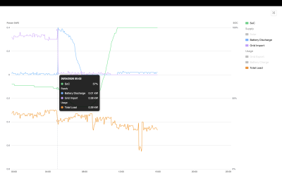

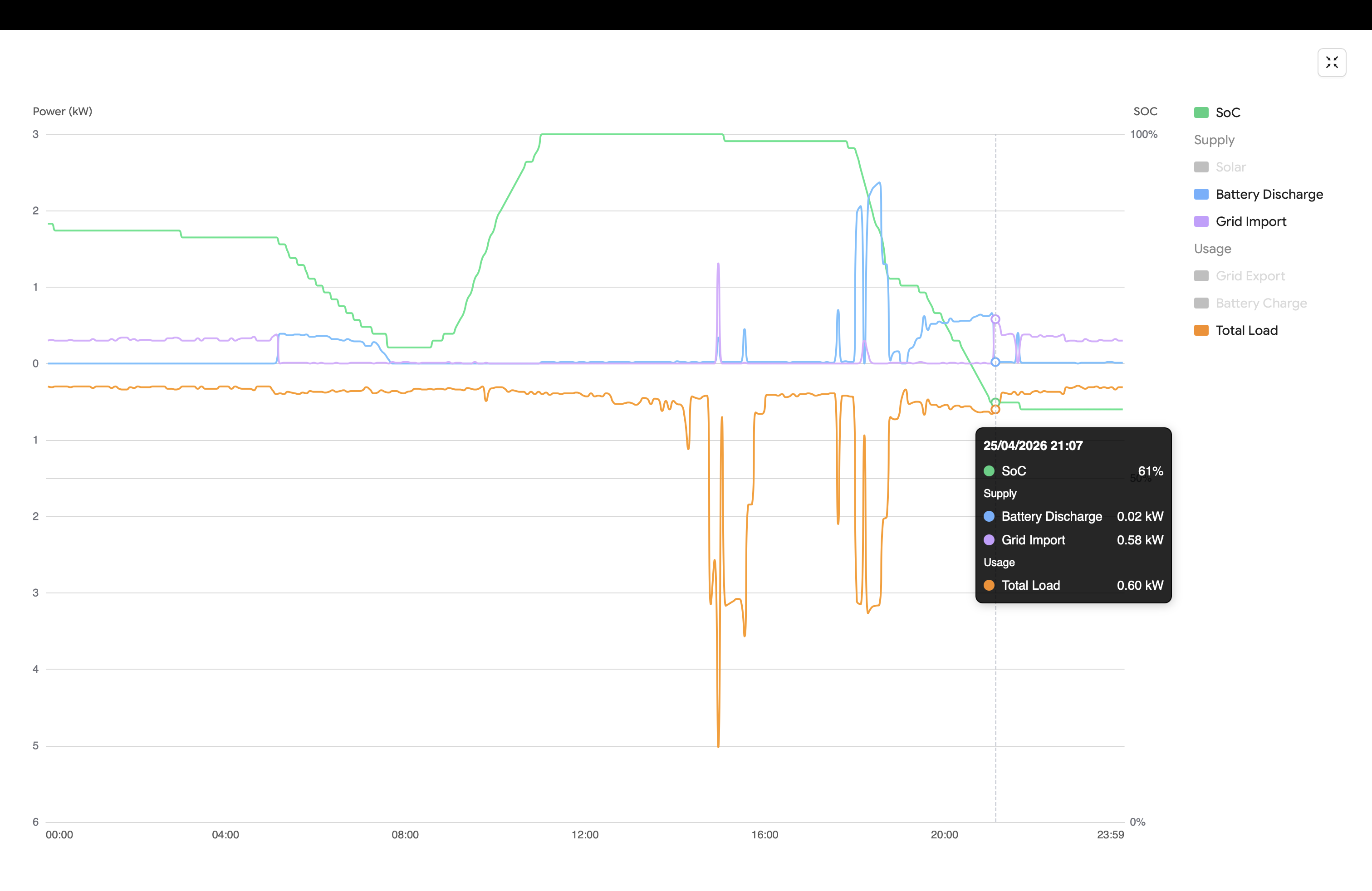

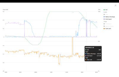

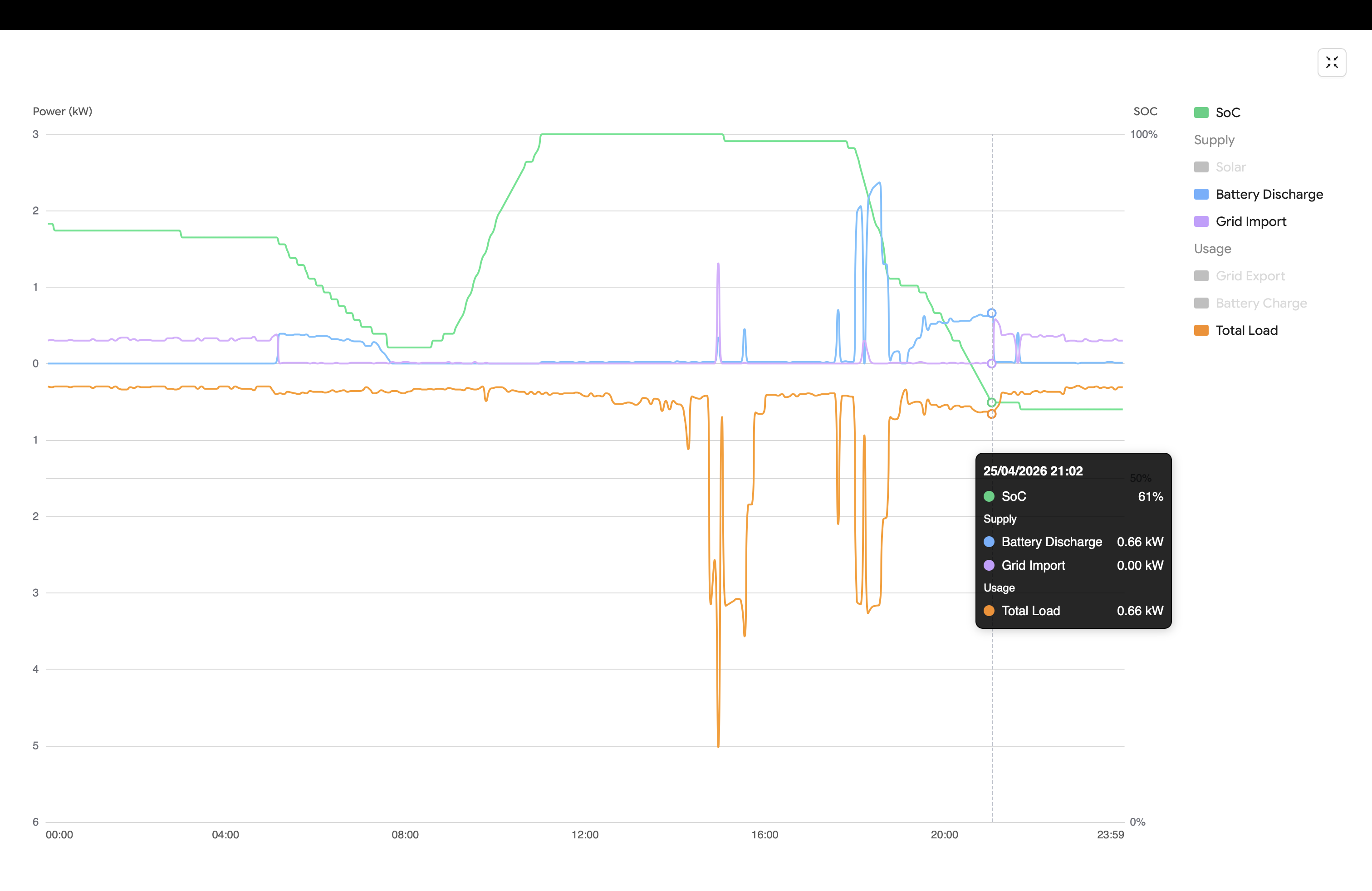

I have a new install of:
9x 475W AIKO panels
FoxESS H1 3.68kW Inverter
FoxESS EP6 5.7kW battery

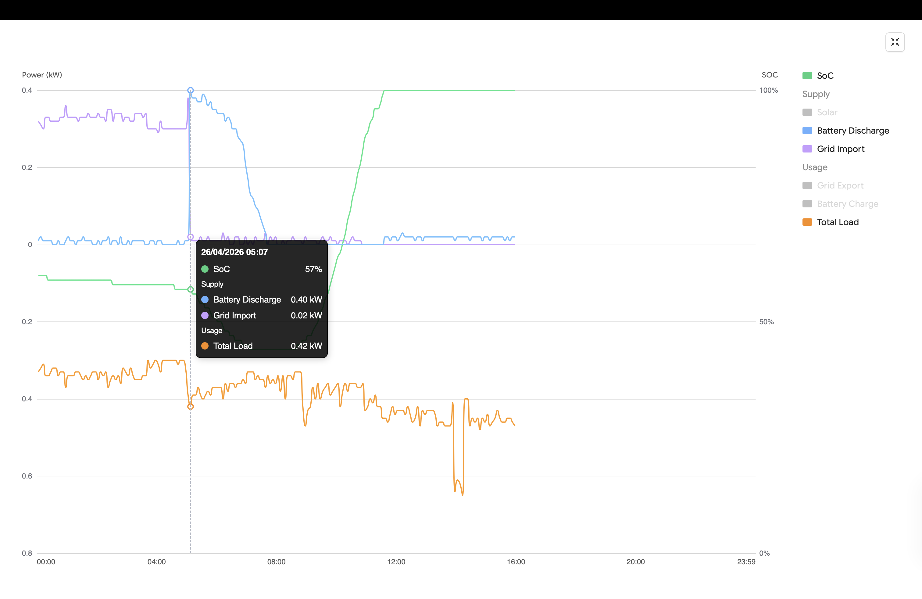

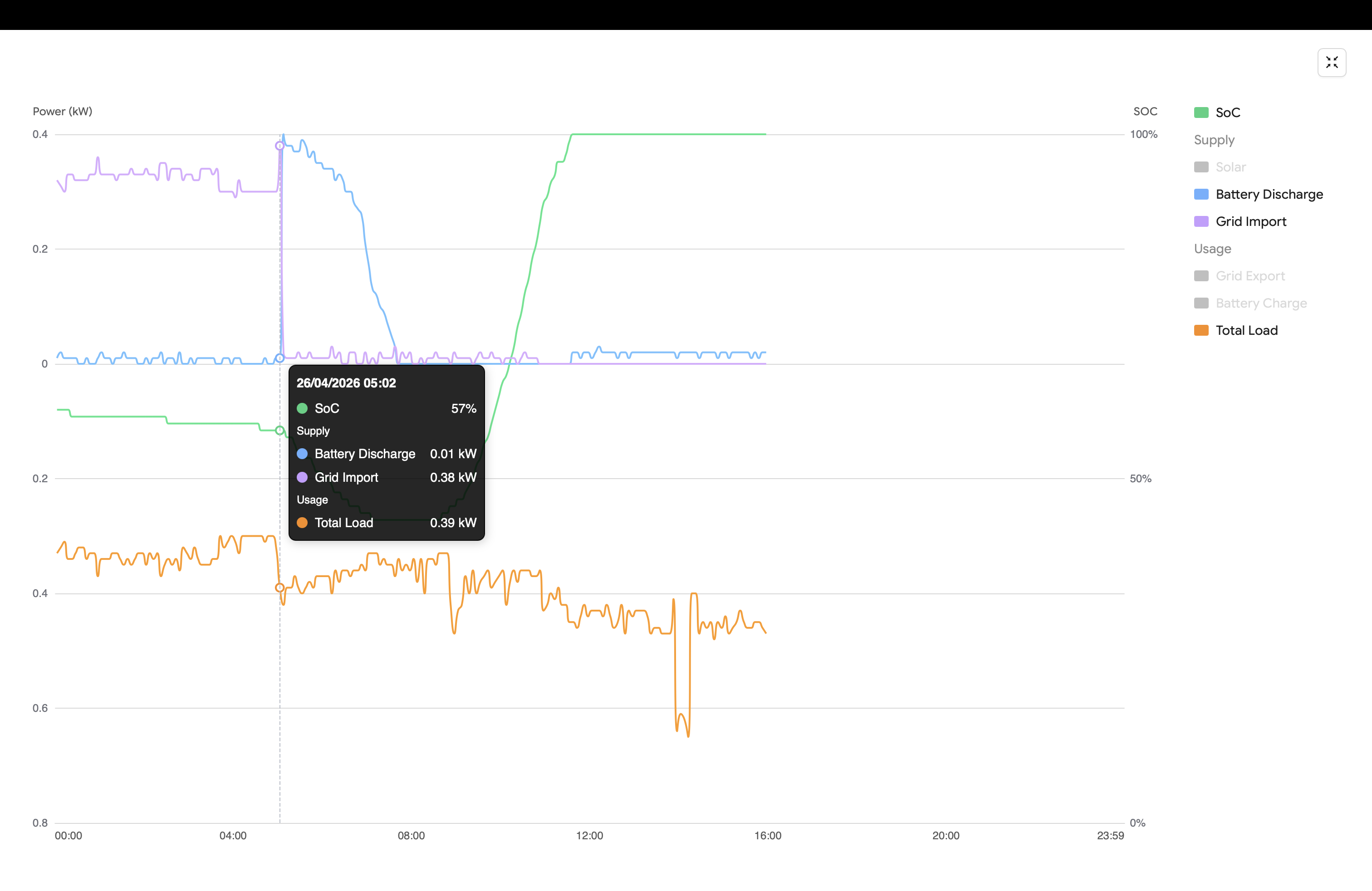

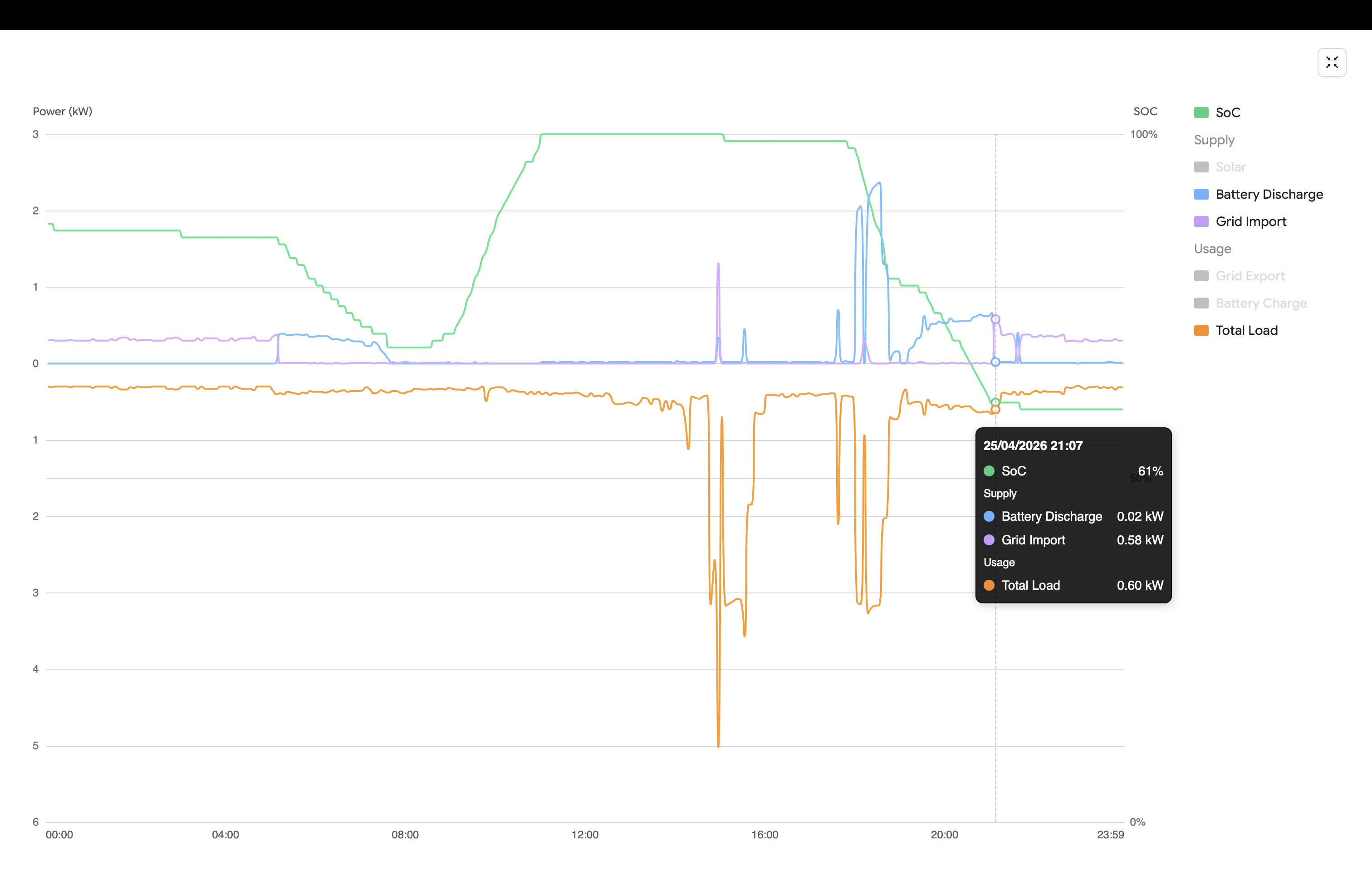

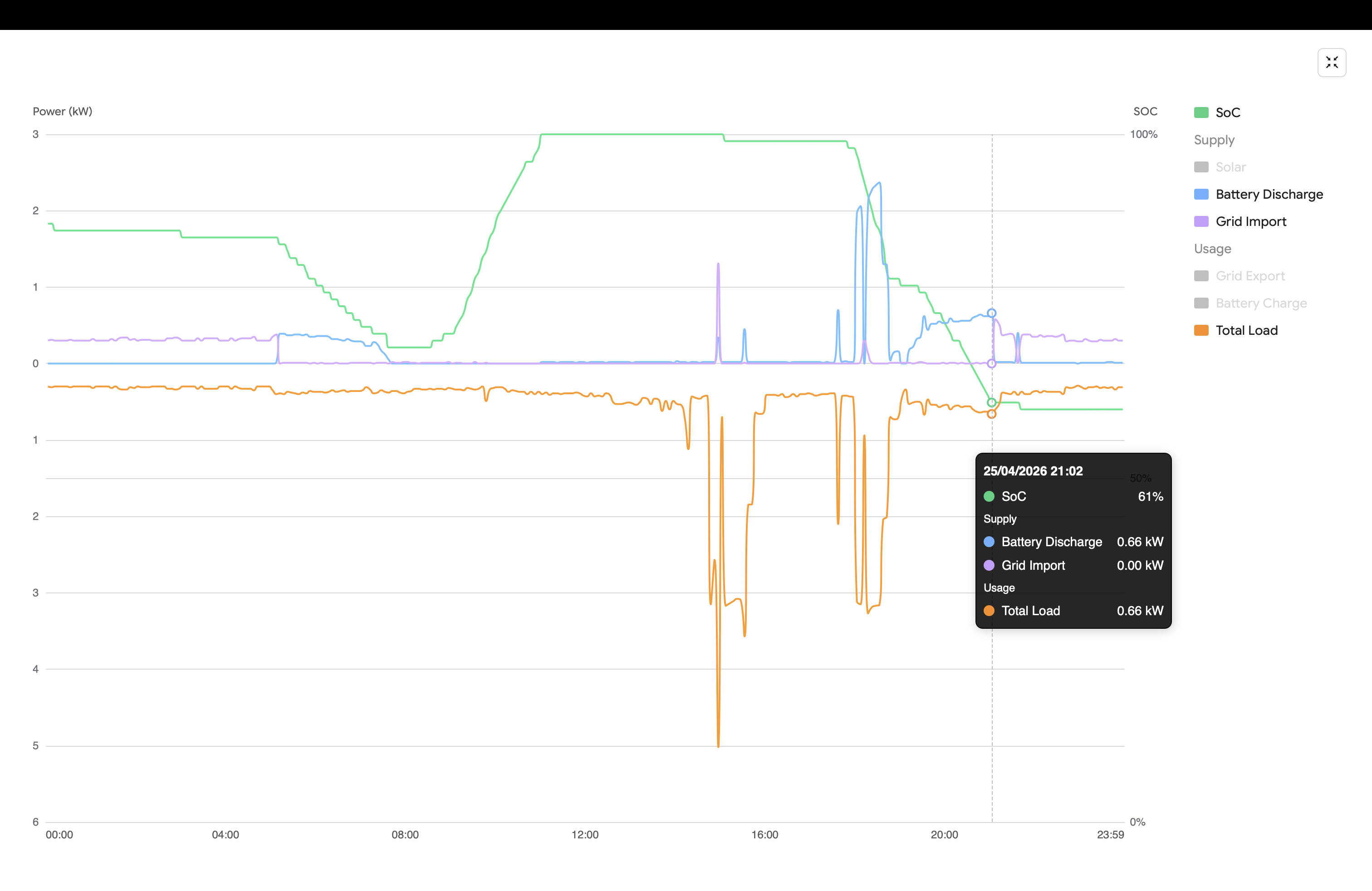

The panels are generating ok and are supplying enough power to supply the house between 0900 and 1900 and then the battery starts supplying.

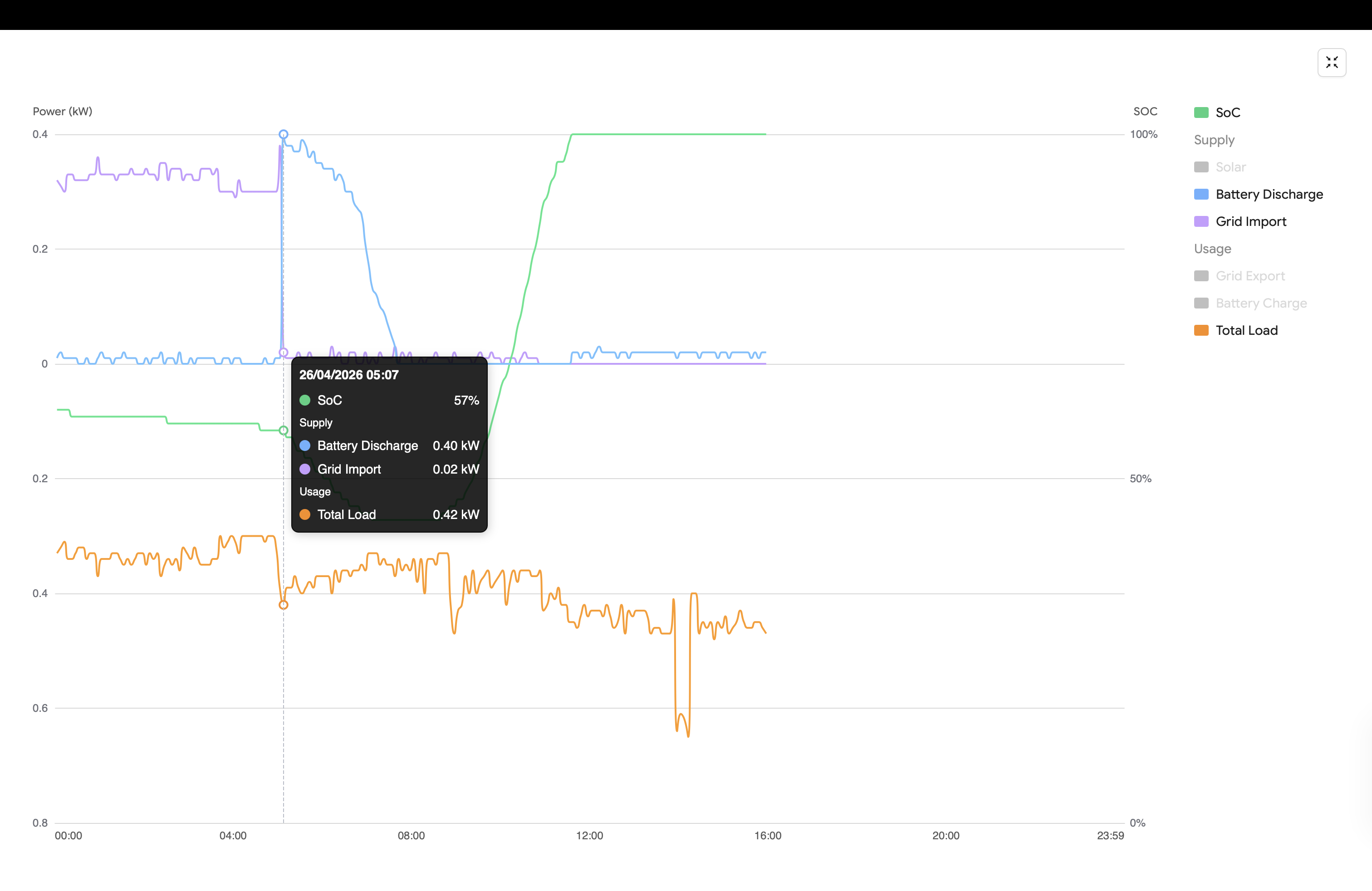

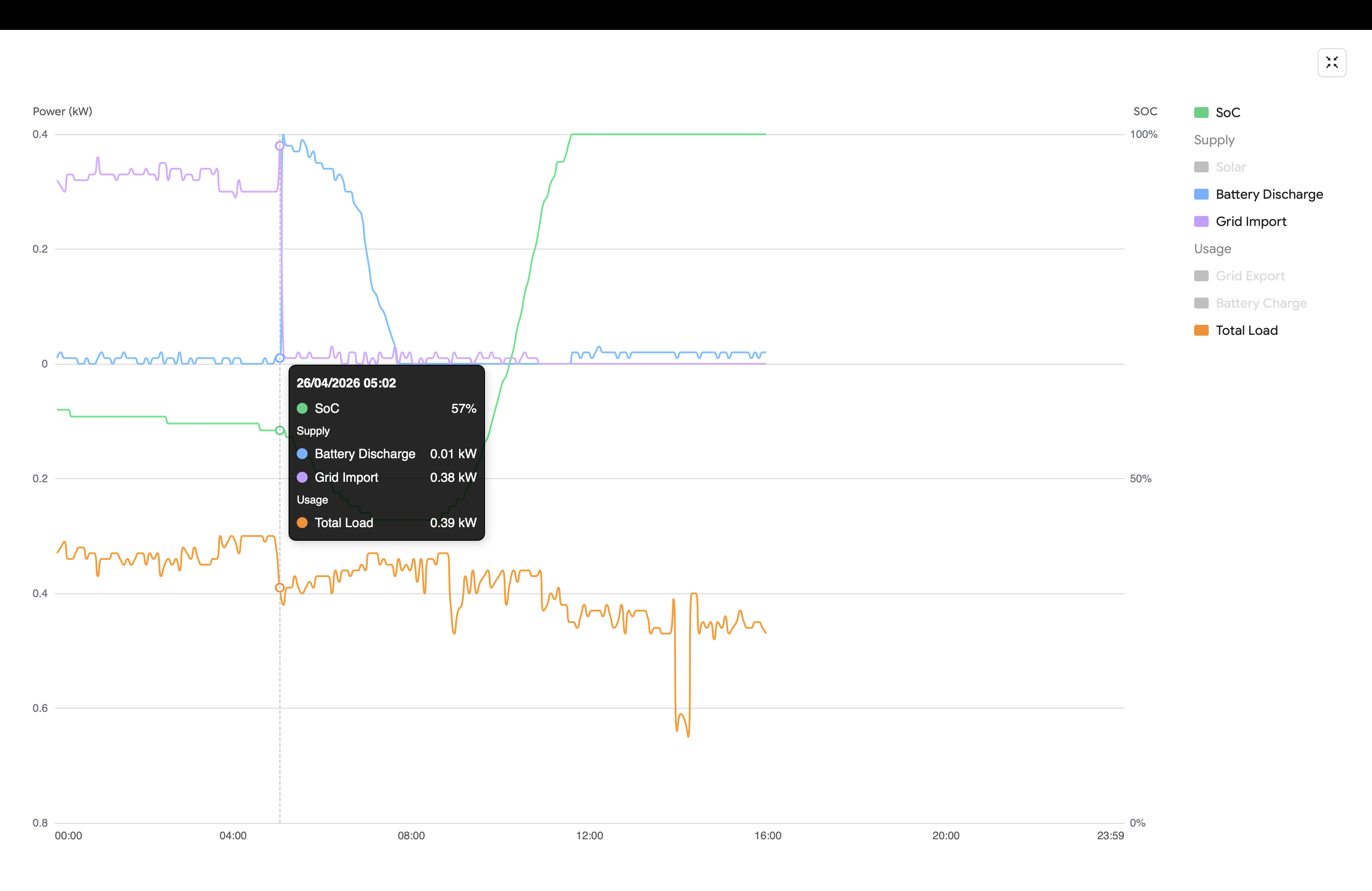

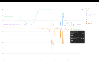

Between 2100 and 0500 everyday it reverts to pulling from the grid and then goes back to the battery at just after 5am and then starts charging at around 0900 when there's enough surplus from the solar.

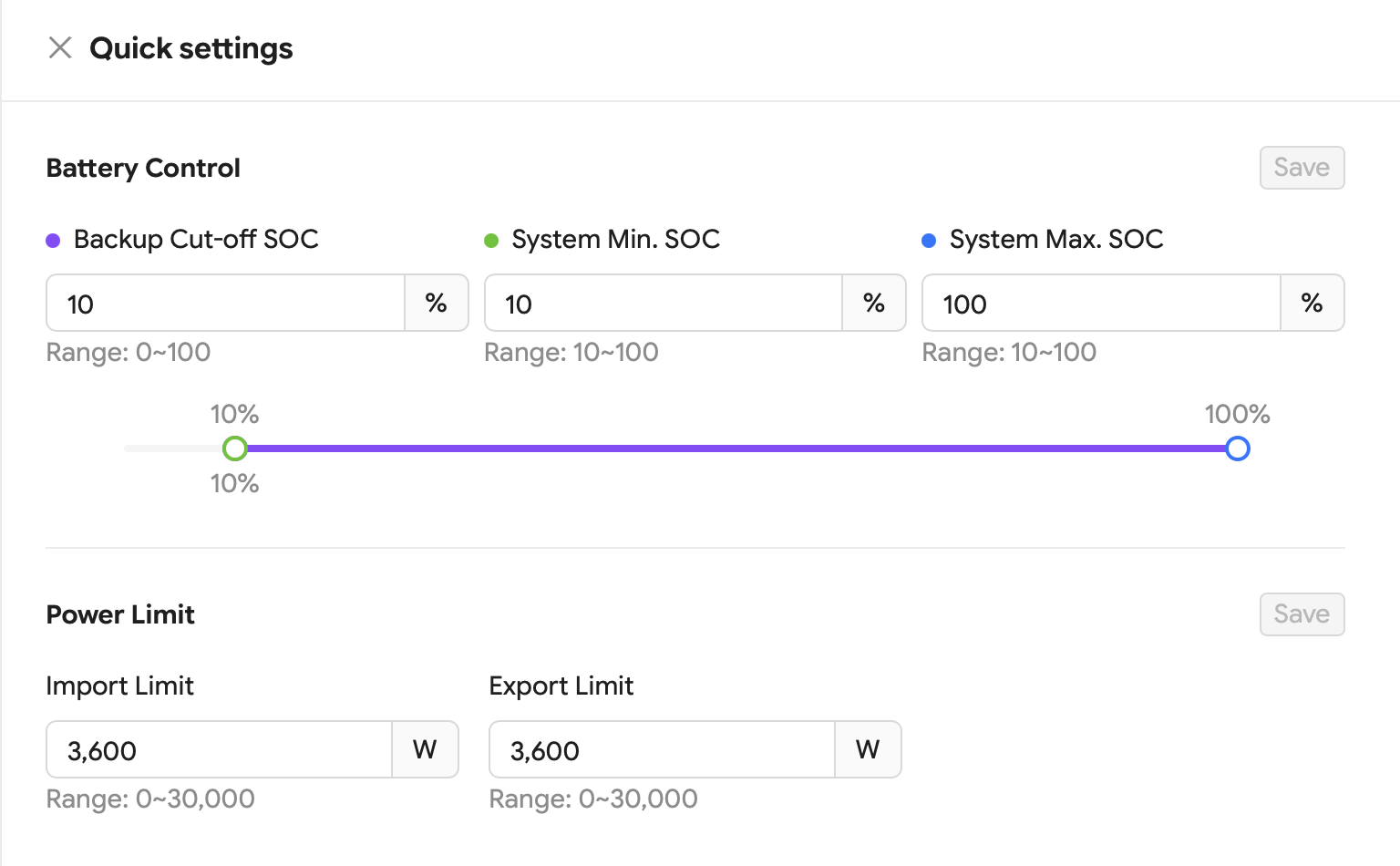

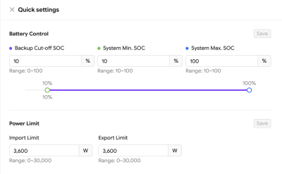

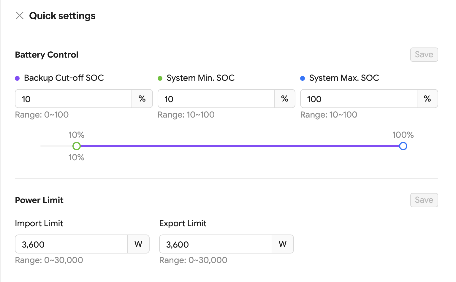

Can't find anything in the settings that has an exclusion period for 'self use' The mode is just set to self use and the battery min/max SoC is set to 10% and 100%
Seems strange that even when the battery SoC is at 80% it still stops using the battery and draws from the grid.
Can I set the system to use solar first, then battery until discharged and then pull from grid? When I read up on 'self use' that was pretty much the description.
Any idea why it's ignoring this between 2100 > 0500?

Given that this seems to happen each day from 21:00 to 05:00, grid draw despite SoC being above 10%... suggests that there is a schedule running that it holding the power back.
Have you got some energy graphs?

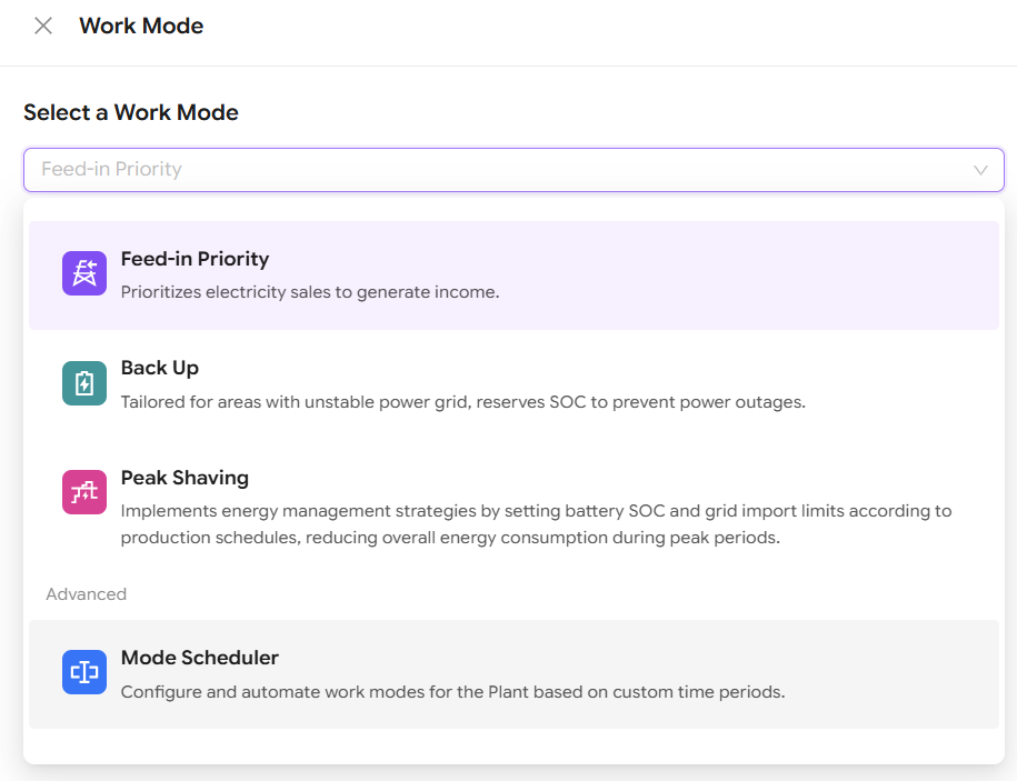

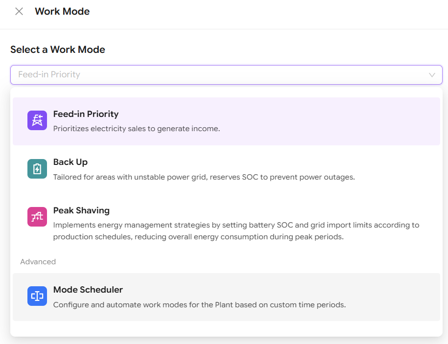

Work mode area, you may have to get to the Advanced section

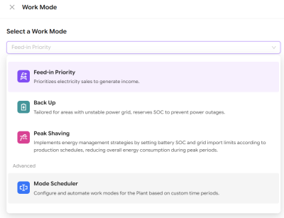

Re: "Self Use" is not using battery at specific times

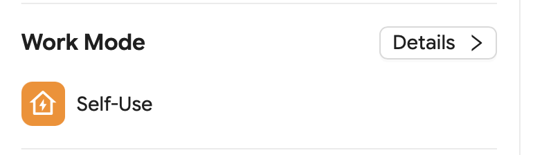

I've been using the web interface in preference to the app since it was installed.

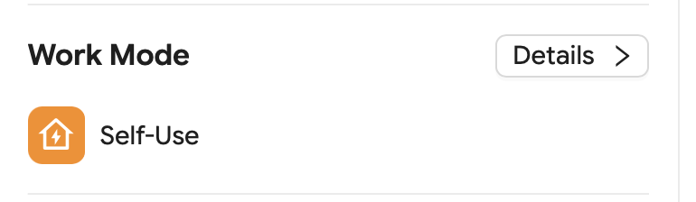

Work mode is set to "Self Use" but there are no advanced settings or options for that, it is just select and save for that mode (unless I've missed how to turn advanced options on?)

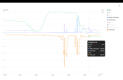

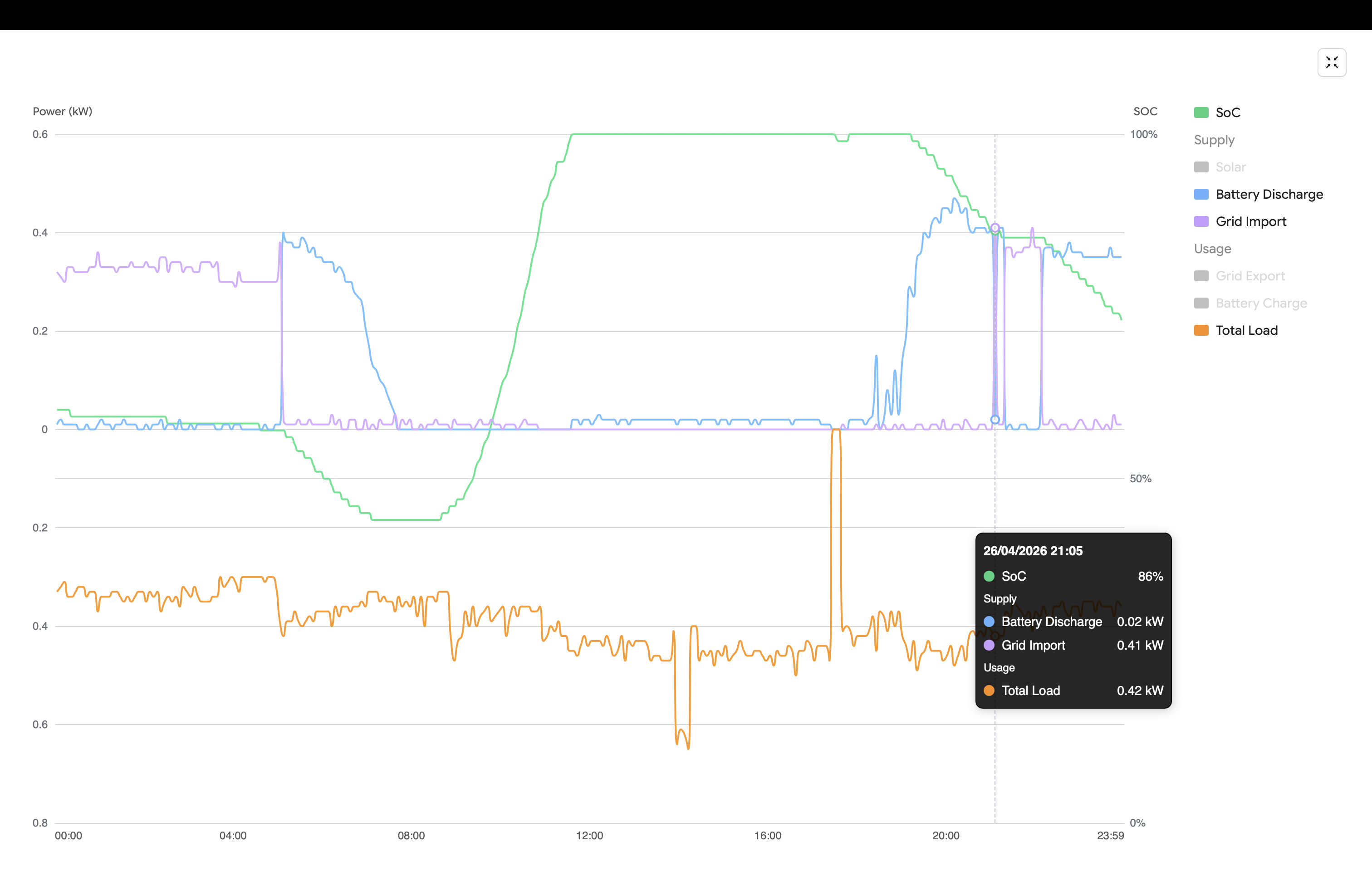

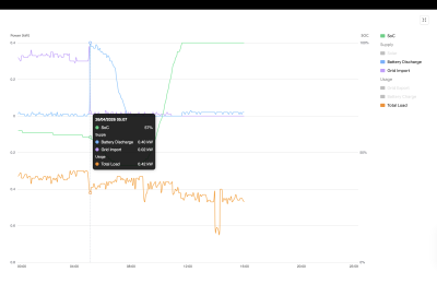

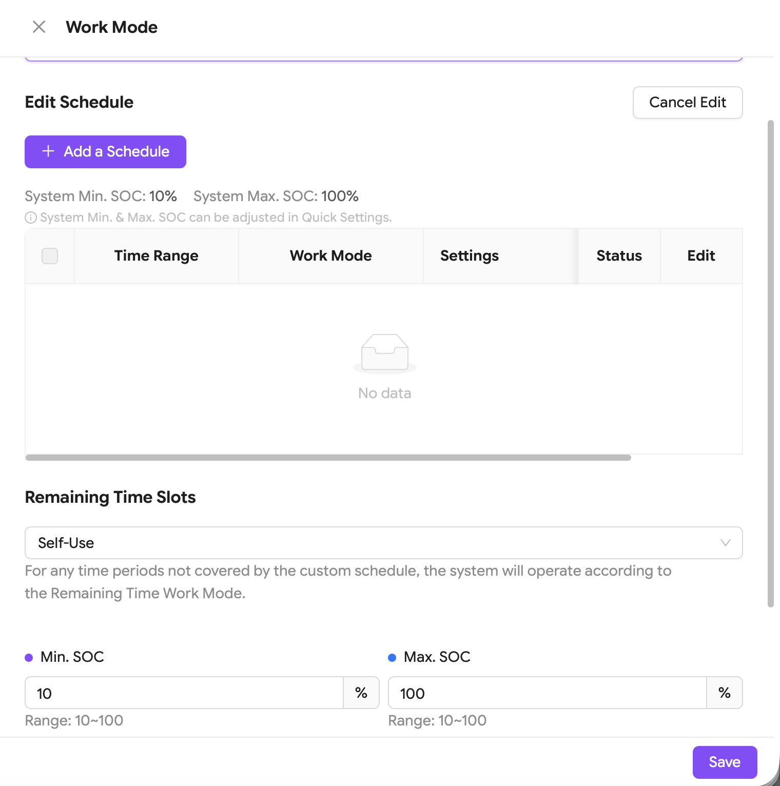

On your last picture, if you select details next to your work mode, there should be a drop down box.

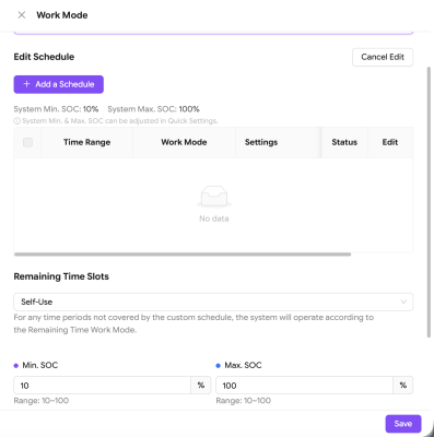

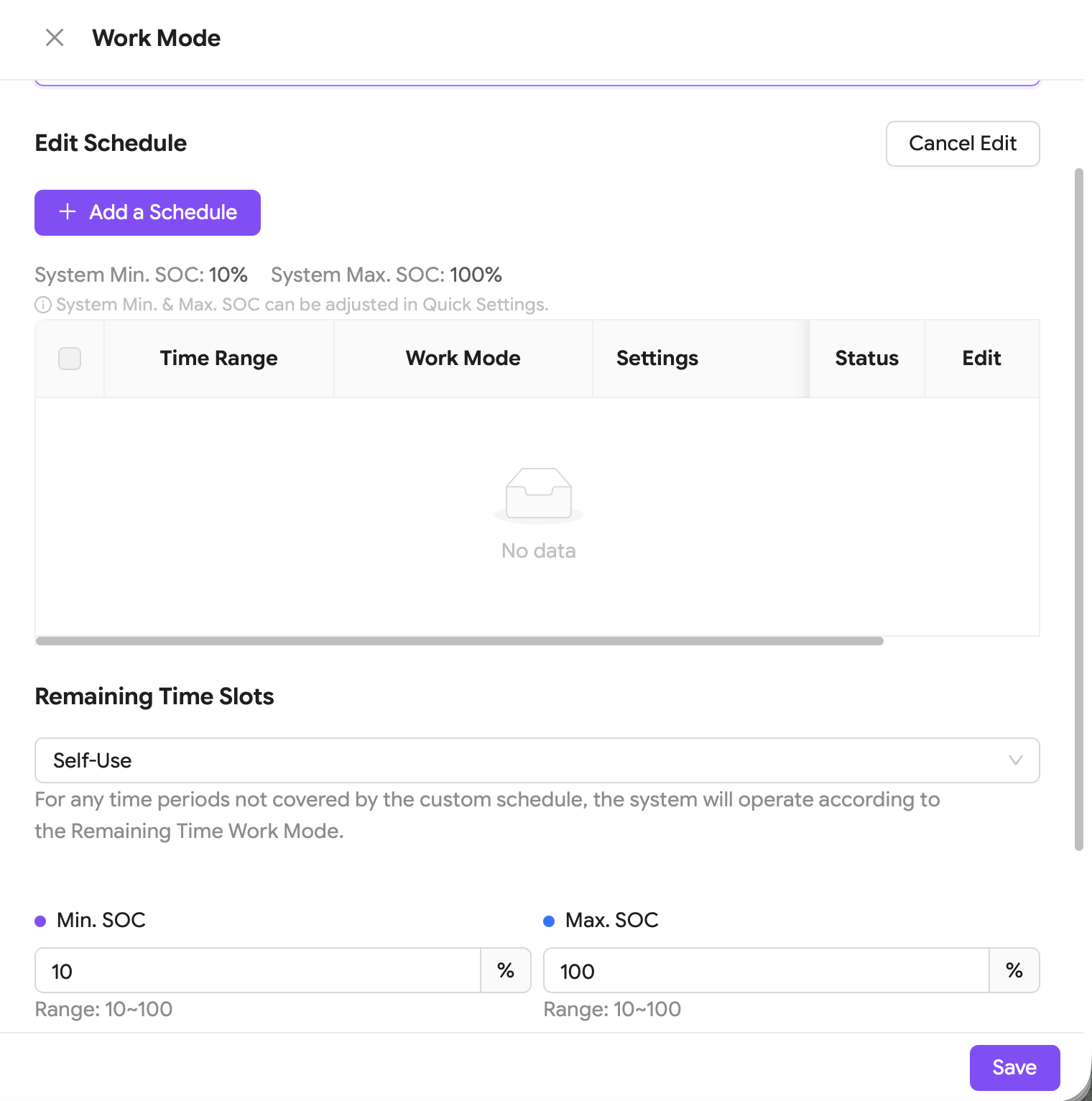

Scroll down to Advanced -> Mode Scheduler, and show what you have there please.
There are no schedules in there (deleted them a few days ago when I was using Octopus Agile)

Maybe Agile still has your system by short and curlies.
It might be an idea to set a charge/discharge for a single minute at 21:00 to 21:01, save it.
Then check values tonight to see if it swaps modes after that schedule and stops taking grid power.
If that works, then you can erase that schedule, save and test tomorrow what it does at 21:00?

Yeah gotcha, but I would still set a 1-min schedule, test and then check results.
If the testing fails, the manager might have crashed, and system needs a full shutdown/restart to get it on track again.

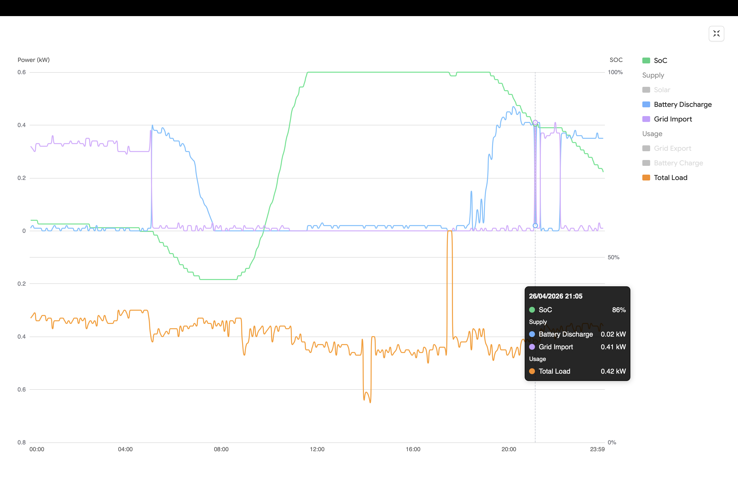

That didn't fix it. At 21:05 it went back to importing from the grid.
I changed it to "peak shaving" and set the import limit to 5W and that forced it to feed from the battery.
Think I'll have to log a support case with Fox as this is weird.
