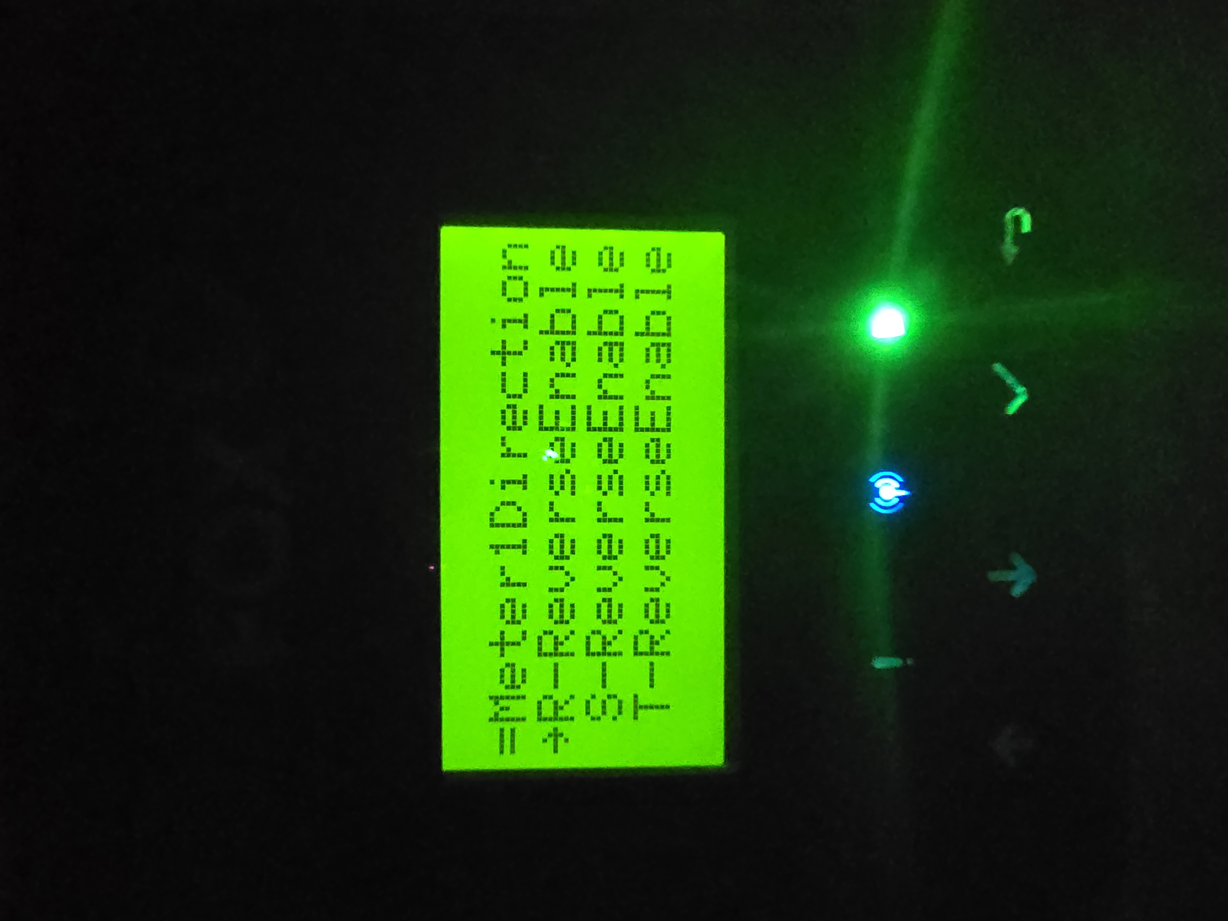

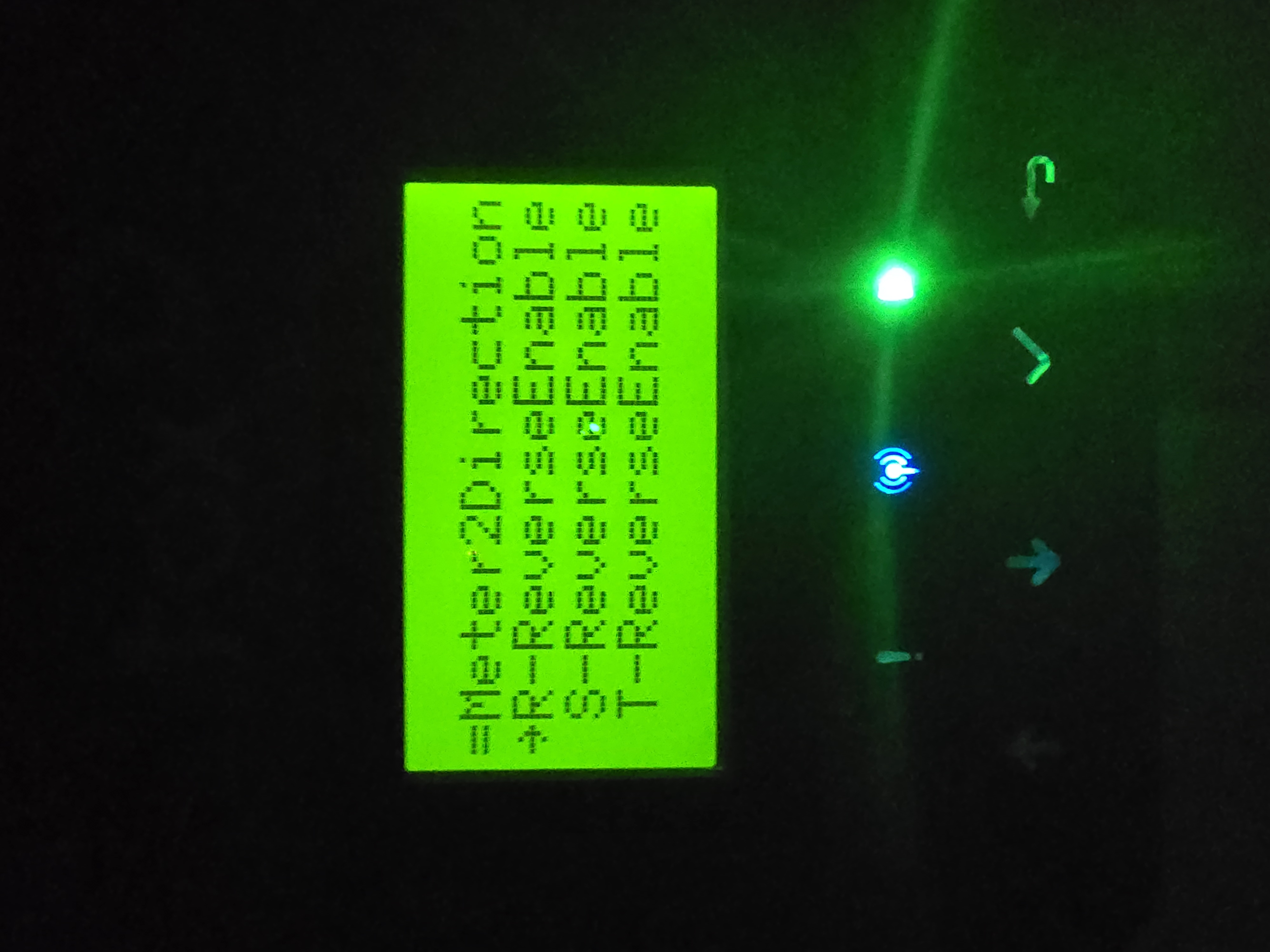

I only have one meter installed, but the direction of CT clamp (CT2) clamping existing PV inverter is pointing to switchboard (arrow pointing to switchboard), is this the culprit?
And is there any setting in the inverter to check this?

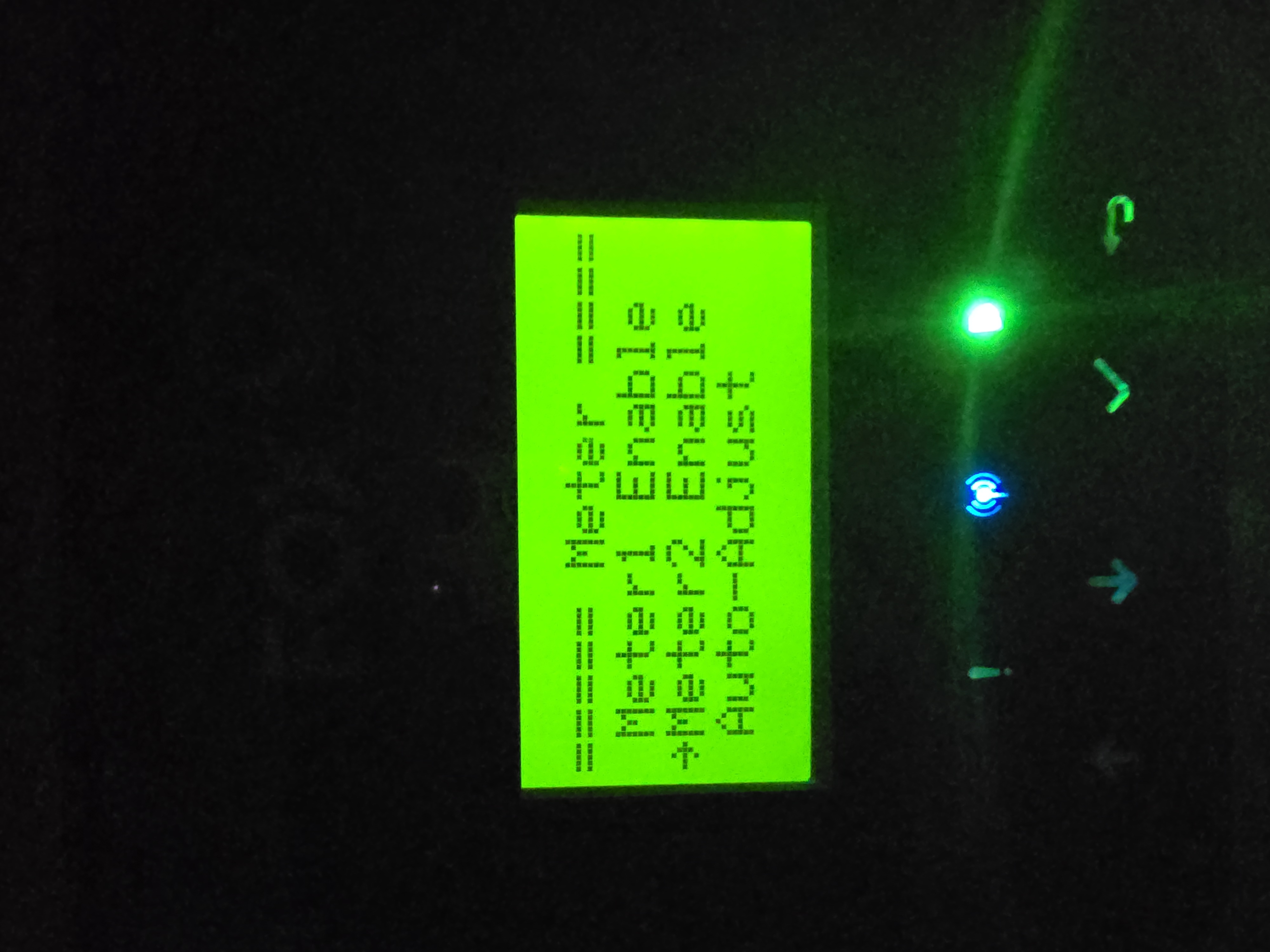

If CT2 is just a CT clamp you can check that is has been enabled as I mentioned before at the Inverter Panel in Settings(password=0,0,0,0), Feature, Meter2/CT2 set and it should say >CT<, if it doesn't, set it to that before you go any further.
It is possible the CT direction is wrong, the problem with the arrow is that if the cable has been wired incorrectly at the meter connector then the direction it is pointing doesn’t make sense, it’s also possible that the cable at the meter connector has broken a core (they are very fragile and often break when putting the connector together), or even the installer has wired it up to the wrong pins.
Assuming CT2 is enabled correctly, make a note of it’s current direction, unclip it and it will roll open, reverse it and re-clip it, wait 10 minutes and then check on your app to see if anything has changed.
Thanks Dave I will check it when the sun is up
In the settings features meter, meter 1 and 2 are both enabled and all set to reverse enabled.
