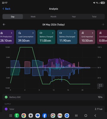

Screenshot from the app showing immersion heater.

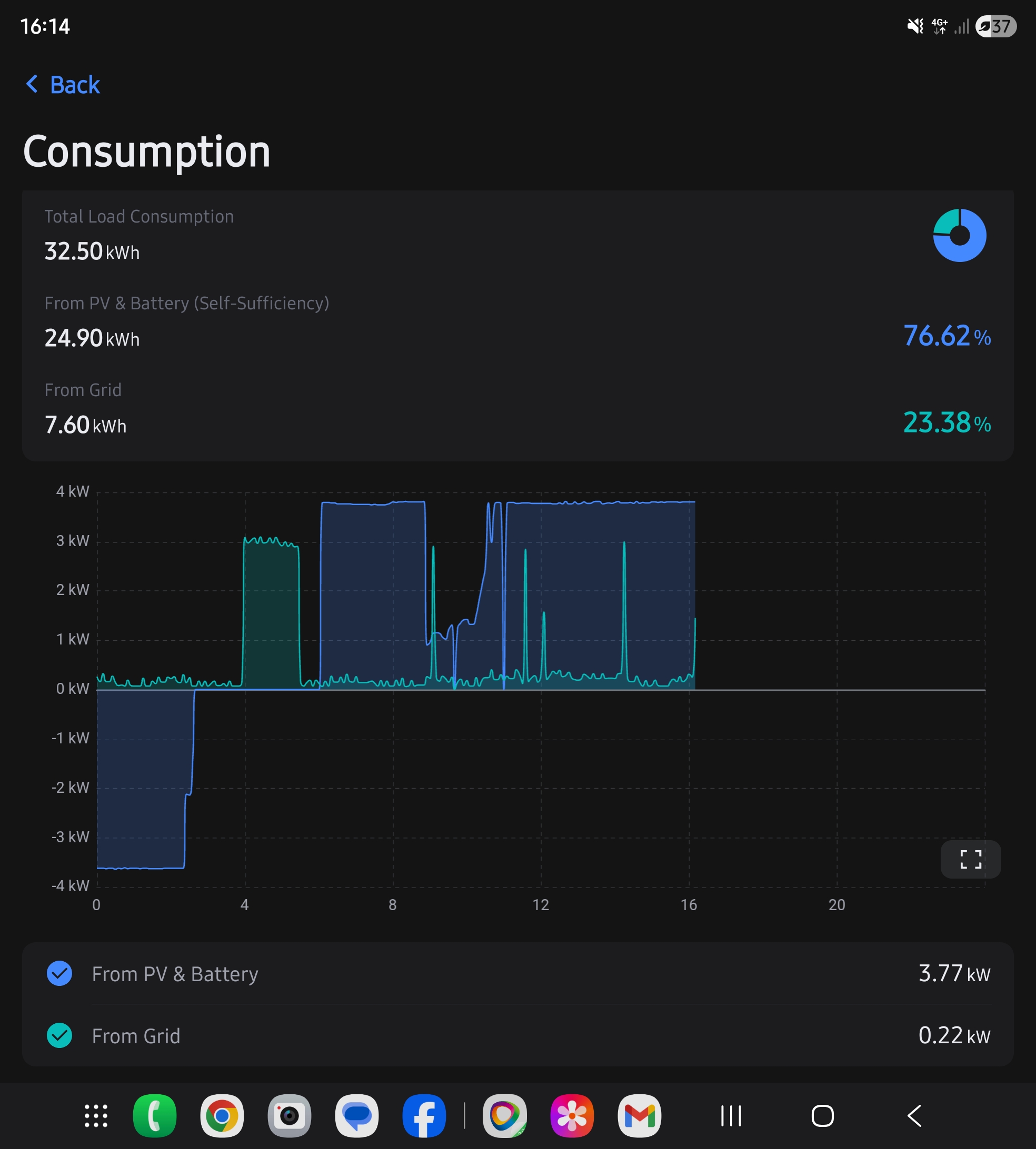

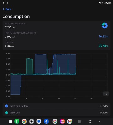

Is it normal for a base load ti be at 3.5-4kw? I've tried switching off eveyrthing in the house but didn't make a difference. Would it be setting with the inverter or ct clamp?
Re: Wrong system reading and battery in idle
If you are sure everything is off, no it’s not normal.
There are no settings for the CT clamp other than enable/disable and reverse - as you reversed it originally because it was reading negative loads it looks likely that the CT clamp may be either located incorrectly or the CT clamp used is not the correct ratio for the Fox system.
Just want to double check this is a single phase system ?

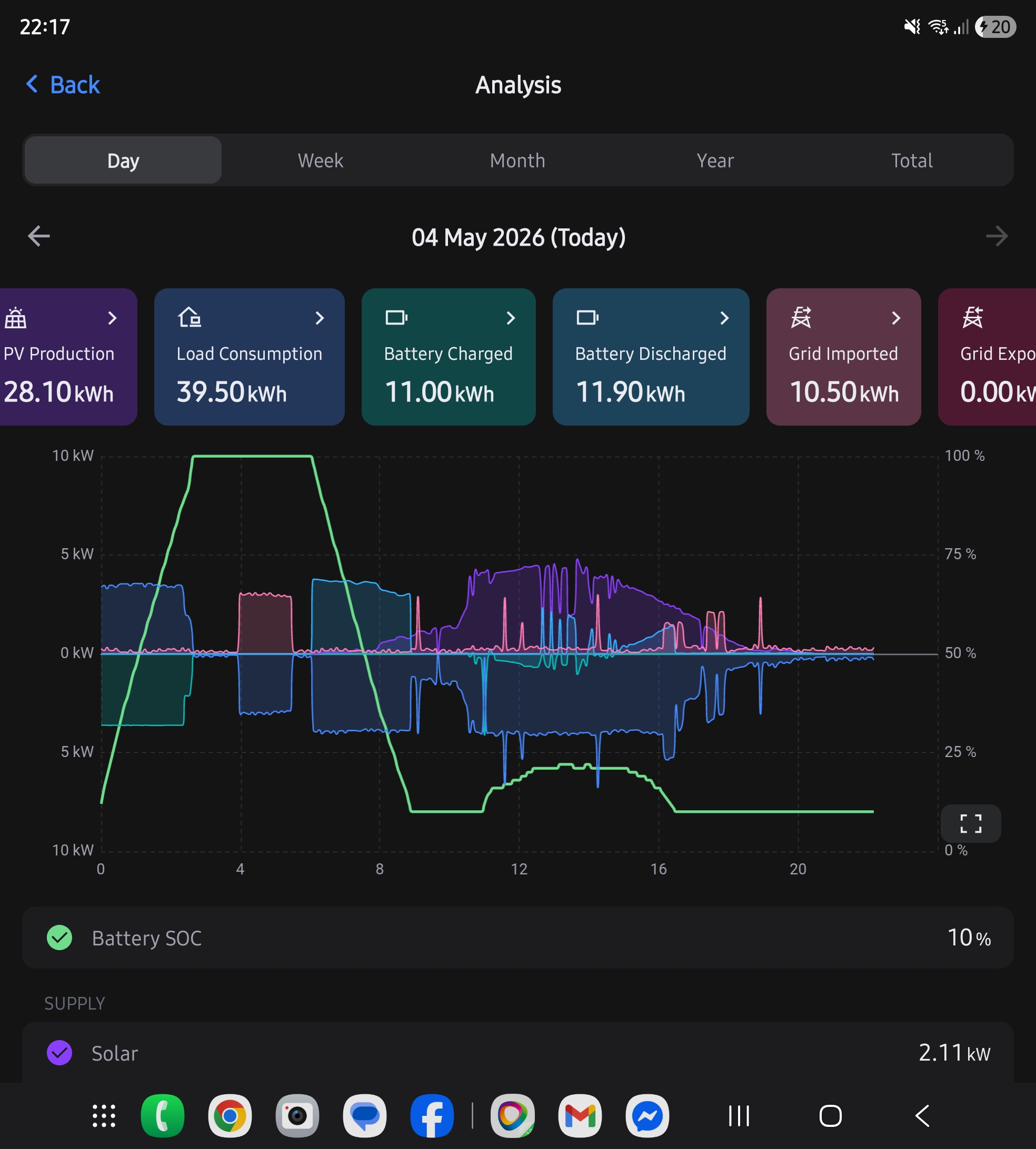

It would be helpful to see the graph you see when you click daily production off the main screen - that shows charge/discharge/pv and load together and you can also see the affect on battery soc.

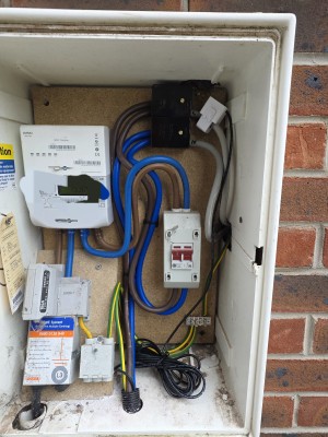

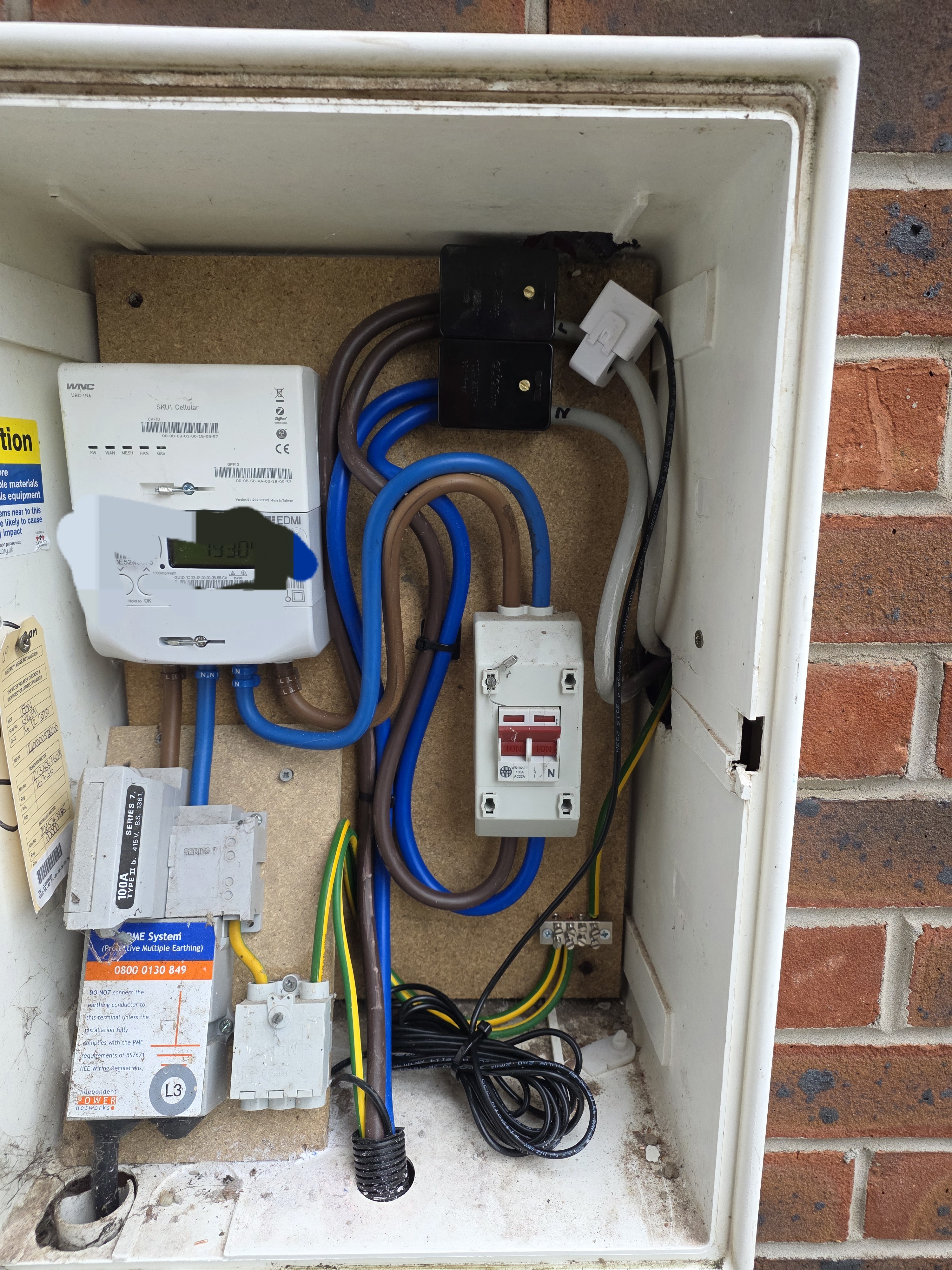

To start with the location the CT clamp should be clipped to the live feed from your smart meter and under normal conditions the arrow should be pointing towards the grid (but as already said if the cores are crossed in the connector this isn’t guaranteed), can you confirm where it is located please.

Yes, it is single phase. My understanding is that base load looks ok until battery is starting to discharge or panels starting to produce during the day. CT clamp is on the Live cable just before it goes intk the house to the fuse board. I will speak to the i staller tomorrow to see if they can send someone to have a look if it's all set up properly.

I would start by reversing the CT clamp direction again, it’s dumping the battery to the grid the moment it detects solar which confirms the direction is wrong and is wasting your energy - there is clearly another problem that is giving you negative load figures.
There’s a cable that runs out of the Henley block (black connector at the top) and down and exits the box at the bottom is that an EV charger or is it the connection to the Fox inverter ?.
