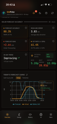

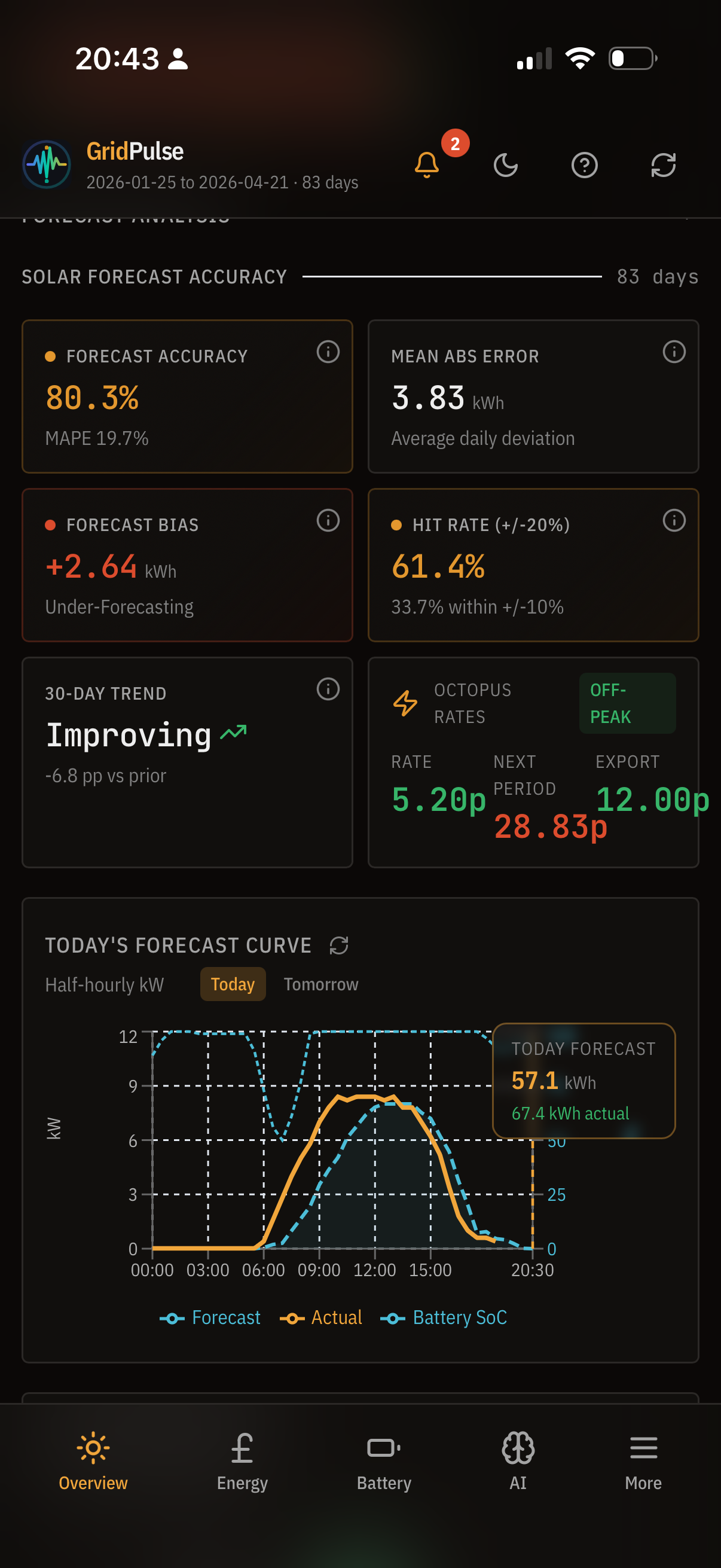

I have to say. I’m satisfied with solcast forecast. Since I started tracking it’s 80% accurate and most of the time I overproduce vs forecast.
