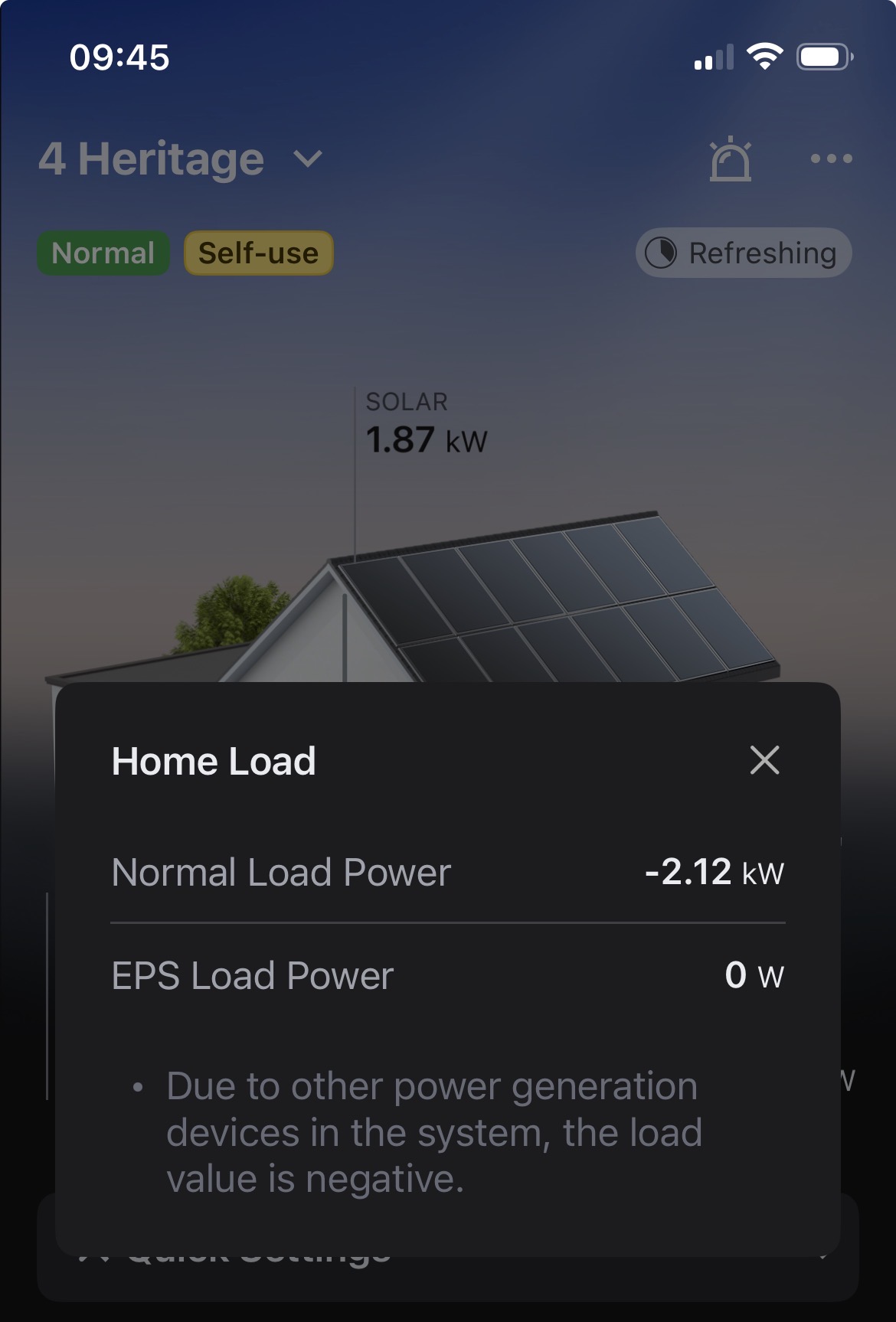

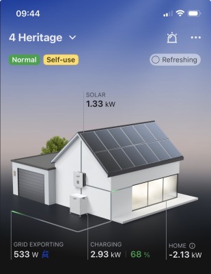

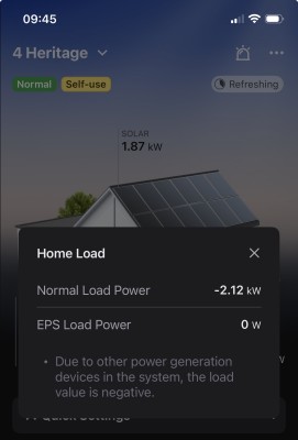

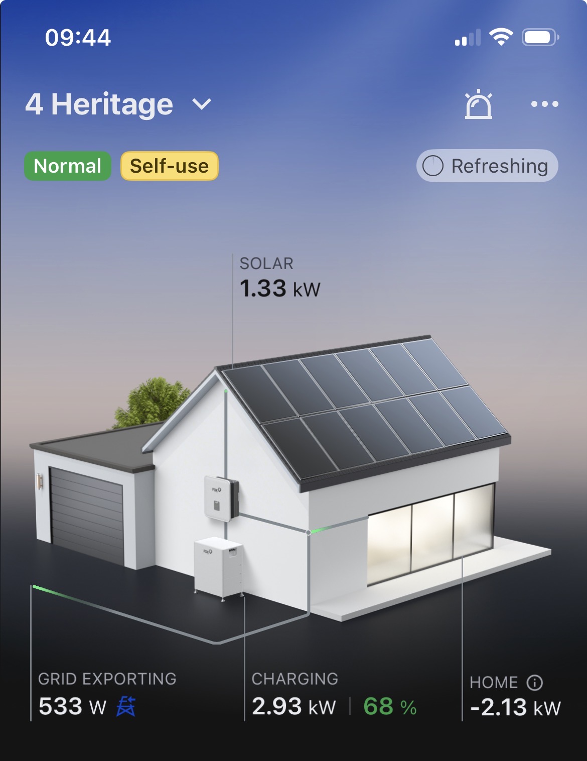

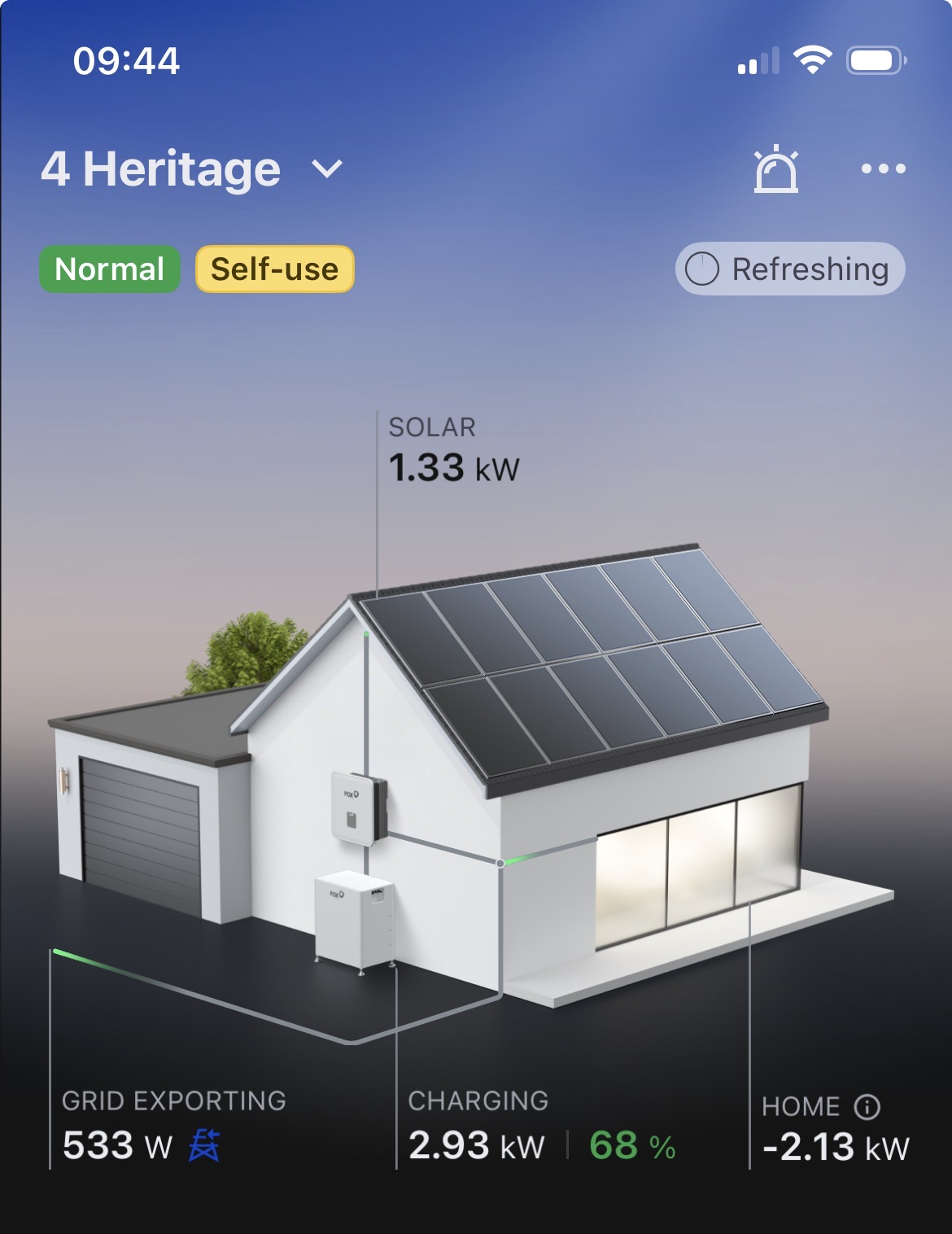

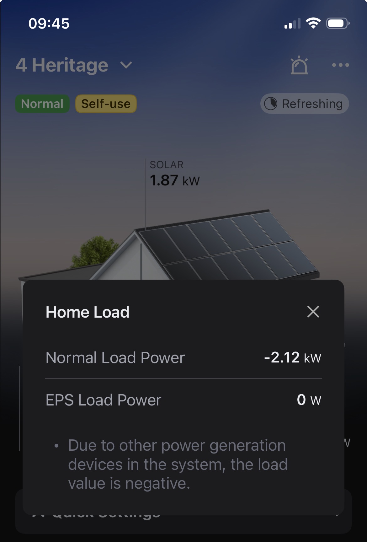

I have an existing old solar system on my house, my Fox doesn't show it as generator. Mine just shows mine as a HOME negative load. Right now -2.13kw and when I press the i button next to it it shows *Due to other power generation devices in the system, the load value is negative
And that other system is feeding into my battery along with the Fox system.
So very different to how yours is show!
