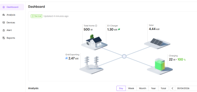

I recently purchased a FoxESS L Series EV charger, which is designed to be compatible with solar generation. The intention is for the charger to use excess solar energy (rather than exporting it to the grid) to charge the vehicle.
At the moment, the charger is only drawing around 1.2 kW. I’m not sure whether this is due to a communication issue or if there is a configuration setting on the inverter that I may have missed.
Any guidance would be appreciated.

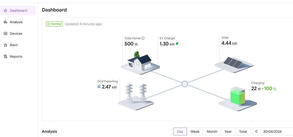

Do have any energy graphs you can share from the App/Website to show what power is being sent where.
Some to the EVCP / Battery? / Export?
Work mode for the Inverter (Self-use for example)
Settings for the EVCP if you can view in the App/Website.

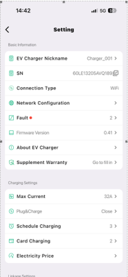

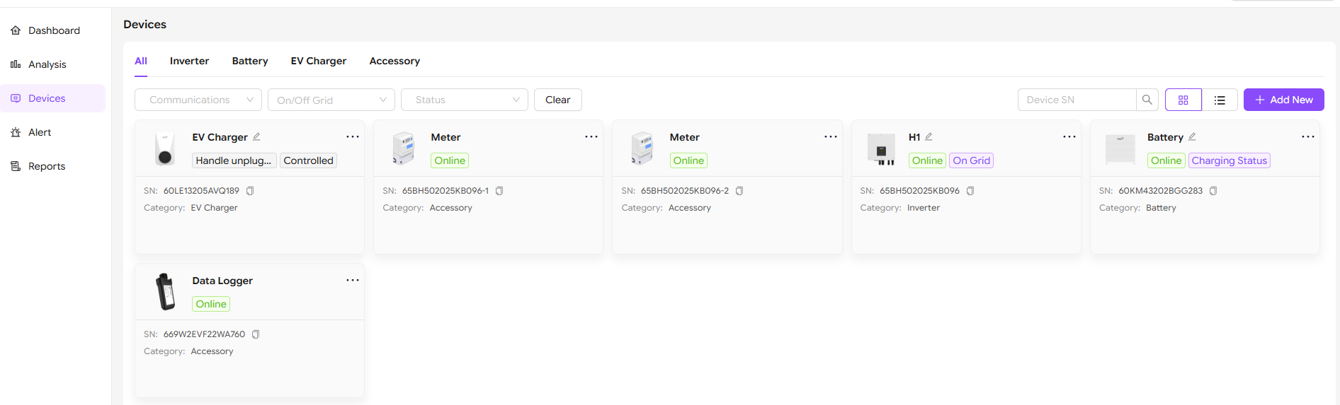

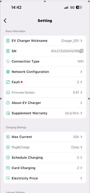

Here it is - what is currently doing.
car is plugged in.
Battery is full
Working mode - self-use
settings from EVcharger
car is plugged in.
Battery is full

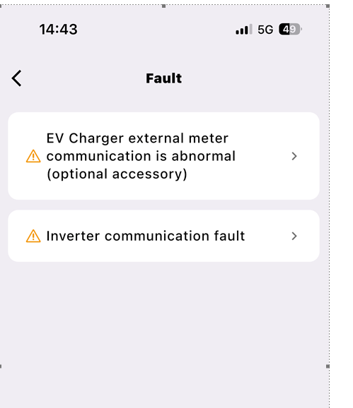

Can you get more detail on the error message for the two fault codes.waiting4solar wrote: ↑Thu Apr 30, 2026 2:38 pm Here it is - what is currently doing.
car is plugged in.
Battery is full
The first one does not seem important, but the Inverter one does seem more of an issue.
I cannot say I can fix your system, but at least it appears TyGuto might be able to help you compare settings now.

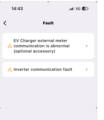

MaterialBarracuda48 wrote: ↑Thu Apr 30, 2026 3:49 pmCan you get more detail on the error message for the two fault codes.waiting4solar wrote: ↑Thu Apr 30, 2026 2:38 pm Here it is - what is currently doing.
car is plugged in.
Battery is full
