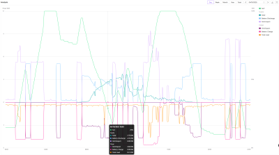

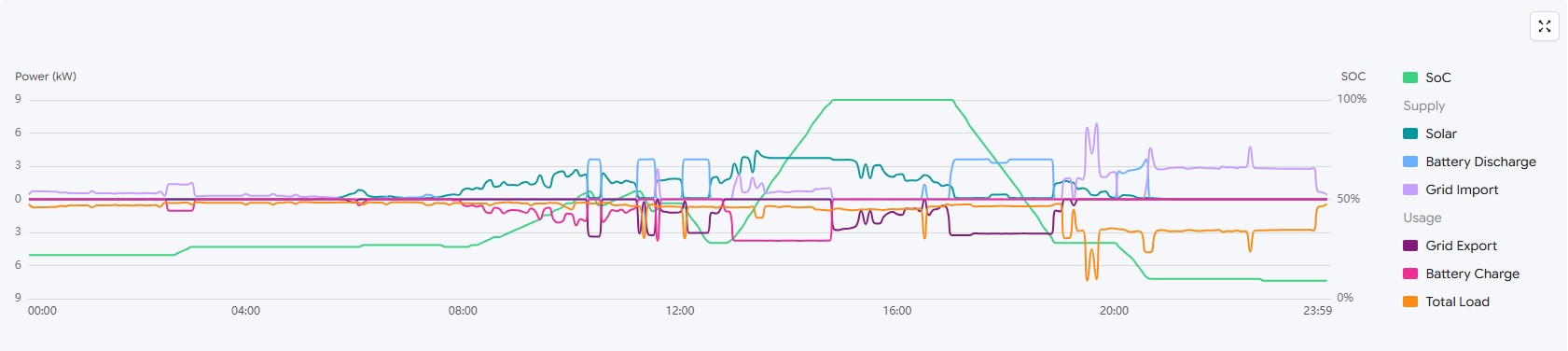

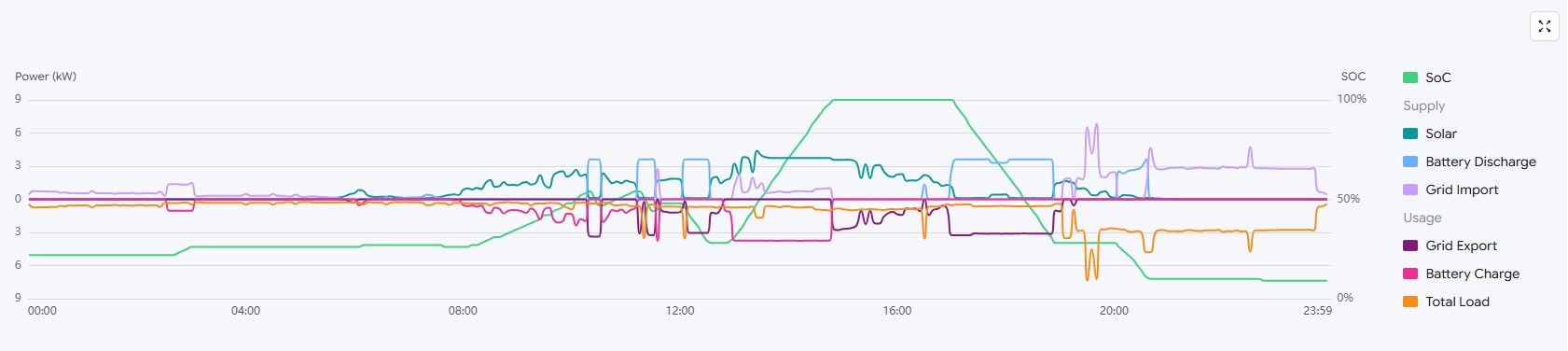

I noticed this today (yesterday's data) but looking back it seems to be fairly consistent. Each time I hit a FD period, the PV drops to around 140W (from an expected 2.7-3.3kW on yesterday's figures) with pretty much all the export and load coming from the battery. Apart from anything else, that's over £1 revenue lost each day (first world problems, I know).
Is this a known firmware issue? I've tried updating a couple of times today but each time hit a timeout at 72% with the inverter disappearing from the app/web (although front panel suggested everything was normal) and needing a full power down & restart to reappear.

"The only thing I can think of is the H1 G2 inverter having a maximum Kw it can handle at any one time"
Yes - this is an expected. But what I would expect to happen - and I believe used to happen before the flurry of app and firmware updates over the last year - is that the inverter uses the PV first before the battery for a Force Discharge just as it does for supplying the house load.
With a 5kW inverter and a 3kW PV input, that means a 5kW FD setting would (should) take 3kW from PV and 2kW from the battery. I cannot think of any situation in which someone would reasonably/regularly want to not use the PV. If you truly want to run the battery down then you'd either wait until the sun has disappeared, or you turn the PV off at the isolator.

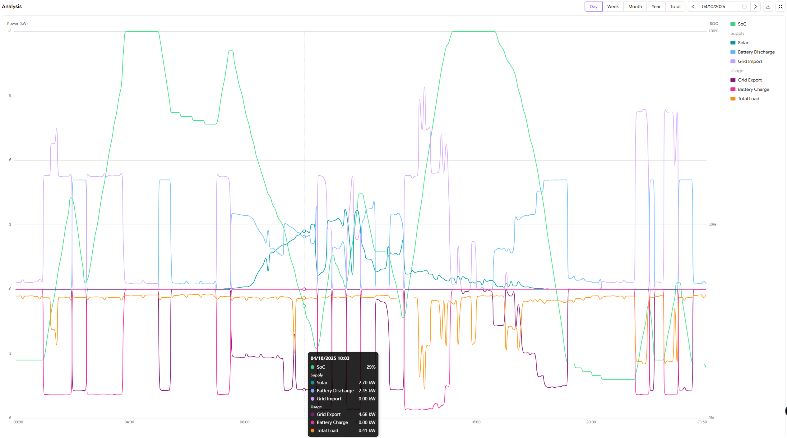

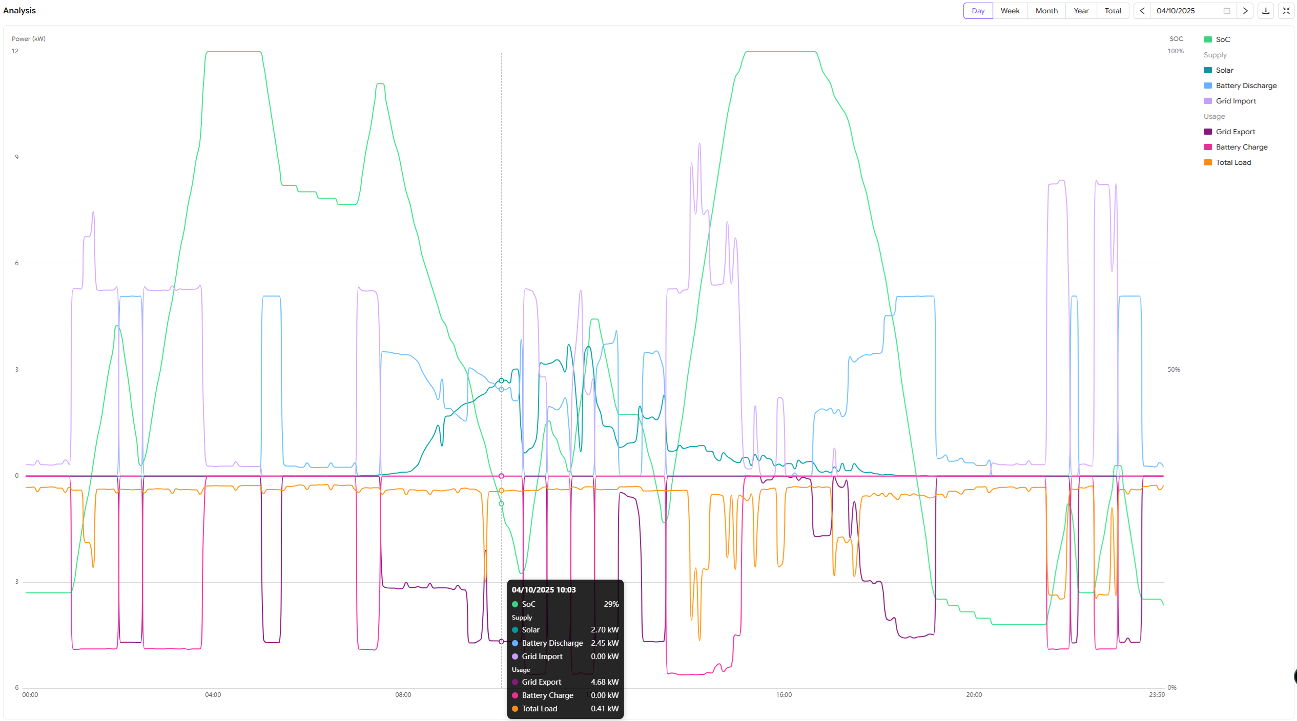

See this breakdown from October. I was on Agile import / fixed export at the time so controlling it myself. There was a negative import price at 10.30 so I'd have been discharging leading up to it (https://agilebuddy.uk/historic/agile/2025/10/4). Given it's 7 months ago and I didn't know to pay attention at the time, I can't be definitive, but it does fit the data and illustrates my expectation as above.
FD is set at 5kW (on 5kW inverter). House load is 410W. That's being supplied by 2.7kW PV and 2.45kW battery. Contrasted to the current situation where the entire supply would be taken from the battery with PV shut off.
Anyway - Fox have updated the firmware to 1.55/1.73 this morning (self-service update failures being another story) and will investigate "if the issue still persists afterwards" so let's see.
