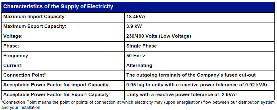

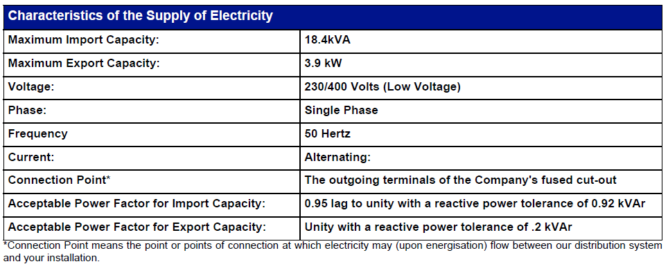

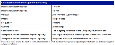

You should check your G99 certificate for the correct value for export.jamescwood14 wrote: ↑Wed Jun 03, 2026 5:52 pm Thanks Dave and Barracuda it worked immediately I set the export power to 6000 it was on zero!!!!!
I have 6kw inverter
In my own example, 7kW inverter with a 3.9kW export limit.
