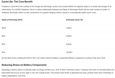

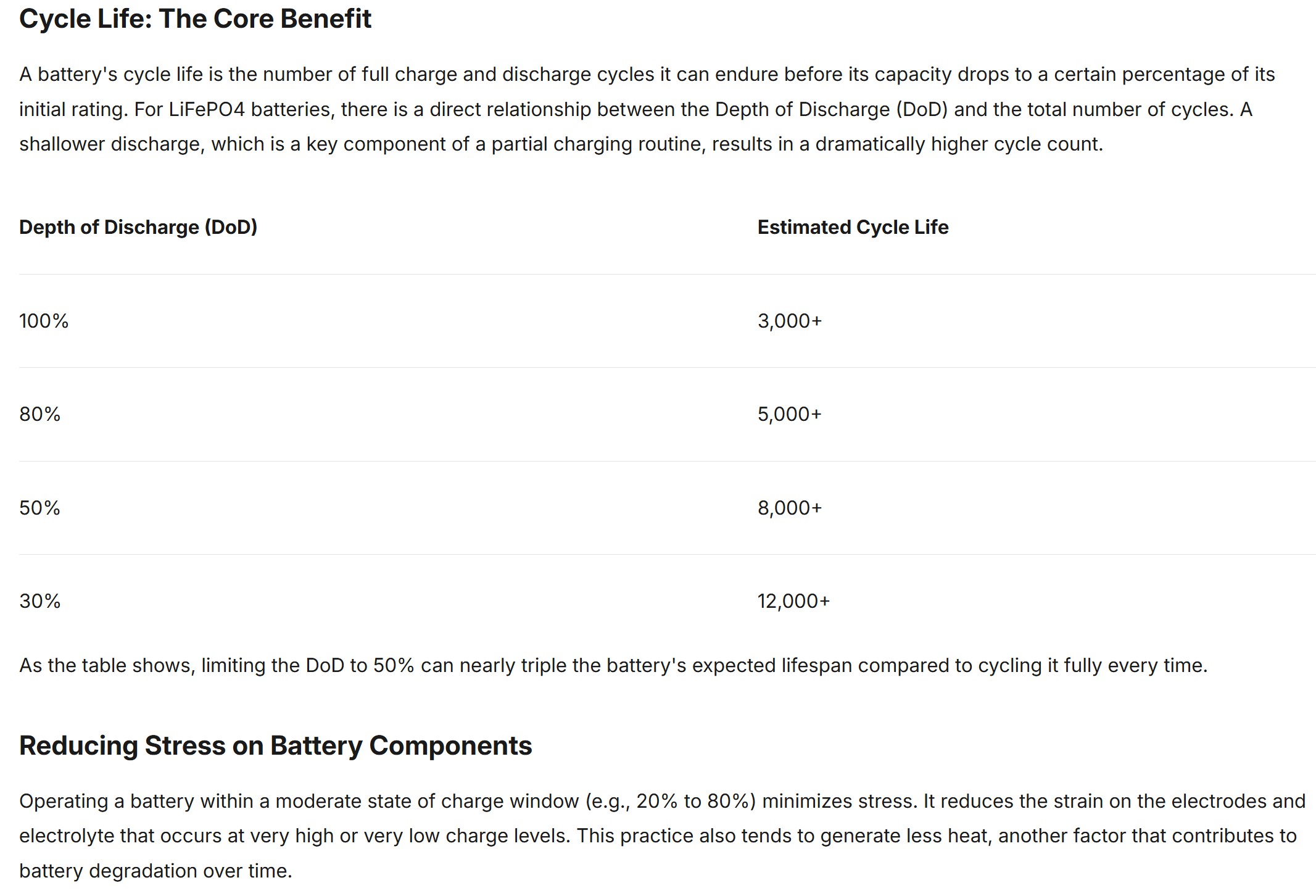

I came across this interesting article which confirms my suspicions about repeated and deep cycling.....I dont think it's worth it for the few extra pence it will possibly make.... https://www.anernstore.com/blogs/diy-so ... epo4-myths

I should probably have clarified, the main intent was not to make money from the export from the battery, but to combine solar/batery and lower my electric bills as the primary goal, any excess is a bonus and for that I have disable the Capture AI export, as I only want to export solar when the batteries are full.
At the time I wrote my post, Capture wasn't fully utilising the cheaper times to charge up the batteries in low solar output periods, switching to 2 cycles seemed to do fix that.
It doesn't also do a fully battery discharge and charge cycle twice a day, not sure how their algorithm works, but that was the setting that fixed it for me (as in to charge when its cheapest), but as we came into spring, I was rarely seeing more than a full cycle and certainly not seeing it at the moment at all. At the solar predictive based charging has been pretty good.
While I agree multiple cycles is bad for the long term health, given how rarely, if ever, multiple cycles occur, and the point of buying the batteries was to use them, its not too bad, but everyones mileage will vary.
My bills have drastically dropped though with the whole combined setup from £138 (May 2025) to £13 (after solar only export) (May 2026), and the selective charging when good solar is predicted has helped with this.

As you rightly say, everyones' setup will be different and offer different "benefits"
I also didnt install solar to MAKE money, rather to save money and get a more reliable electric supply - we seem to get a fair few power outages and I had previously been running a couple of battery backed high power UPS's with lead acid battery replacement costs of around £300 every 3 or 4 years
We typically use around 16kWh a day / 6300kWh a year which has remained pretty constant over the 6 years I have been averaging it, with Octopus we were paying £130 - £160 a month.....since the solar and battery install in April our payment to Octopus has been just £36 (standing charge and overnight import) AND we have been credited £50 feed in tariff for May so, potentially "saving" just under £200 a month.
Obviously this will reduce over the winter months but prior to solar we recorded the usage minute by minute over 18 months using a Raspberry pi by counting the smart meter LED flashes and crunching that data against the predicted solar gains from Global Solar Atlas along with the Octopus smart EV rate of 7p per kWh over night to charge the solar battery we reckon to only be pulling from the grid for a few days over winter.
Time will tell if that is the case but in the 2 months it has been in operation the returns have exceeded our predictions
I cannot see any advantage in using capture AI as against setting the Fox app to force charge the battery overnight, I still feel the extra "savings" of a few pence a day by cycling the battery harder and more often would not outweigh the cost of early battery replacement.........but I could be wrong
