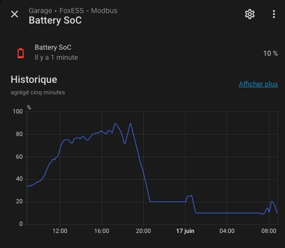

Yesterday evening around 8pm the battery dropped very fast, from about 85% to 20% in less than an hour, with nothing special running in the house. Then in the middle of the night it started to charge from the grid on its own, which it never did before.

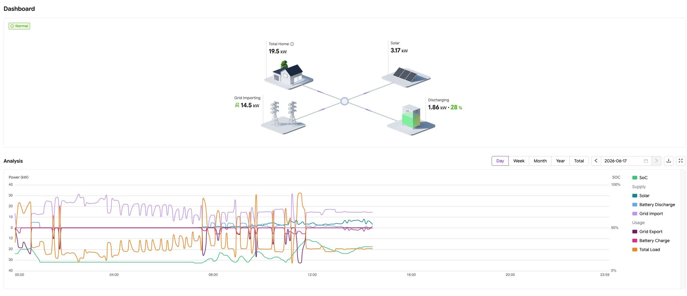

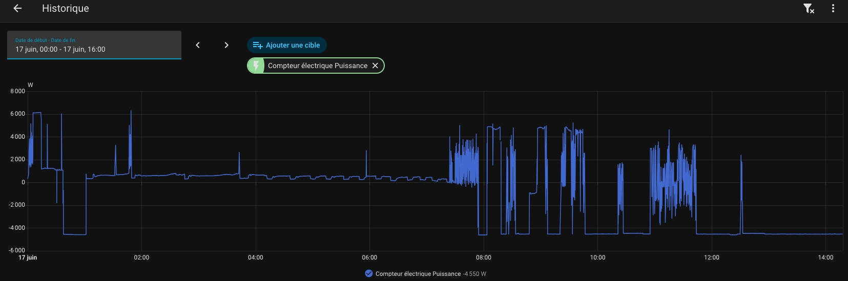

When I look at the grid power meter, I now see flat rectangular plateaus at a fixed power, around +4500W (charging from the grid) and -4500W (discharging to the grid), lasting several minutes. This is very different from normal solar production or normal consumption, which are always noisy and irregular. A flat plateau at a fixed power looks like a forced charge or forced discharge order from the inverter.
On the attached screenshot (17 June, 00:00 to 16:00) you can clearly see these flat plateaus at about -4550W during the night and the morning, including periods when there is no solar production at all.

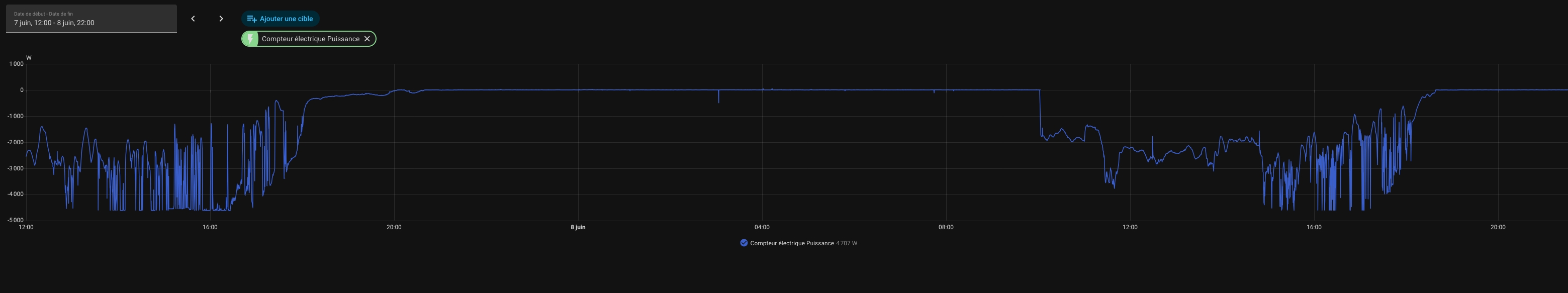

For comparison, a few days earlier (7-8 June) the grid meter was flat at zero during the night, with only noisy solar production during the day. No grid charging at night, no fixed plateaus.

That looks like a battery dump/cycle which you tend to see when there are CT clamp issues - if nothing has changed on the system i.e. there has been no work on it, CT clamp removed/replaced for any reason I would strongly suspect that this is a reverse meter sensing problem, i.e. the inverter believes that the CT orientation has changed and has flipped the polarity.
There is an installer setting that can be adjusted to stop this happening - ask your installer to disable the automatic meter reverse connection detection (which can be done remotely)
