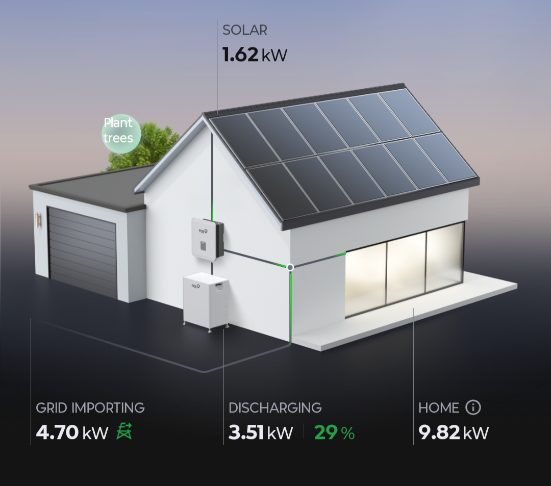

I had my system installed yesterday and I have had some strange reading on my foxes app load being fairly high when nothing is turned on (minus fridge internet router) and sometimes when I do have the Aircon on it actually shows load - and the battery started charging? (Maybe of the grid although I've not set it to do that)

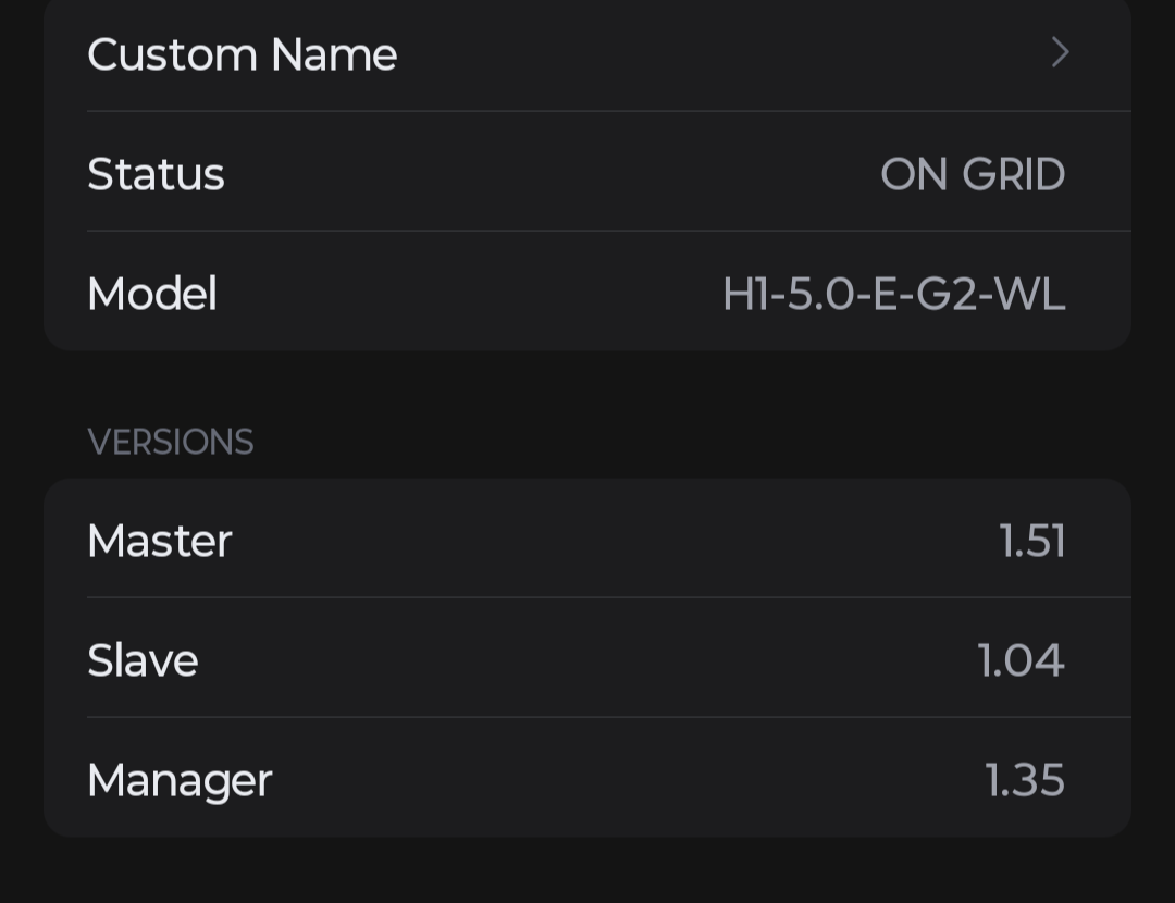

I have attached a few images the battery I have is ep6 5kw this discharged a few times already due to the home load shown as high.
It also reported yesterday that I'm pulling from the grid and when I checked my Scottish power account this morning I had more grid consumption than usual like twice as much.
Looks like a classic case of a reversed ct clamp. go into your meter area find the white or black ct clamp, unclip it paying attention to the current direction, flip it 180' to the ct is facing the other direction. wait 5 mins for the data to stabilise and then you should see the house load look normal again.

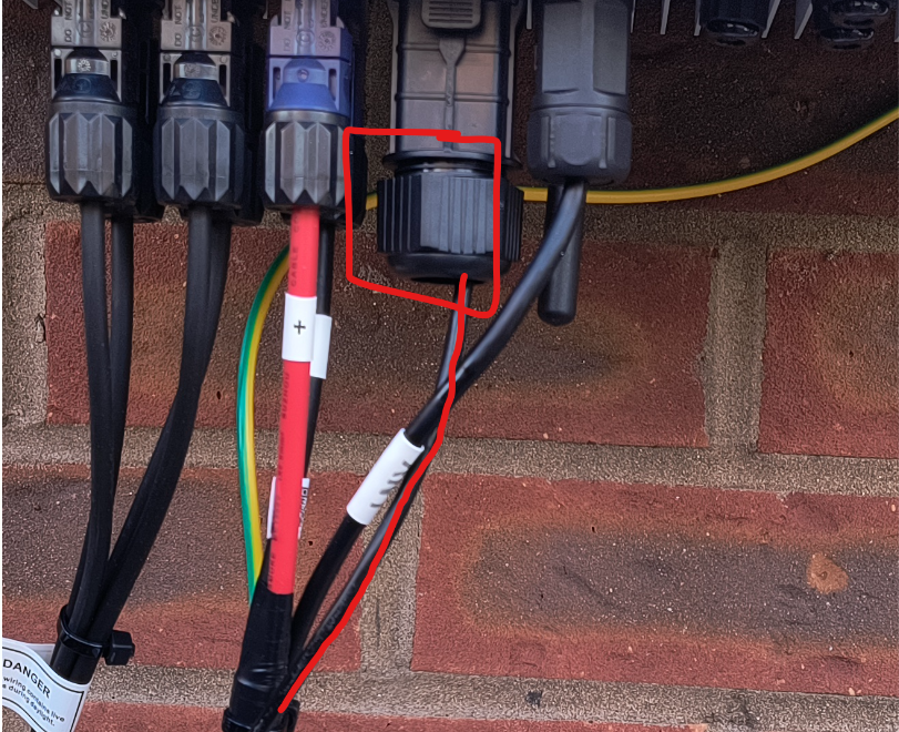

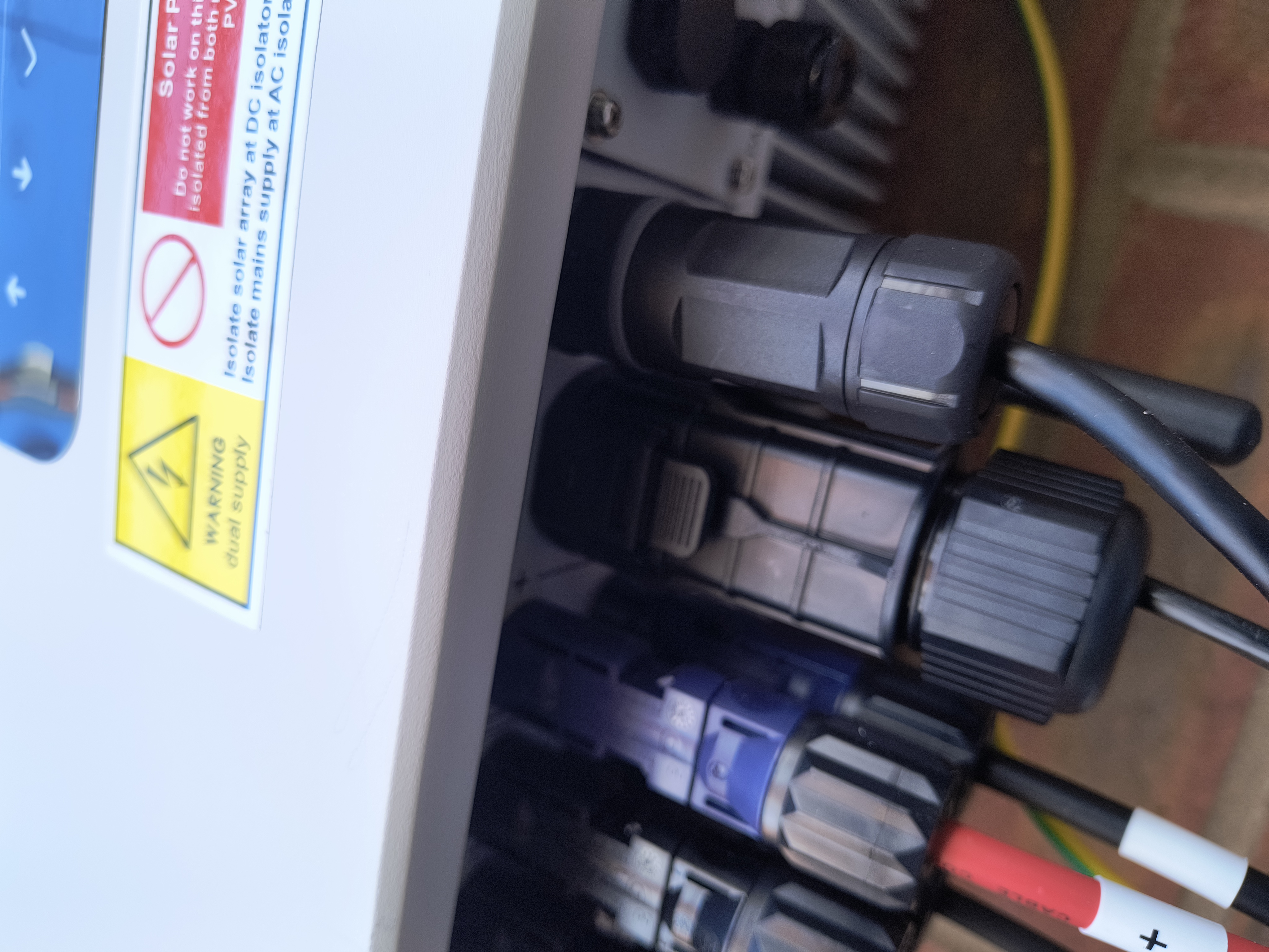

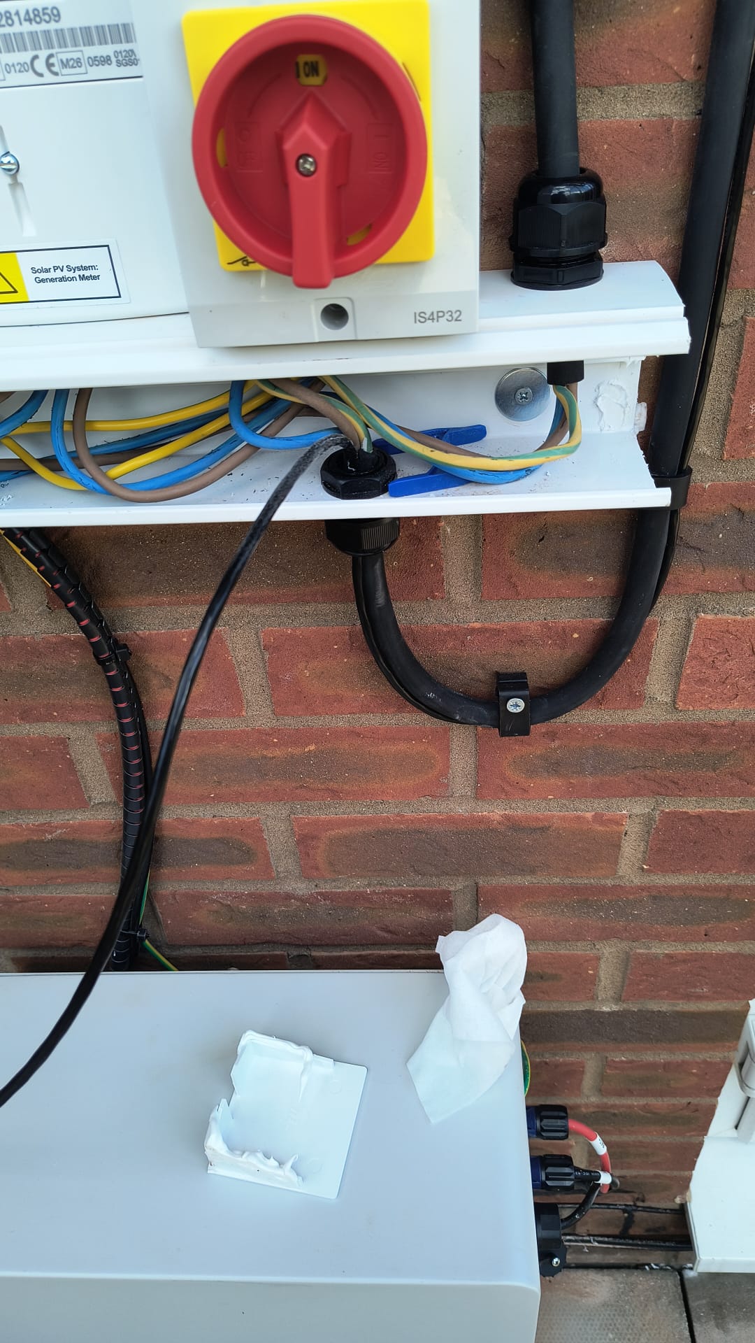

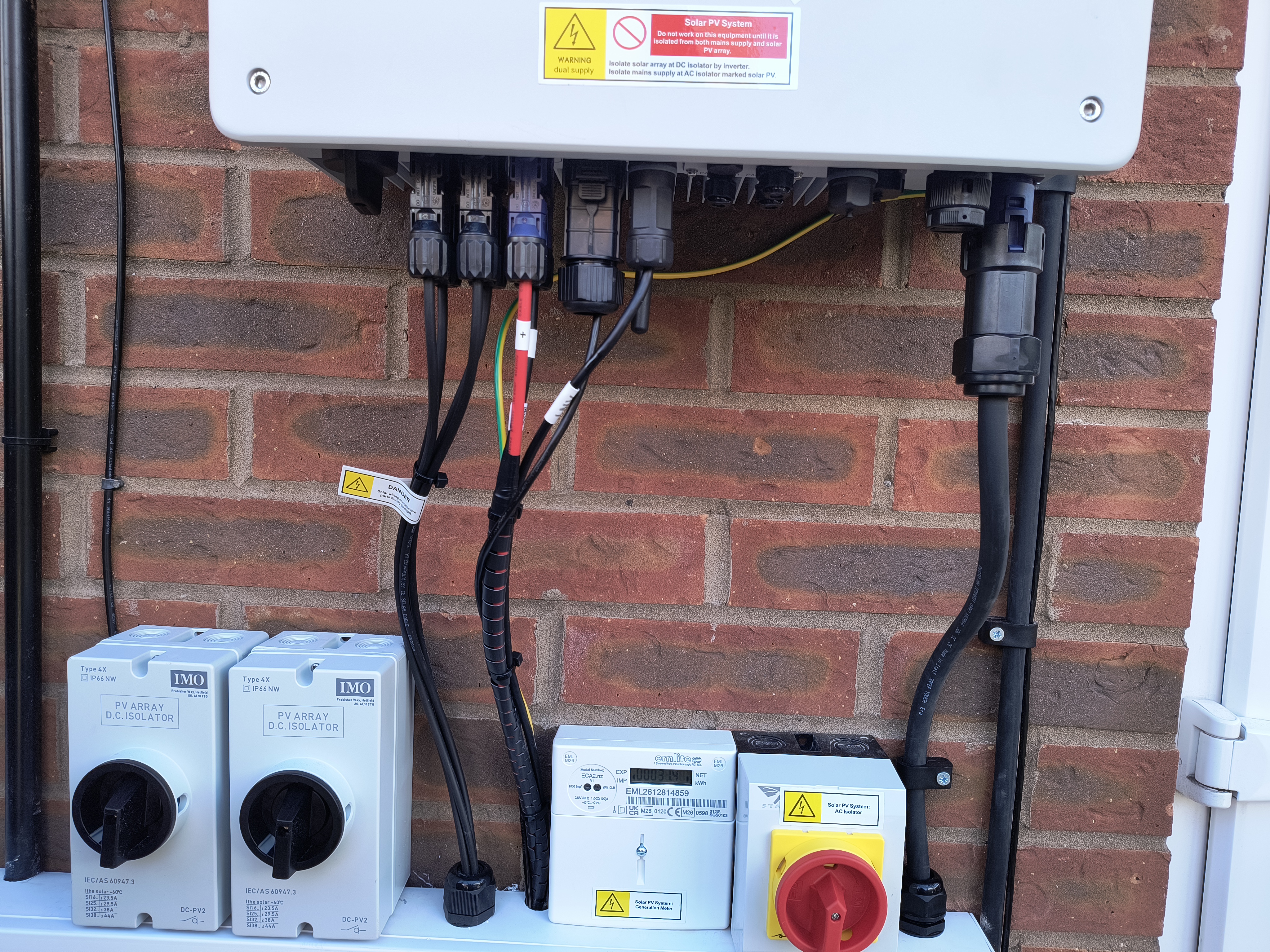

Thanks a lot for your reply. I have attached images of my setup I assume it is that cable? Turn isolator switch off turn power of in the house unclip twist and reboot?
On the inverter when I go into settings feature CT check it returns connection err too
trace that cable back to the CT clamp and flip the clamp around by unclipping it, before re-clipping.
It goes here and then all along the wall into another switch below my fuse box I cannot see a clamp.
