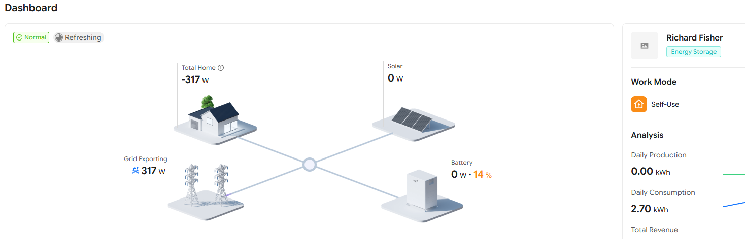

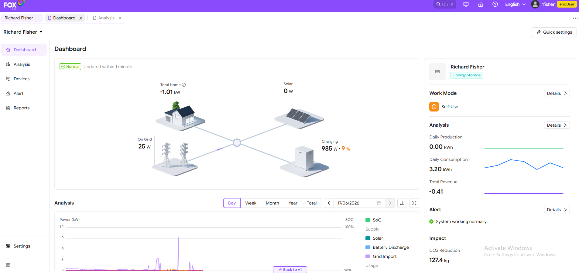

heres my dashboard

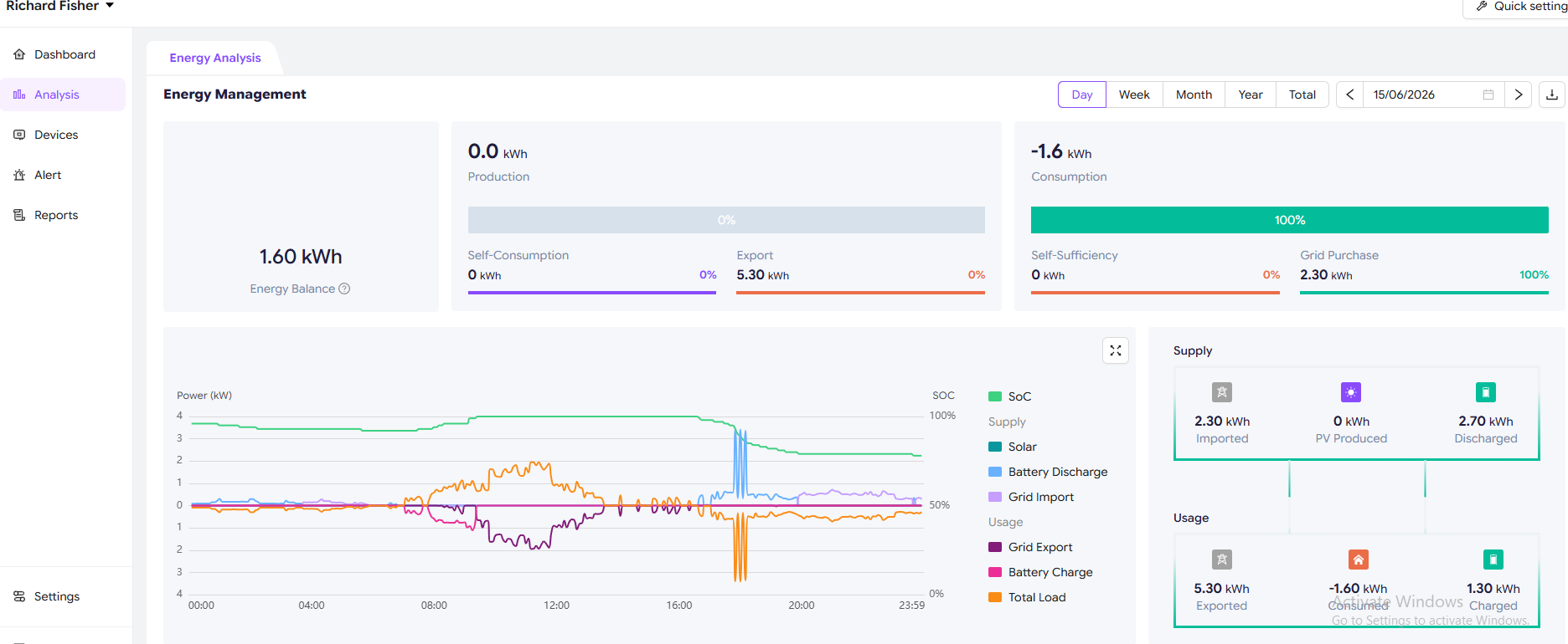

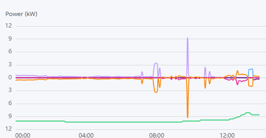

and the analysis from 15/06
heres my dashboard

The lower graph appears correct given it isn't measuring the load correctly because of the other inverter, albeit at 8pm the battery shuts off and it reverts to using the grid.
The large spikes of grid import you will see regardless as the inverter couldn't supply that much power, but the fact that it's not trying suggests some kind of scheduling or system min soc issue.

Dave, its just flipped over to grid export instead of charging the battery. it was charging, then a larger house load kicked in which the battery supplied, then when that load finished it started exporting the excess to the grid, its been doing this for the last 25 mins

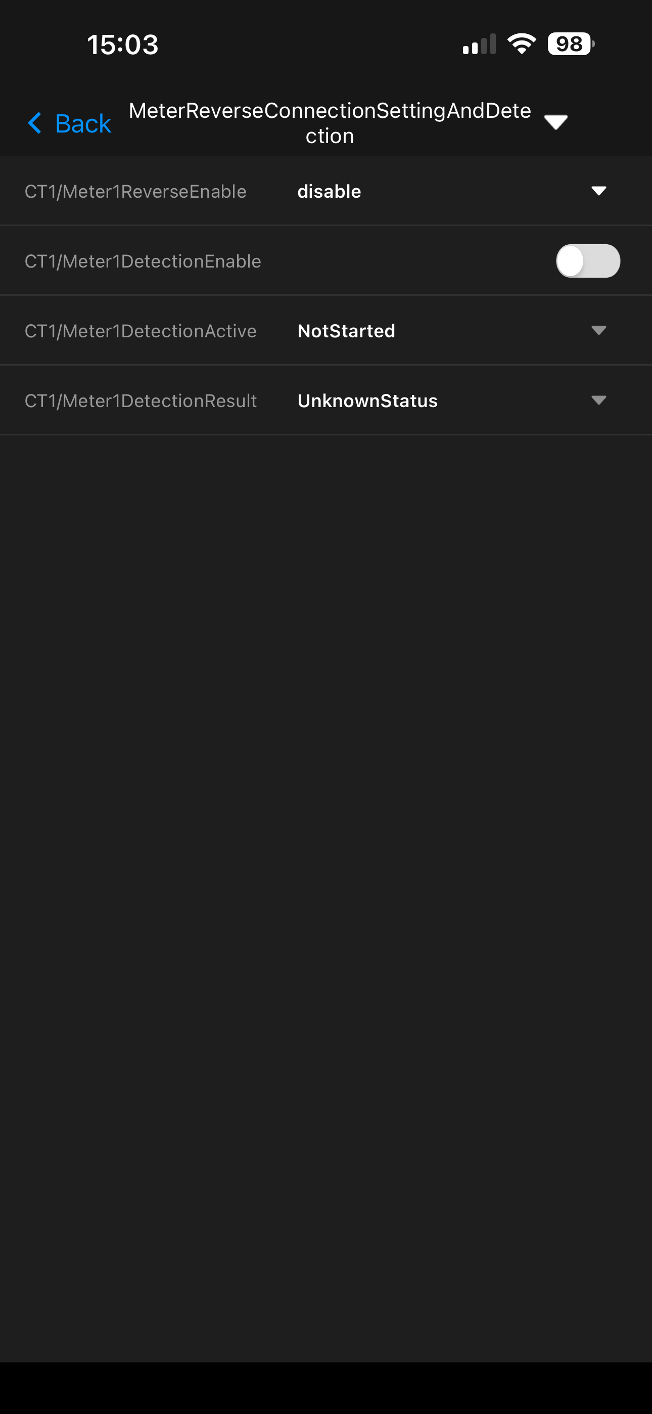

I think the problem could be related to your second inverter and the CT sensing of the Fox inverter (i.e. it is getting confused when the load is going from negative > positive or back again) , this unfortunately is an installer only setting but he can change it remotely, can you ask them to make sure that automatic meter reverse connection sensing is disabled.

Dave , the installer can't find that setting, could you point us to where it can be found?Dave Foster wrote: ↑Wed Jun 17, 2026 2:32 pm I think the problem could be related to your second inverter and the CT sensing of the Fox inverter (i.e. it is getting confused when the load is going from negative > positive or back again) , this unfortunately is an installer only setting but he can change it remotely, can you ask them to make sure that automatic meter reverse connection sensing is disabled.

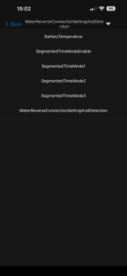

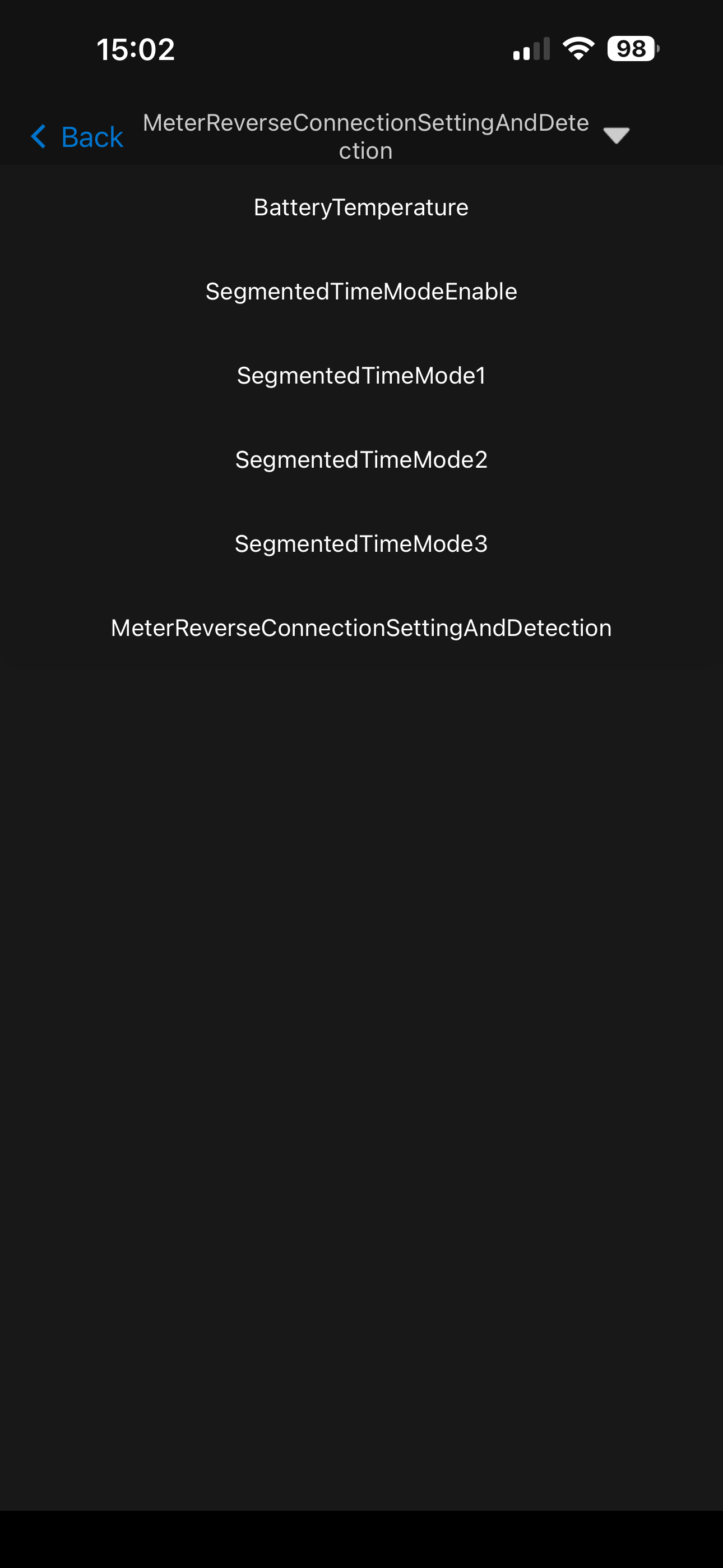

It has to be viewed with installer or agent access, it is the last item in the advanced menu list
And when you select that item you will see
CT1\Meter1ReverseEnable should be disabled
