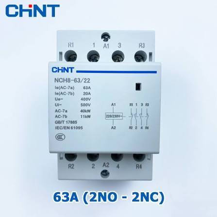

You can run all your back up on auto contactors. You need to spread the load out over the 3 phases as you only have 5kW/phase with a 15kW inverter.wilks wrote: ↑Sat Apr 18, 2026 8:59 pm 3-Phase ‘hybrid’ setup composed of 5 x Foxx EP11 batteries, a H3 Pro 15 inverter, and 31 Aiko 450w solar panels each with its own associated Enphase micro inverter.
I would like my setup to be able to switchover and continue to operate fully (‘whole house’ mode) using solar generation and stored battery power, in the event of a full grid outage.
My installer told me at the point of installation that my system could not do this,
You could do your system with a 4pole 2NO 2NC (below) and a 2pole 1NO 1NC contactors. To cover all 3 phases.
You can run 4 circuits on a 4 pole and 2 on a 2 pole.
On a 4 pole R2 & 2 (combined) go to 2 circuits as do R4 & 4 (combined).
R1 & R3 go to 2 separate EPS ports and 1 & 3 go to the grid.
A1 to Grid L and A2 to Grid N.
Normally power runs from grid 1 and 3 to CBs connected to R2&2 & R4&4.
In a blackout the power it cut to the coil A1 & A2 the contactor will automatically switch to R1 & R3 and thus runs off the EPS. When the power is restored the contactor coil it automatically switches back to the grid.
Please do NOT consider the solution suggested above for several reasons - use a proper auto transfer switch (ATS) system.
Just five reasons not to consider netsheriff's' suggestion:
- Single phase failure may not be detected, likely resulting in the inverter tripping out or possible back-feed to grid (safety issue)
- Short duration breaks will result in rapid change-over from mains to inverter supplying the load and back likely causing damage to the contactors
- No true detection of out of tolerance of mains voltage, although the contractor coil is nominally rated at 230v its pull-in and drop-out voltages are likely outside the normal tolerance for mains voltages
- Using two contractors in the manner suggested can result in the change-over of all phases not being simultaneous, increasing the likelihood of equipment damage
- An ATS will provide a means to perform a manual change-over if necessary
