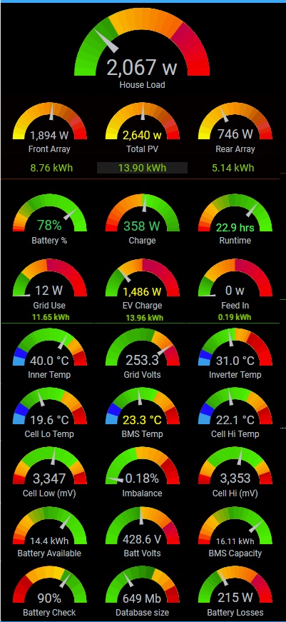

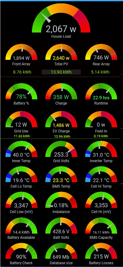

If you are really interested in the analytics, getting a Home Assistant would really benefit you - it is a small micro-processor based device running a bespoke home automation OS that connects directly to the Inverter via it's RS485 connections and provides access to a considerable number of sensors that you don't get on the app/website.
Without wishing to send you down a rabbit hole (they are very addictive), this is just some of the sensors my Inverter is reporting in near real time.
With this information you can get early warnings of over-heating, modify the minimum SoC's automatically, change the charge periods, a great many things.

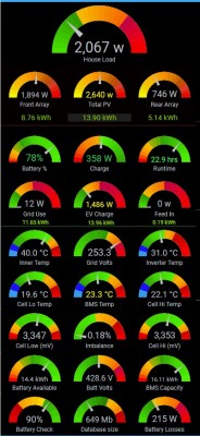

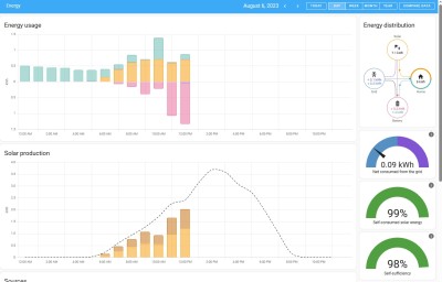

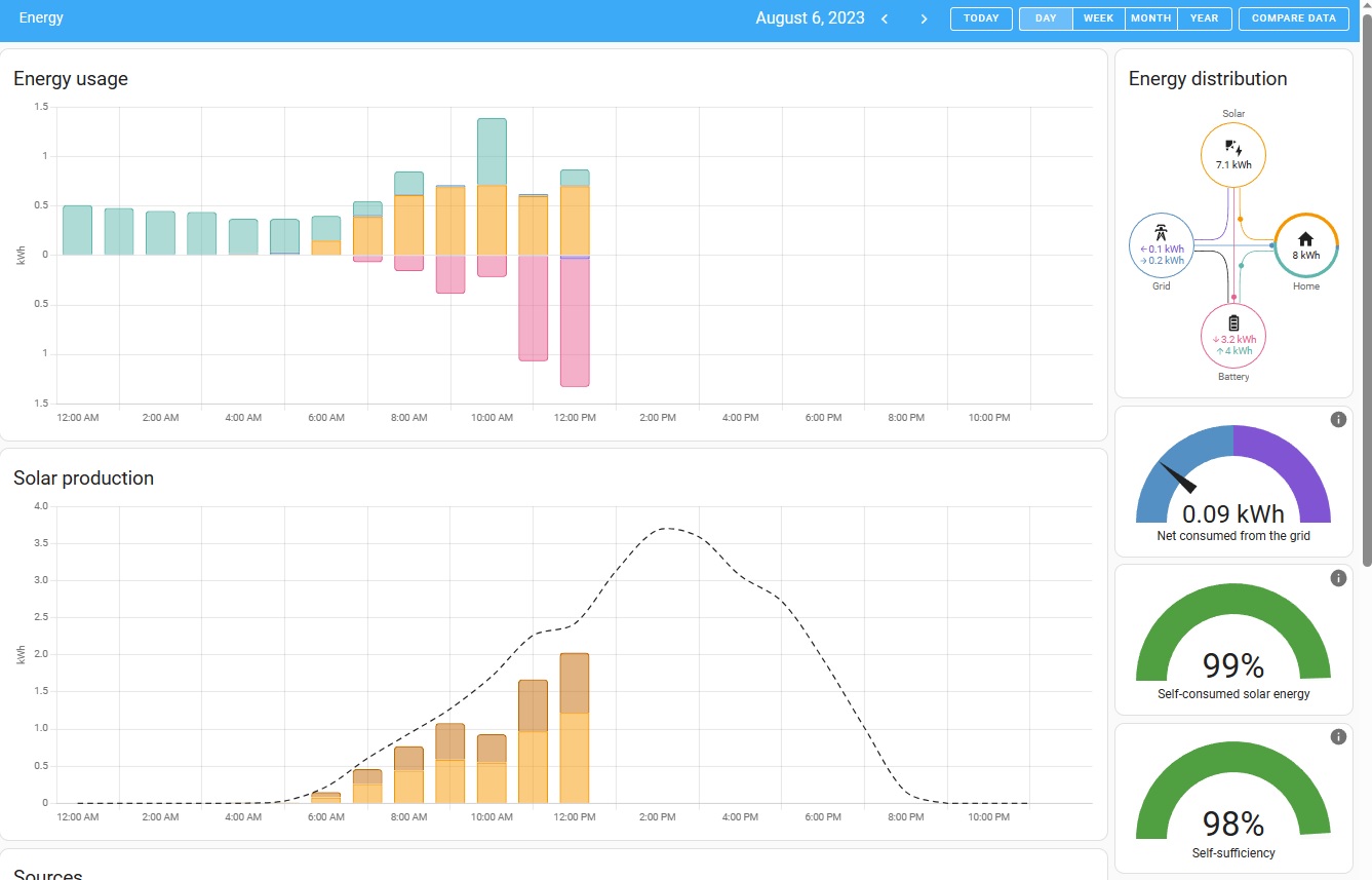

That's what the energy dashboard looks like for me today (not very sunny), and it does that 'out of the box' with very little configuration required, other than the decision of how to connect - via the cloud API (which used the FoxESS servers and it's 5 minute update cycle), or via RS485 for real time and local control.
If you have the mobile app on your phone you can send notifications to yourself, so for example if the solar forecast isn't enough to charge the batteries and you haven't set a charge etc..
if the inverter is connected via RS485, you will also have the ability to set charge periods, min socs, and you can do it automatically by writing your own automation.
With a bit of minor adaption you can create your own dashboard which shows only the key sensors, statistics and graphs you are interested in.
