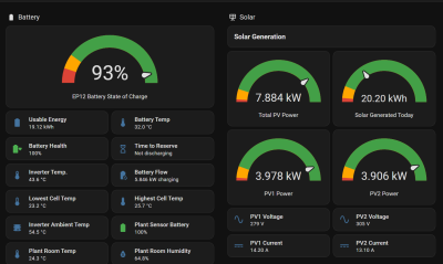

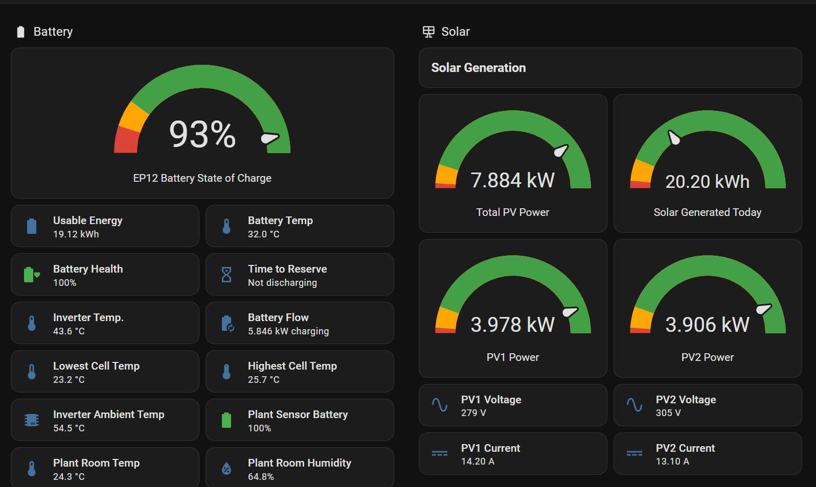

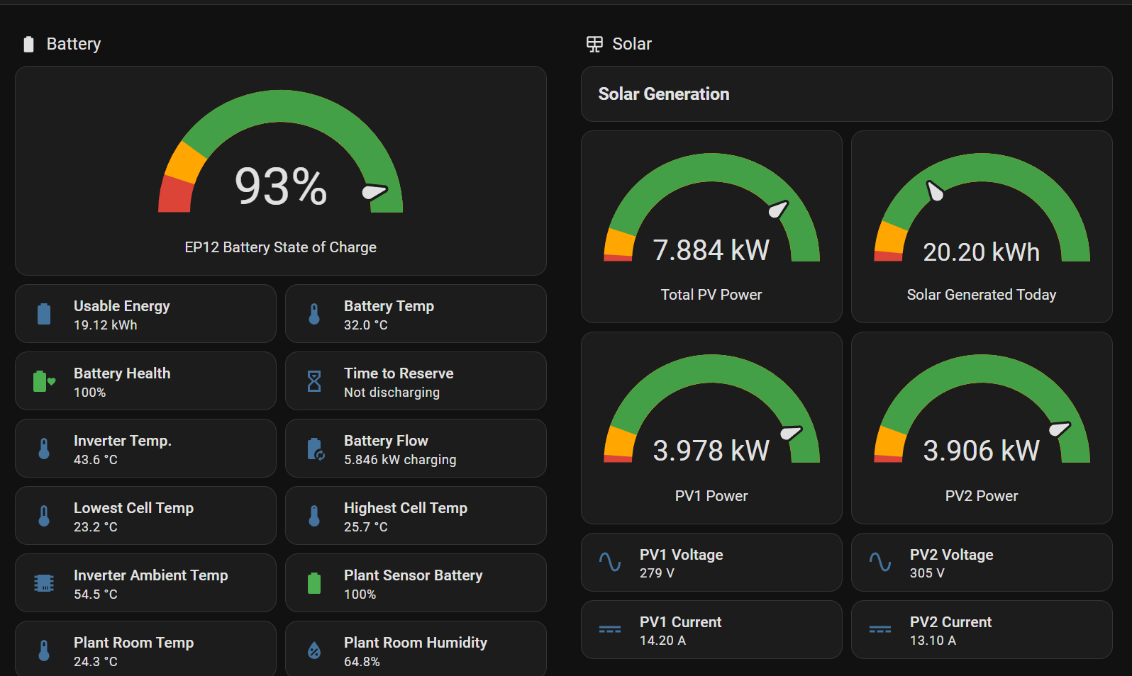

Well so far at least the system seems to be working pretty much as I expected even in this mini heat wave. I've 18 x 480W panels and seeing PV maintaining 7 to 8 kW, and it's staying reliably up there at peak times of the day so no derating currently it seems.
