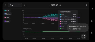

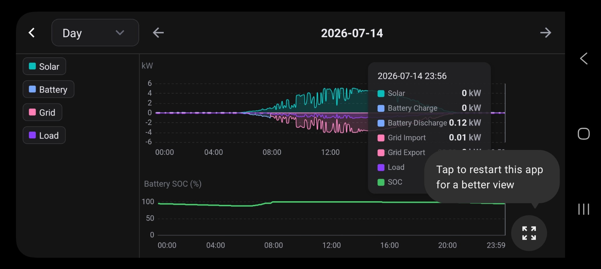

Can you show a graph image for power for a full 24hr period?
Re: system
does this help. we got home at 2.30am
Re: system
You need to click on daily production bottom left, select a random full day for stats for when you was away.
Take a picture, then scroll down that page to Statistics at the bottom (press the square on right side to expand)
This will show full day load, and then the Statistics can show either a nice rough baseload, or spikes that need looking at.

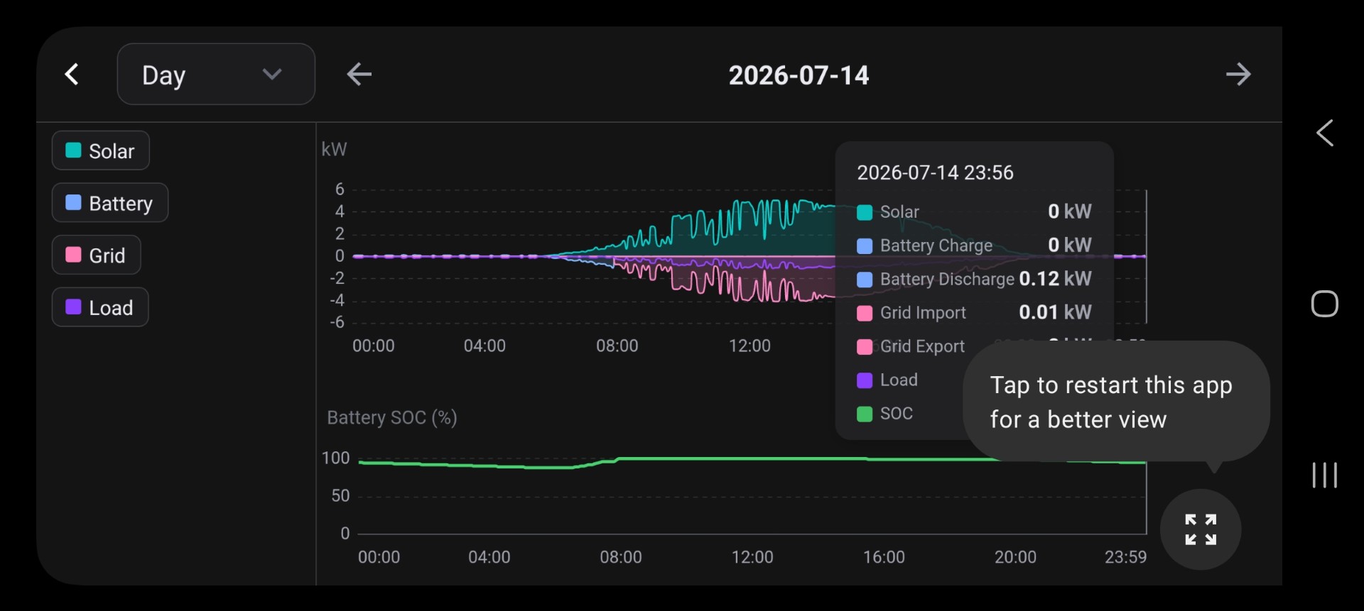

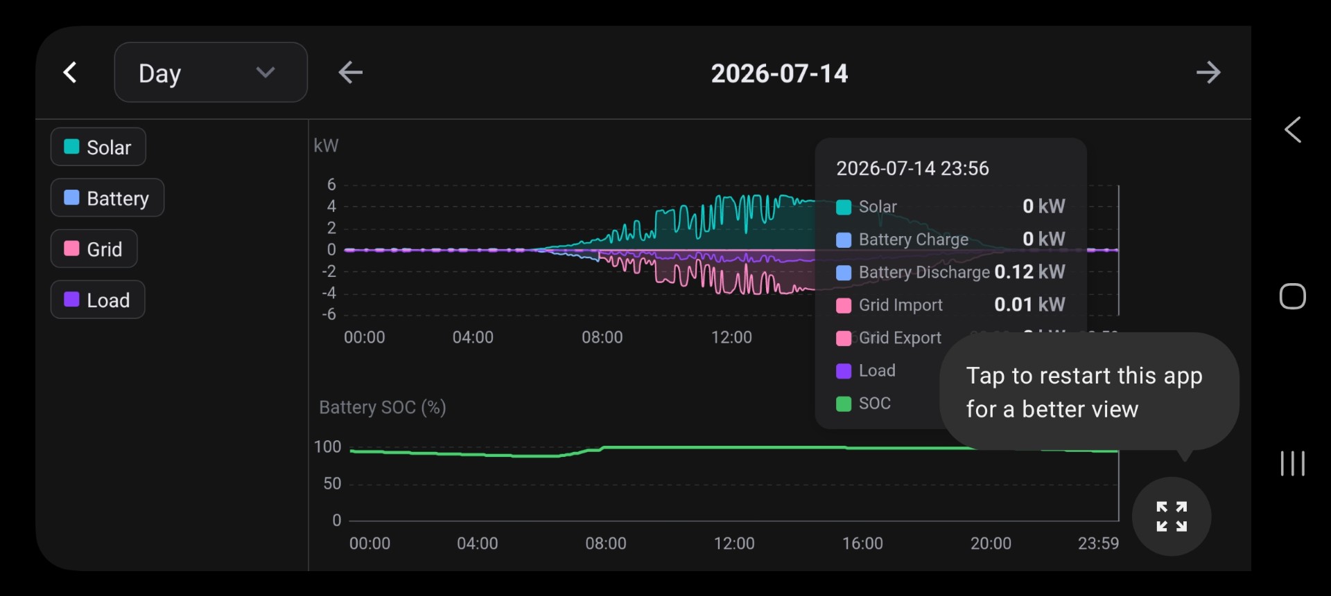

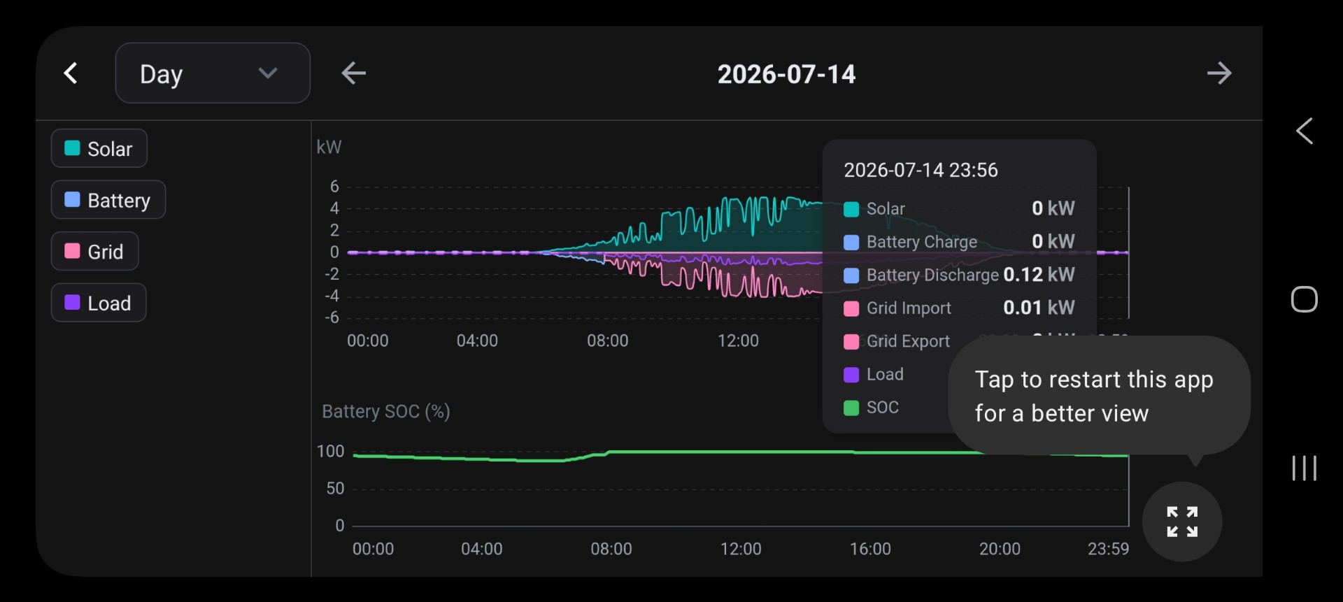

attachments below I think
Re: system
Both same :D
What was your Daily Consumption for the 14th?
You can probably see that your base load is low (click on 3am for example)
Then if you follow the Load value, it increases as your PV begins to generate.
Again, check say 9pm for house Load and check.
So click 3am, post Load value
Click 12pm, post Load value
Click 9pm, post Load value
So you have before solar load, during and after.
Suspect your Inverter is what is munching your load, increasing your Daily Consumption figures.

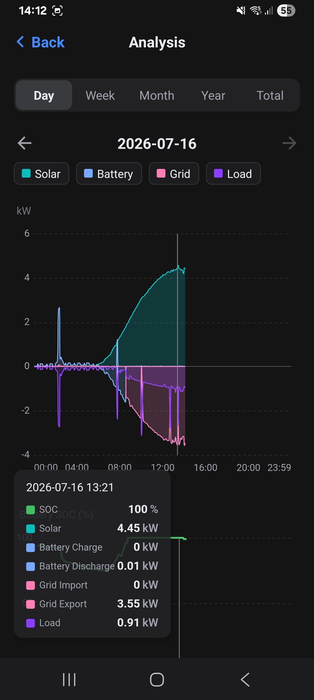

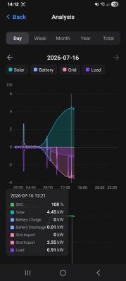

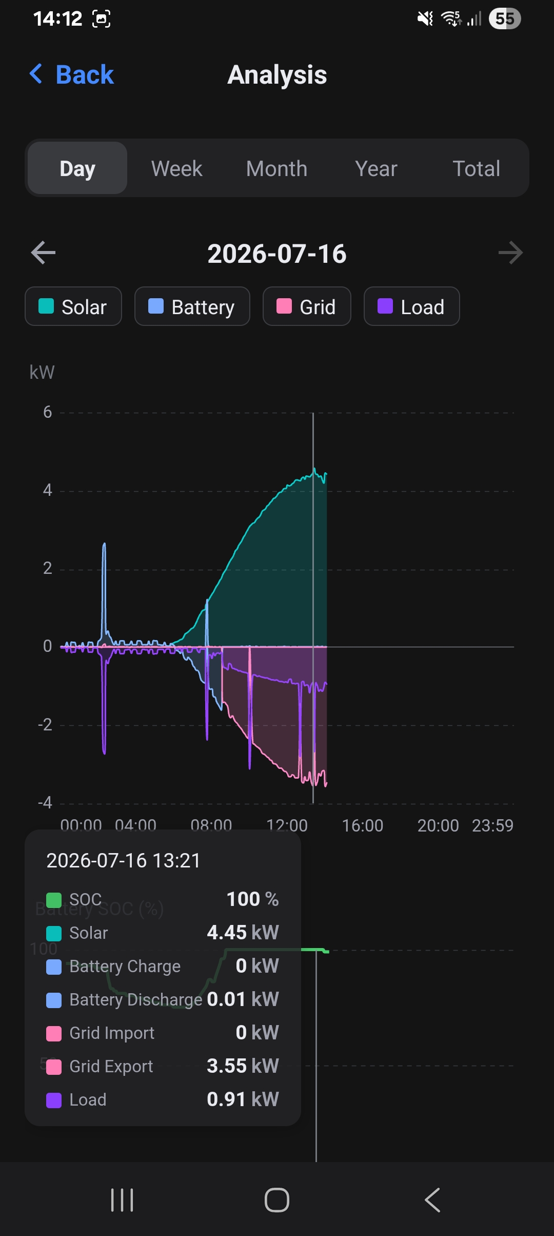

Re: system
on the 15th @ 3am 0.02
on the 15th @12pm 0.84
on the 15th @9pm 0.14
hope this makes sense to you. :roll:

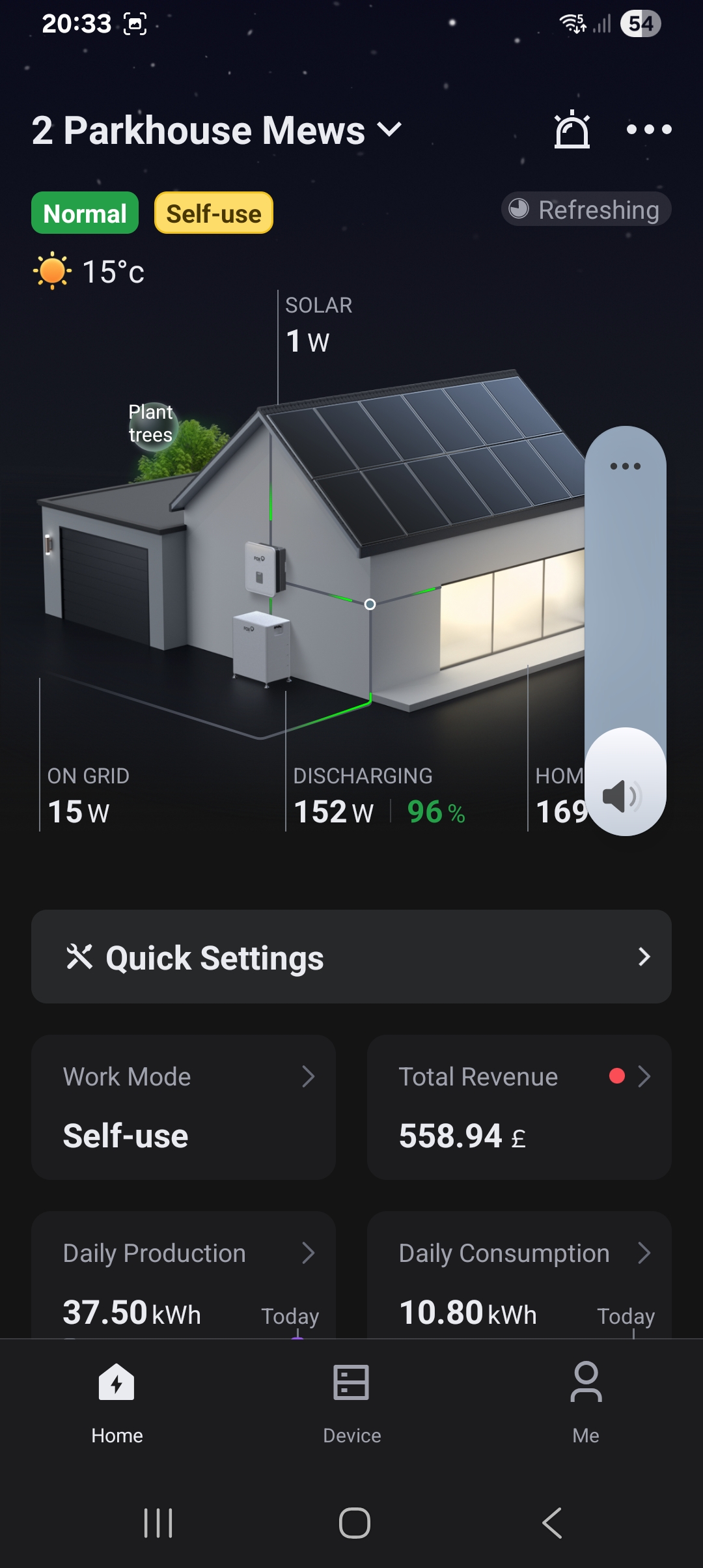

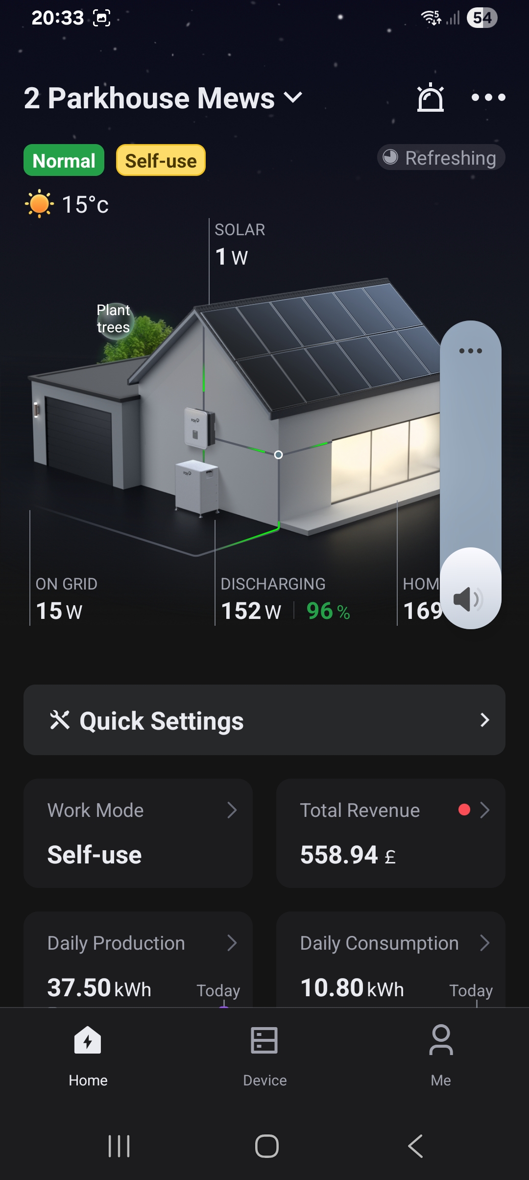

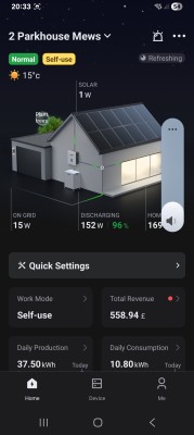

just done a screen shot as of now.
Washing machine has been on 4 times today and the kettle.
perhaps im getting a bit paranoid.
Re: system
davec wrote: ↑Thu Jul 16, 2026 1:44 pm on the 15th @ 3am 0.02
The pattern I was seeing in your 24hr graph, looks like little to no load 00:00 - 06:00.
As the PV begins to generate, your load goes up, as your Inverter is now doing more conversion work, DC -> AC.
As seen by your higher consumption around 12pm
At around 9pm, as the PV is going/gone, your system settles down again.
You can multiply the kW by 1000 to get Watts of course.
on the 15th @ 3am 0.02 = 20W, this is very low... Inverter doing little to no work, and router
on the 15th @12pm 0.84 = 840W, Fridge freezer was maybe running, and some other things, Inverter is doing a bit of work also with that value (hard to say exactly what your house was doing at this time)
on the 15th @9pm 0.14 = 140W, looks around average for a fridge freezer working
I would recommend if you are heading away, to set your Battery max SoC to around 80%, leaving it at 100% for too long will damage the cells long term.
Just seen your recent post, I don't think you are being paranoid, but do look back over the week's logs to check for any big spikes. I think your Inverter was using a fair amount, but that's normal.
