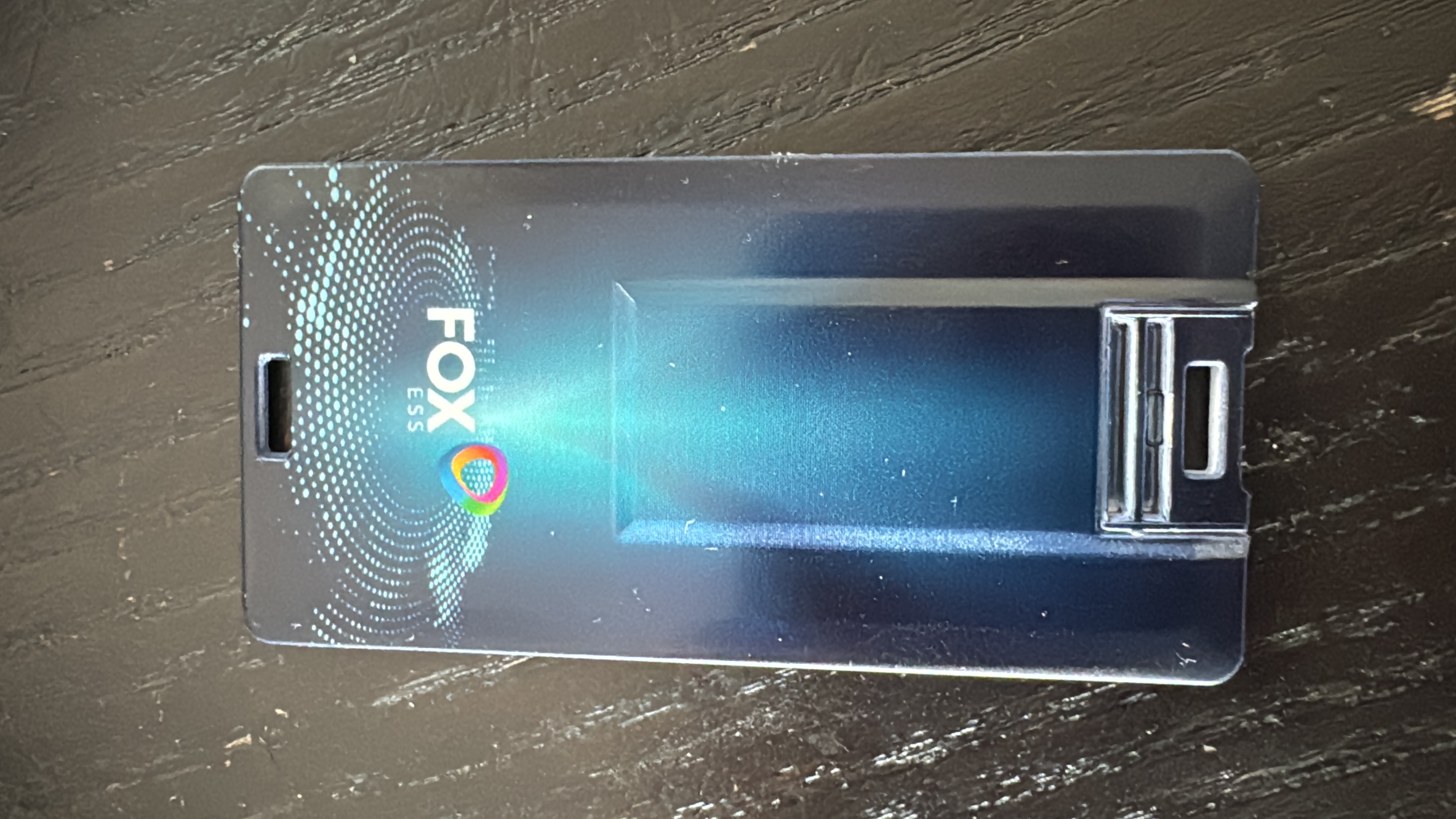

Received the slimmest USB I’ve ever seen.
Am I supposed to snap this out of its card?
