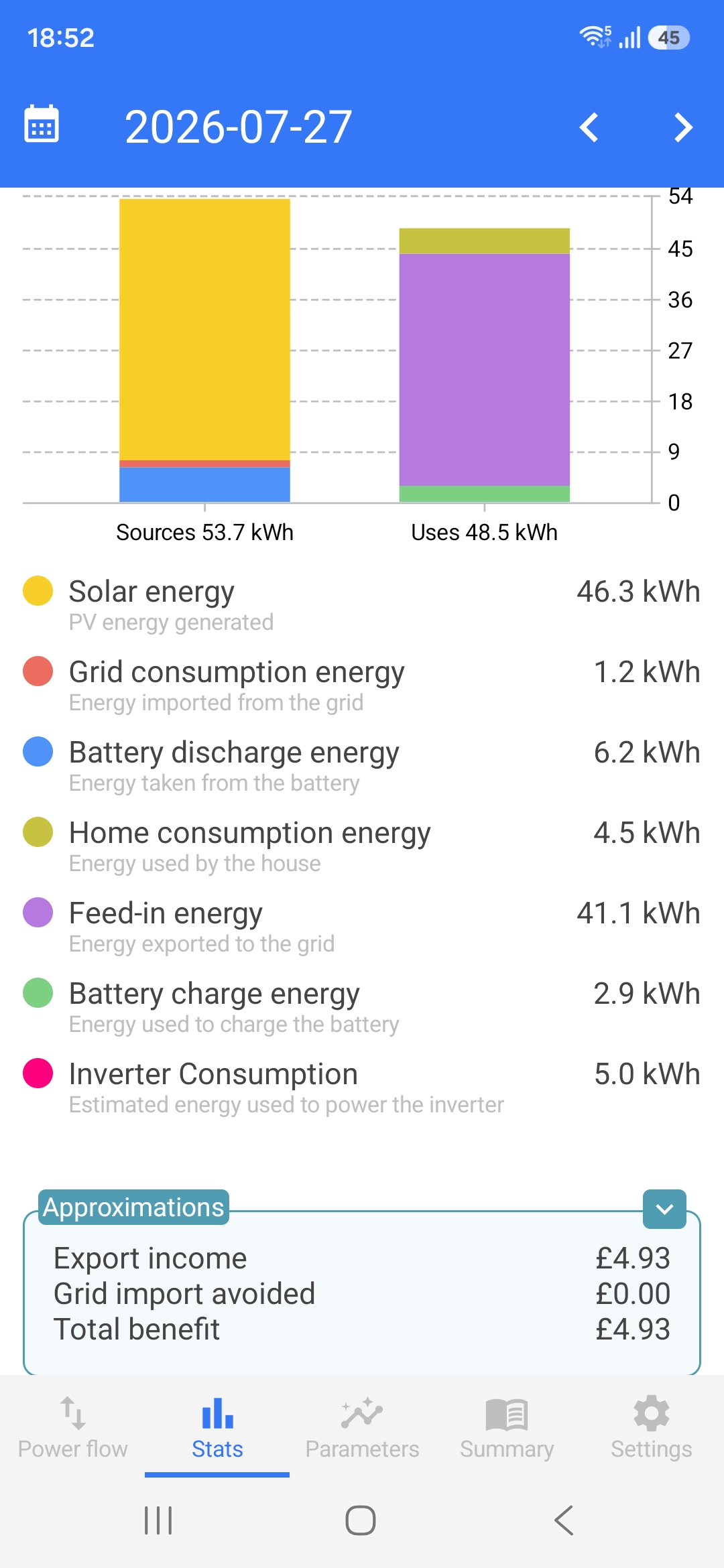

Re: Large Increase in Energy Use Since Installation
Do you use energy stats?
My 3 previous days inverter consumption there are 5.0, 4.1 and 5.0
spiral wrote: Tue Jul 28, 2026 6:12 pm Do you use energy stats?
No, I don't use it.
Do you have a screenshot of these 3 days from the App?

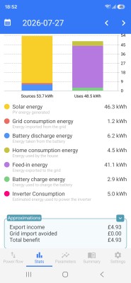

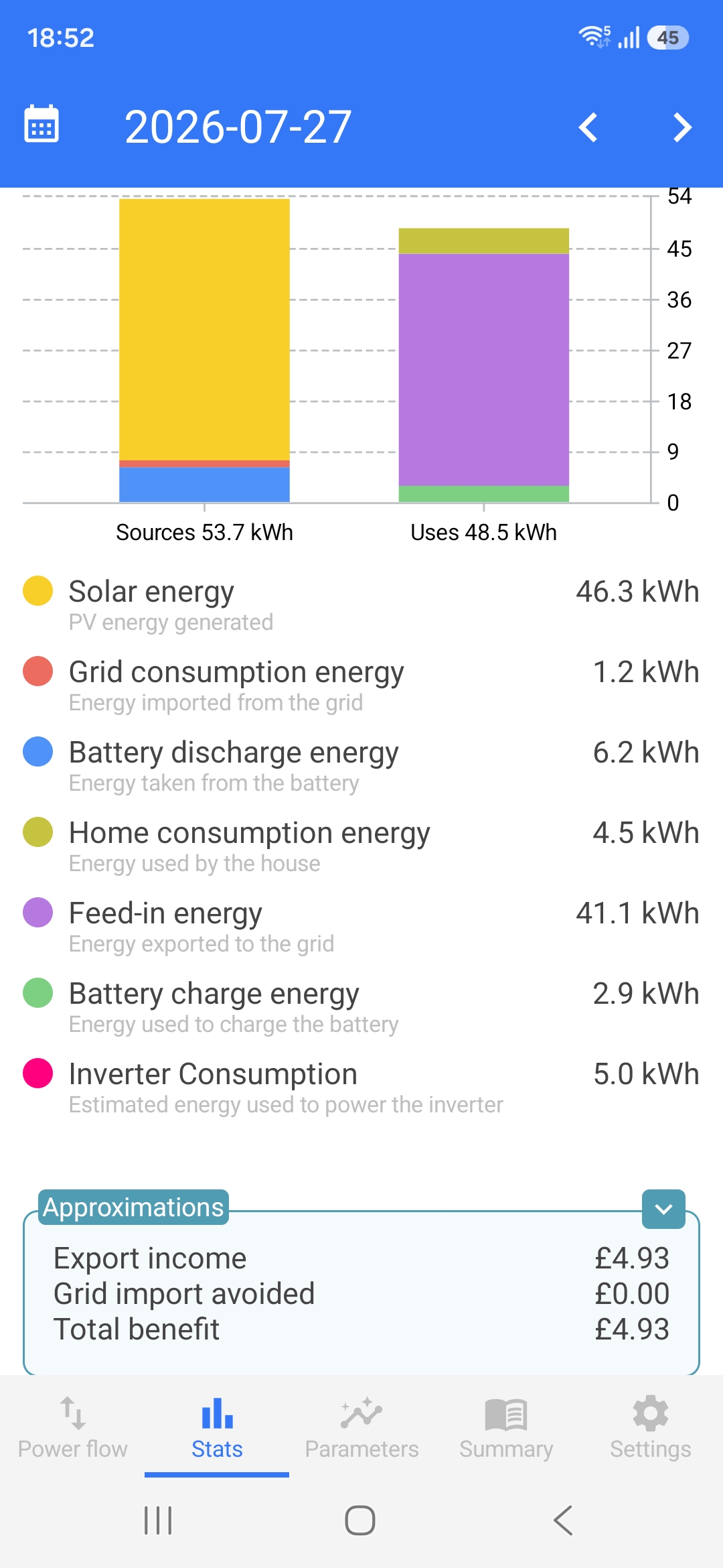

Here's yesterday's
I checked energy stats for yesterday, it claims 5.7kWh to run inverter.
I don't personally care still if that is accurate, I am happy to still calculate the ROI based upon PV self-use/export supplied by Fox.
You can grab figures from the energy stats app, and deduct this from your ROI figures if you like in your spreadsheet.
I am not 100% sure, but I think MCS calcs that installers use and supply to you, include a baked in 10% loss.
