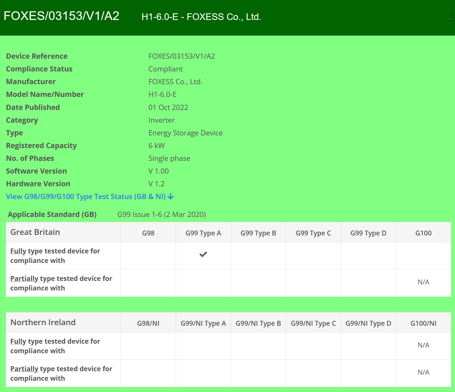

However as far as I can see, the H1 family of devices are not G100 certified eg
As such, if I want to upgrade my inverter I assume I need to do the G99 I would have had to do last year, had I known what I know now? (with the possibility of getting told "no", of course)

Hmmm, here is a G100 declaration for the H1 and AC: https://cdn.shopify.com/s/files/1/0257/ ... 1675684985

The G100 would make sense, although 'technically' you could upgrade your inverter, leave it's safety set as G98 and make sure an export limit is set to 3680W but some DNO's don't seem to like that, some prefer to see a meter installed rather than a CT, and others agree - in that scenario all in-house use is 5 or 6kw (depending on inverter), export is limited to G98 (16A).
Personally I would go with the 6kw H1 then you've got lots of capacity and capability to fast charge your batteries, it's only a few pounds difference and you'll likely need to uprate the cables anyway. The decision around the G100 / G99 I think will depend on a conversation with your DNO - G100 if you consume a lot more than you export (and the DNO agrees), G99 if you want to add a few more panels and export more power.
The DNO's are often quite helpful and will point you in the right direction, and you could ask whether they would accept an upgrade to bigger unit if the G98 safety and export limit was set - in which case you don't need to do anything other than get your installer to change the inverter.

Thanks for the thoughts. Sounds like I do need to call the DNO at some point then, see how they "like" to do it. Do you have any idea why there is a G100 "declaration" for the FoxESS inverters but no evidence of them having being tested to that - seems odd!

Yes it's an odd one, for G100 there is no accreditation, it's more like a set of guidelines that are 'in addition to' G98 or G99 - so in effect it's like a G98/9 'plus' as long as the DNO accepts the principle.
I'm with Scottish Power and this is their take on what it is acceptable https://www.spenergynetworks.co.uk/page ... _grid.aspx but sadly every DNO seems to have their own take on it.
