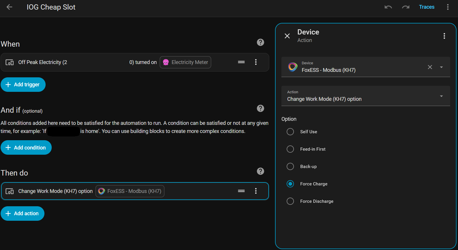

Can you share an image of your automation?
Example...

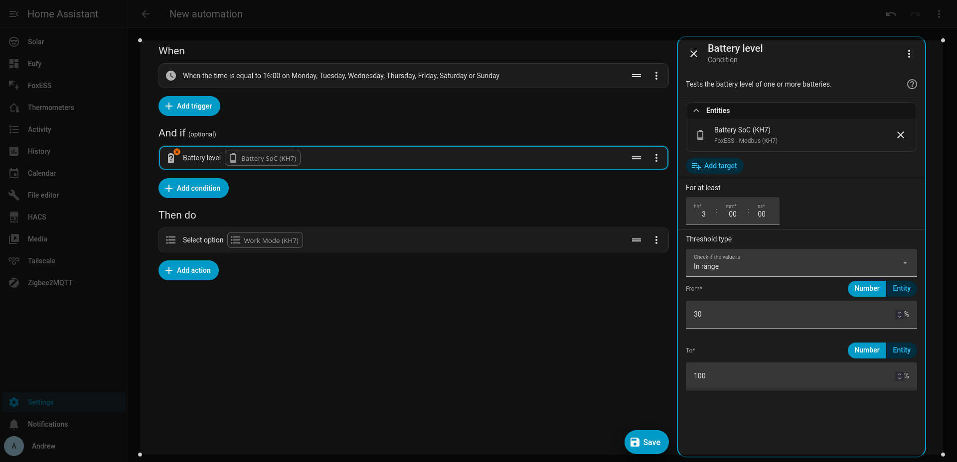

So something similar to this... (except this reads as 'above' or 'below' for SoC)
1. Set a time for 16:00
2. Have the And if check for SoC values above 30% (so that is does not begin to discharge if battery is lower)
I have it set to check for 3hrs, that should take you to 19:00
3. Set work mode on inverter to discharge
You will then need to recreate the above again, except you have it check for a below SoC, 30% and have it change work mode to Self-use. I am not an expert, but you can try to set something up, and test it out.

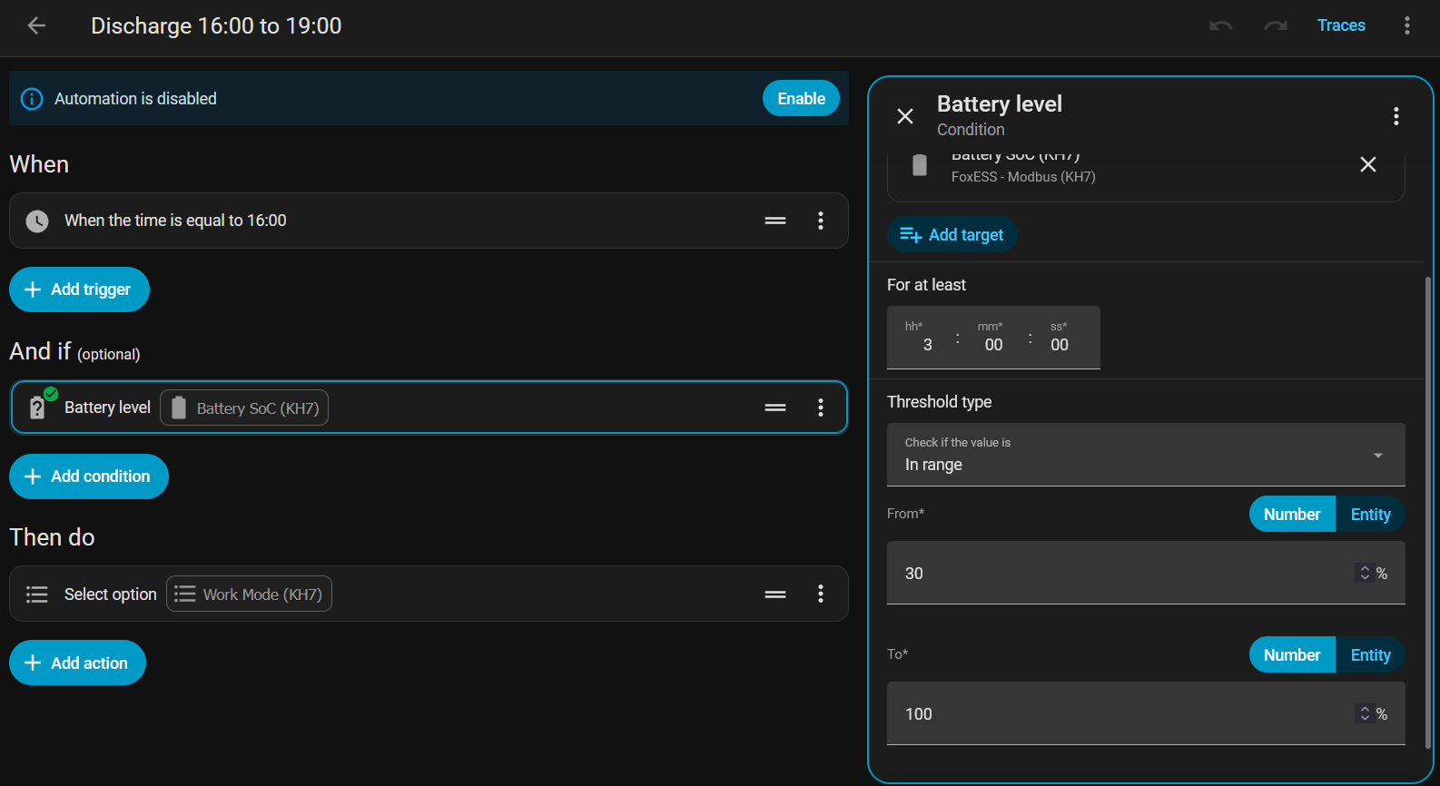

Thank you. I am giving it a try now, but I keep getting an error which is that when ever I include the battery SoC I get a red X saying condition not met (despite it matching your example.

Re: Use Home Assistant to control force discharge down to 30%
Thanks, screenshot attached.
Check this video, note exactly what is pressed.
Also might be worth just doing 'Above' 30%
Then on 2nd automation, with same time, have it set to 'below' 30%, and set different work mode of course.
Thanks, but that is exactly what I have done and it still gives me a warning saying the condition has not passed. Something must be causing an issue somewhere, I'll disconnect and reconnect everything and reboot home assistant and my inverter over the weekend and see if that clears it.
