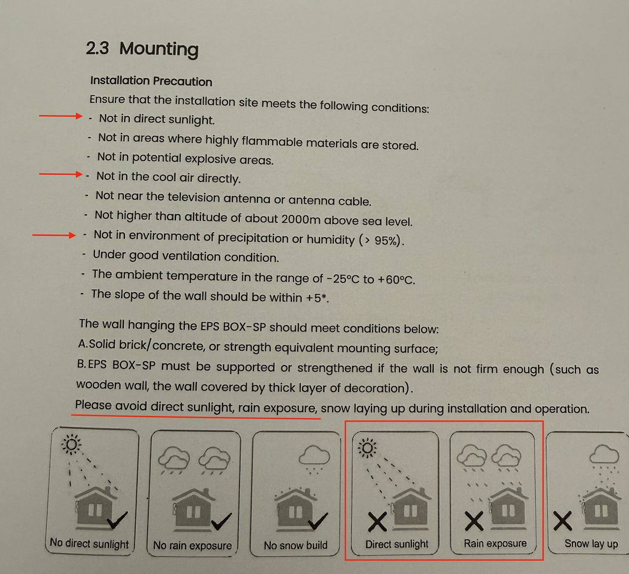

I asked my installer if this should really be fitted outside, as we are coastal and everything metal rusts,
they said no problem the boxes are fully IP66 and meant to be installed outside and close to mains supply.
I found an installation manual, which essentially says install out of direct rain & sun ... I have both ... so am a bit worried.
What did your installer advise?
