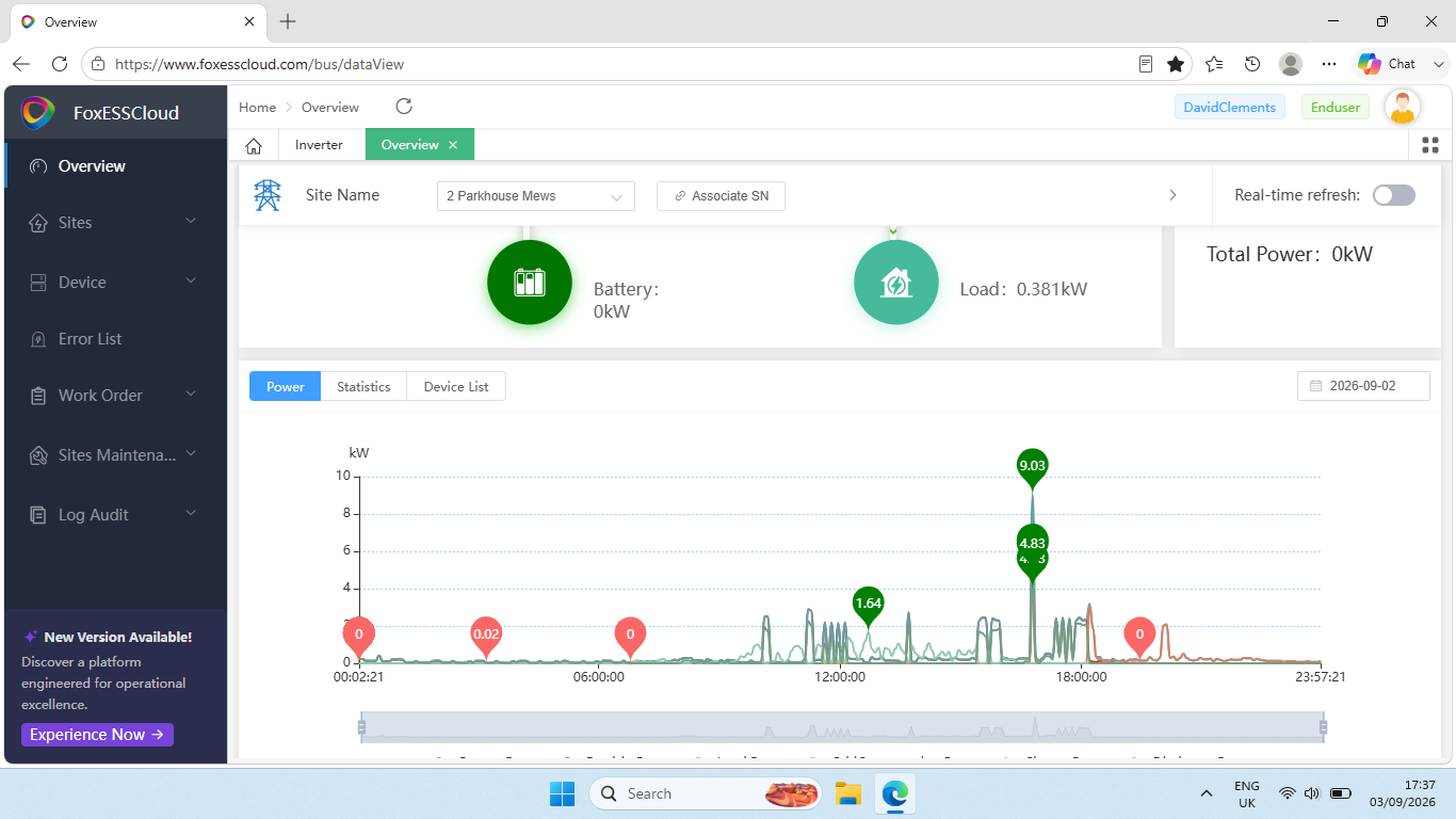

Re: picture
I have attached image 1857.jpg (2026-07-12)
In section 1 - This looks like normal house use, you can see Fridge Freezer cycling on/off
In section 2 - This is charging up the battery to 100%, you can see the purple load below the 0 line that looks like Fridge Freezer cycling, note above the line, the battery is no longer discharging as solar is covering the load.
In section 3 - The most interesting section, you can see the purple lines below the 0 line sharply increase once the battery reaches 100% SoC. What's more interesting is the load value increases during the day as the solar increases. Find out what is happening is what we need to find out now. It looks like excess solar is being diverted into a house load, like a water heater or something? You can see your load around the middle of the day, is close to 1000W.
In section 4 - Same as section 1, now that the solar has stopped
You may have to set your home up as you left it on holiday, wait for around midday on a sunny day. Open up the FoxCloud2.0 App and look at the house load, it should be close to 1000W. If you do see this kind of load during midday, you then need to carefully turn off circuits on your fuse board, one by one. Wait each time for the app to refresh (hopefully you have 5 second refresh rates) and then turn off next circuit. Repeat down your circuit board until you finally have the one that drops load down to 100W or less.
Once you get the correct circuit, you can then investigate what is plugged in/wired up to it.

Re: picture
It's definitely not your fridge freezer, that seems normal from your values. You are correct that there is DC->AC being converted for export, but the load of nearly 1000W is way too high for your inverter.
If you have 5 second refresh rate firmware on your inverter, then you will see on your FoxCloud2.0 App the (almost) live power readings. With that enabled, you can turn off circuits until you at least find one that is using the near 1000W at peak solar.
DIY stuff, just note if you turn off the circuit to your router, then you will loose ability to check. So try to power off lighting circuits/cooker etc first.

Re: picture
Graft from yesterday.
