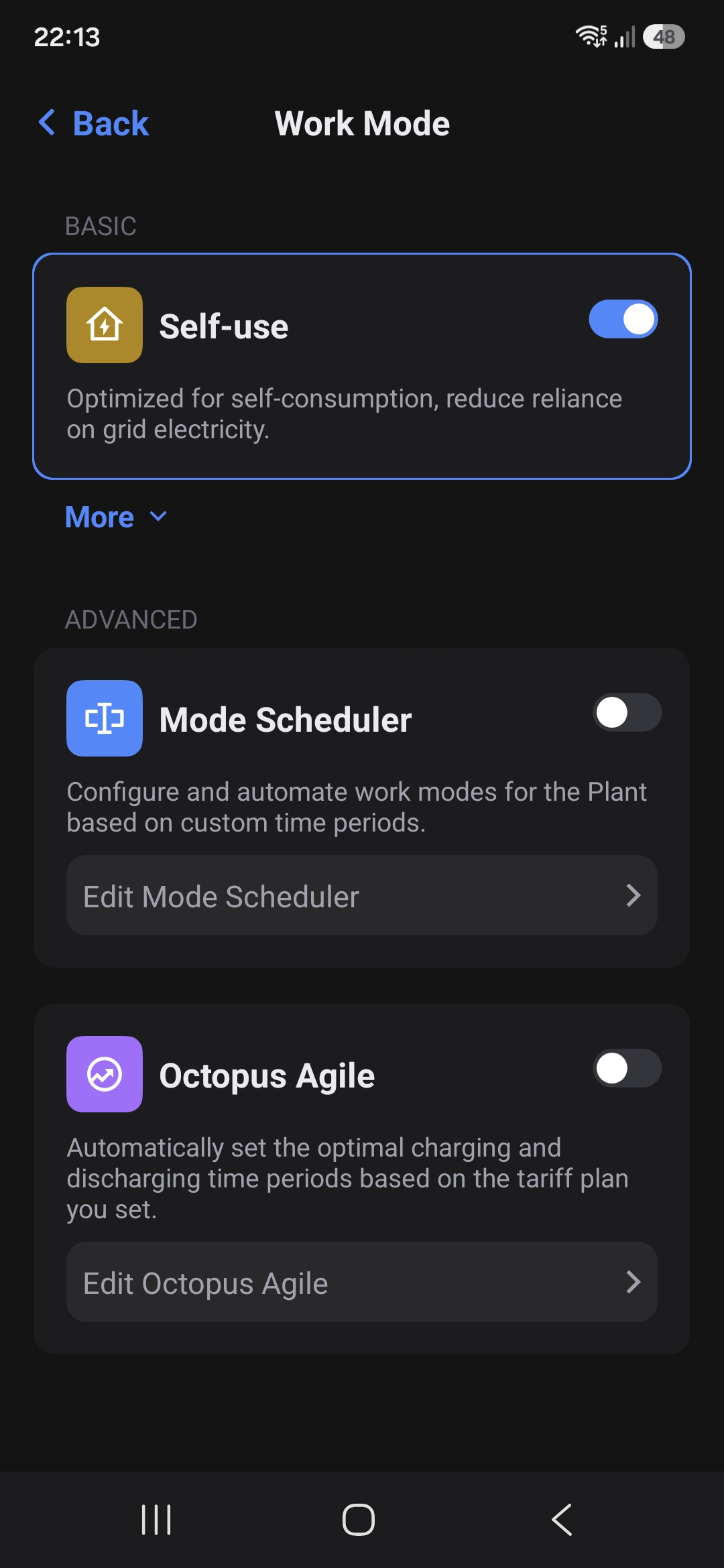

Ah not strictly 'Self-use' you are using Mode Scheduler, that is programmed to charge/discharge.
I have mine set to on demand in Axle, so not that.
Are you saying it swaps to 'Self-use' after events? Rather than back to 'Mode Scheduler' (See below for clarity)
If so, might be worth pinging a message to Axle support to ask what's going on.
Just for clarity, there are 4x 'Basic' Work Modes:
Self-use
Feed-in Priority
Back Up
Peak Shaving
Then you have 2x special modes under 'Advanced'
Mode Scheduler <-- What you are programming your charge/discharge with
Octopus Agile
seems so....after the grid event it switches to self use which in itself is annoying BUT the schedule that I set (forced discharge from 00.00 to 02.00) has gone, replaced by THEIR schedule from - in this case - tonight which was forced discharge from 19.30 to 20.30.....which I am finding very irritating as repeatedly resetting to my requirement takes time and should not be required

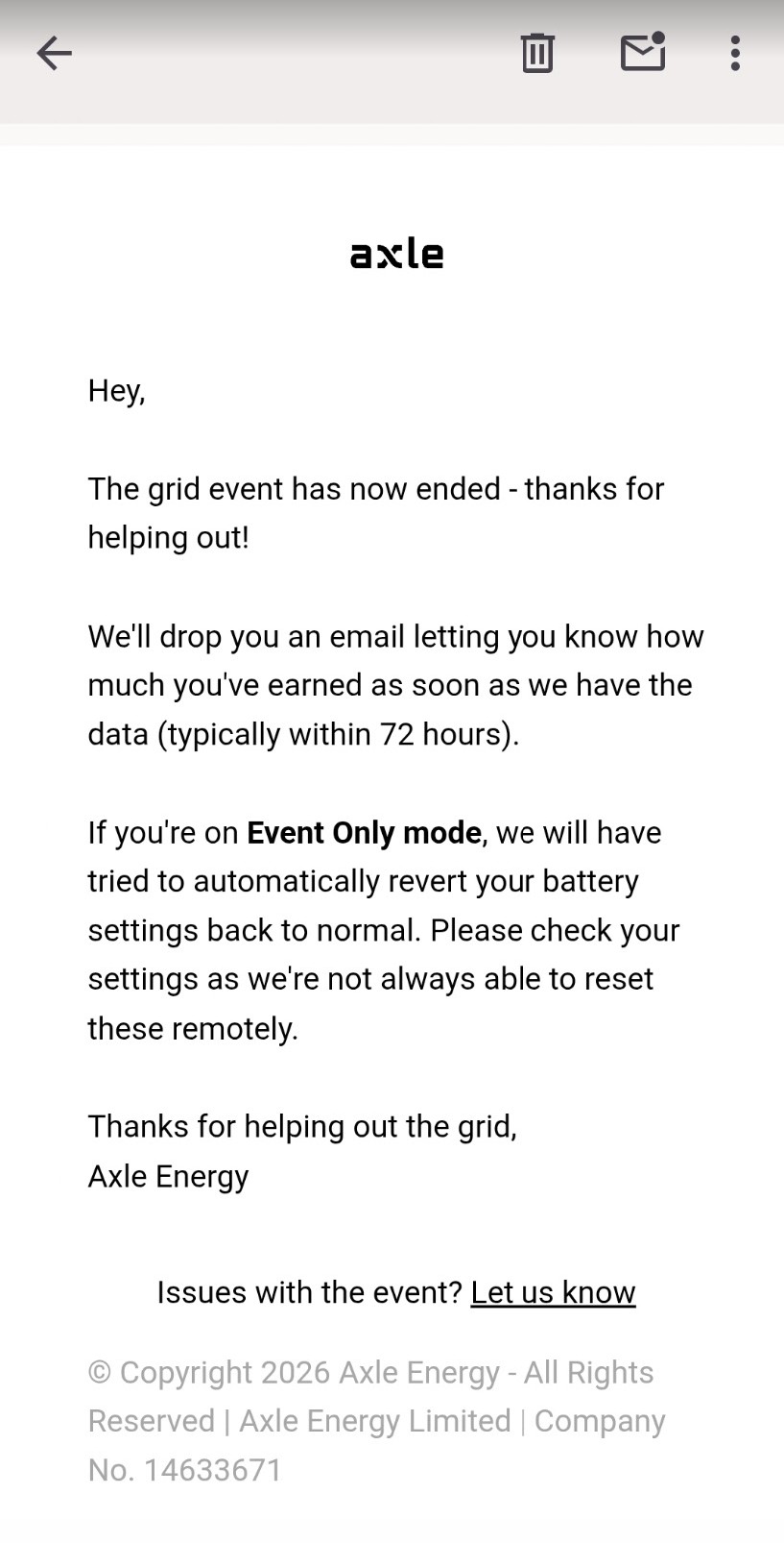

All they could offer was this

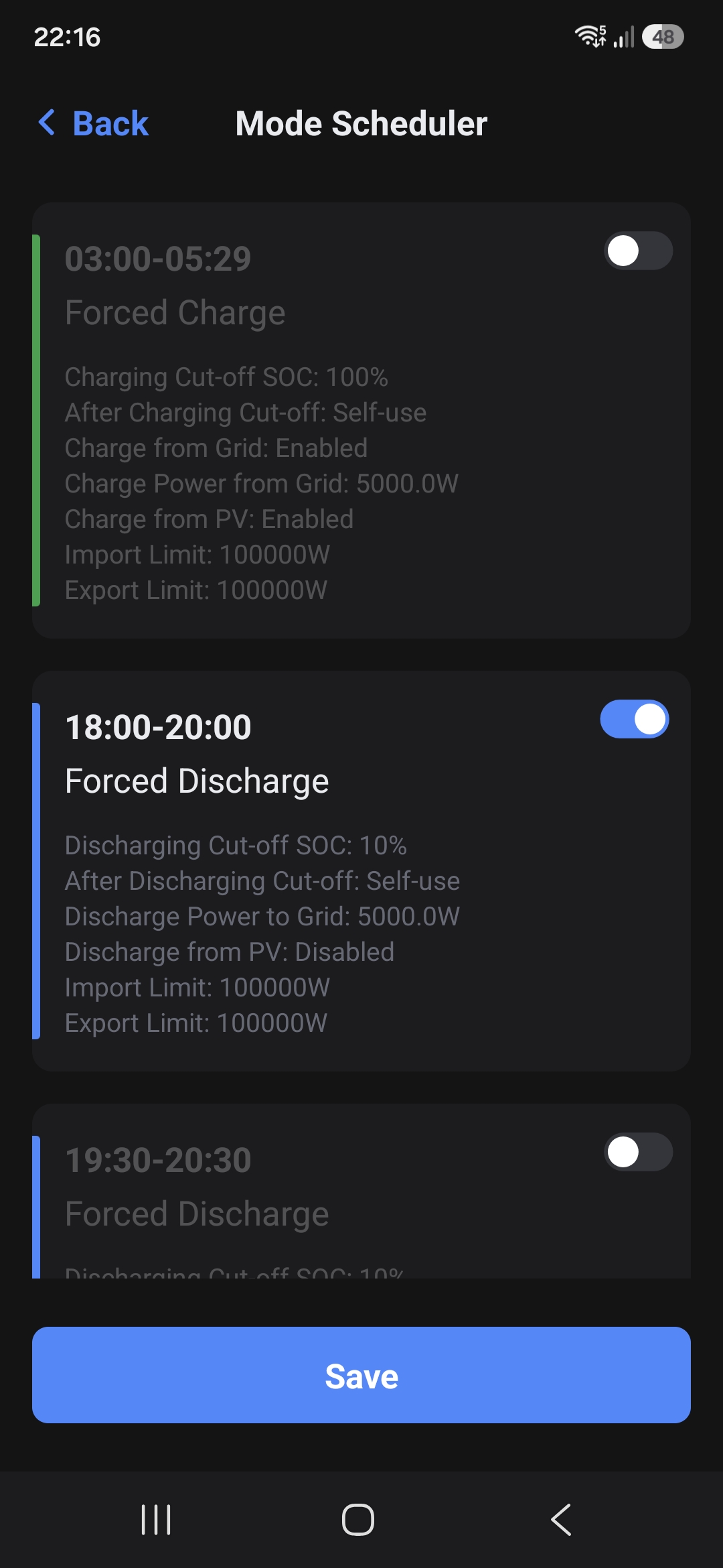

For me, in the FoxCloud2.0 App, the existing time slots programmed are not removed. They are 'turned off' via a slider, so next time you see an event, and it finishes, can you take a picture of your mode scheduler and see what is there?
It has returned to self use.....surely it should be mode scheduler IN self use mode.....

Mine pops back to Basic Self-use, seems that yours does too.
At least you just need to enter the advanced mode and just toggle the exist schedules on again (you can erase the 18:00 - 20:00 they added)

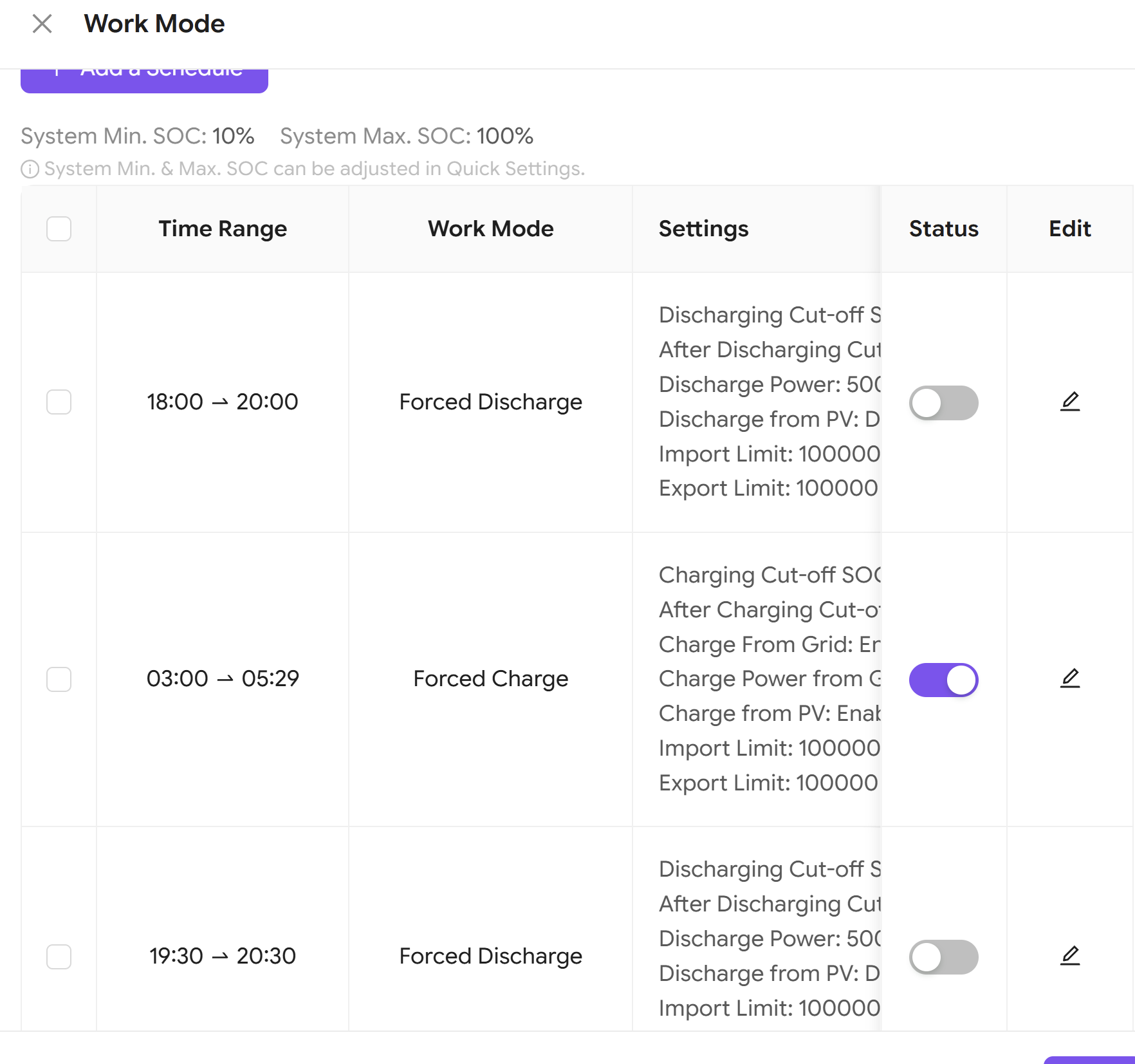

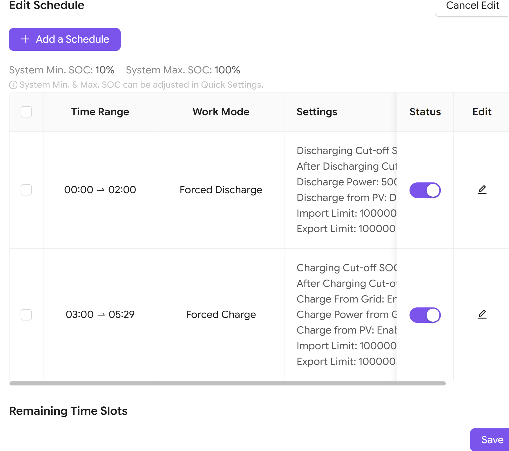

To clarify
After tonights discharge the Axle system has again deleted (or changed) the forced discharge schedule I had set up.....and also set it back to self use rather than returning it to mode scheduler as I had it.....
PRIOR to the event I had a forced discharge set between 00:00 and 02:00 and a forced charge set between 03:00 and 05:30 as below
After the event it has changed (or deleted???) my forced discharge schedule and also left previous Axle schedules in the list although not active
