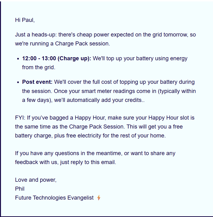

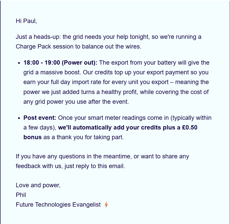

A known case in point - there was a Charge Pack session yesterday evening and they'd typically charge the battery during off peak hours once the session had completed. They didn't do that last night. The battery ran all the way down and the PV is now charging it. And again looking back, that seems to have been the case since 8th September...

I am guessing that the charge pack add-on for Octopus is doing this automation? It's a newish feature that I am aware of, but don't know in great detail. Perhaps it's still going through some teething issues (the PV covering load only?)
After rebooting, I guess next step is to unpair and rebind in Octopus account, and if that fails, then you will have to contact Octopus for support.

Yes exactly that. Octopus make a point of stating this with every notification they send on the Charge Packs sessions, essentially making customers believe that they'll not be out of pocket letting Octopus control the discharge/ charge processes. Or at least they did. I've just checked the emails from them and the messaging changed significantly between 5th September and 7th September.
I contacted Octopus yesterday, not one to sit on my laurels. So awaiting to read their comments. The more I look at this, the more it seems like it is something they're doing.
