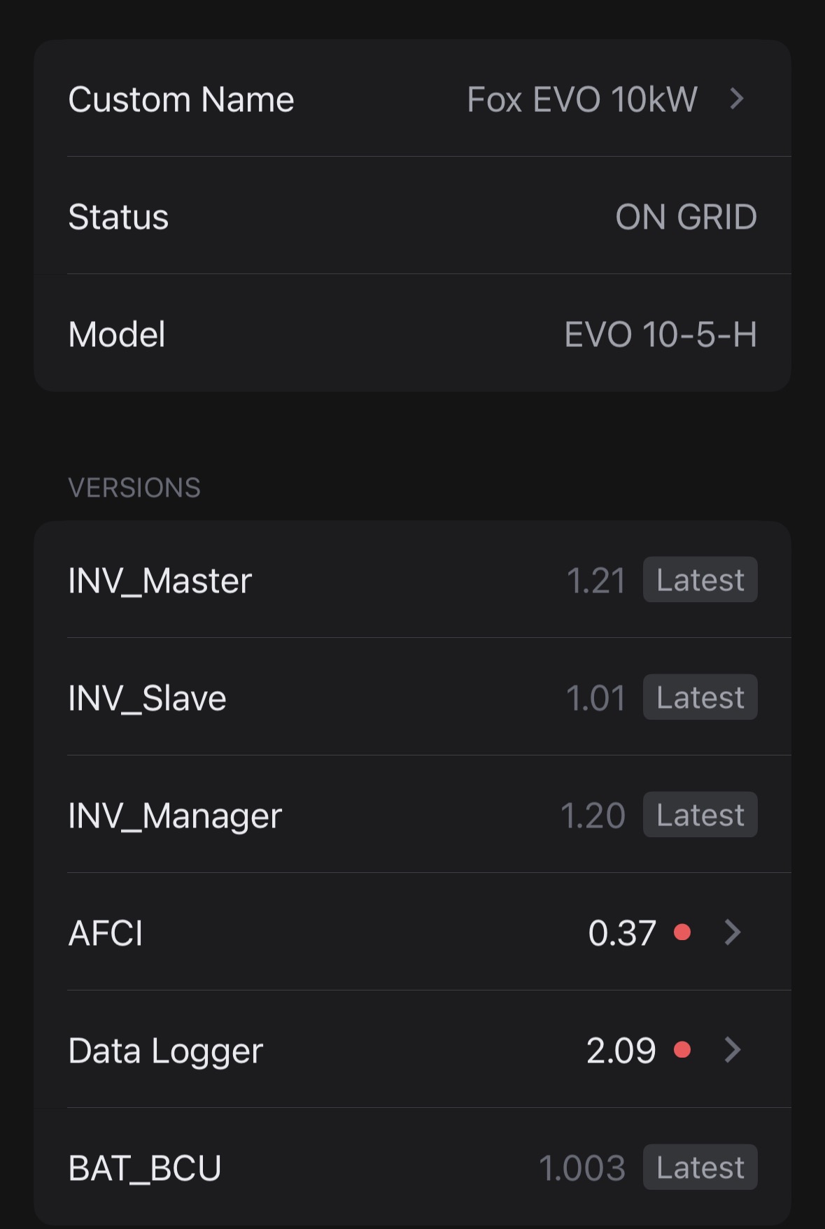

Re: Evo 10 Inv_Manager Firmware issue 1.18
Well it’s been a while! A firmware update!
I will NOT be installing this for at least a few months this time! 😂
