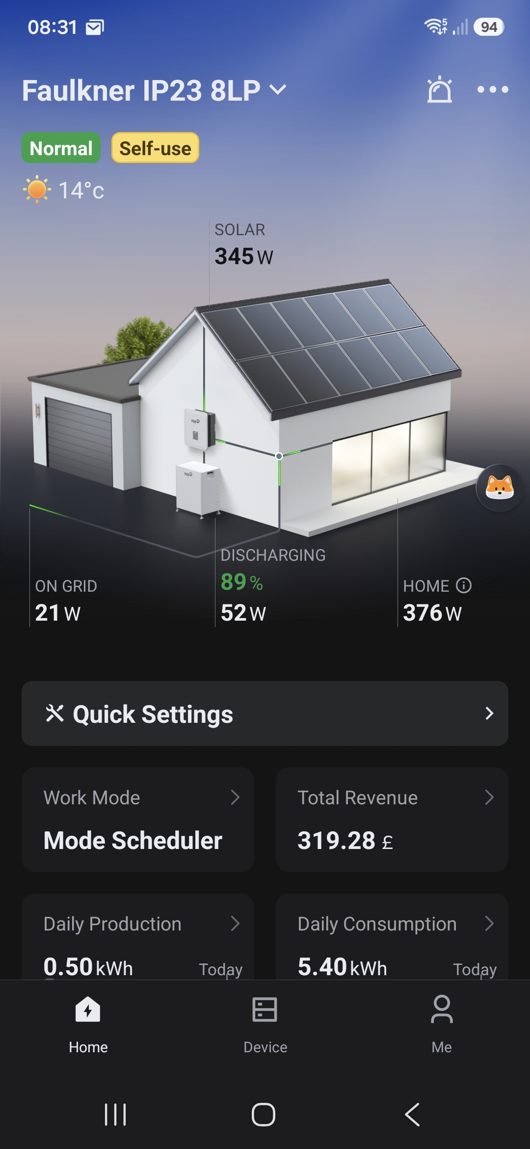

example from this morning - and apologies for the disgusting state of my windows! - I am generating a lowly 345W

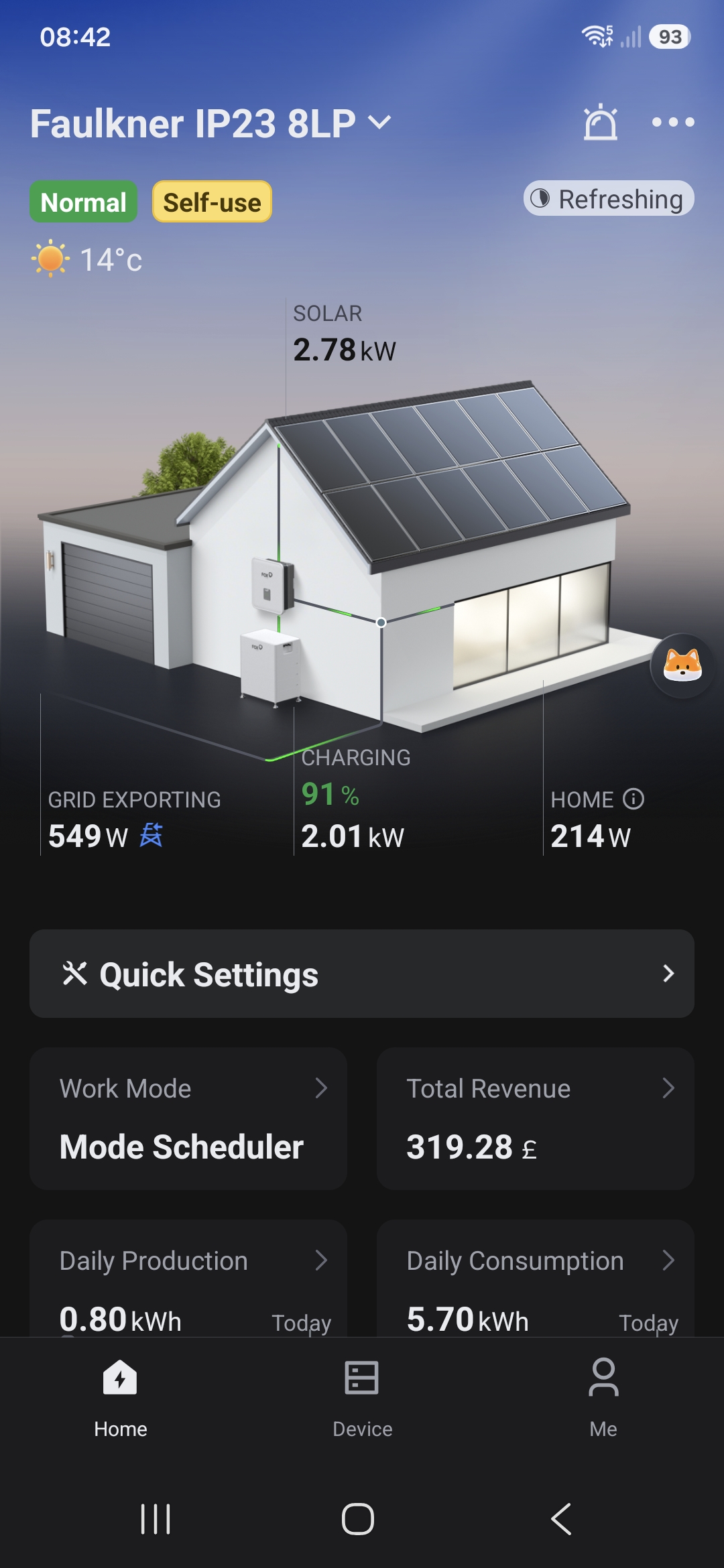

literally 10 minutes later and I am generating 2.8kW....same apparent level of sun, no cloud, light level looked the same

In devices/inverter/ real time/ the PV is showing around 200V but the current draw is miniscule and therefore the output power is also almost nothing
Could it be something with the MPPT settings in the inverter ????
