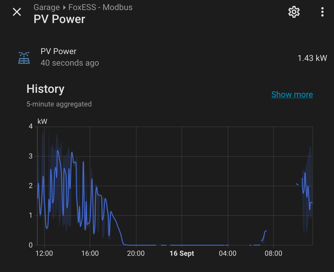

I seem to be getting some odd behaviour recently.
I keep getting very intermittent data coming into HA.

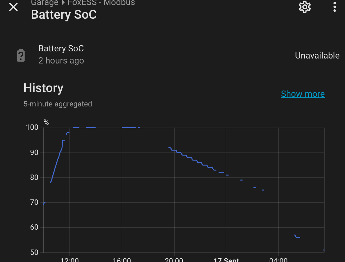

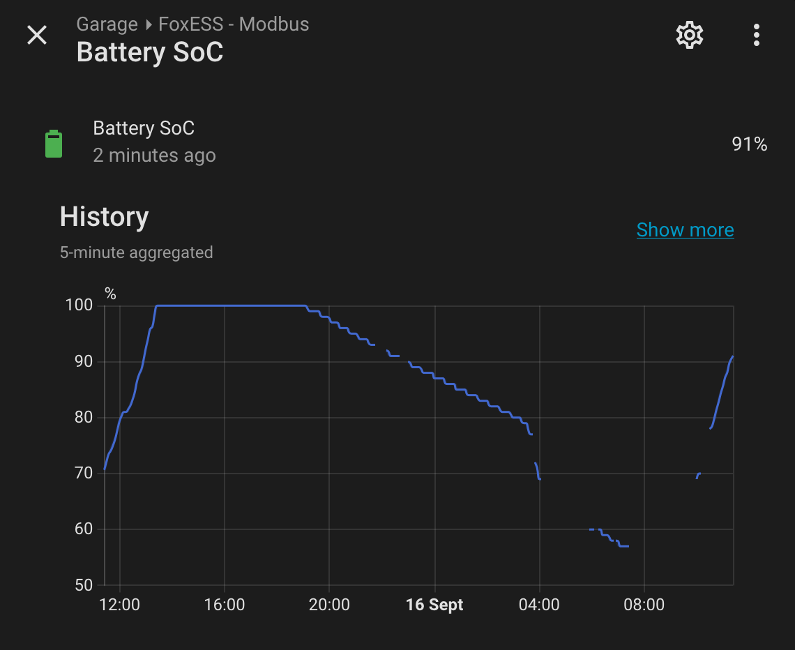

After a restart or just some amount of time the data comes back but only for 3-4 hours then it may be very patchy for a period of time. I can't seem to pinpoint the exact issue, it's been working faultlessly since day 1 when my solar system when in a few year ago.
