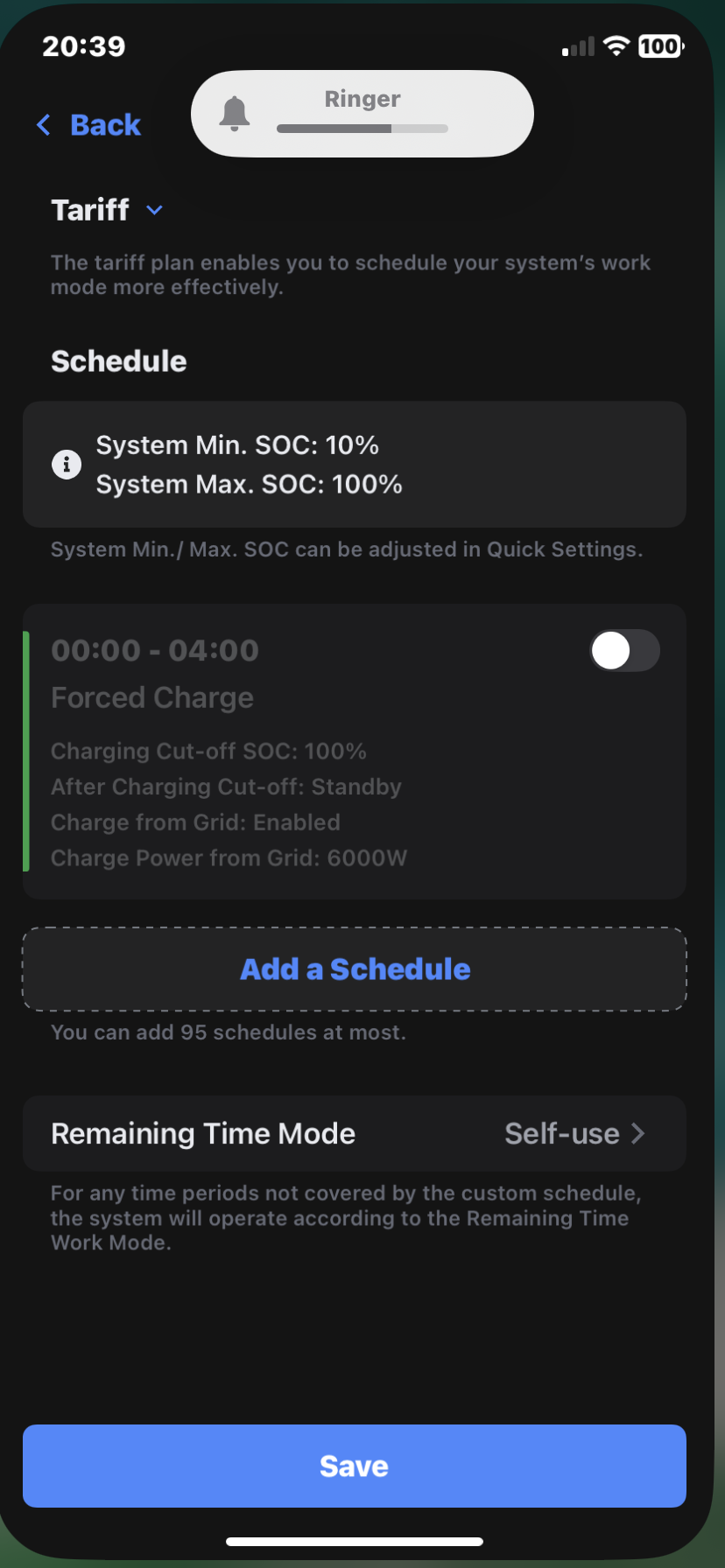

Can you post any schedules that you have set, along with your default minsoc settings - also worth double checking that the time shown on your inverter screen is correct
Hi Dave
I have
Heat Source - set for all day
DHW - set fro 6am to 7 am and 4pm to 5pm
Circuit 1 which is set from 6am to 10 pm
Silent Mode - set from 10pm to 4am
I have attached the Munson setting

Your scheduler is not set to charge during the night, given that you don't charge at night currently, what happens if you set the system to 'Basic work mode: Self-use'
As it is almost 9pm when the battery goes into standby, now would be a good time to swap work modes and check. If you have the 5 second refresh of live data on your FoxCloud2.0 App, then you will see quickly if the system is discharging from the battery or not.

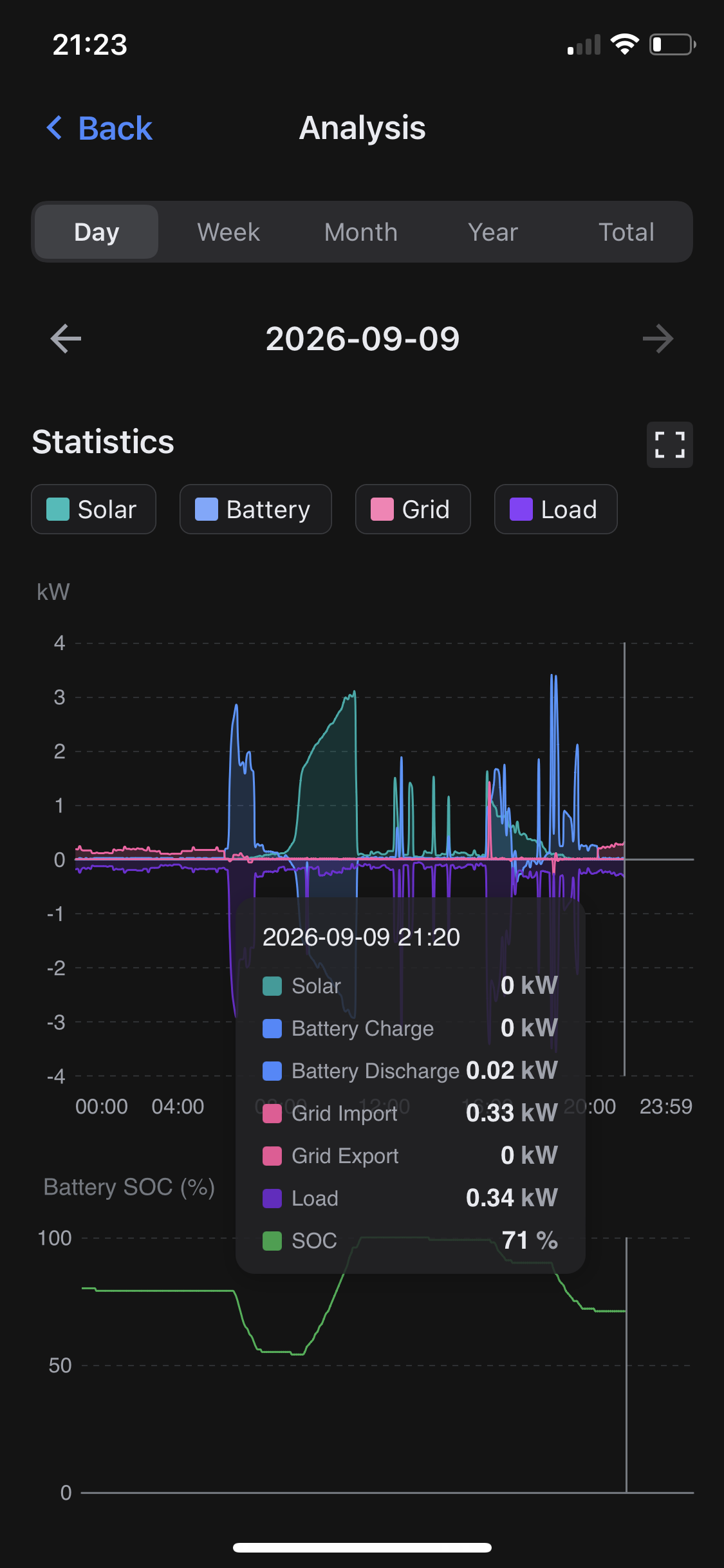

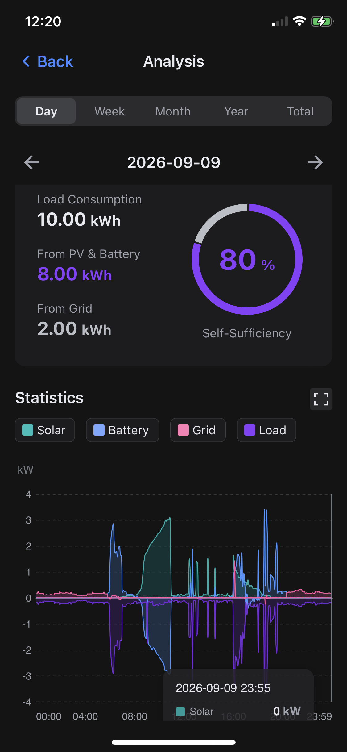

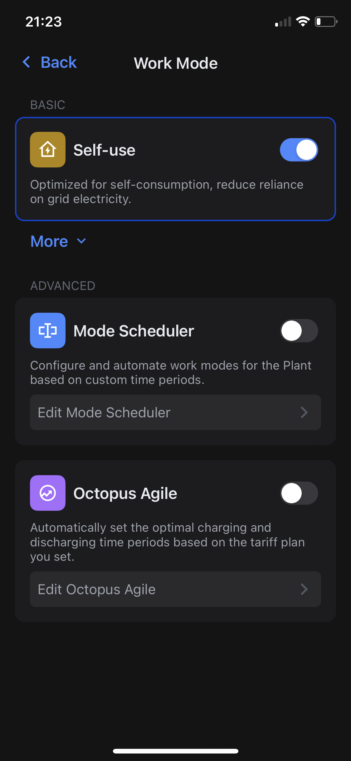

Hi there. Thank you. I think I am in self-use but attached a pic below. Also another chart showing how 30 mins ago power for the house is coming from the grid and not the battery
It looks like it has taken the change to the basic 'self-use' work mode.
On the power graph picture, it is as you are saying... taking power from the grid.
However, did you swap work mode at 21:23, or a little earlier?

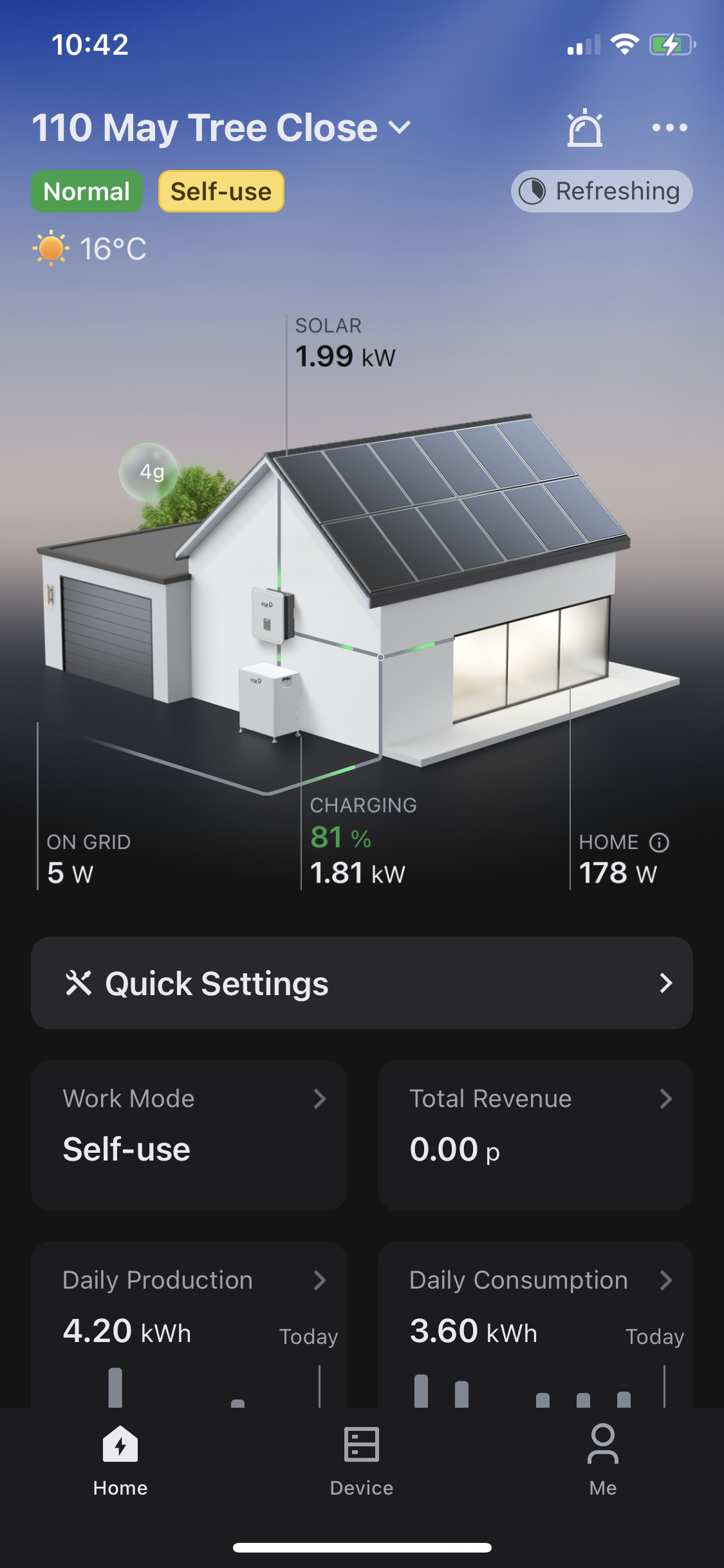

Hi there. Yes I have the refresh - pic attached and I am in self use. Any other ideas as to why I am taking power from the grid and not my battery through the night?

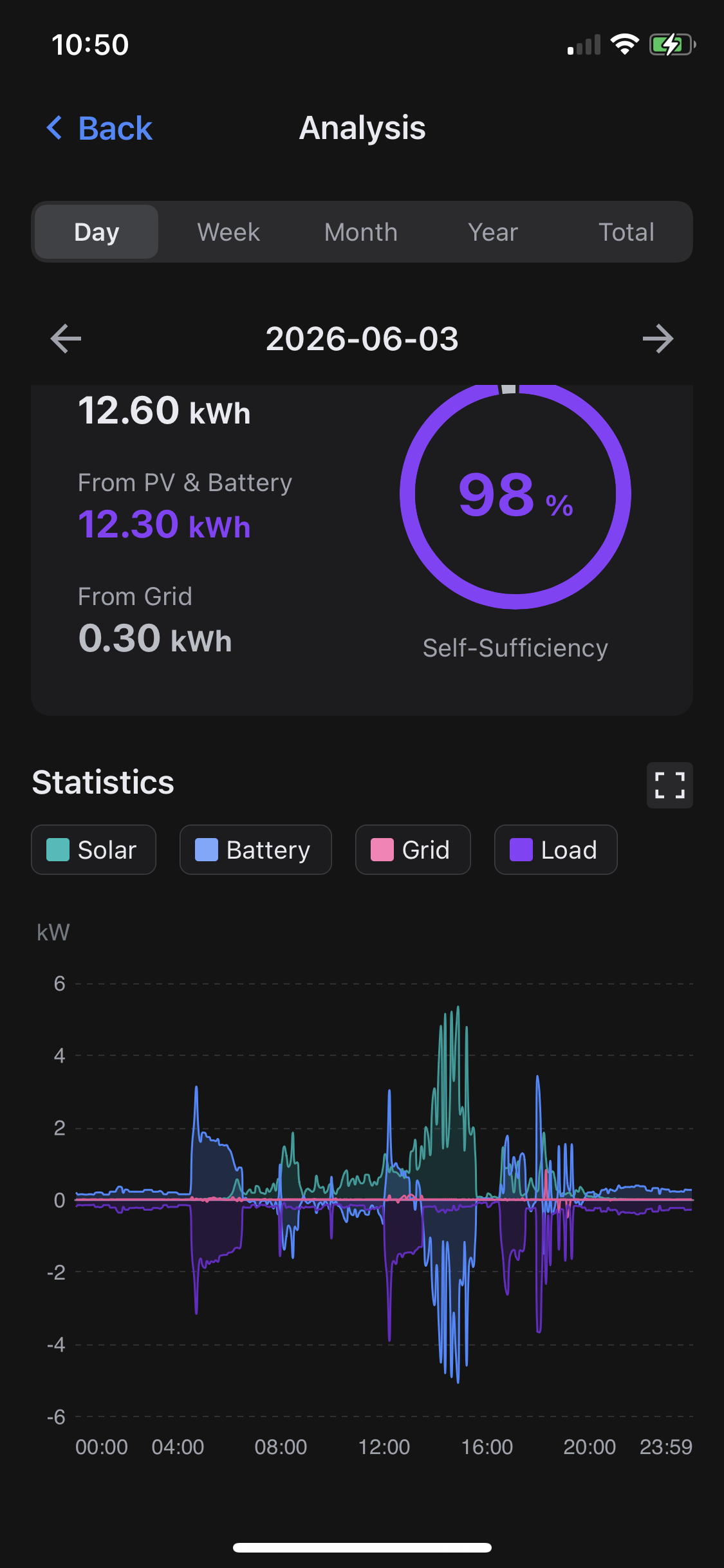

I have attached a chart of when we were taking power through the night from the battery. The change to taking power from the grid instead of the battery seems to have happened on the 7th June and can’t think of anything we changed at this time do really odd.
Looking at your latest image, there is only 0.3kWh of grid power used in a 24hr period. You are always going to pull some power from the grid, there is a setting you can adjust for meter compensation.
See this post here, and set perhaps a bias of 13W of Export? ( (0.3kWh x 1000W) / 24hrs) = 12.5W average grid pull )
viewtopic.php?p=17996#p17996
If you have some other days you can post graphs for, if you are unsure, they can be looked over. Do not worry too much about the grid import at night, it is the overall picture (24hrs) that you need to look at.

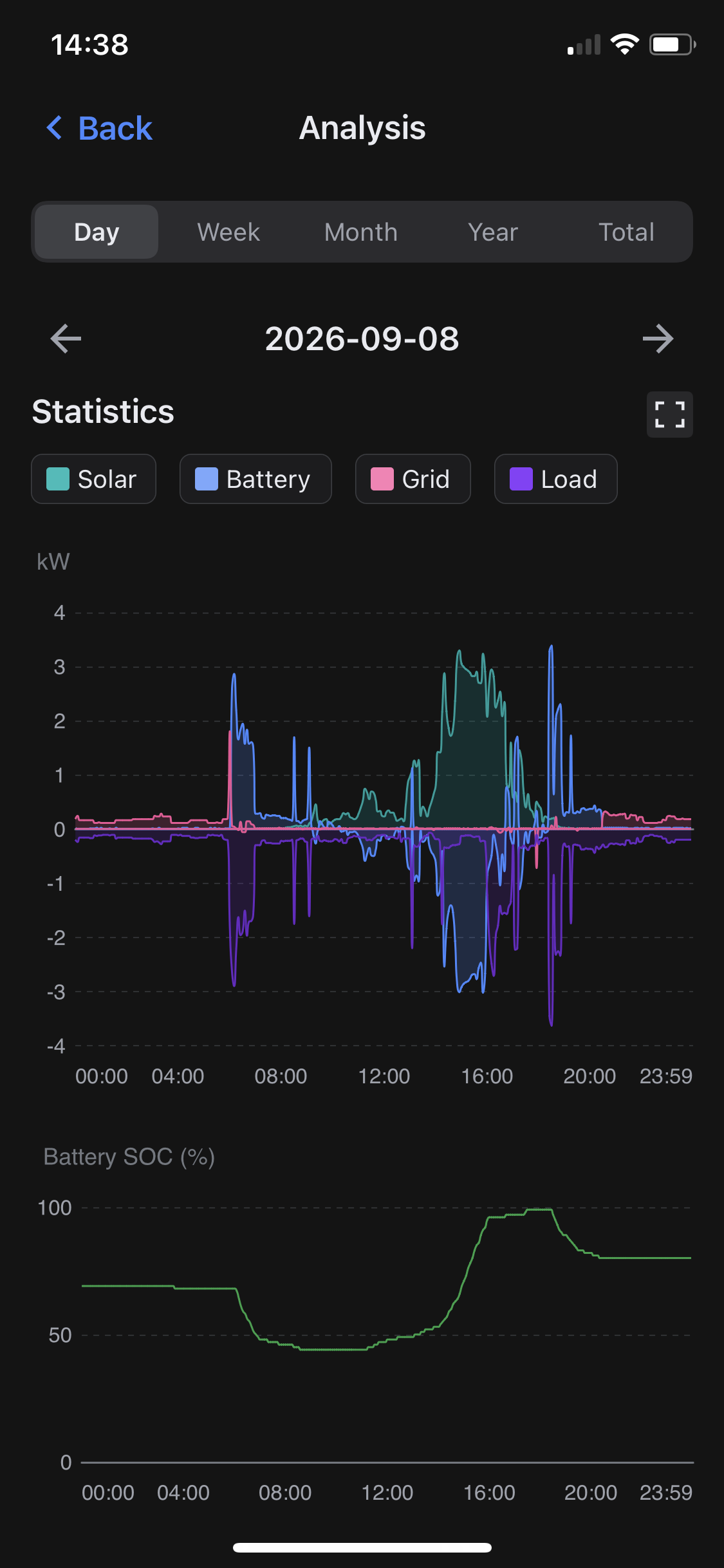

Hi there.Thank you for taking the time to look at this. Absolutely happy to take 0.3 kWh from the grid over 24 hrs but since the 7th June, this is what has changed so for example yesterday , we pulled 2 kWh from the grid over 24 hrs which I thought was a bit excessive when we had lots of battery power. What do you think - see pic.
Have you done a system restart, so a full shutdown of Inverter and Battery?

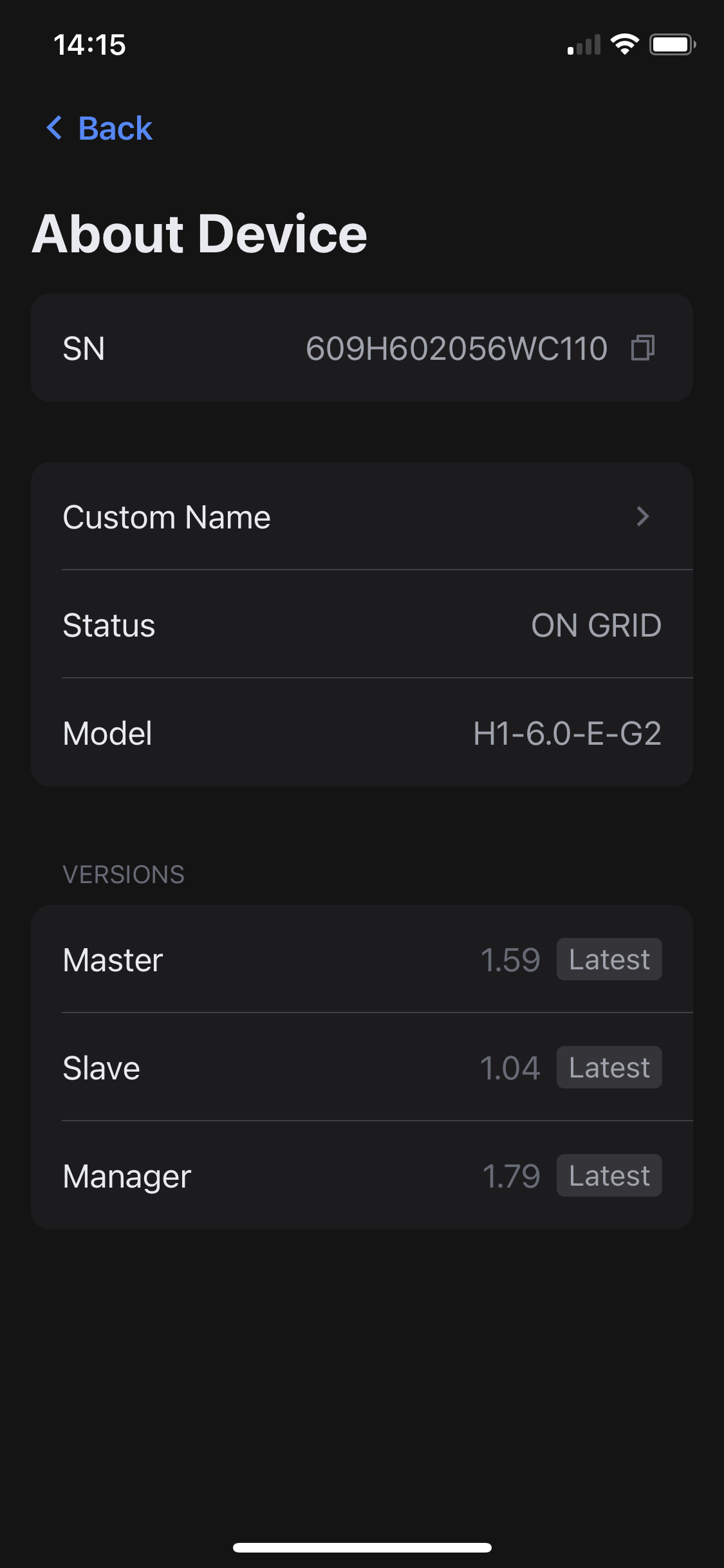

Can you check on your firmware versions, are they woefully out of date?
Hi there
Manager needed updating but can’t be hugely out of date as only installed last September. I am so nervous to do a system restart as not done before and worried I will mess settings and anything else up.

Yes, it should be working as intended... in 'Self-use' work mode, it should be using that during the night, and not stopping at around 8pm/9pm (depending on when it plays up)
I would get that reboot done to cross that off the list, and check tonight/this evening after the battery usually goes to sleep, if it is providing power.

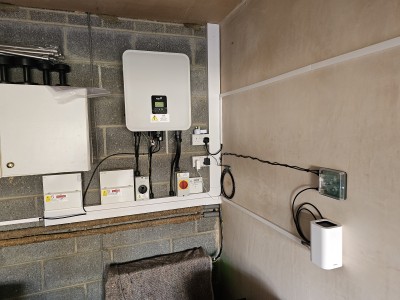

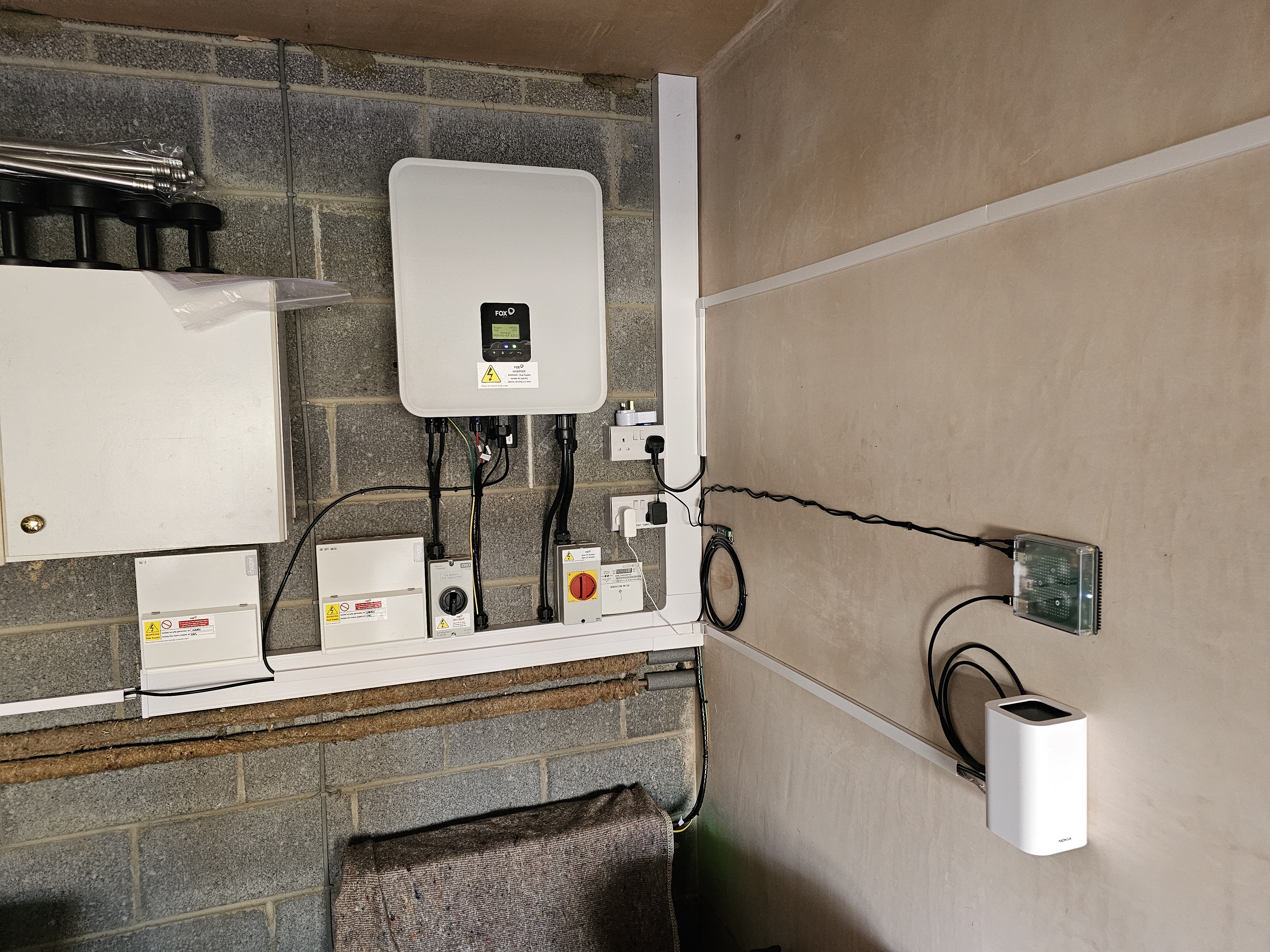

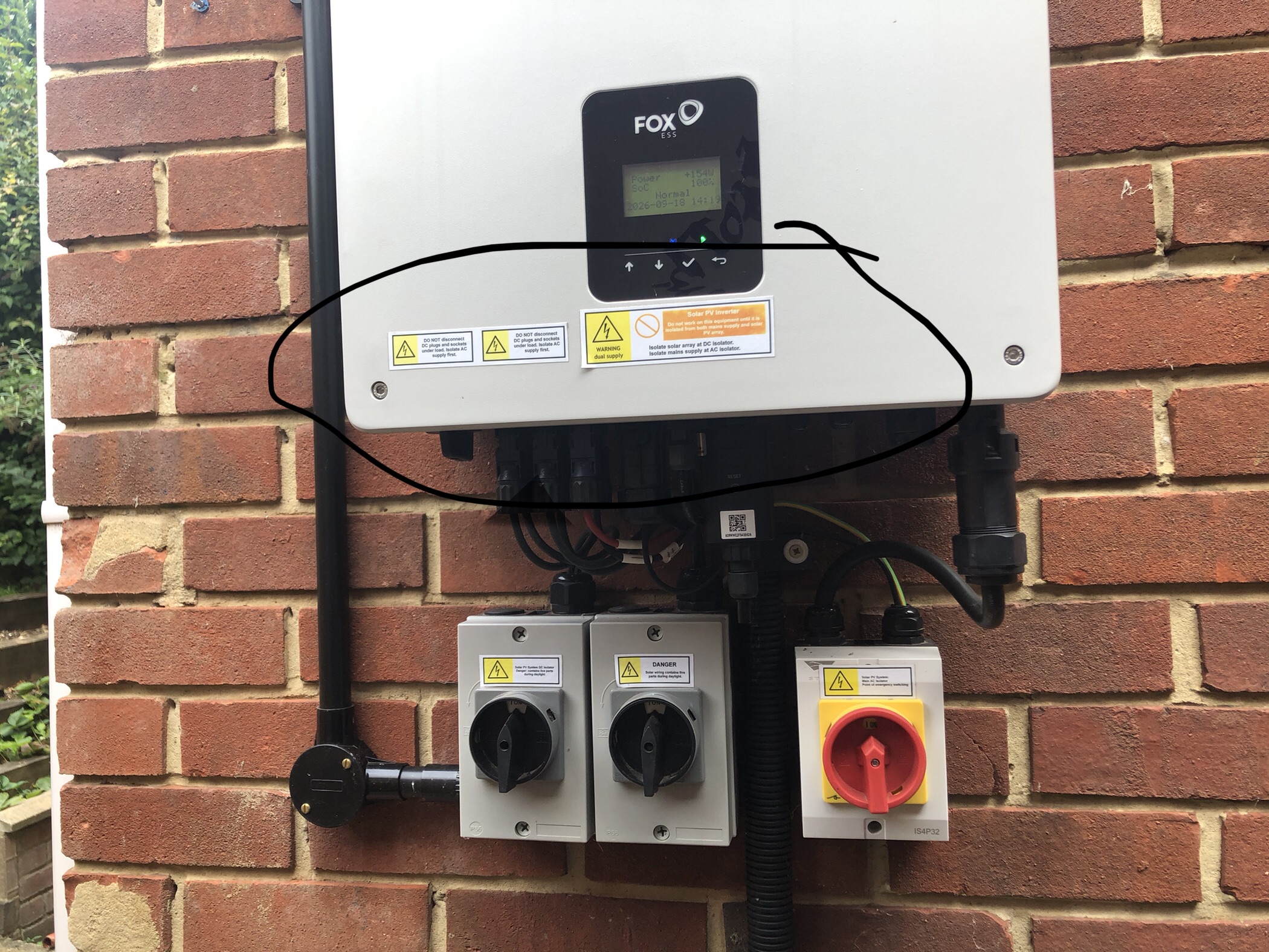

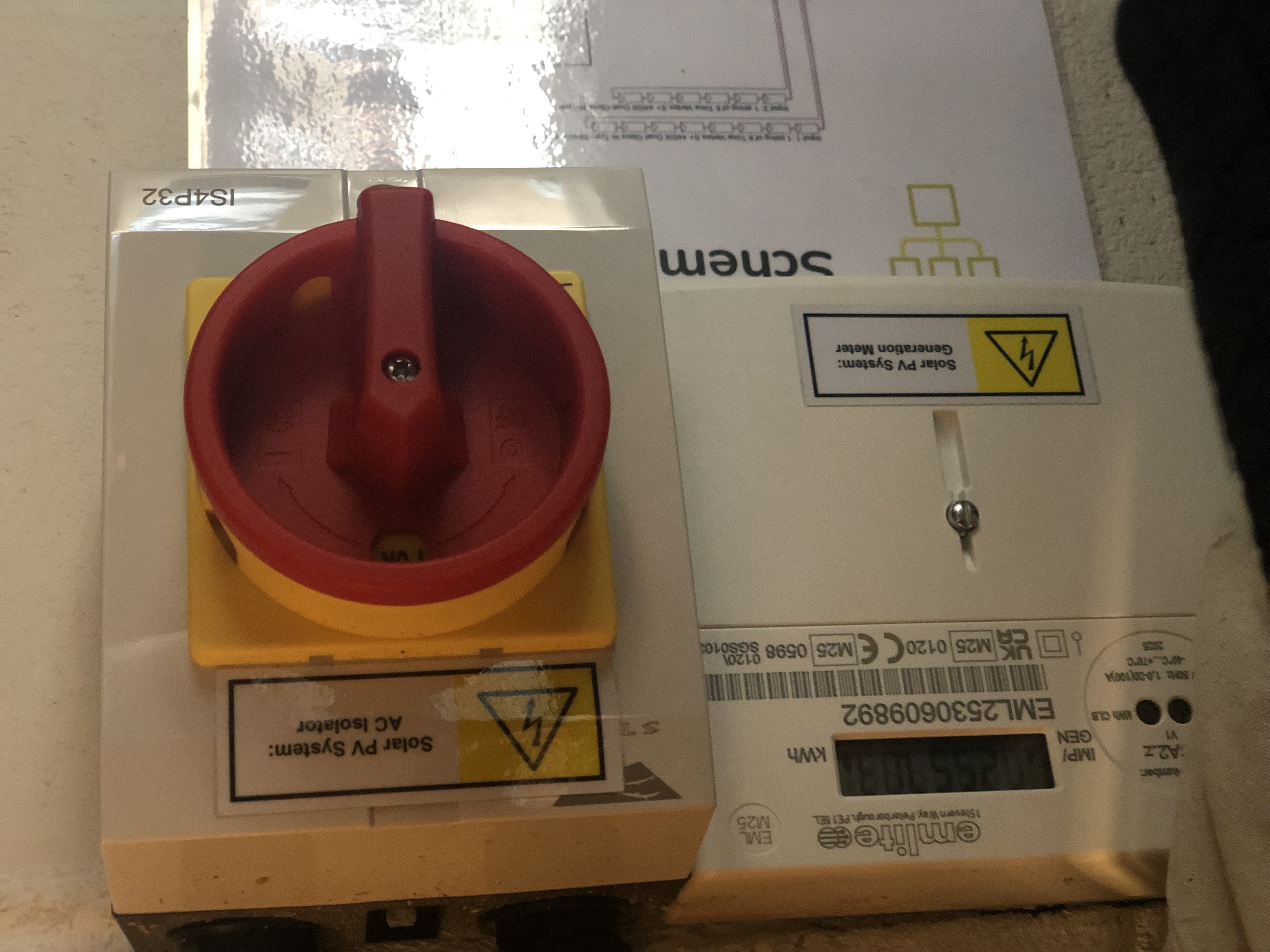

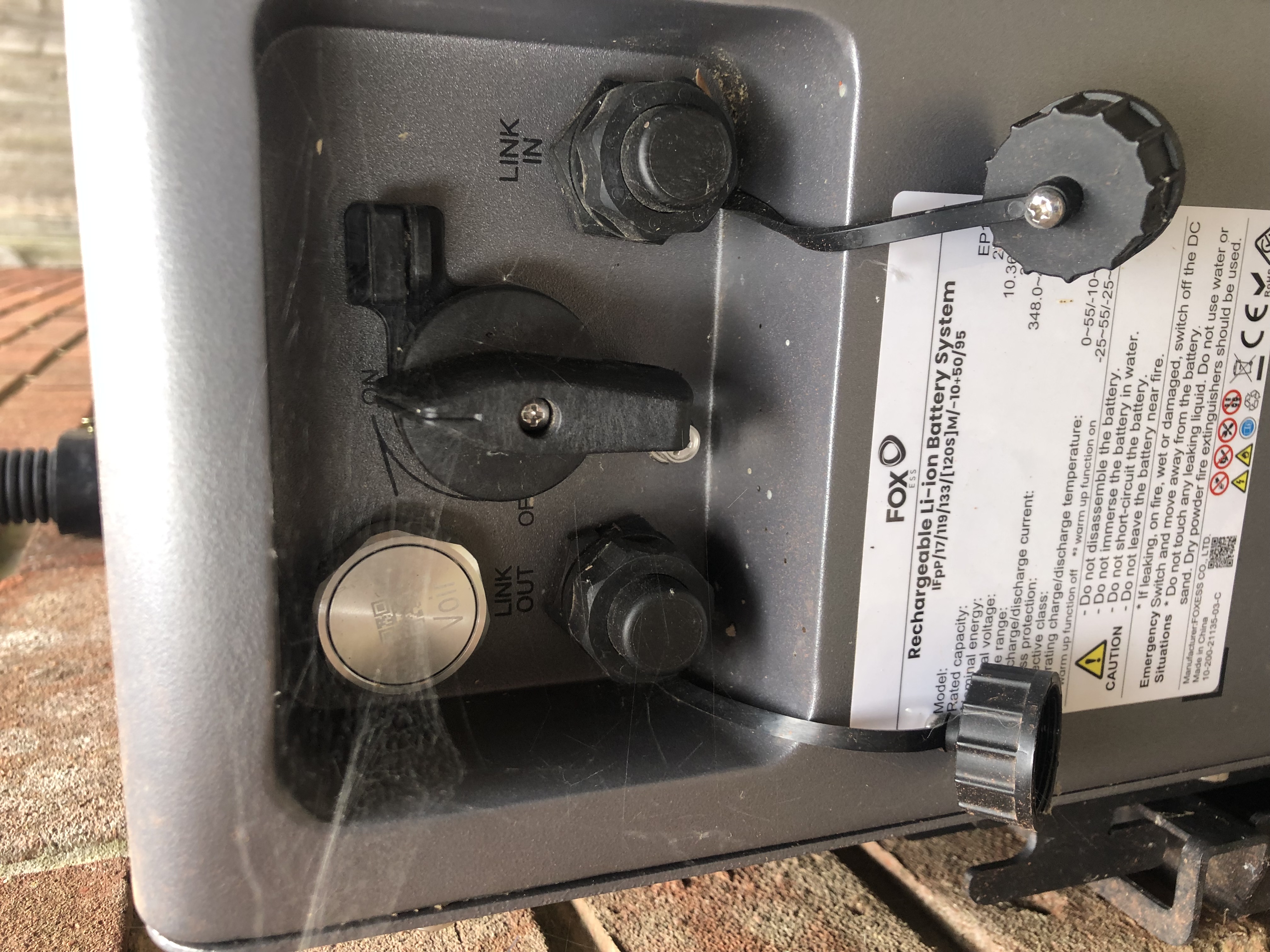

Hi there. We plucked up the courage to try a restart and found a hiccup after watching the video. I have attached photos.

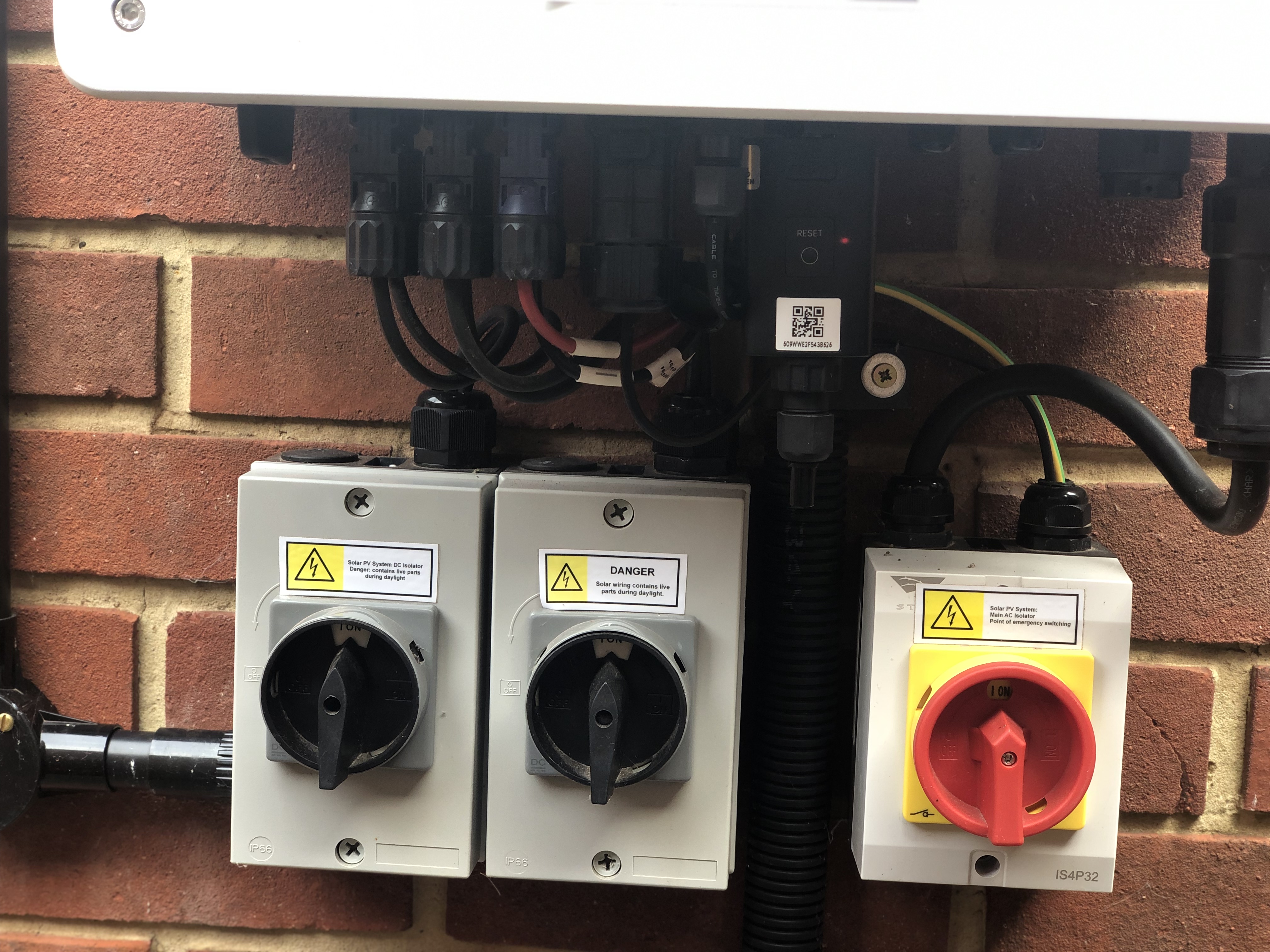

1. We seem to have 2 DC isolators( or at least 1 labelled isolator and the other mentions solar wiring) plus we have the switch under the inverter mentioned in the video. Do we turn all 3 off or 1 or 2 of these?
2. Then, we seem to have 2 Isolators - 1 outside on our wall where the inverter
is and 1 inside near our fuse box. Do we turn both off or 1 and if 1, which 1?

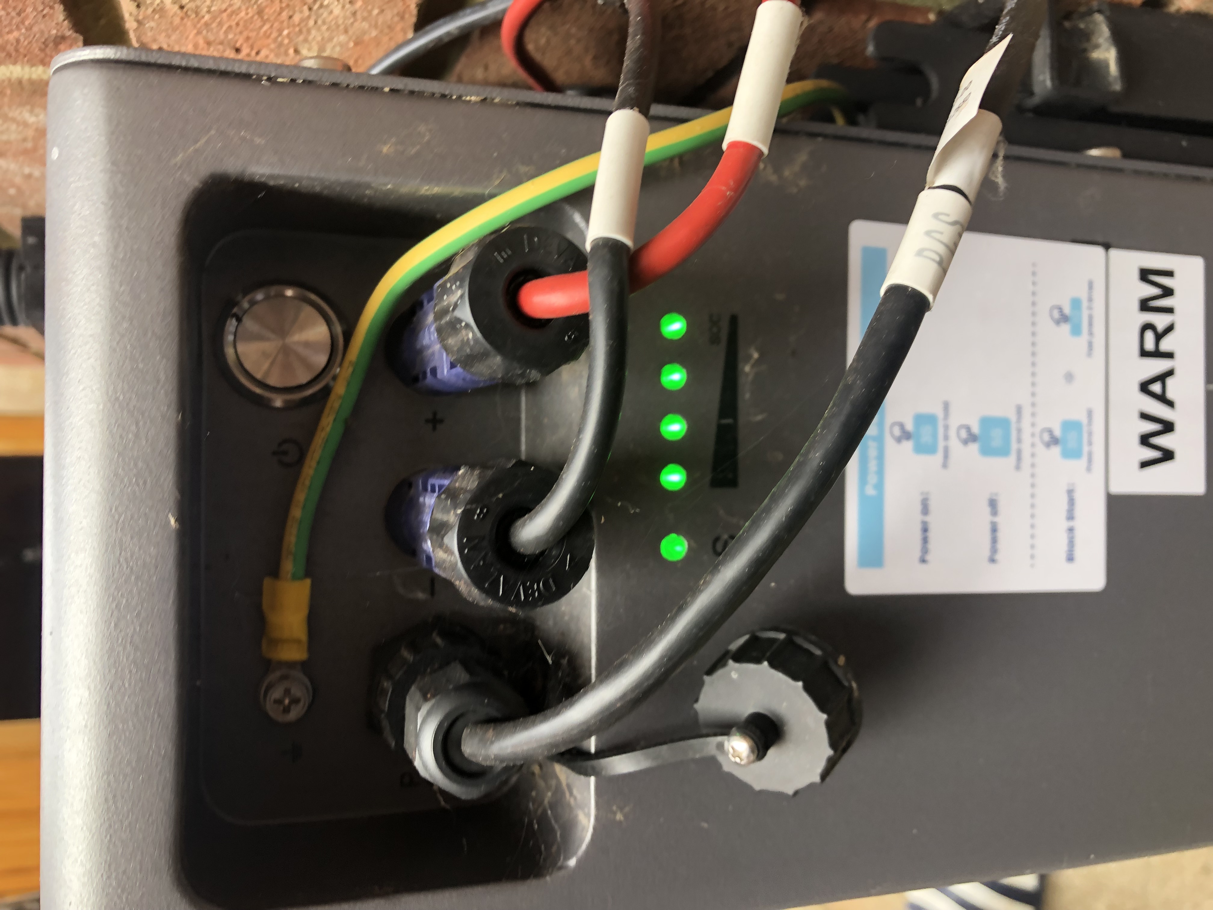

3. Then we don’t seem to have a circuit breaker on the battery box I have attached photos of each side to show.
4. Finally, the video says to isolate the D.C. first. On the inverter label, it says isolate the AC first - I have circled the picture.
Thank you in advance and hoping you can help these novices

From my own handover sheet
1. Turn OFF the PV supply at the consumer unit.
2. Turn OFF the AC isolator at the consumer unit.
3. Switch the AC Isolator at the inverter to OFF.
4. Switch the DC Isolators at the Inverter to OFF.
The consumer units in my case are in garage with my kit, so the two metal tins on the left side, underneath the cupboard.
The 3x DC Isolators are as follows, the inverter one will be sort of redundant (no need to turn off)
The other two bigger switches should be for PV and your battery.
If you are unsure, turn them all off. Just note on your battery, if you rotate the breaker on the left side... once you turn it back on, you have to hold down the silver button on the right afterwards to power it up.
If you are still unsure on some point, let me know.

Thank you and the circuit breaker - where is this?
Hopefully in your fuse box (aka consumer unit)
In my example, it's a fuse inside the metal tins
