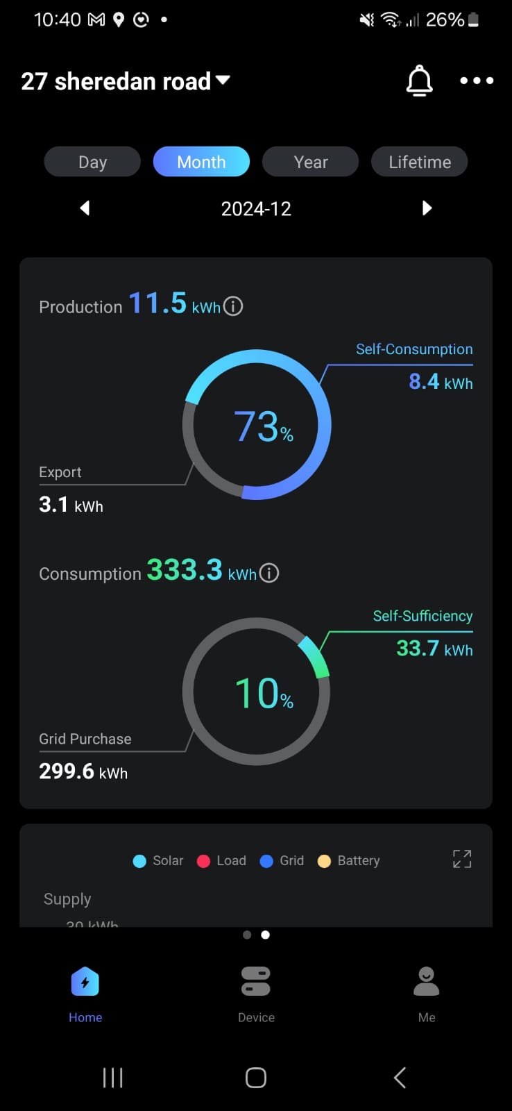

Hi All,
I have just had a new installation and noticed the 'discrepancy' between the numbers shown on the app suggesting the inverter was consuming a significant amount of power. After reporting it to Solar Power they agreed to send out an engineer to check everything over. For the rest of the day I monitored the energy flow diagram closely on my PC and, using screenshots, recorded what it showed periodically throughout the day, From what I could see...
1 - When the Panels were producing relatively low amounts of power, the 'missing' power was significant (up to 260W).
2 - When the Panels were producing significant amounts of power (over a Kw), the 'missing' power drops significantly and went as low as 10W.
3 - When the Panels were producing no energy (eg at night), the 'missing' energy dropped to virtually zero.
The engineer came a couple of days later and could not find any faults but took pictures of my recordings to report to Fox. They thought it could be to do with the way the inverter calculates power from the panels when they are at lower levels and maybe it could be power loss in the cables from the panels to the inverter. My runs are maybe 20m but they suggested that was not unusually long.
They rang Fox and spoke to someone there who said this had been reported by quite a few others and suggested a software upgrade. After the upgrade the numbers on the energy flow all added up to within a watt or two across all devices so problem fixed. But....

Thank you so much. You took your valuable time to answer me in so much details.
Here's my December production, tiny compared to you. I would like to find how much energy the inverter use per day if possible.
Thank you
This is what I got -
Your solar Production was 11.5 kWh (A)
You Exported 3.1 kWh (B)
So your Self-Consumption is (A-B) = 8.4 kWh (C)
Your Self-Consumption ration is (C / A) = 73%
Your consumption was 333.3 kWh (D)
You Purchased 299.6 kWh from grid (E)
Your Self-sufficiency is (D-E)=33.7 kWh (F)
Your % self-sufficiency is the ration between (F / D) =10%
Your system efficiency (Input/Output) is:
Input = Production (A) + Purchase (E) i.e. 11.5 + 299.6 = 311.1kWh
Output = Export (B) + Consumption (D) i.e. 3.1 + 333.3 = 336.4kWh
Your system losses is the difference between Input and Output (-25.3kWh ) which is -8.1% of the Input ~ 108.1% efficient.
Either you have more generation than is being shown here or there is something wrong in the grid purchase or consumption measurements - probably best to start with can you confirm how much electricity you have used on your December bill as we should be able to trust the smart meter.
- Posts: 1855
ok, thanks - if I assume all of that is production then the new figures areRoyS wrote: Wed Feb 19, 2025 11:54 am Sorry, I did not realise it. Yes, I have a solar edge system. Production for December 24 is 68.17 kWh.
Thank you
Your solar Production was 79.7 kWh (A)
So your Self-Consumption is (A-B) = 76.6 kWh (C)
Your Self-Consumption ration is (C / A) = 96%
Input = Production (A) + Purchase (E) i.e. 79.7 + 299.6 = 379.3kWh
Your system losses is the difference between Input and Output (42.9kWh ) which is 11.3% of the Input ~ 88.7% efficient.
So efficiency is good at 88.7% (90% would be ideal) and your losses is 42.9kWh ~ approx 1.38kW per day in December which is about right.
