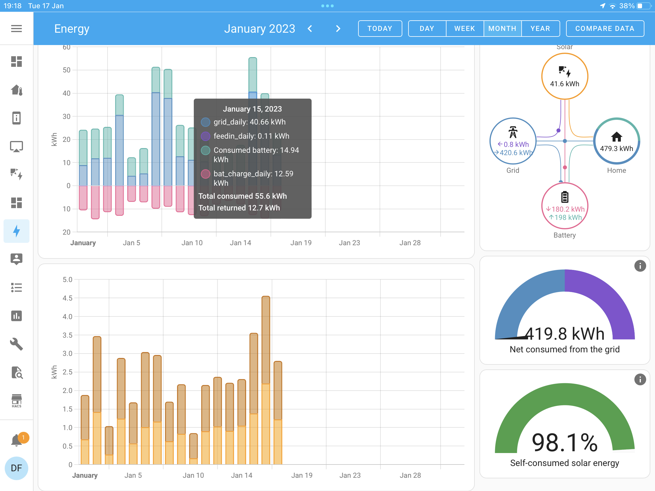

Personally I've setup HomeAssistant with the InflixDB and Grafana addon and query the data myself via modbus over ethernet. From here I don't need to rely on the FoxESS cloud service to be online and hold my data and grafana is very flexible in how you can model dahsboards and reports

I’ll try and pick off as many points as I can, probably the most important one is why do the numbers often not tally and the answer is usually down to system losses, these losses include charging the battery from the grid which requires an ac to dc conversion and then the natural RTE of the batteries (basically chemistry and resistance which generates heat).
Fox quote the HV2600 batteries as having a 97% RTE which is high for LFP batteries, normally its around 95% but if you add conversion losses I would ‘guestimate’ you are probably losing around 10% in the charge / discharge process. There is also the conversion loss between the solar (DC) and grid, and finally the amount of power the inverter needs to stay awake which it takes from the DC feeds (solar / battery), it’s usually about 70w.
It isn’t easy to work all these things out from the Fox statistics, I use a Home Assistant wired into the inverter to give me almost real time statistics, most importantly it allows me to calculate daily system losses - so for example my system today at 6.30pm i’ve had 3kw of solar, my battery has charged off grid 10.94kw, has discharged by 8.84kw and the total system losses for all of that are showing as 2.93kw.
I’m not absolutely sure on this but I think the Total Yield on the site overview monthly stats page is consumption yield plus losses, does Total Yield get close to your Octopus stats ?
On the device page Total yield is everything that has come out of the inverter i.e. all the output the hybrid inverter sends to the house load (either from solar or batts) - you’re right in that you need to take into account both charge and discharge of the batteries from grid or solar to avoid double counting and any solar that passes through the inverter to the load.
I don’t see the labels for charge/discharge energy totals on the web site,I only see Charge and Discharge on the device statistics page? but either way they will be including any charge (or discharge) from solar or grid.
At this time of year when the sun’s elevation is so low, unless you have clear line of sight all around you, you will likely be getting shadows from gables, trees, other houses etc.. and probably only clear solar between 10 and 2.30pm. Yesterday was a very sunny day and my 4.1kw of panels produced 4.6kwh which I thought was quite good, i’m not surprised after battery charge you aren't feeding in, anything at the moment.
Having said that in the summer months (June,July,August,Sept) I would be expecting over 20kw on a clear day so I wouldn’t be disheartened by your output now, from March you should be seeing double what you are now and increasing.
I know it’s frustrating but I would highly recommend looking at a home assistant which is basically a small micro computer such as a Raspberry PI, they are very good at doing real time calculations, providing statistics and lots of other things - i’ve included a screen shot of mine below, it takes all its information from the inverter itself either by connection to the Fox cloud (which gives 5 minute resolution) or by direct connection to the inverter (which gives near real time) - there are quite a few experts on the forums and William Eccles has done some brilliant setup videos to guide you through.

Dave - your dashboards look great. Any chance of sharing exactly what sensors you are using where (or sharing your dashboard YAML)?

Best thing to do to learn about HA dashboards etc is to work out what you want to know / be able to check about your own installation. Simple stuff like "how much power did I put into the battery last night?" is useful, but you can also log that night over night, and compare it to the temperature of your battery bank (if you're connecting via RS485 you can see the values the BMS knows about) and then see if the temperature is having an effect on your battery capacity.
Or you can work out how much usable power is coming out of your batteries, and hence what the effective cost of that stored power is - and how much you're saving vs using it directly from the mains.
As you learn how to do new things, you'll find yourself having your own ideas about what you could do, what questions you could answer.

Thanks, it's actually quite an old dashboard that one - home assistant is very addictive and you can "willeepyaich wrote: Sat Oct 21, 2023 3:03 pm Dave - your dashboards look great. Any chance of sharing exactly what sensors you are using where (or sharing your dashboard YAML)?
Thanks again to all in the community who are helping us newbies get to grips with all!
Most of the sensors there are standard Foxess modbus sensors, and using the standard gauge card and custom button card - with the standard gauge card i've gone to the trouble of defining segments (rather than just red, yellow, green) - it shows a finer resolution and I think looks better, i've posted a sample of a card below to show you it's yaml - but if there are any sensors there you are interested in, or have an idea for them - just post it here and i'll do what I can to help.
This is the gauge code, it uses a template sensor that takes the standard load_power sensor and converts to watts (see below)
