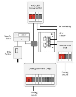

Level 2 – Automatic Circuits

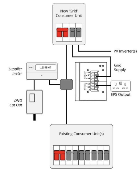

Like Level 1 above, but in this case, the EPS output is connected to a single circuit or a group of circuits. This is either through part of an existing consumer unit or a separate consumer unit on its own. This method is automatic, and the power will kick in after a few seconds in the event of a power cut.
This would power just the essential circuits such as lights, fridge and one or more rings, for example. This ensures that high load circuits such as EV chargers and cookers are unpowered, ensuring the EPS does not overload due to the cooker being on or the car being on charge.
This would almost certainly involve accessing the main consumer unit and thus would not be a DIY job. You would need to be qualified or hire a qualified electrician to set this up.
Level 1 & 2 are the only levels that allow you to utilise the UPS (Uninterruptable Power Supply) mode. Read more on this mode in the settings section later in this article.

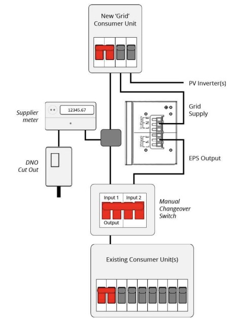

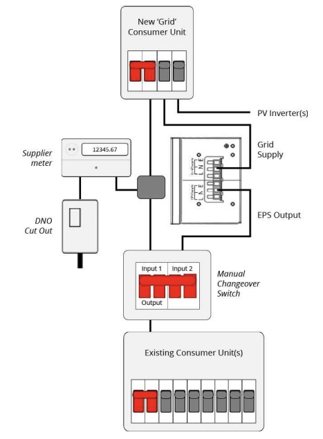

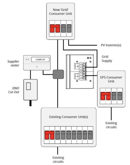

Level 3 – Whole House Manual
This is where the EPS output is routed into your main consumer unit. In a power cut, your entire home will be powered via the EPS.
However, there are a few requirements and caveats with this method. You’ll need additional hardware installed and you need to be careful about how much power is being drawn while in EPS mode.
You will need a “changeover switch” that, when pulled, will isolate your home from the grid and in turn, energise the EPS.
This is a manual action and in a power cut, you must pull this switch before any power is supplied from the batteries.
You’ll also need to be careful about what you turn on when in EPS mode. The EPS can supply up to 5kw of power (approx. 20A in the UK). If you draw more than this (say you have the oven on and then switch on the kettle and microwave), the inverter will overload and shut down requiring it to be reset in order to continue working again.
One way around this is to pull the circuit breaker for the circuits you don’t want powered before you throw the “changeover switch”. I usually pull the breaker for the EV charger, cooker and outbuilding. This will make it unlikely that I put anything high powered on that would overload the EPS.
Ironically, this is likely to be cheaper to implement than Level 2 because a simple changeover switch can be bought for as little as £40. An electrician just needs to wire the EPS into this switch and in theory doesn’t need to touch the consumer unit.
https://www.electrical4less.co.uk/produ ... er-switch/

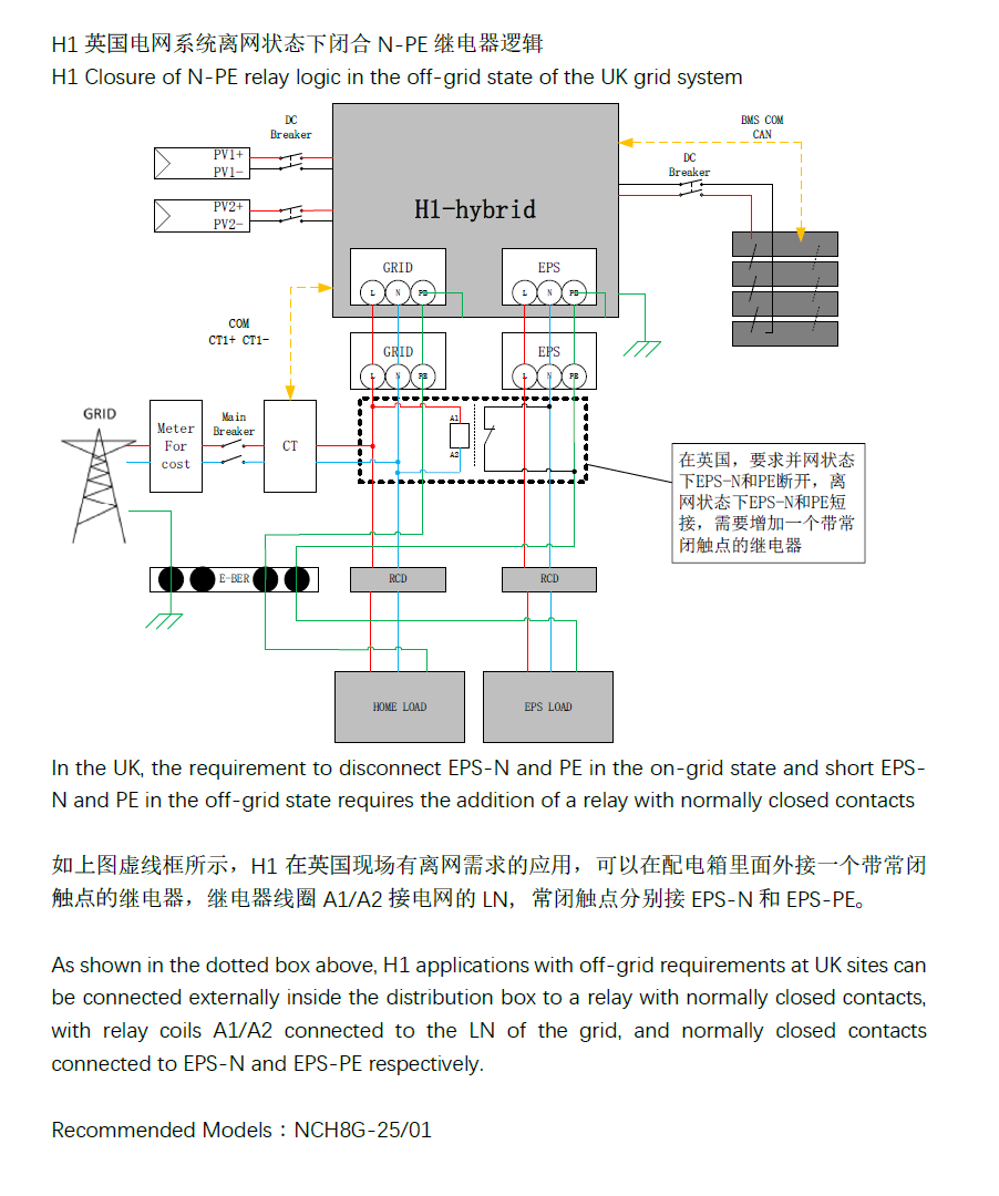

As mentioned at the beginning of the article, if you're earth is supplied by the grid, not only will you need an earth rod installed, your electrician will have to ensure that the EPS neutral is connected to local earth rod when in EPS mode and simultaneously disconnects the grid earth. This applies to both Level 3 and Level 4 (below).
A more detailed diagram and explanation can be found here:
https://github.com/TonyM1958/HA-FoxESS- ... ypass-mode

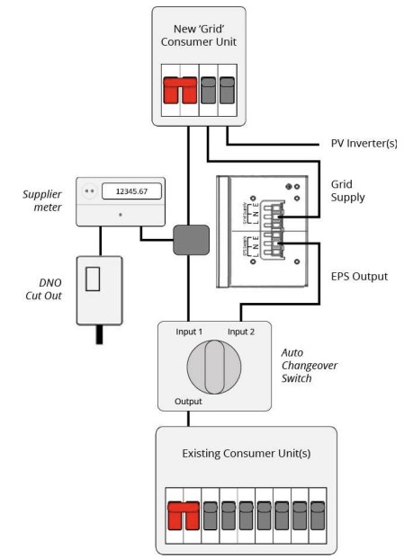

Level 4 – Whole House Automatic
This is in principle the same as Level 3 above.
The main difference is that the “changeover switch” is an automatic one which senses the voltage on the grid/EPS and switches automatically.
This is perhaps “overkill” for most households. One area where this could be useful is if there is essential medical equipment or systems that require powering while you are out of the house or cannot physically get to the “changeover switch” to manually activate the EPS.
It could be argued that Level 2 can be utilised instead in this situation where only the essential circuits are connected to the EPS rather than the whole house.

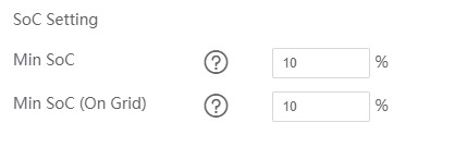

2) What battery settings should I use when considering the EPS?
The FoxESS inverters have two settings involving the “Minimum Charge Level” of the batteries;
• “Min SoC” and
• “Min SoC (On Grid)”.
Min SoC – The minimum battery level the inverter will allow the batteries to fall to in any situation.
Min SoC (On Grid) – This is the minimum battery level while there is grid power being supplied to the home.
If you don’t have EPS set up, then most will have both of these set to 10%. This is the lowest the batteries will go to in order to protect them from damage.
If you have EPS enabled, then you may want to set Min Soc (On Grid) a little higher in order to create a buffer to allow a backup of power to use in the event of a power outage.
To be clear, this will ensure that you have the minimum power in reserve to run the EPS for a set amount of time that you are comfortable with. In many cases, especially in the summer, you'll likely have well in excess of the minimum. Having the battery buffer in place is likely to be more important to you in the winter when solar production is lower, and your battery is frequently empty by the end of the day.
Let's look at an example...
You have Min Soc set to 10%.
You have Min SoC (On Grid) set to 20%.
In a normal environment with grid power on, the battery level will not drop below 20%.
This allows a permanent 10% buffer at a minimum which you can use in a power cut. While the power is out, the inverter will continue to supply power until the battery level drops to 10% and then will stop providing power.
How much of a buffer you keep will entirely depend on how much battery capacity you have and how much power you want to retain in case of a power cut.
Let’s say you have 20 kWh worth of capacity, then a 10% buffer will mean up to 2 kWh in reserve. A typical baseload of a home can be anywhere between 100-300w so this reserve would only last 6 to 20 hours. You could lower the baseload by turning off standby appliances, non-essential lights, perhaps a freezer than can last a period of time without power, for example. This would extend the time this buffer would last.
To extend the amount of time the EPS would last, you would either need to increase your battery capacity or increase your buffer by setting your Min SoC (On Grid) to a higher %.
For info, I have 17.92 kWh (7 x HV2600) worth of battery capacity and I have a 10% buffer allowing me up to 1.8kWh which roughly equates to about 8 hours of EPS time for me at my baseload usage. I have Level 3 set up which means I need to pull the “changeover switch”. Before I do, I pull the circuits I don’t need such as cooker and outbuilding (includes EV charger) and reduce my baseload to as low as I can.

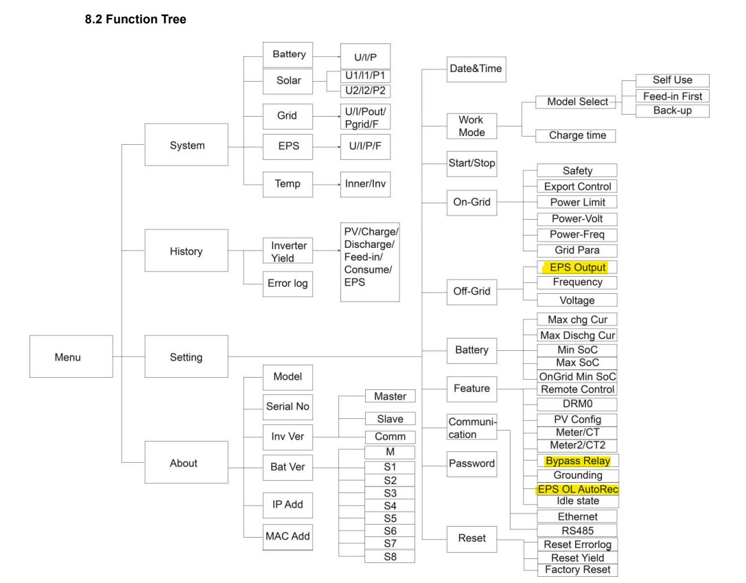

3) What are the various EPS settings on the inverter and how should they be set for your chosen EPS setup?
There are 4 main settings to consider:
1) EPS Output - Enable/Disable
2) Bypass Relay - Internal/External
3) EPS OL AutoRec - Enable/Disable
4) Grounding - Enable/Disable
5) UPS Output - Enable/Disable
EPS Output
This is an obvious one. If you are setting up your EPS or already have it set up then this setting should be set to Enable.
If not, or you simple do not want to make use of the EPS whatsoever then simply set this to Disable.

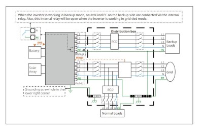

Grounding
If your entire home has its earth protection provided by an earth rod (typically called a TT system, for example. See link at the beginning of this article), then it’s likely your main consumer unit, and subsequently, your inverter will be grounded to this. Under normal operation and in a power cut, your inverter will not provide any errors related to grounding and any operation of the inverter will be safe (Grid or EPS).
Some homes however do not have an earth rod, and instead earth protection is supplied by the grid (sometimes called TN-S or TN-C-S). In a power cut, this earth protection will likely be cut and this leaves your system vulnerable and could result in damage to your inverter or you and any visitors to your home if the system has not been earthed properly.
In levels 3/4, you realistically have no choice but to add an earth rod to your home to connect all of your circuits and inverter to the ground. I’m not aware of any alternatives to this although that’s not to say they aren’t any. In 99.9% of cases though, unless you live on a rock, you’ll be able to install one and it is the most cost effective method. In this case, you would set the Grounding option to Disable.
Why would you ever need to set this to Enable?
If you decide to install level 1 or 2, you will still have to install an earth rod. In most cases, a good electrician will still connect every circuit (including the main consumer unit, inverter and the socket or circuit(s)) connected to EPS) to the earth rod. However, if this is not practical for any reason and you decide to install an earth rod and only connect it to the EPS supplied socket or circuit(s), then in a power cut the inverter will throw up a grounding error. Your EPS supplied socket or circuit(s) will be protected but the error will cause the inverter to shut off.
This is where you would set the Grounding option to Enable.
This will stop the error occurring. You are effectively manually telling the inverter that the EPS sockets are grounded and to stop the grounding error from triggering. For the sake of everyone’s safety though, especially if you are installing Level 1 on a DIY basis, please ensure the socket is grounded before switching this to Enable.

Re: What is EPS and what are the various methods/levels?
Very helpful article Ryan and thanks for posting.
I have the Level 1 version of EPS and like you have 4 x 2.6kWh of batteries.
Can I check one aspect of the article please? You advise that you have a buffer of 15%. Does this mean that your SoC is 25% (being 10% minimum + 15% buffer) or is the SoC simply set to 15%?
I will admit that mine is set to 25% which probably provides more capacity than is likely to be needed if the EPS were to be activated but I will admit that I prefer to have too much than too little stored power while we are in the winter months. I expect to reduce the SoC in spring once we get more daylight!
Thanks again for the article
1 x 5kW FoxESS inverter
4 x 2.6kW FoxESS batteries (version D)
19 x JA 405w panels
Thanks Lingford, I’m glad it was useful to you.
Lingford wrote: ↑Mon Nov 07, 2022 12:14 am Can I check one aspect of the article please? You advise that you have a buffer of 15%. Does this mean that your SoC is 25% (being 10% minimum + 15% buffer) or is the SoC simply set to 15%?
I have my “Min SoC (On Grid)” set to 25%. This minus the “Min SoC” (which is the absolute minimum) results in the 15% buffer that I referred to. Hope that helps :)
Like you, I too am considering whether it’s worth keeping that extra power in reserve. Is it worth importing from the grid that much earlier to retain that buffer? Some would argue that in the UK, power cuts are rare so you would be paying for that extra 15% when you don’t need to, which would be a very valid point. I have thought about reducing that buffer by 5% (0.5kWh) which is worth about 15p per day based on my tariff prices!
Any major planned outage and we would get a heads up of course! However, with a small baby in the house and the fact that I am using the full range of my battery at the moment, that small buffer is just piece of mind!

When using method 1, do we need to add a N-E bonding?
Just testing with a multimeter I can see a PD of ~120V between L-E and ~80V between N-E.
When grid is connected I see the expected 230V between L-E and 0V between N-E.

I have been trying to do research on the external EPS using as you describe an 'auto switch', it has been difficult to identify products that are labeled as an automatic or EPS switch, looking through the literature provided by FOXESS on their website there is inadequate information on external EPS and how to proceed. I am glad I stumbled across this forum today, the above is useful.
The closest I have come is to a single alternative manufacturer who manufacture an EPS box. From what I gather the contents of the EPS box are 2 contactors and having done a bit of research, I am struggling to work out how this particular manufacturer justifies the cost of the EPS box.
I know that Contactors have to be carefully selected dependent on the types of load to be protected although there are some 'standard' type contactors recomended for domestic use. The reason for this is that certain types of load found in a domestic situation have significantly higher instantaneous start up currents than say lighting.
My Intent is to have a second consumer unit that can be powered by the EPS mode containing selected circuits I wish to protect and enable. It has been interesting to read other users experiences of RCDs and RCBOs tripping, my consumer unit only have RCBOs with a couple of MCBs for permited circuits.
My installer is indicating that they will only supply a single socket EPS installation, although I have no confidence in them actually returning if I asked for it.
This is all rather moot at the moment as I am still awaiting functioning batteries (I have 3 that don't work).
Does anyone have any advice as to sources of 'auto switches' or constructing an external EPS auto switch?
15 x JA Solar 365W Mono MBB Percium Half-Cell Array - WSW Facing - split roof - 4 panels on low pitch
1 x H1AC1 Series 5.0 Inverter.
3 x Fox ESS HV2600 HV Batteries (faulty awaiting replacement (installer error))

diolemo wrote: ↑Sat Jan 07, 2023 5:05 pm When using method 1, do we need to add a N-E bonding?
I’m not sure about the N-E bonding. As far as I’m aware, an earthing rod is the only reliable means of earthing protection.
I have found a discussion here on it if it helps.
https://engx.theiet.org/f/wiring-and-re ... ply/109663
captaincaveman wrote: ↑Thu Jan 19, 2023 11:04 pm I have been trying to do research on the external EPS using as you describe an 'auto switch', it has been difficult to identify products that are labeled as an automatic or EPS switch, looking through the literature provided by FOXESS on their website there is inadequate information on external EPS and how to proceed. I am glad I stumbled across this forum today, the above is useful.
From my own research, a reasonably priced automatic changeover switch sourced outside of the usual Chinese crap on eBay and Amazon are hard to come by.
That being said, I know of two people on the Facebook forum to have used the “automatic transfer switches” successfully from Amazon/eBay but I can attest to how long they will last. I did see a YouTube video of someone taking one apart and the feedback was ok.
If you get a separate CU for essential circuits, essentially level 2, then this in my opinion is the best but most expensive option.
You eliminate the need for a changeover switch and is all automatic. Additionally you can turn on the UPS option which essentially allows a transition of less than 20ms - meaning that anything electronic like a pc or server will not restart.

Hi guys,
do you have any info about the "UpsOutput" setting?
Re: What is EPS and what are the various methods/settings?
Peeshow wrote: ↑Wed Mar 08, 2023 11:42 am Hi guys,
Nothing written anywhere in publicly available fox documents.
However in general UPS is faster at switching over from the Grid AC to the EPS output (<20ms) than just the EPS on it's own.
This is usually only necessary when you really need computing equipment, for example, to continue running uninterrupted (which typically needs <20ms before the RAM memory resets with the lack of power).
That being said, if you have levels 3/4 installed, having UPS on becomes irrelevant because the act of having to manually throw the changeover switch will obviously result in the power being off briefly (automatic changeover switches can't typically be relied upon to switchover in less than 20ms).
Hope this helps.

I’ve recently had Level 3 EPS installed with my H1 inverter and am very pleased with it. Power cuts where I live are unfortunately pretty regular especially in bad weather.
One thing I hadn’t expected was the EPS behaviour when the grid returns. There was a cut this evening, so I threw the changeover switch and all was working well. When the grid came back on, I noticed (through HA monitoring) that the inverter reverted to “On Grid” mode and was powering the house through a combination of battery power and grid, even though the CU was physically isolated. I tested this by switching the inverter into Backup mode to stop the battery being used. I’d expected the grid not to return until I flipped the changeover back. After a bit of head scratching I realised why - the inverter MCB is on the “grid” side of the changeover switch (in a separate “high loads” CU with my EV charger) and so was able to resync with the grid and supply power to the house through the EPS circuit. I confirmed this by checking the EPS power info on the inverter screen and it confirmed EPS was feeding the house, not the grid directly.
Just writing this down in the hope it helps someone else going through the same confusion as I did!

I found this diagram in a GoodWe manual (which is suspiciosly similar to Foxess, but better done) where the "how" is more clear. There needs to be a internal relay that bonds EPS N with EPS E when it's running in island/EPS mode.
Where is this relay in FoxESS EPS system???

Graph9919 wrote: ↑Sun Nov 26, 2023 12:09 am I found this diagram in a GoodWe manual (which is suspiciosly similar to Foxess, but better done) where the "how" is more clear. There needs to be a internal relay that bonds EPS N with EPS E when it's running in island/EPS mode.
This has been an interesting discussion point for many months, an installer recently spoke to Foxess support (UK) and they confirmed that NO E-N bonding takes place within the inverter when in EPS, it would need to be done within whatever external solution you install using an external relay that activates when the grid fails/ EPS becomes live

Dave Foster wrote: ↑Sun Nov 26, 2023 9:47 am

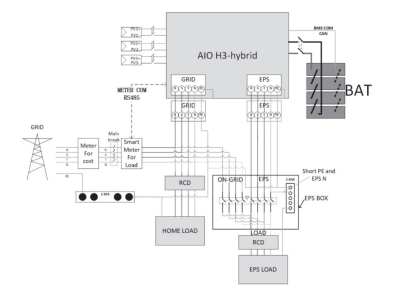

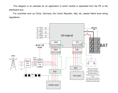

I've been checking more Foxess manuals, in the AIO H1 manual this N-PE bond is completely omitted, but in H3 and AIO H3 it is mentioned.
In the H3 the relay is there and it is explained that works automatically:
In the AIO H3 it is explained that the bond happens in the EPS box, not clear if happens automatically too or if it is asking to do a manual permanent short or else.
I will contact again FoxEss, if the AIO H1 can't do this bond then either they provide what is needed for it to work (not explained anywhere in the documentation) or I'd consider the EPS function as faulty and ask for a replacement. You can't sell an inverter with EPS that can't do grounding properly and not explicitly say it in the documentation and flyers.

Graph9919 wrote: ↑Sun Nov 26, 2023 11:49 am I've been checking more Foxess manuals, in the AIO H1 manual this N-PE bond is completely omitted, but in H3 and AIO H3 it is mentioned.
Ok, please let us know what they say - as you say this is a very grey area, I think made worse by regional differences in electrical standards

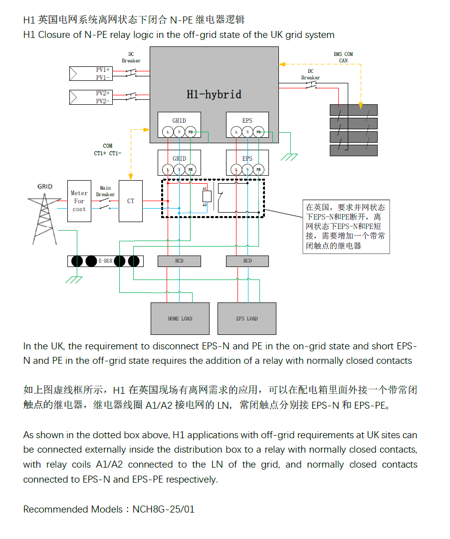

I've been waiting for a response since november from their support; this week we have the Genera Expo in Madrid and Fox is there, so I went to ask them directly.
Attached is their official solution for this. Basically a NC contactor energized from the grid side.
Main issue with this solution is that once the grid is back, the NC opens again and you have a floating neutral for 3 minutes in the EPS side.
No information whatsoever about the ups, bypass relay or grounding configurations that needs to be in place. These guys are super lazy about writing documentation.
