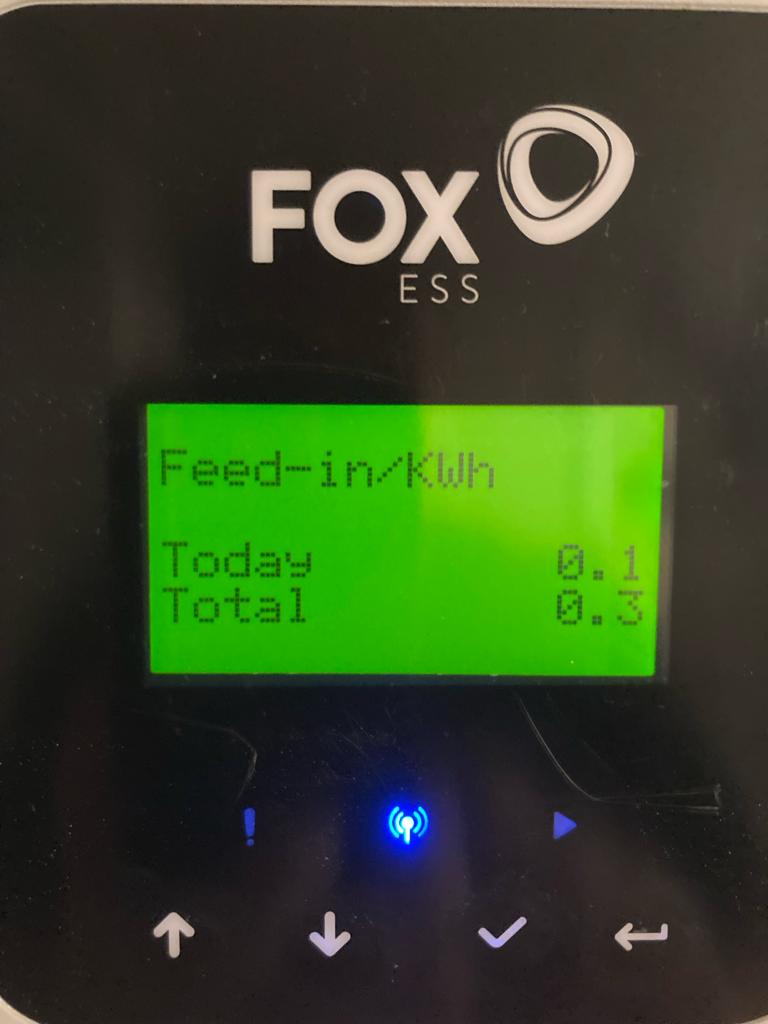

Thank you very much for the explanation. I also took the measurements directly from the inverter. See the attached picture.
Of course the amount is very small, but it is there.

- Posts: 1855
Yes it’s a grid tied inverter and normal, there will always be a small import & export, once the sun starts shining in warmer months all of these numbers will become noise in the overall statistics.
