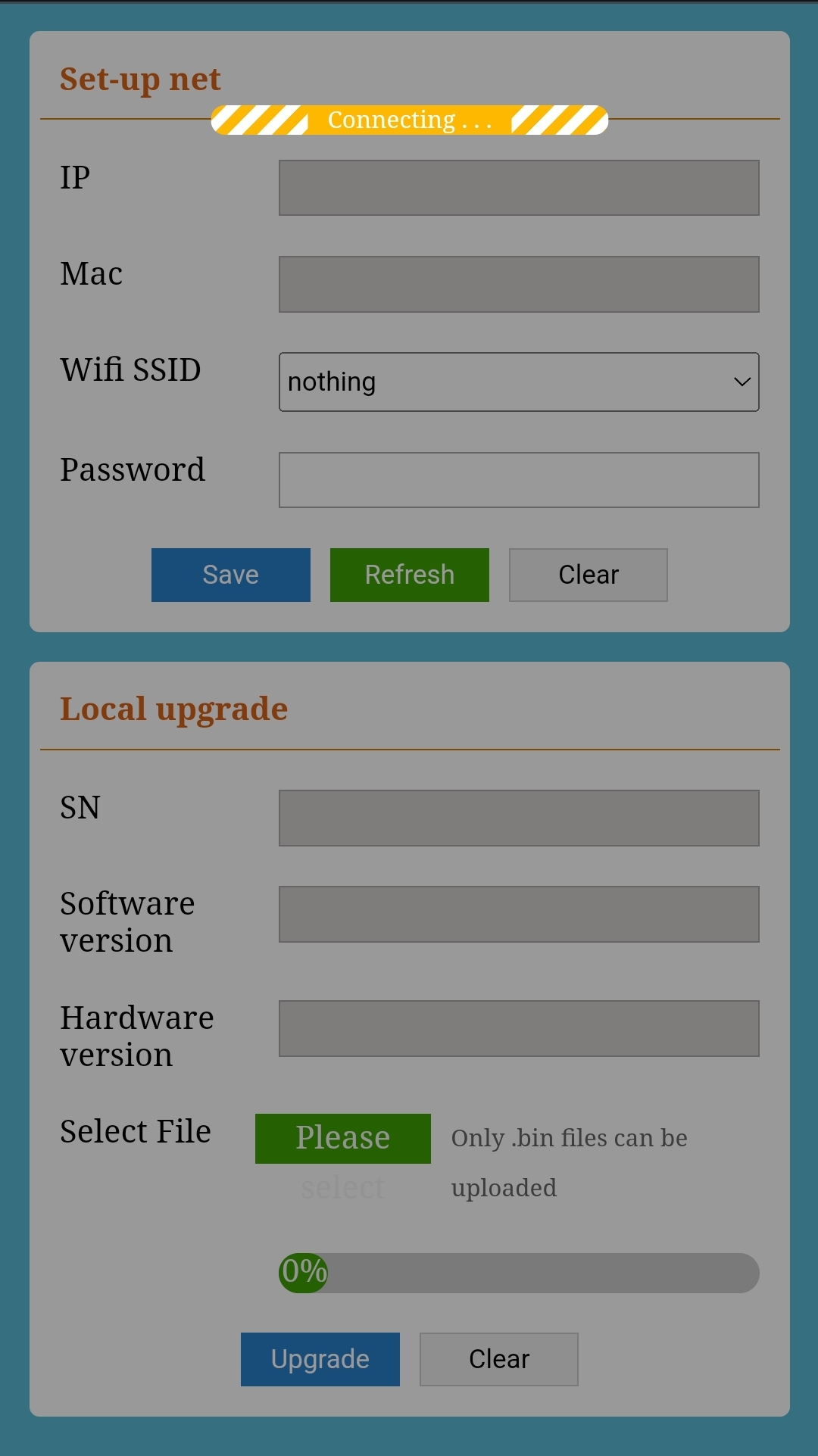

When I try to connect directly to the IP of the WiFi dongle, I can see the initial configuration screen, however it is now perpetually showing a "connecting" bar.

The dongle screen you are seeing usually happens if the browser on the device you are using isn't compatible - usually on older devices, try with a newer phone, ipad, laptop - failing that un-screw the dongle, remove it and re-insert it and try again.

As for the Dongle web interface, I have disconnected, and reconnected. Using Android on a Glaxy Note 10 with Firefox and Google Chrome, alongside a Ubuntu laptop, running Firefox and Chrome all show the same infinite "Connecting..." issue. The main reason i wanted to access it was to prepare for changing over to a new WiFi SSID/Network name

After any kind of glitch or reconfiguration, I find it can take half an hour or more for the wifi dongle to re-connect to the foxess cloud. Of course there's neither feedback nor control over this process, you just have to wait and hope.
