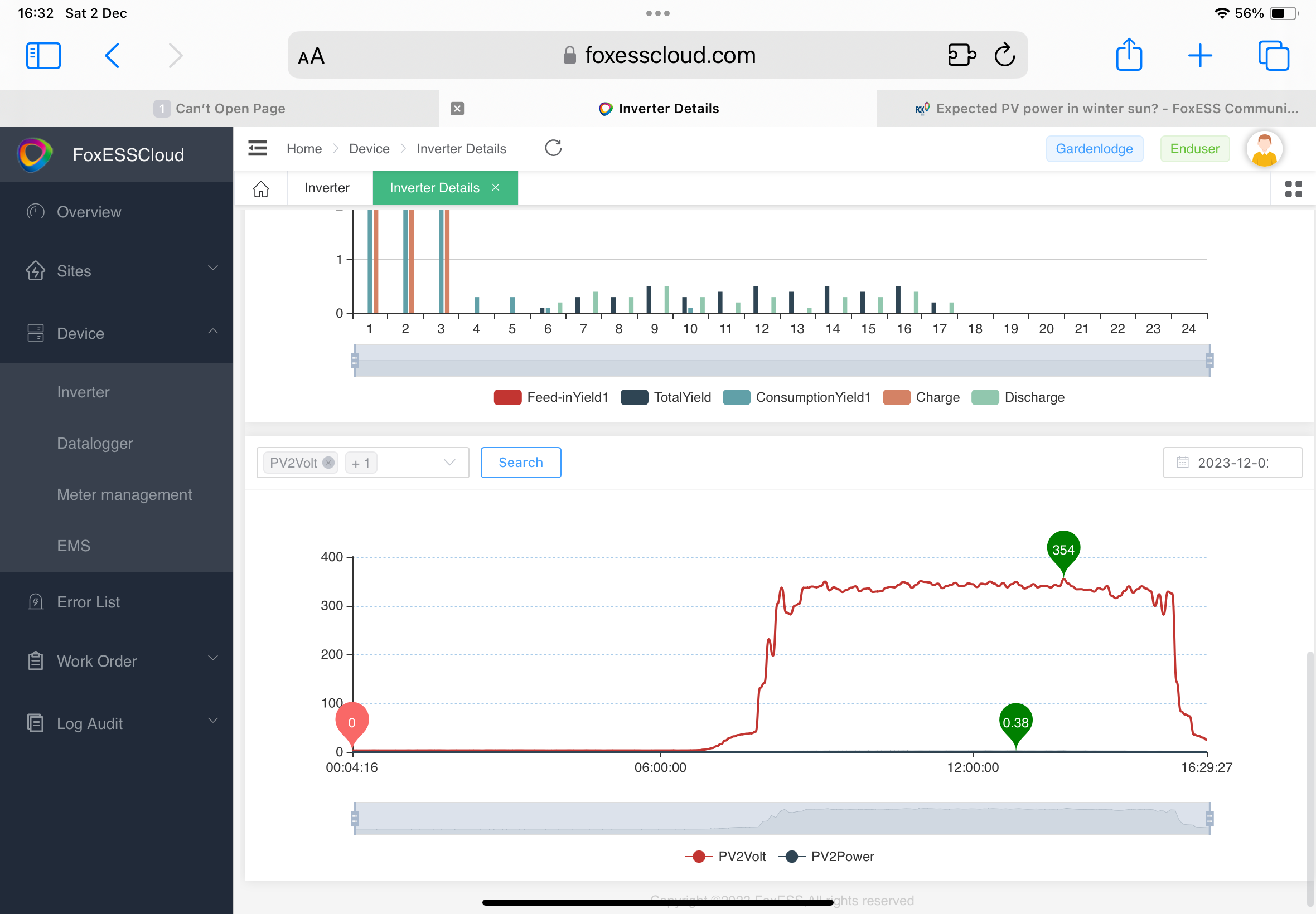

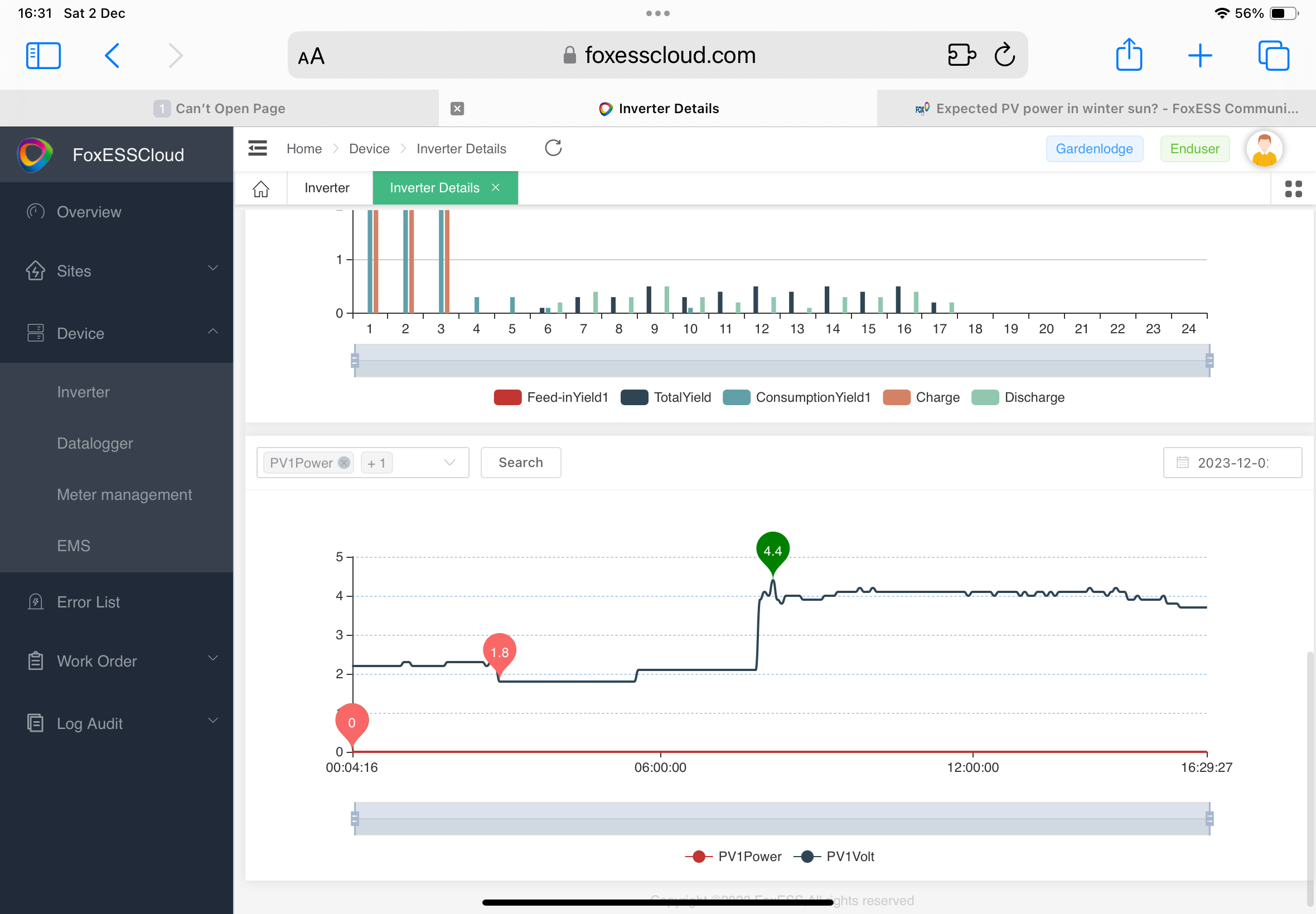

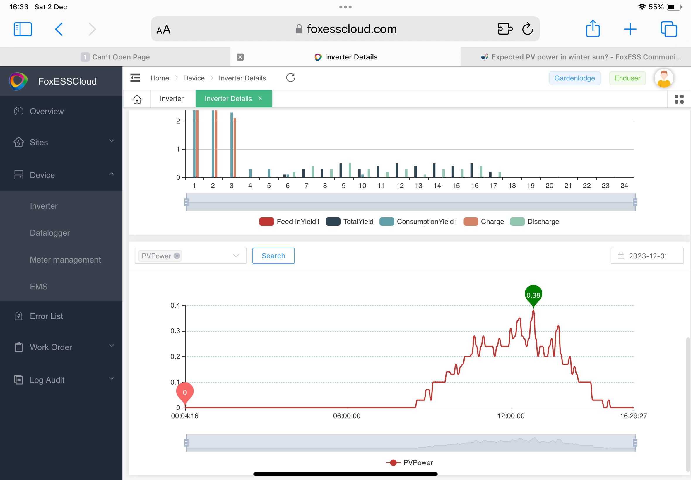

Three screen grabs.
1. PV1 Power and volt.
2. PV2 Power and volt.
3. PV Power (which is identical to PV2 Power. PV1 Power is zero).

Thanks for posting those graphs, that makes sense now - yes PV1 is not connected, all your panels are on the one string PV2.
Your output isn’t particularly high - If there were no shadows (or frozen panels), and full sunshine I think you might expect 1kw output at peak but obviously with the suns elevation being so slow, other houses, trees, chimneys and gables all get in the way.
December is the worst solar month by a fair margin, but if we get a bright sunny day I find it is a good idea to take a picture of the two strings every hour or so, then you can see if there are any shadows being cast and from where.

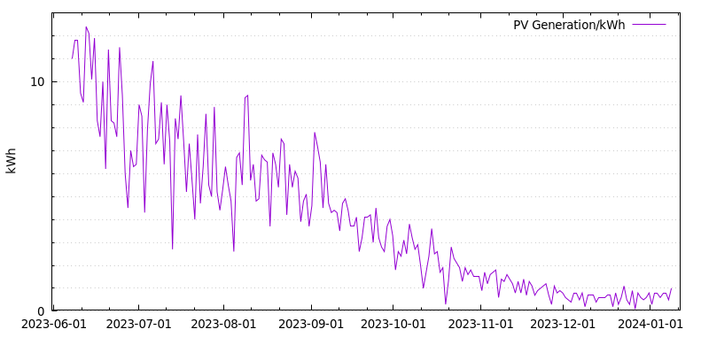

In case it helps, here is my daily PV generation over the last year. This system is 6x390W panels, 3 on the back facing ESE, 3 on the front facing WNW, all as a single string with 6 optimisers.
