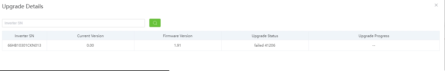

I am continuing to face issues with my H3 single CPU unit. In addition to my previous problem, I am unable to update the firmware via USB as well - it always results in a 'fail' message. I have fully charged batteries, and I am supplying 170V DC to PV 1. Both the master and slave components are still displaying version 0.00 in the monitoring system after restarts. Has anyone encountered similar issues or knows how to resolve this situation?

Thank you for your response. Yes, a new manager version 1.75 has been added, which I updated from version 1.71. Currently, version 1.75 is uploaded, and the update was successful. However, after the update, the inverter did not start up. The Master still shows version 0.00. So, I proceeded with an update of the Master to the only version offered, which is 1.91, but this update ended with an error message "failed 41206". Please, how can I perform a downgrade to return to a functional firmware version? I am seeking any assistance to revive the inverter. Thank you.
