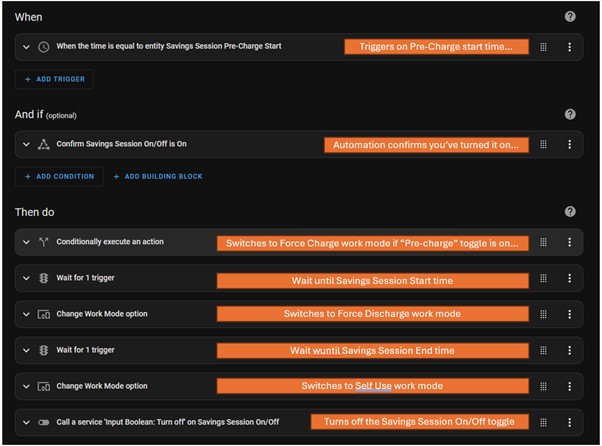

1) Enable the automation (if not on already - you can keep it on permanently if you want - my OCD leads me to turn it off...)
2) Turn on the main On/Off toggle
3) If required, turn on the pre-charge toggle
4) Set the pre-charge start time - this bit is fairly common sense - if you want to pre-charge for 30 mins, set it to 30 mins before the start of the savings session and if you don't want a pre-charge, simply set it for a few mins before the savings session start time
5) Set the savings session start and end time.
6) and relax... the automation will trigger at the pre-charge start time and turn itself off at the savings session end time.

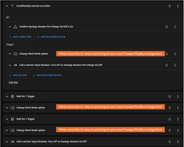

____
Step 3
Next, you'll need to create a new automation.
Open a new blank automation, switch to YAML view and then copy and paste the code in the link below into the automation.
After you've copied the code - switch back to visual editor mode - then make sure work mode steps are pointing at your own Foxeess Modbus integration.
